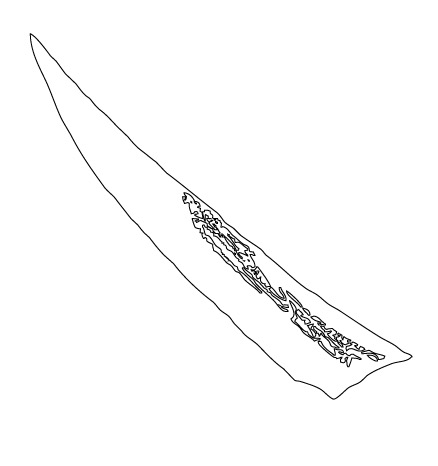

The first thing I did was sketch a rough outline of the blade using a shot of the blades as my guide.

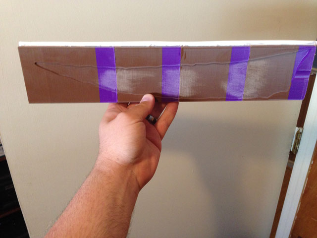

Next I built a quick'n'dirty 3d model and printed a negative mold on my printer.
I hot glued all the pieces to foam board, then hotglued the two halves together and poured in the resin and it is now curing.
NOTE: Pulling the blank destroyed the 3d printed mold even tho I did use a liberal amount of mold release.
My intention is to use this resin cast as a template for crafting the blades overall shape and contours by sanding and shaving. At present I don't have any intention to cast it in metal but I will probably cold cast a couple when I'm done. This should make for an interesting project and is totally new to me so if you are interested fallow along and please comment/share your ideas and experiences if you have ever done this as I can always use advise.

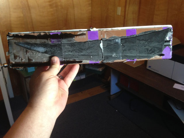

One side of the 3d printed mold:
After pulling the first (and only) cast from it. I want to let it fully cure before I go to work on it.

Well I managed to crack the resin blade when I pulled it, it was quite difficult to pull from a abs mold.
I glued it together and make a quick mold using some brush on silicon before I went home yesterday and let that setup overnight.

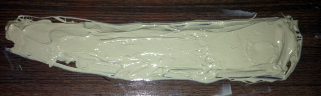

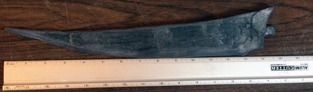

This morning I after the mold had set I mixed up some smooth cast 325 with equal parts of urefil micro beads to give the resin some elasticity and cast blank blade from that.

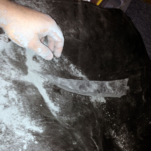

I let it cure for a few hours and then started to sand a little bit. Keep in mind it wont be fully cured until tomorrow but I just couldn't want.
The filler helped but boy what a mess!

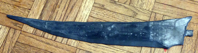

Now I have the rough shape and a start on tapering the blade. The blade is pretty floppy at this point so I am going to let it sit over night before I attempt to do anything else to it.
For reference this is what i have in mind for the pattern on the blade, my guess is that this should be on both sides.

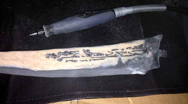

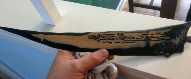

I've done some more sanding to get the shape I want and etched in the pattern with my dremel.

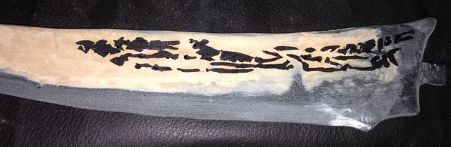

Marked the pattern with a sharpy:
Etched the pattern in to the blade:
More sanding this time with wet sand paper:
I put put on a little rub n buff which brings out the little flaws that I need to fix. I think it's looking OK so far.

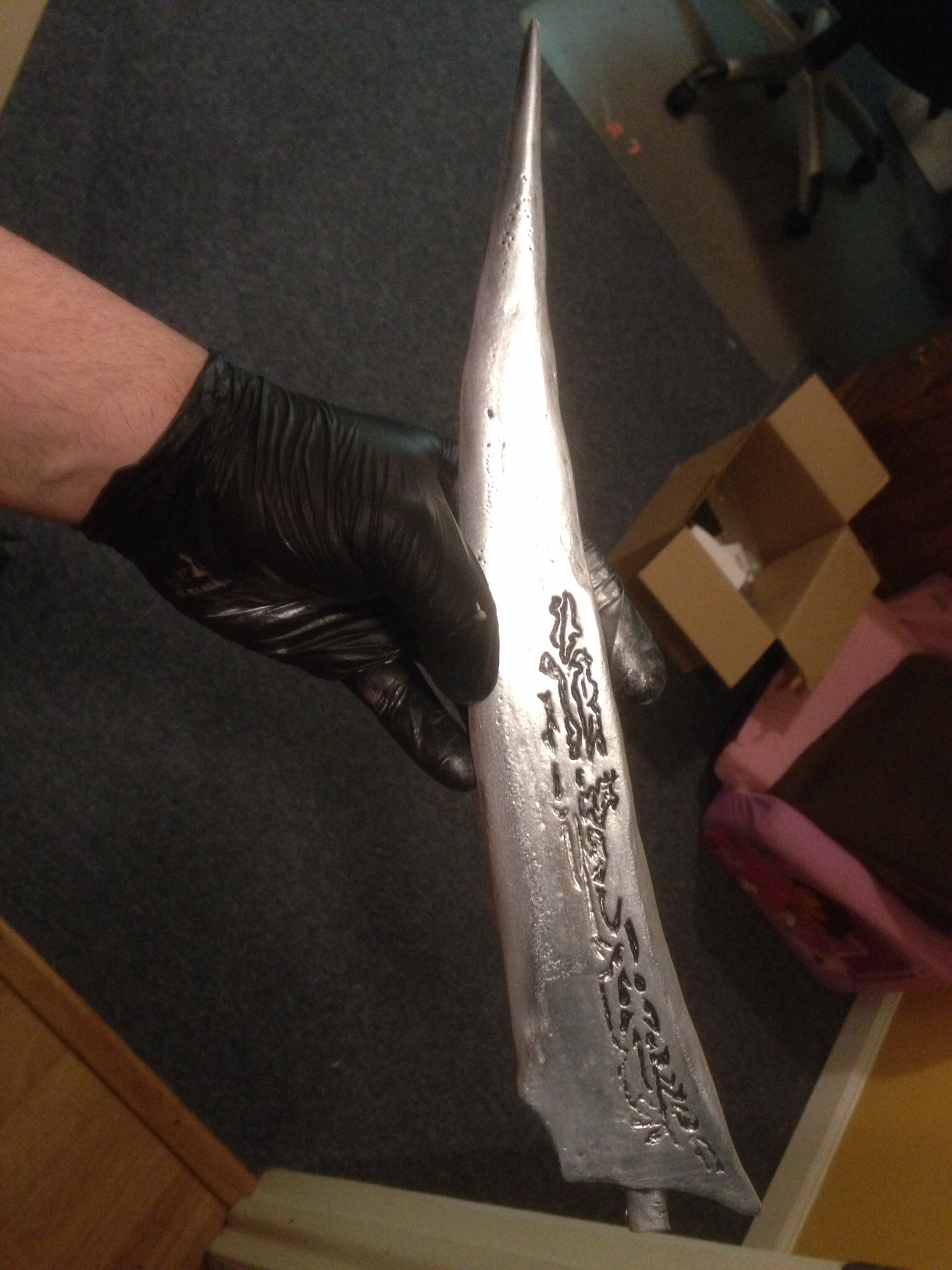

Well I am pretty much done with the blade now. I used some bondo glazing putty to fill in the tiny pin holes. After that cured I sanded it smooth and gave both sides of the blade a clear coat.
I've asked IronManiac to help with the handle. Once that's done I'll make a mold and bang out a few cold cast copies.
