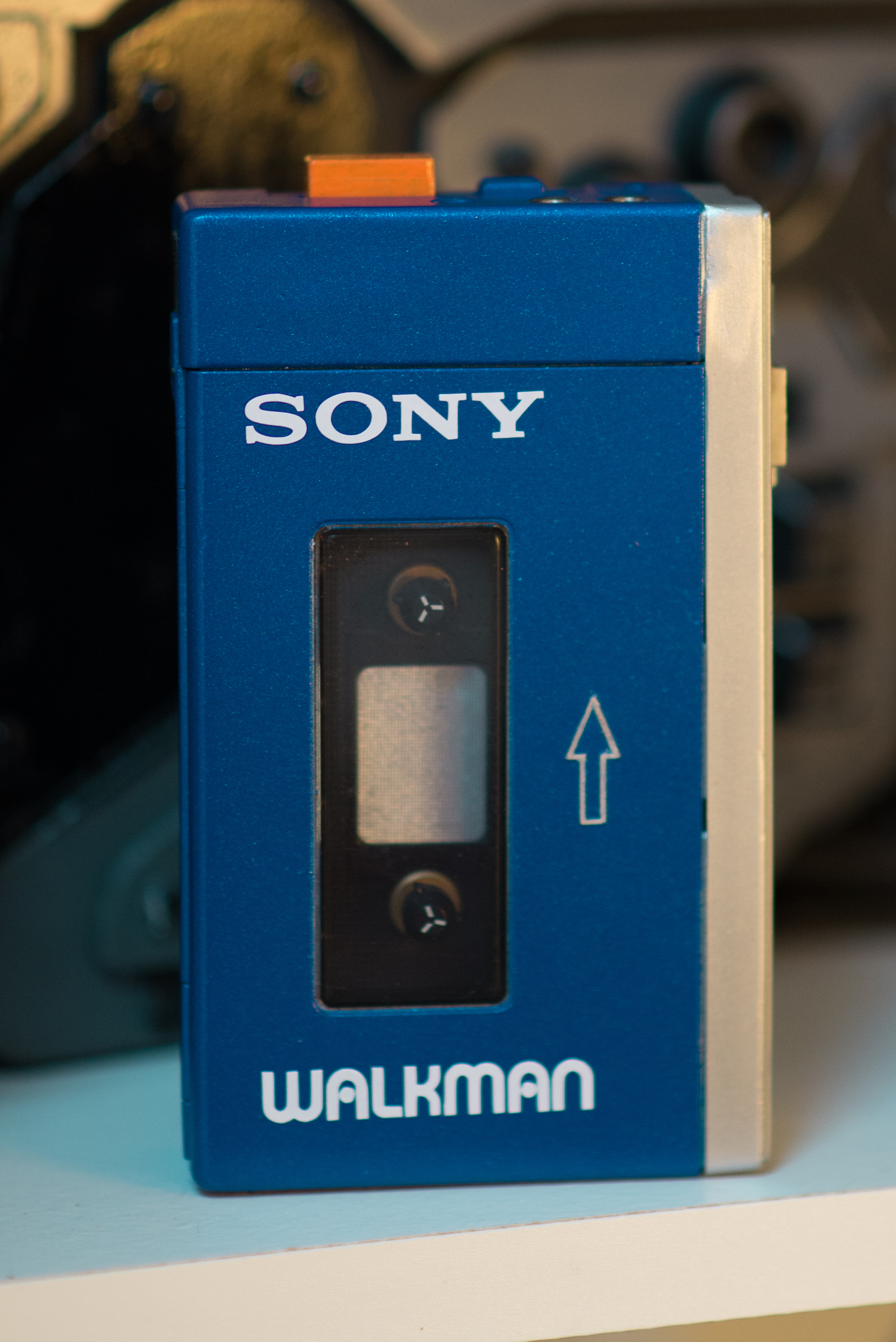

Walkman
Since the Walkmans are so expensive on Ebay I thought it would be fun to make my own and print. I'm new to 3D modeling so this is a big challenge for me. Again, I'm not going for 100% accuracy, but just something that looks good with my costume. I also thought it would be fun if I could fit my iPhone in there.
I'm far from done, but here is was I got so far:
So far pretty happy with it, and with three parts like that it should print well on my 3D printer. The big part and the side will be glued while the top will be a lid for the iPhone. Buttons will be printed separate.
That's what I got so far. I will post updated when I have some. And please, I would love all feedback, good as bad. Pointers, tips and tricks and so on!

Added a bit more of detail to the Walkman. Don't think I'll add much more since my printer wont be able to print that fine details anyways! Might have a go at printing it tomorrow!
The Walkman looks great! Most of the fine details look like they can be drawn on or etched in, so I think you'll be fine there. Really interested in seeing everything come together.
Would you mind sharing the files for the Walkman when you're done? I've been 3d printing my own helmet the last week, and I'd love to get that piece churned out, too.
I actually bought a real TSP-L2 on eBay yesterday. I will still print my own, because I want one that fits my iPhone! When I get my real one I will make a better model with real measurement. If I'm happy with the results I might share!
