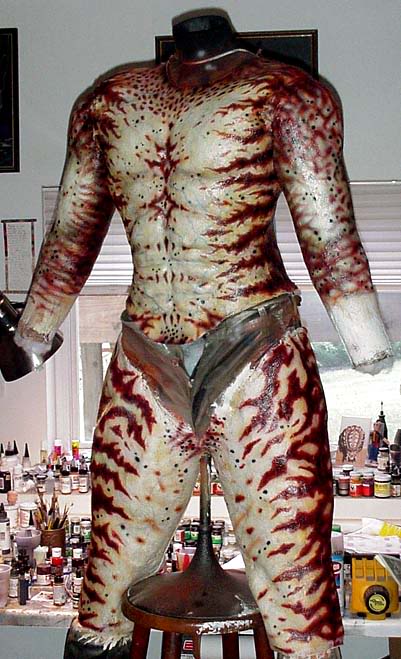

here is an example of method # 2

It would be like sewing a shirt together and it's not attached to an undersuit. and it takes patience to do it this way. best method i've found of eliminating the "seam" is to sew it in 3 key sections top front and back. leave the bottom or the underarm section open you will need to allow air into the suit.
if you look at the image you will see how both methods are applied. the top section of my suit is "sewn" together. The bottom section is actually attached to a pair of military cargo pants...an undersuit if you will.
