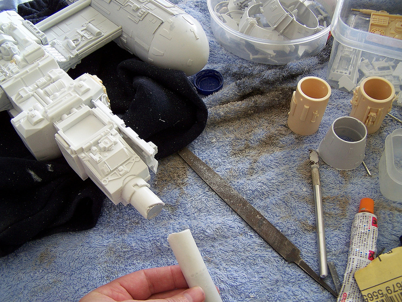

Lee you have put a jinx on me as i went to turn over my build and bam
Hey bud, cant view your pic, but i take it you have a bit of droop, its nothing to be ashamed of, i came out and just admitted it, there is help out there lol!
Bests...... Lee
Bests...... Lee
can you see it now, much worse than a droop. Man am i having trouble putting picks on here now.
Wow, ah no big deal buddy, follow my guide and itll be super fine, the 19mm ABS fits tight over that alloy nub, so cut it as i have, with a slot on the underside, it works great, better it happened now though eh? TBH, im quite glad it did happen, as its pretty unsalvageable once all bonded up!
lee
Right, I see. Gonna have to do this. Much as it scares the bejeezus outa me cutting that resin bit off (irrational fear of: what if the ABS don't fit...). Looks like a cool fix too for the other droop you mentioned, should it arise - with a different gauge ABS of course.
I see this stuff can withstand 180 degrees Fahrenheit. Should be OK then, but we're putting a load on it, which I guess it's not designed for..? Ok, I'm worrying too much. Just grab me by the collar and slap my face a few times and tell me there's nothing to be afraid of.
SLAAAAAP.......It'll be fine daaaaammmnnn youuuuuuu :lol. Seriously bud, it will be cool, yes, the ABS takes a lot to warp, it'll never get that warm Steve, and the weight isn't all that much TBH, the super snug fit is the winner, hence this tube is now integral on my model, bonded, and screwed up inside, making the cockpit removable, but a nice tight fit for peace of mind! Cutting the resin part off is super easy, i just made a few very light passes with the saw, just till i felt it rub the alloy, the resin was so soft, it just came away perfectly.

Lee, I've done the neck fix. Not only is the ABS a nice snug fit on the armature it's also just a much better fit inside the head than the resin was. Snug as bug in a rug, likes. Like you, I probably won't even ever glue it on, to ease with any storage/shipping probs in future. THANK YOU!
