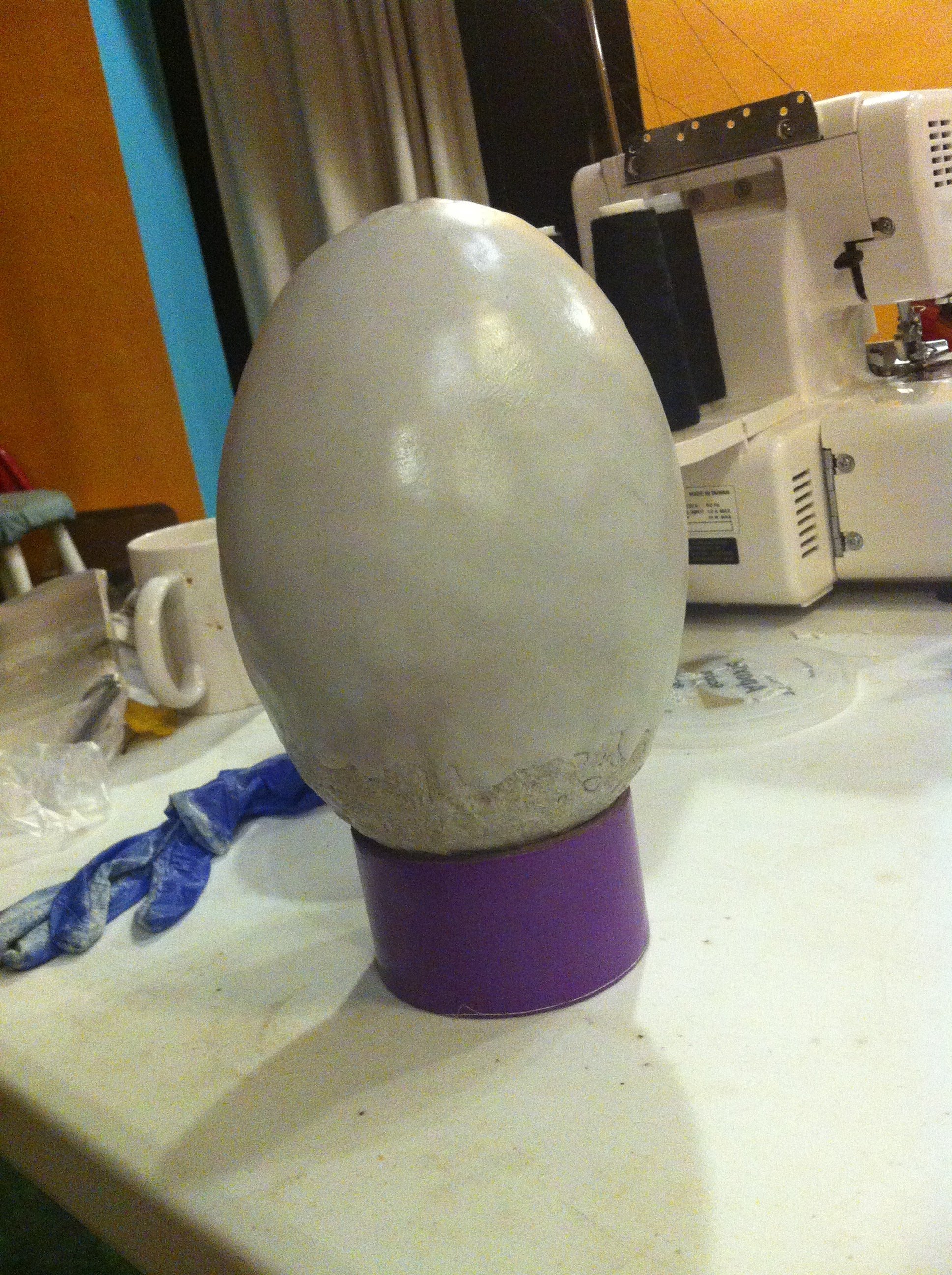

Then, I gave it a hard look, decided it sucked, and was the wrong shape to boot. I abandoned the project for a week in despair.
Picked it up later, decided it wasn't doomed and that all I had to do was widen the midsection to take it from ugly goose egg to rounder ostrich egg. I also started to figure out the AS a little better and went a little crazy smoothing it out. (Not sure why my pics are sideways or how to fix... any tips from more experienced users?)

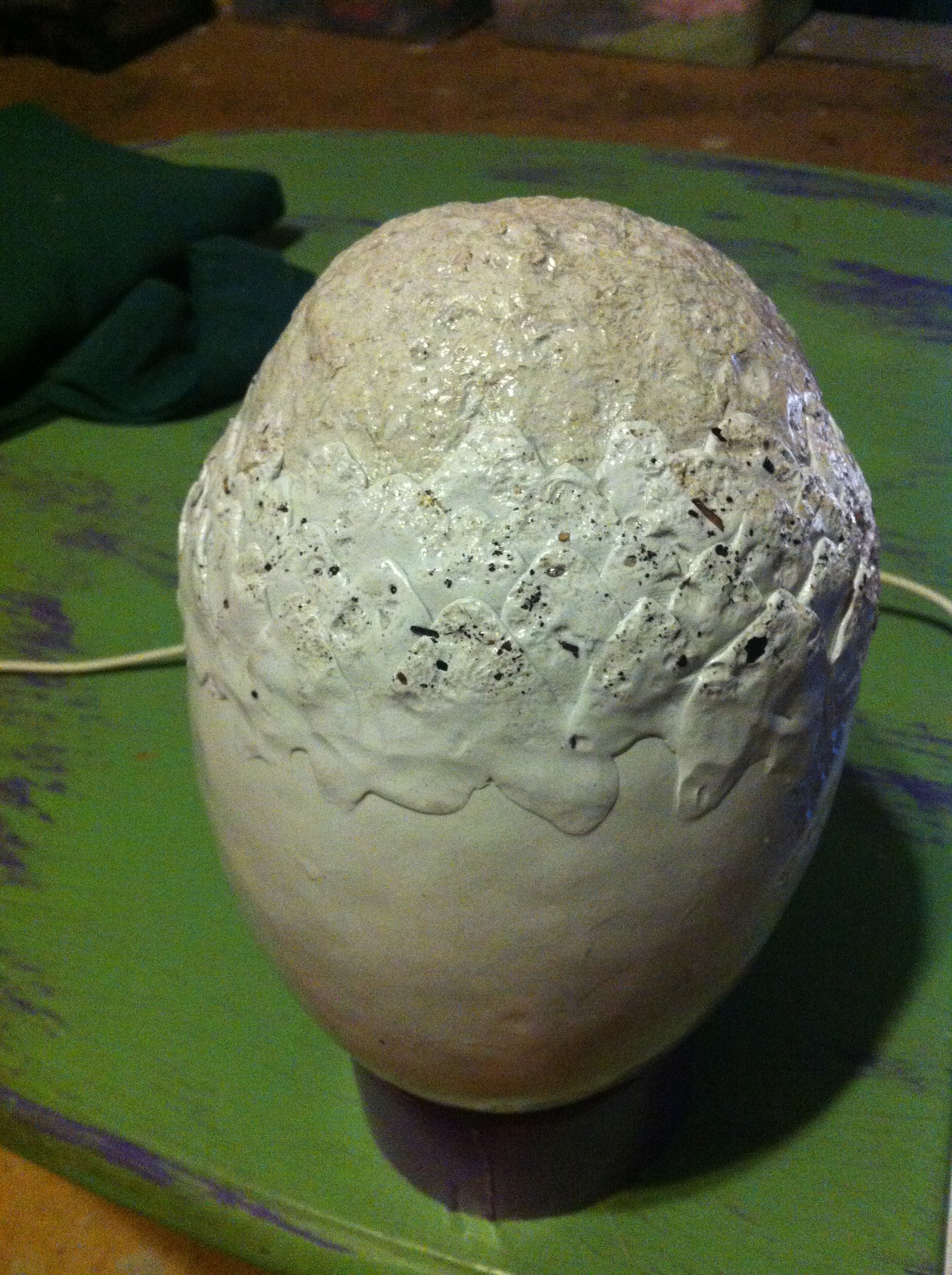

Then I set it down for another week, not looking forward to sculpting a million scales. And as I started, I once again did not think ahead. No grave consequences, fortunately, I just hadn't considered the fact that the first row of scales would set in stone the number of scales there would be per row, as well as dictate the approximate size of every scale until almost the top. I think I estimated fairly well though, fortunately.
Then I added a few more rows, and smooshed my hard work with some more texturing. In the show, the scales closest to the bottom appear to be fossilizing or blending into the rough texture, with some scales almost invisible. I tried to replicate that too. (I guess I got some dirt in the AS, but I would later dig some of that out or just paint over it)
If you have a keen eye, you've already spotted another major mistake I made. I made the whole base egg one smooth shape, without thinking about how the scales would add bulk. The first few rows of scales stick out a good bit wider than the bottom rough part does. In fact, I made the base pretty much the size and shape I wanted the final piece to be, meaning the final was larger than expected. A chronic issue of mine. I probably noticed this at the time I was making it, and after adding a few more rows of untextured scales...

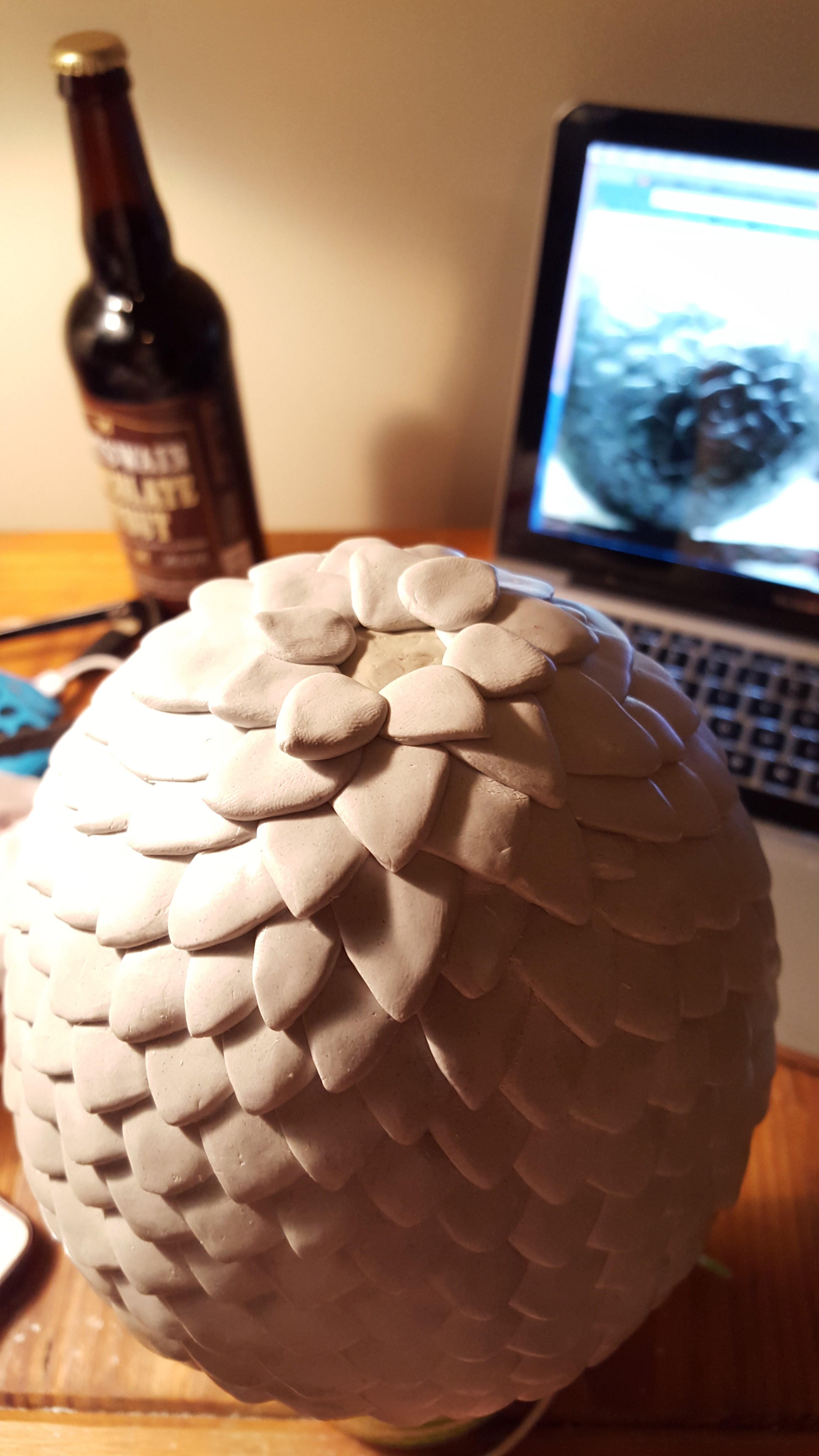

Of course I got distracted for another month, and then suddenly it was just a couple weeks before the con! I whipped off the last few rows of scales over the next couple weeks while apparently not sleeping ever.
But then I had to figure out how to start reducing the number of scales in the rows, or they would start to get really tiny, which they're not supposed to. I also had to figure out how to top it off. Honestly, I'm not sure what I did to accomplish this. I guess I started putting a few on at different angles, varying the size here and there, and just messing with the pattern til it looked right. I stared at reference images like this shot from the Game of Thrones Exhibition that I brightened up to try to show the detail better, and then gave it some artistic license because it was still really hard to see and there was no shot like this of the black egg anyway.

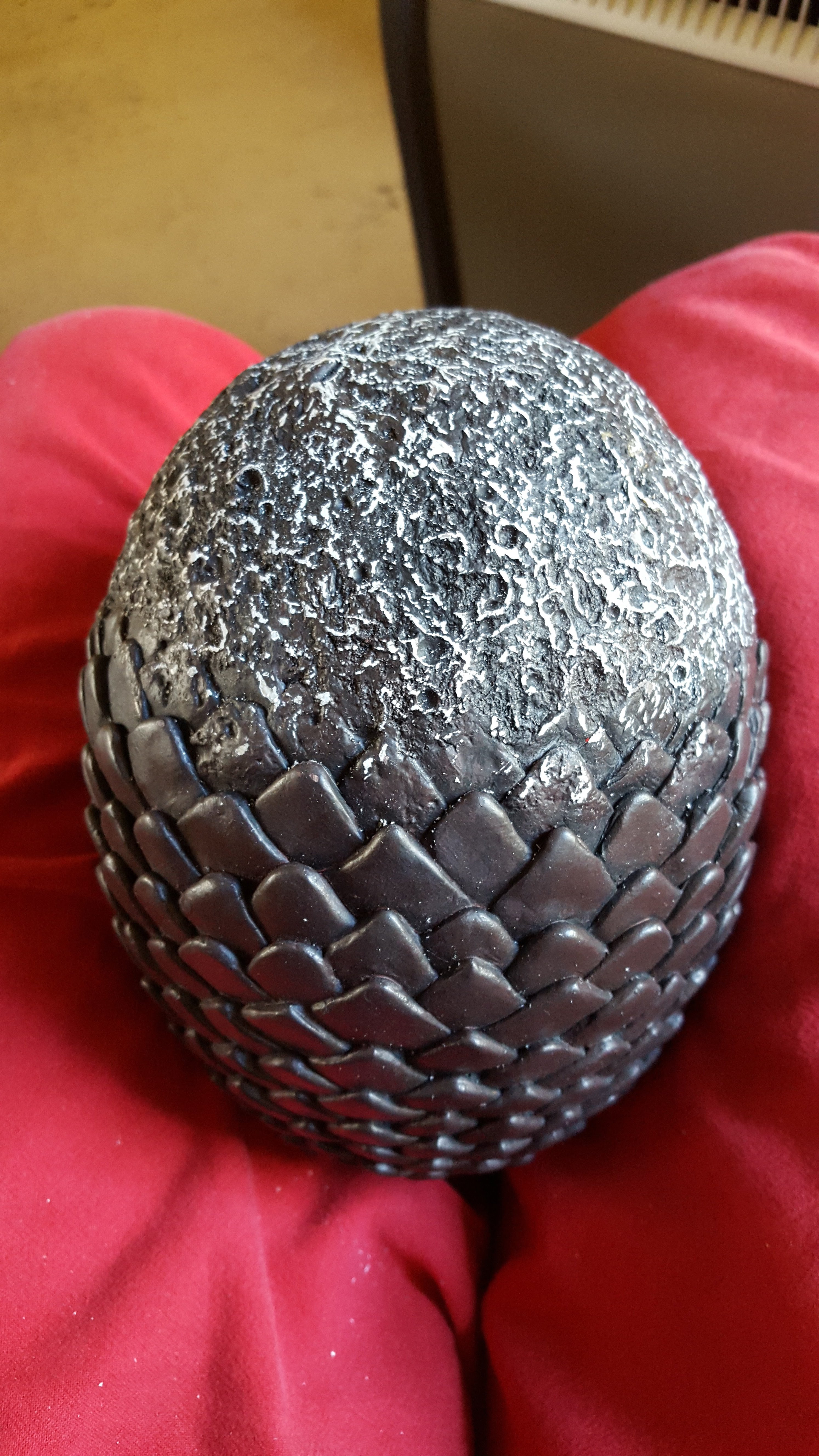

Then I started painting by hand. Painting isn't my thing, so it took some figuring out. It took forever just to do a base coat of black, making sure to get in every cranny of the "stone" part and every edge of every scale. If I just slopped a bunch of paint over it in with a big brush, I feared I would fill in all the gaps and lose the detail, so I used a small brush. Still dunno if that was the best method or not. I ended up sanding off the top black layer of paint off of the rough bottom, as the high points of that texture are lighter in the show.
Then I continued painting, adding red over the black. I spent a long time trying to figure out how to give it dimension with the red, until I realized that I was painting in really poor lighting. So when I brought it outside to see in natural light, it looked very different than it did inside. After all this, I realized that the eggs don't really look that vibrant or variegated in the show after all, and that the "black" egg was really a dark brown, or I suppose you could say black with red shining through.
So, I darkened it up some more, sprayed a clear coat to protect it, and brought it to the con! I'm pretty proud of how it turned out; after all the thoughtless errors I made along the way, I managed to fix them pretty well! Five months of on and off work produced this. Somewhere over 300 individually sculpted scales, hand painted, with a great weight to it.
