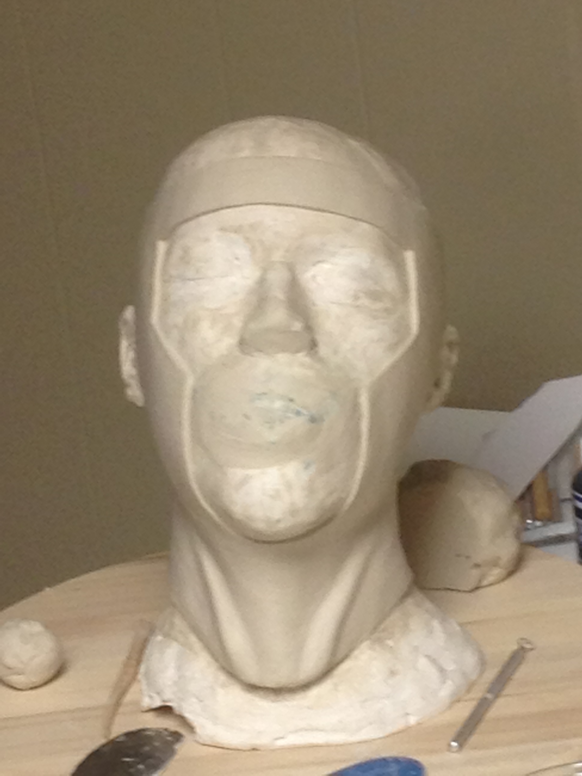

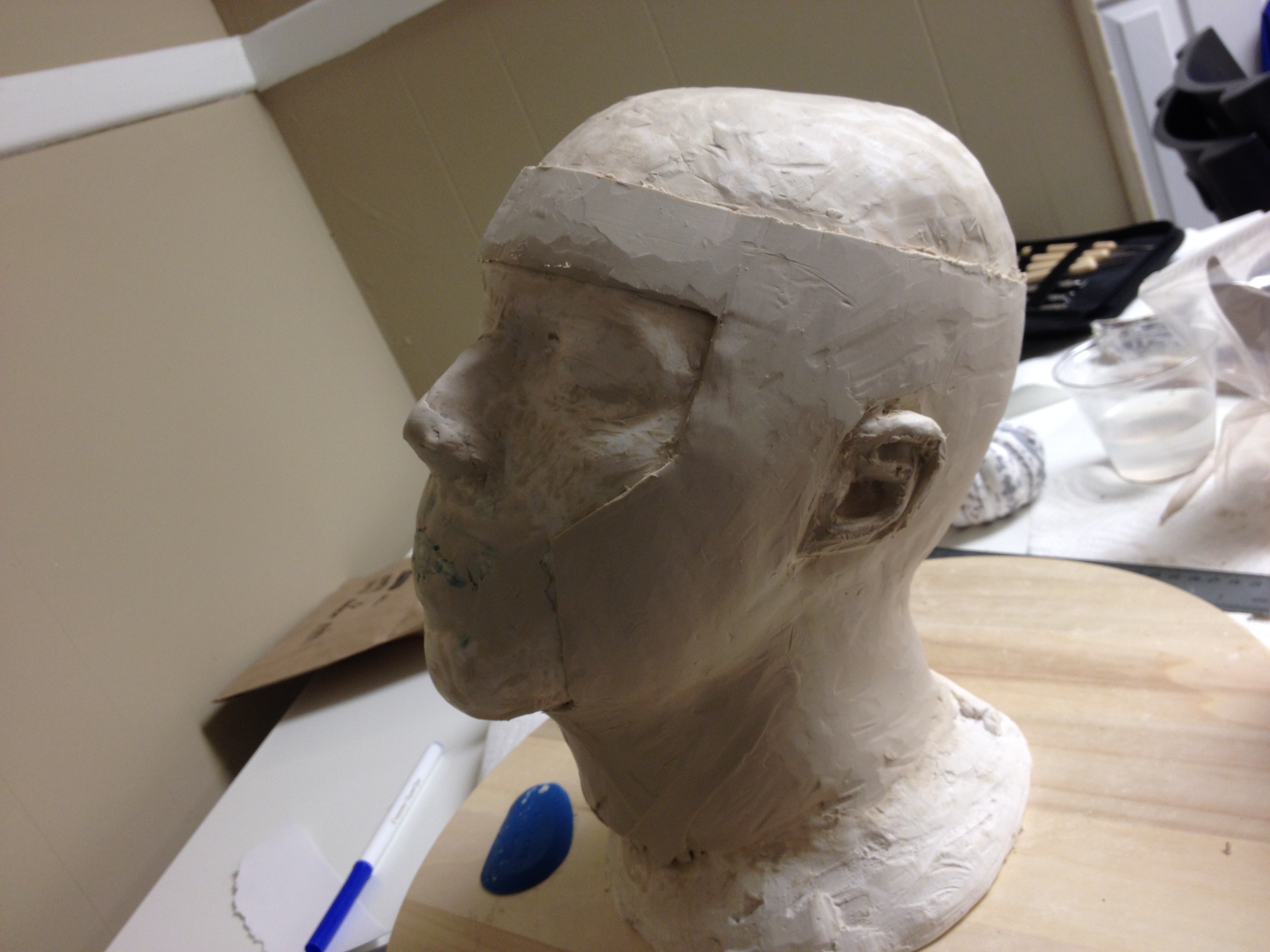

I am working on a big upgrade for my Gambit costume. After brainstorming numerous ideas for the various parts, I just decided I'd get the best results by sculpting and casting everything. I have started on the cowl first.
I need to sculpt the neck detail then even out and smooth everything. I may need to use a junk mold to make a resin master to sand smooth. I'll eventually be molding this and casting in urethane.

Finally something worth updating. I am nearly done with the cowl sculpt and have started on the chest armor sculpt.
Cowl sculpt

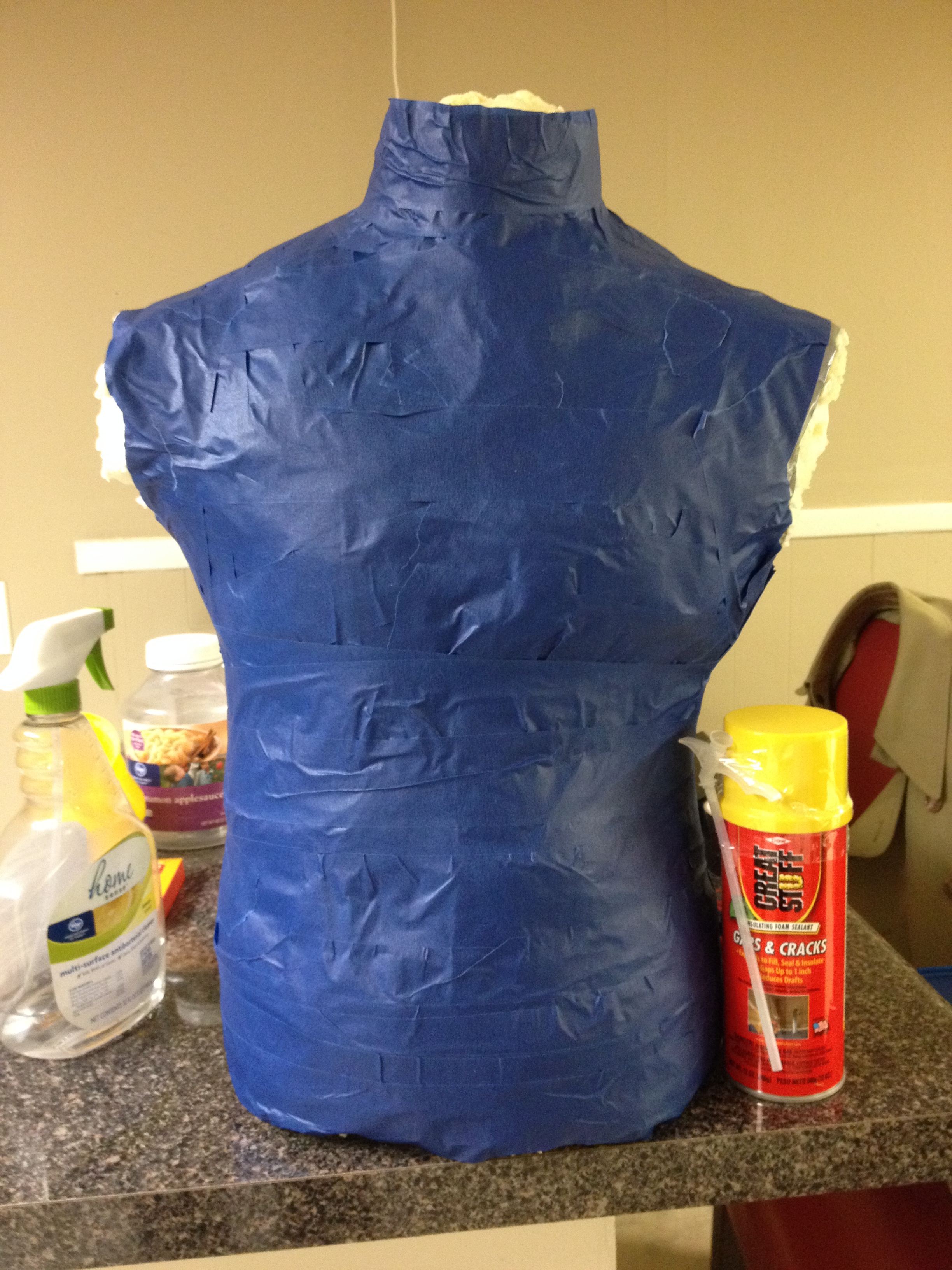

I started with a duct tape dummy torso. I put masking tape over this so I can just pull off the outer layer of tape to make it easier to clean up the clay from it after I mold the sculpt

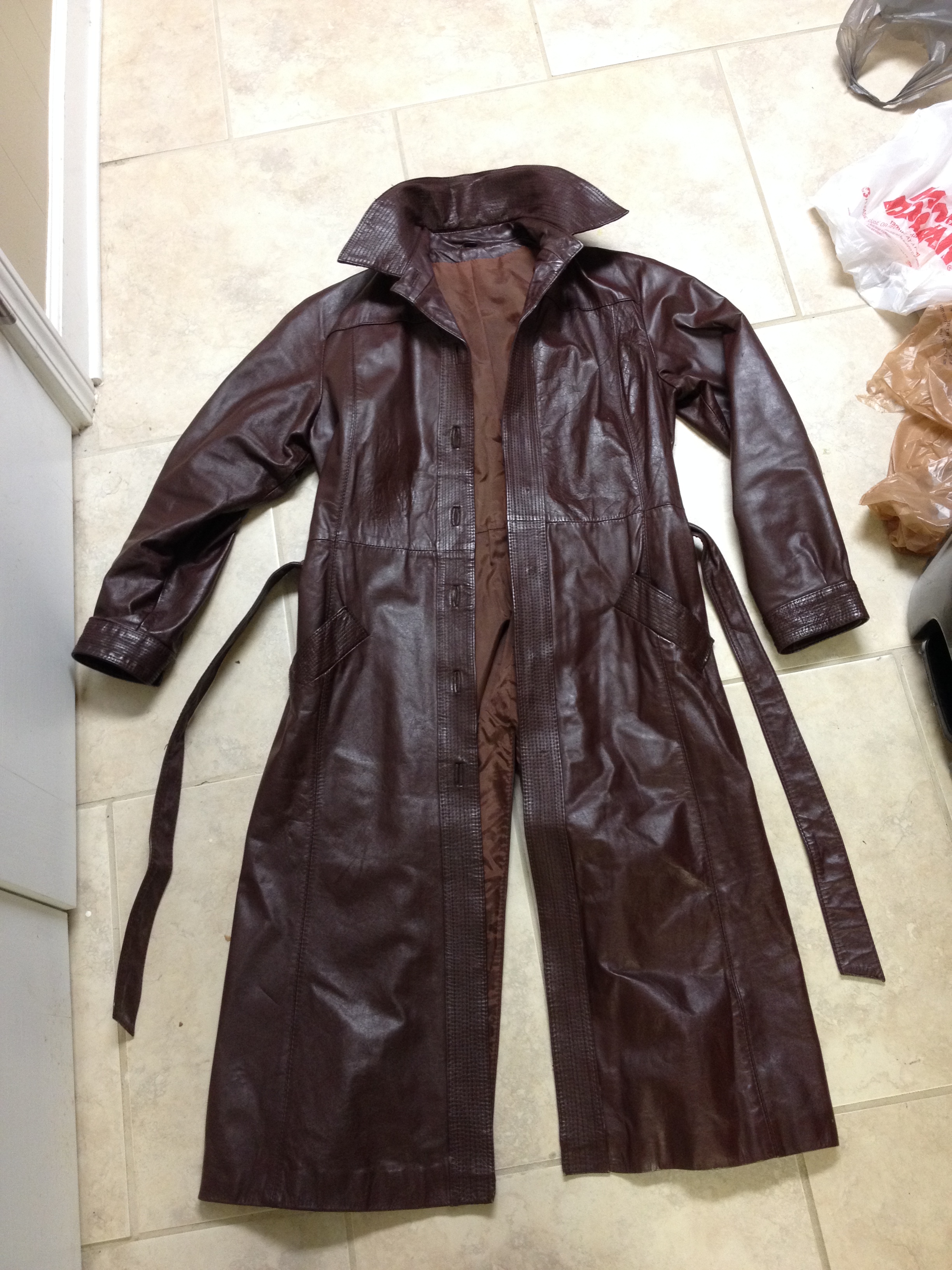

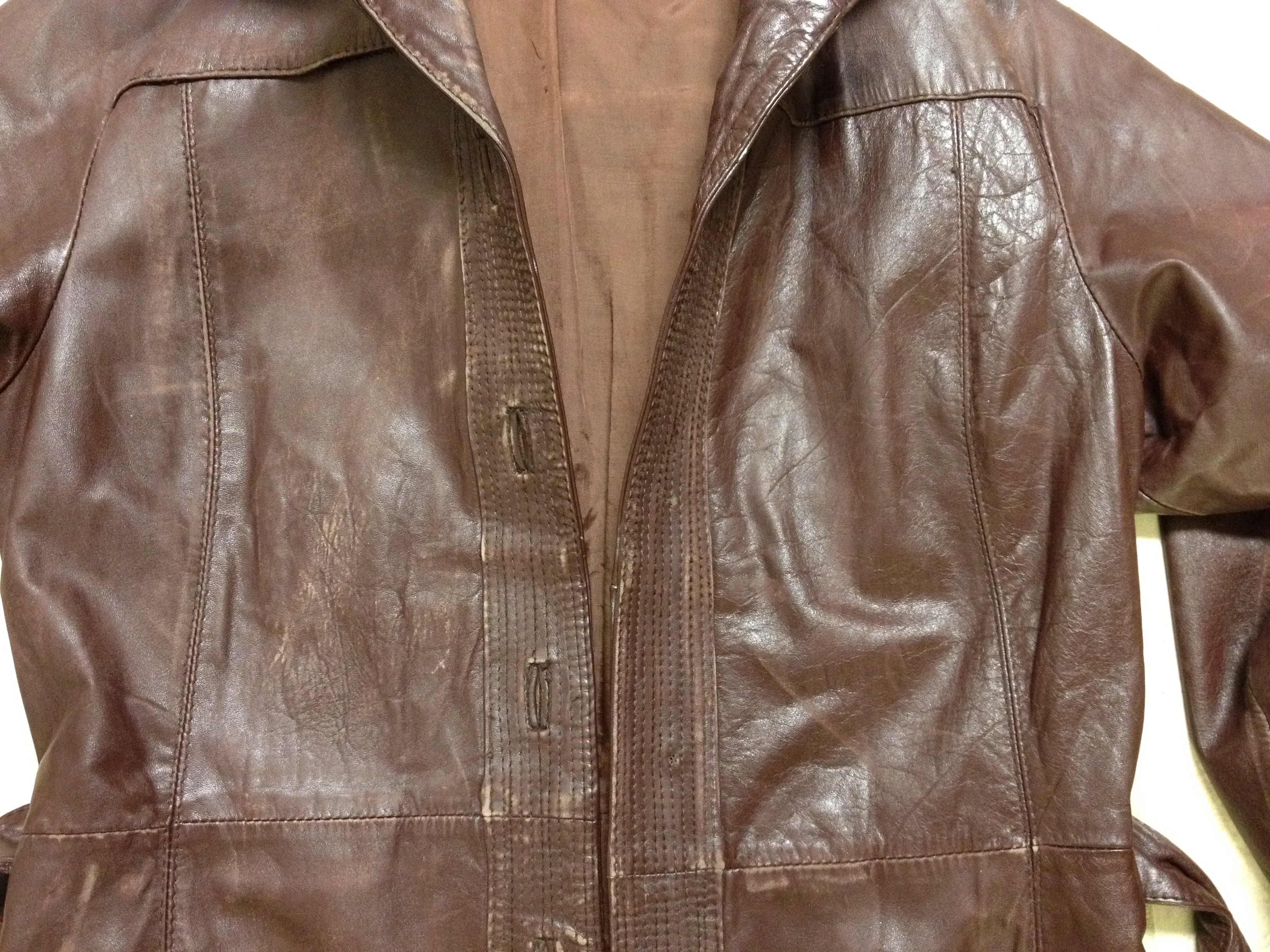

I forgot to post about my new jacket. I didn't originally plan to replace my original jacket, but I found this at a thrift store.
Despite being a thrift store item, this was relatively new feeling and looking. I started by removing the buttons as I would not be using them and didn't like they way they looked. Then i did some quick weathering with sandpaper.
