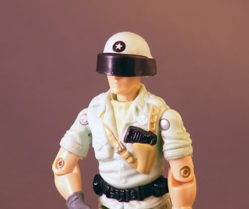

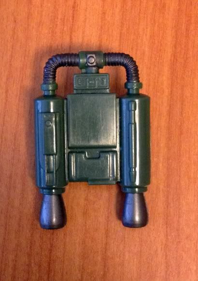

For those who may not know, Starduster is a rare G.I.Joe figure from 1987 and was offered as a mail-a-way from G.I.Joe Action Stars Cereal. The figure was a dedicated Jet Pack trooper using the J.U.M.P. jet pack that was originally offered in 1982. He looked like this:
Last year, I did a modern interpretation of him to fit in with the rest of the "Pursuit of Cobra" and 30th Anniversary toys. Which looked like this (with the original)...
I'm basing my costume on that figure as it fits with the newer movie style.

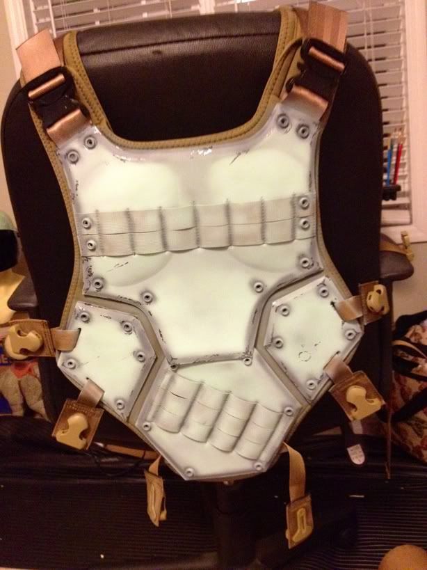

I started with an airsoft vest that was made to look like the NEST guys in Transformers 3, which you can find here. I bought the DE version so I could paint it easier.

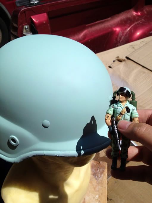

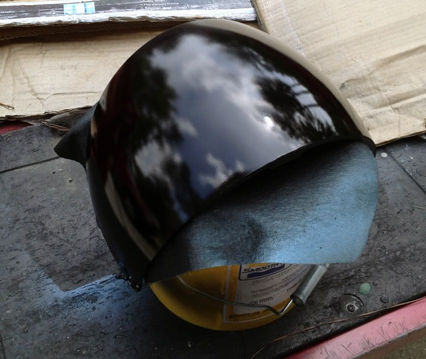

For the helmet I bought an airsoft Kevlar helmet that has a face shield and painted it to match the figure's color.
Then using a template I added the star and started clear coating. Unfortunately the clear coat ended up turning the color so i may repaint the helmet. If I do, I'm moving the star down some as well.

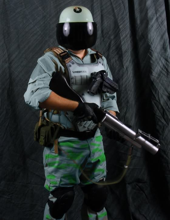

For the visor, I used the taillight tinting spray, Night Shades. 3 coats and it worked great. Does impair my vision, but not enough that I can't see.

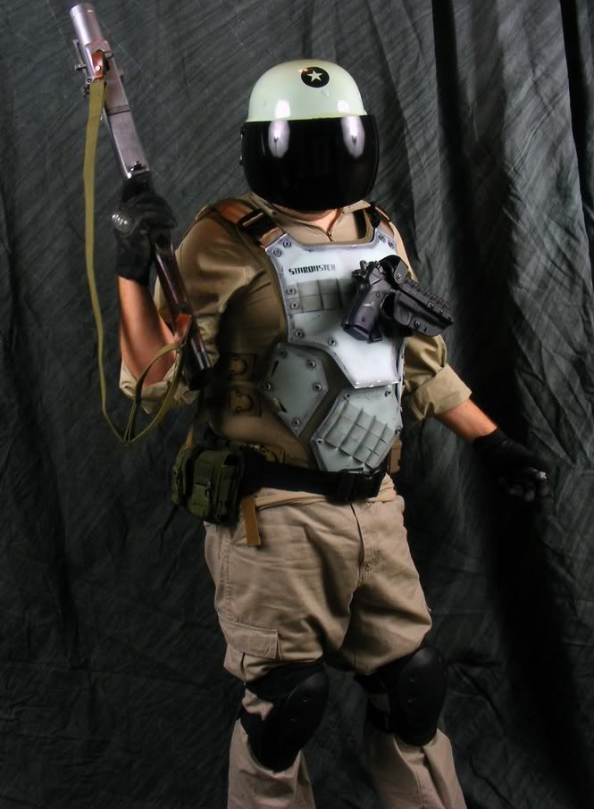

I painted the vest with the same color I mixed up for the helmet and then added some weathering. I also decided to add his code name on the breast, partly inspired by the big "R" on Roadblock's armor from Retaliation.
And so with some Blackhawk kneepads, Oakley tactical gloves, a molle blast belt with pouches for my 40mm grenades, a molle holster on my chest with an extremely cheap Barretta 92, a 511 tactical combat shirt an some cotton cargo pants from Wal-Mart, this is where I'm at....

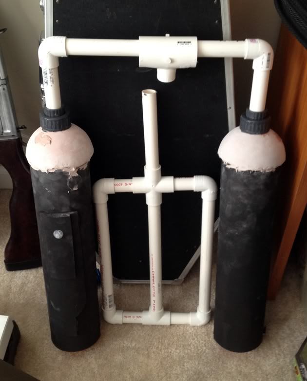

So, the pics I do have are a little outdated, as I started to change it up some already. But here's how I first went with it...

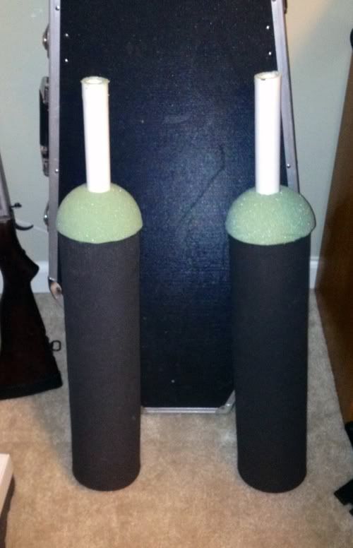

Using the 1:18th Jet Pack I took some measurements and loosely scaled it up.
I then took a swimming pool noodle thing and rammed a PVC pipe up the center for the fuel tanks. I wrapped it in two layers of foam and used a floral arrangement half sphere as the top of the fuel tank.
I then started to bondo the hell out of those floral spheres to strengthen them. I used PVC pipe to build a frame that would be inside as support. The PVC connected to the tanks using a coupler that I think is for sprinkler systems.
I decided the floral spheres were too large and bulbous for the tops of the tanks, so I've removed them and am working on something different for now. I may end up sculpting and casting the tops.
But for the frame, I added nylon straps with clips on the end that ended up coming off of my vest. And the hose is from an old beat up shopvac.
One of the selling points to me on the vest was not only did it look cool, but it already had clips attached on the back for adding backpacks or something. So, it worked perfectly in that it could also be a harness for the JUMP pack similar to what I'm using for my Jango.
The main body will be foam, like the wrapping on the tanks and will have holes in the back to allow the nylon straps to come through and attach to the vest. I'm likely going to plastic coat the foam to keep it rigid.

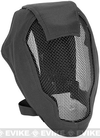

That mesh mask sounds pretty good for a Cobra Viper. You should also check out this if you haven't heard about it already!
