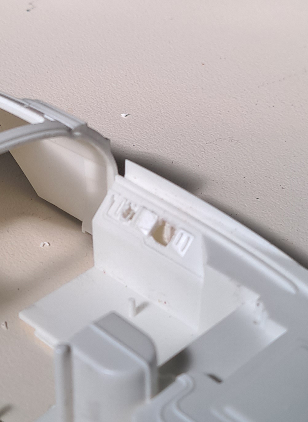

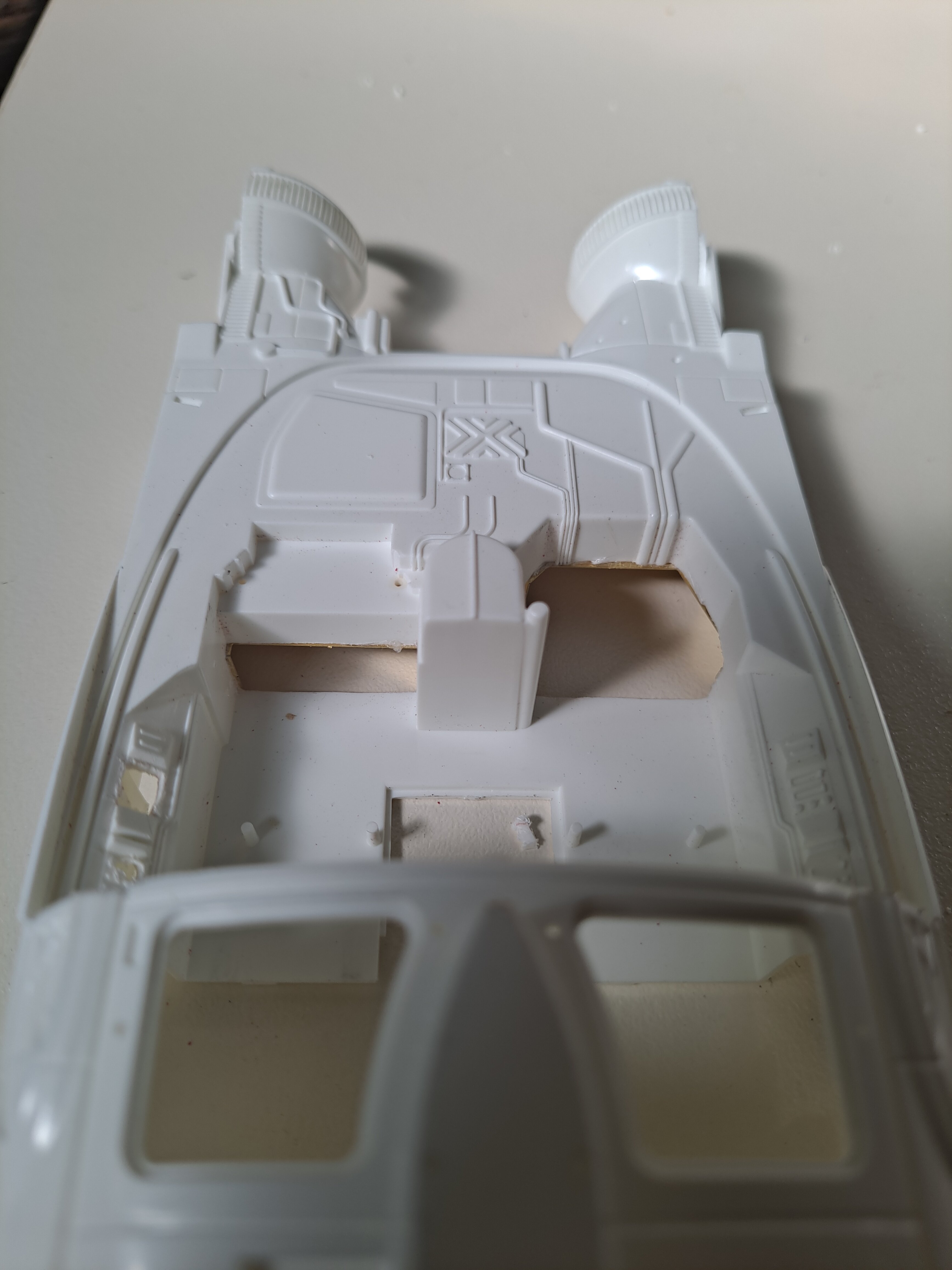

Here's how I spent my Saturday afternoon. There's 3 hours of work in here alone.
