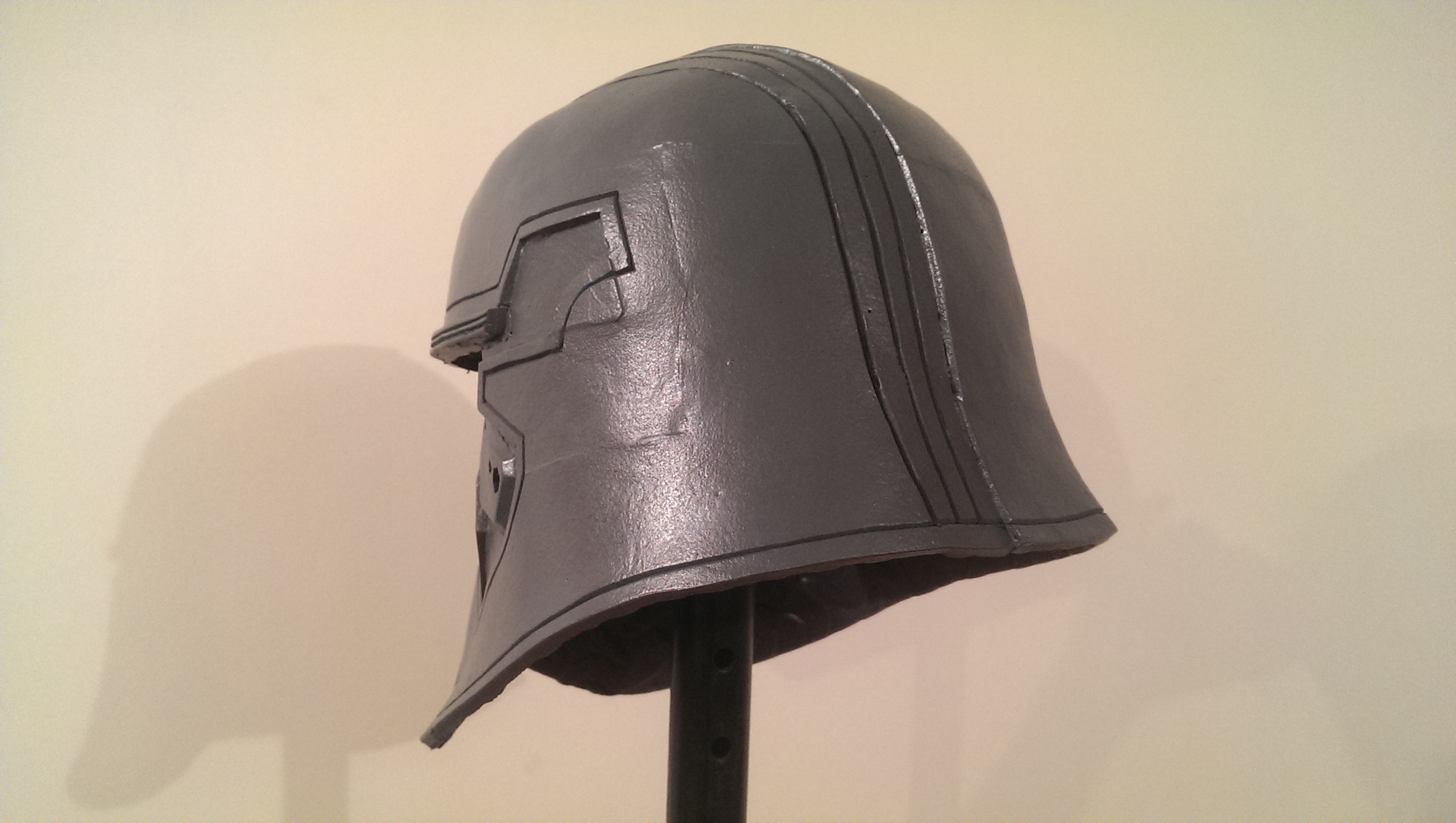

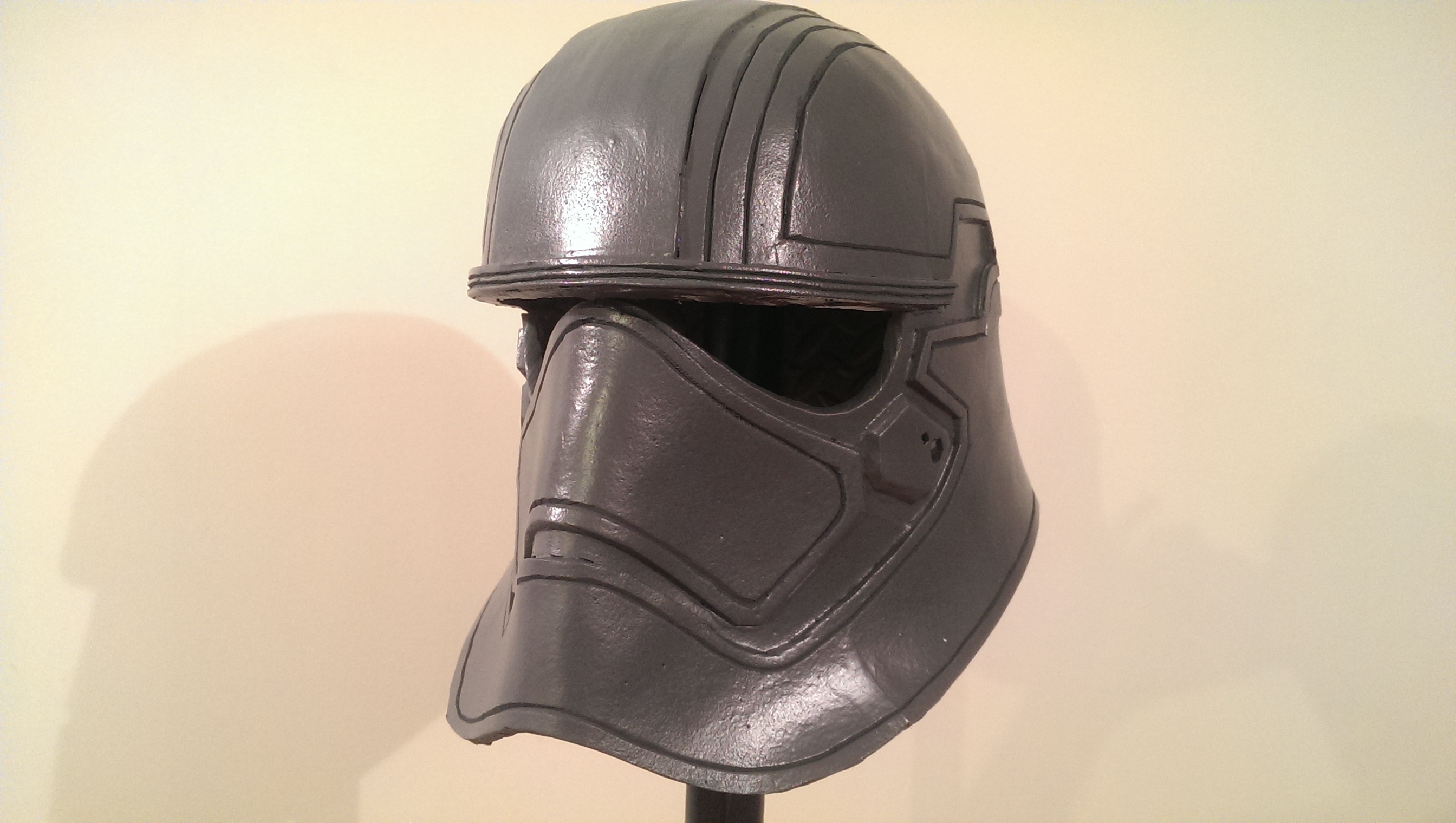

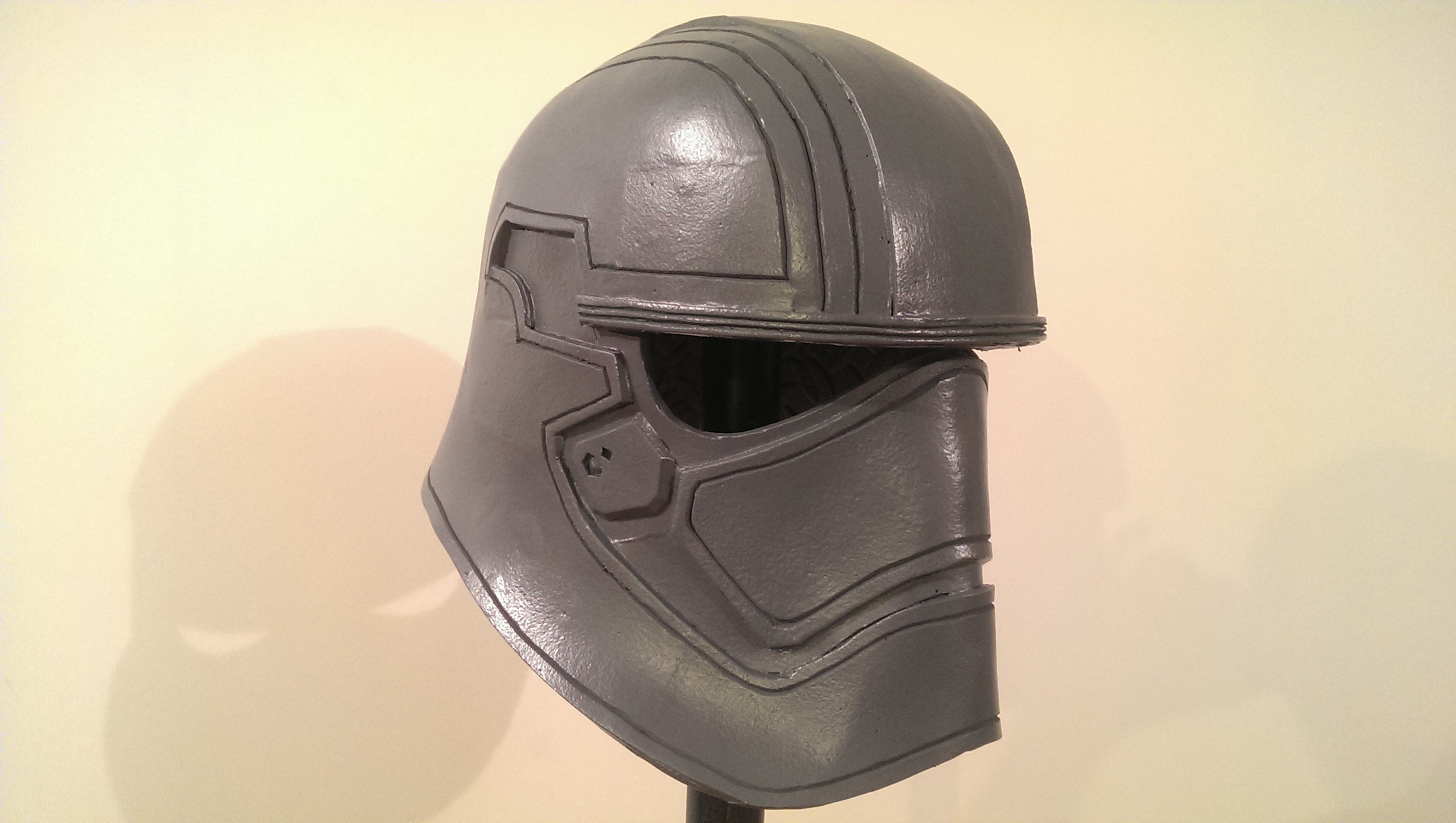

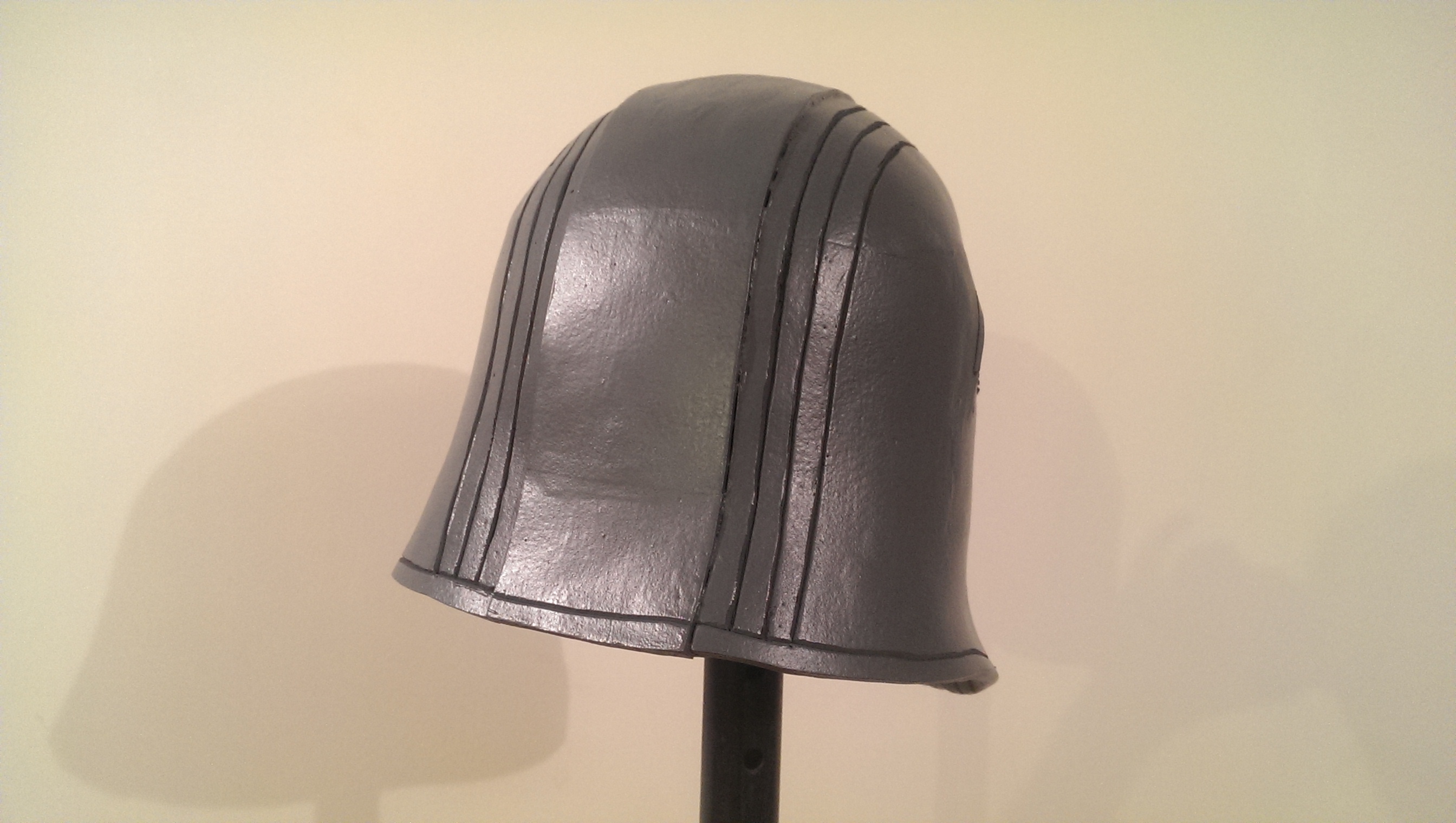

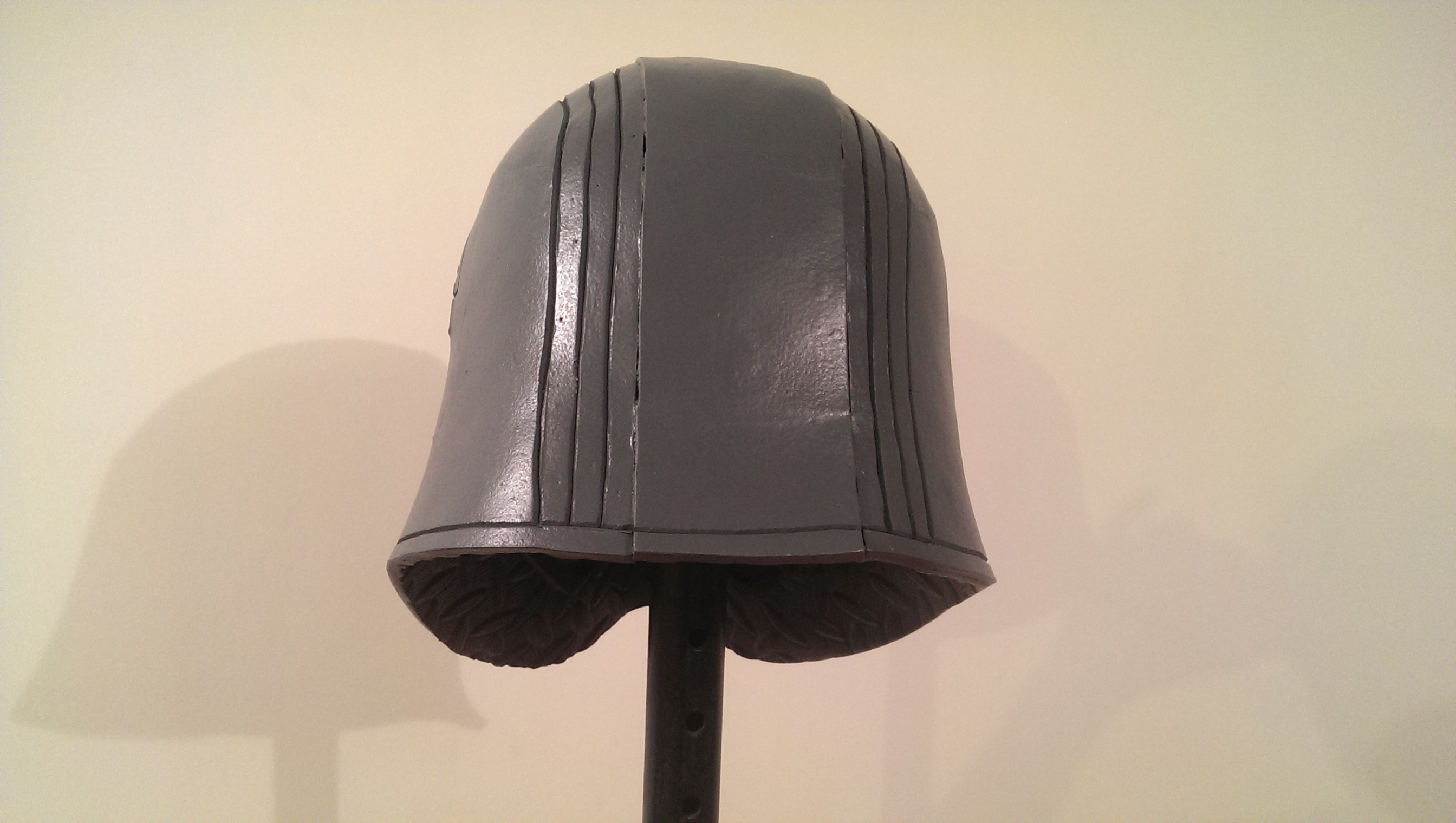

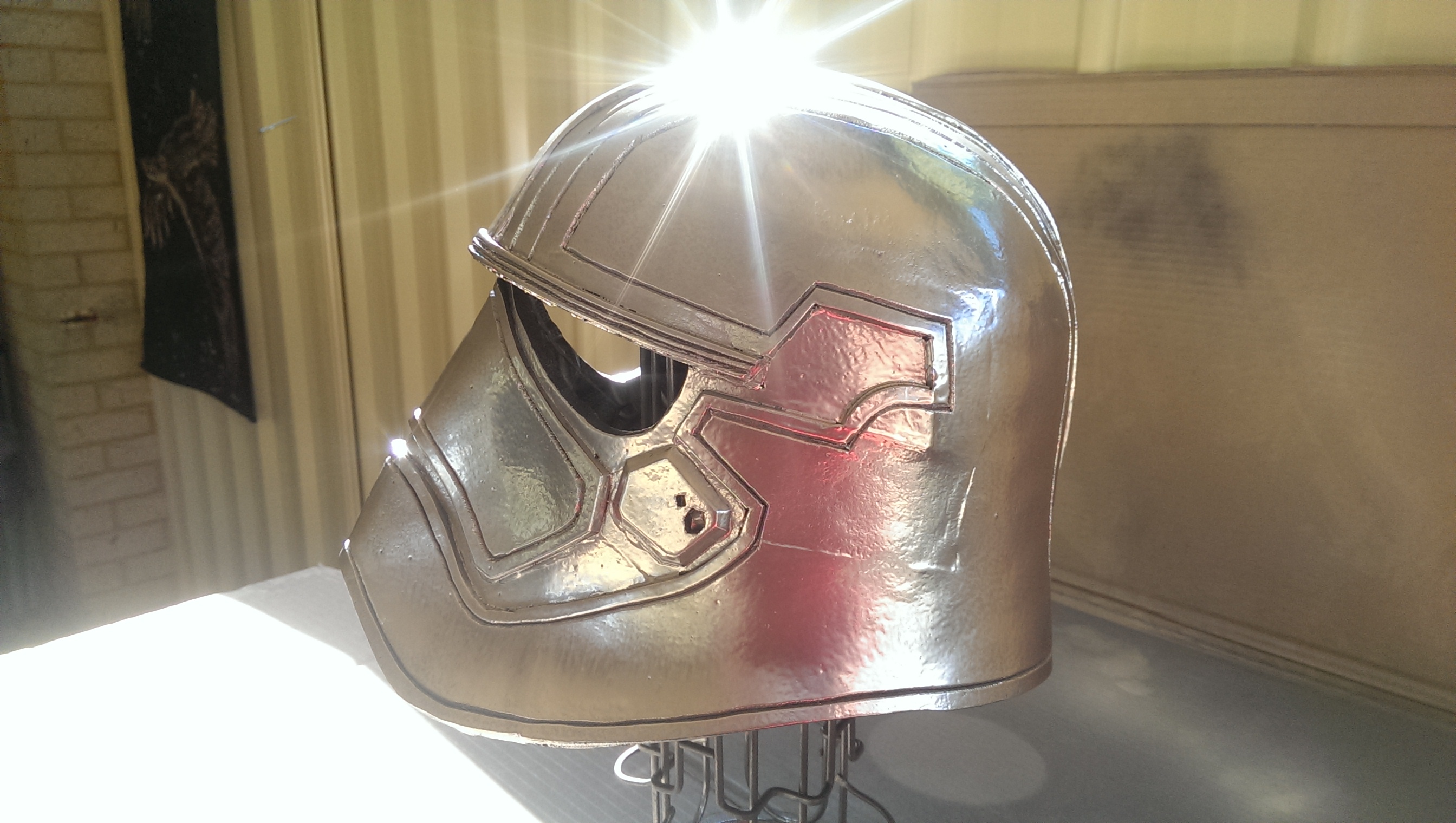

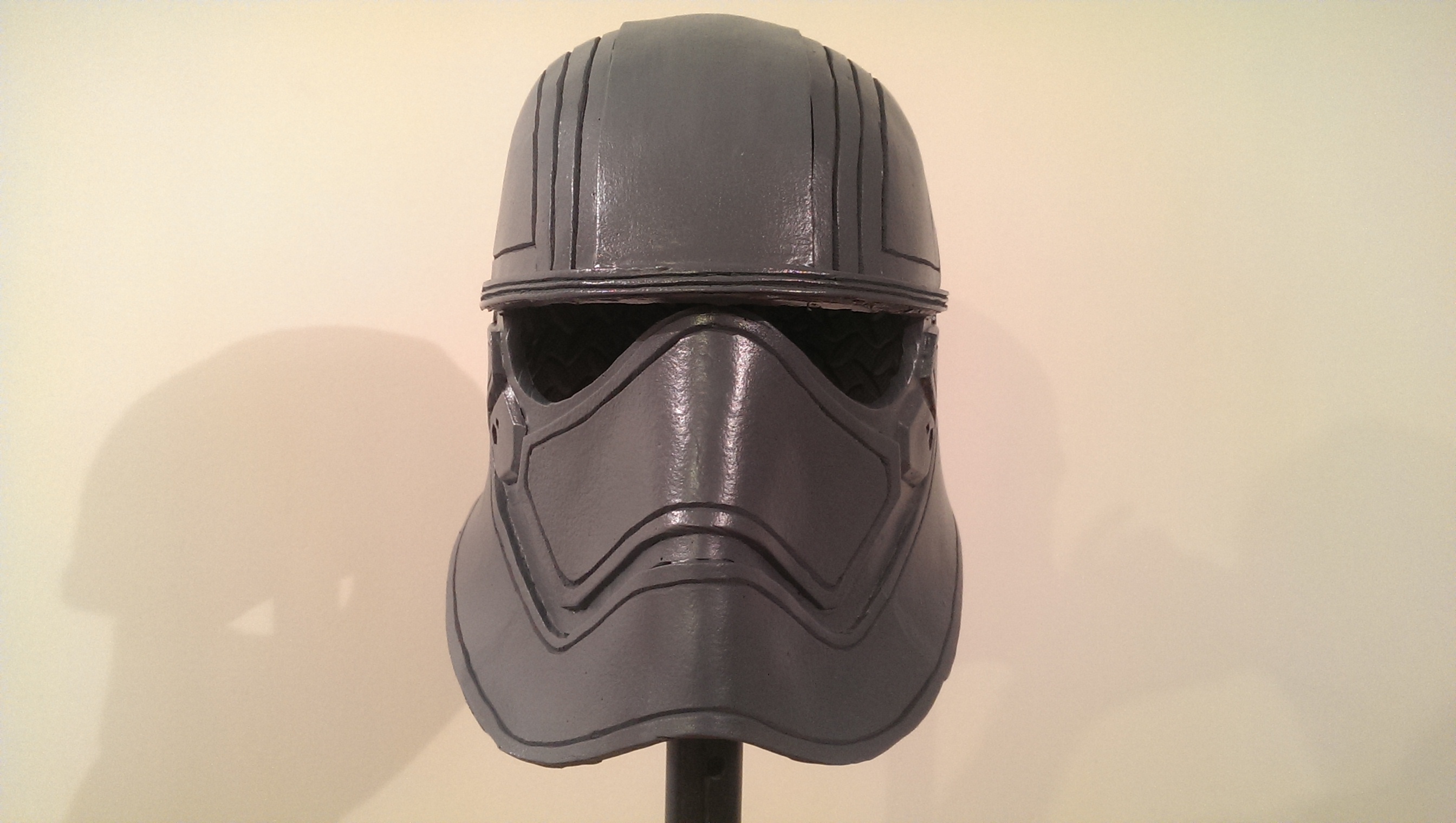

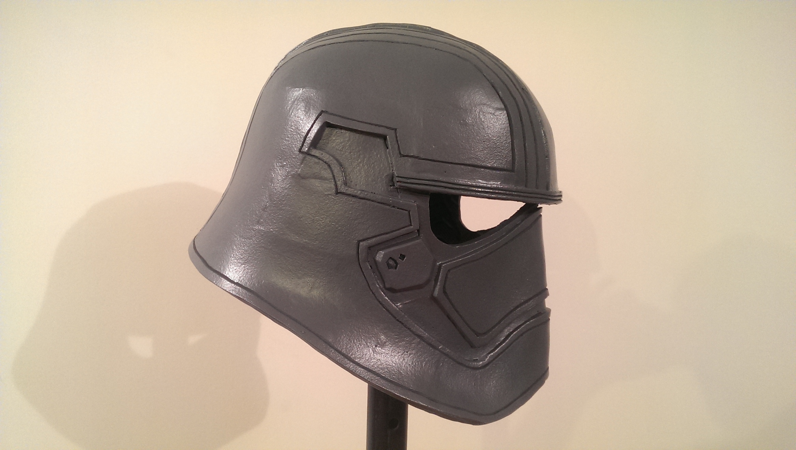

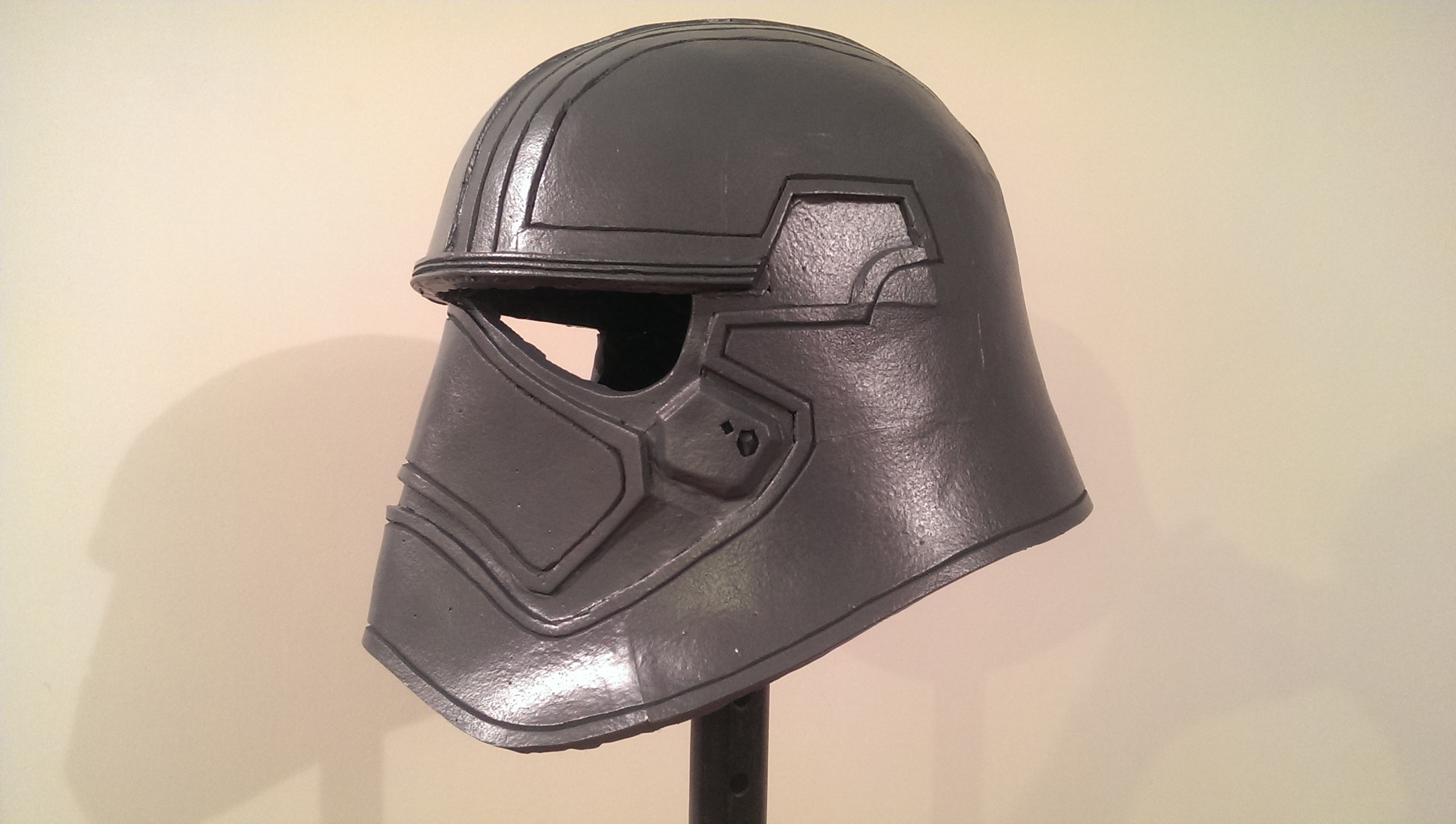

My progress so far using Rundown's unfold of Phasma's helm. I noticed the 1/4 arc at the rear of the temple recess deeper in the build and added it latter.
IMAG7239.jpgIMAG7240.jpgIMAG7241.jpgIMAG7242.jpgIMAG7243.jpgIMAG7244.jpgIMAG7245.jpgIMAG7246.jpgIMAG7311.jpg
View attachment 617543View attachment 617544View attachment 617545View attachment 617546View attachment 617547View attachment 617548View attachment 617549View attachment 617550View attachment 617551
What paint did you use? I'm almost finished will all the body work so now I'm testing paints and clears.

mmhnc I used a chrome paint, BUT unfortunately it has flaked off and was very fragile, so i have removed all the chrome and replaced with a silver. All paints were the Rust-Oleum brand.

@mmhnc I used a chrome paint, BUT unfortunately it has flaked off and was very fragile, so i have removed all the chrome and replaced with a silver. All paints were the Rust-Oleum brand.
What are your under layers, base/primer/etc?
For my cyberman I used Smooth-on Epsilon as my base coat (instead of PVA). Gives it an M&M shell with only three thin layers. Then about three layers of primer, sanding, and then a final thin layer of primer. Then rust-oleum chrome with metallic flek. Then floor polish as the various clear coats I tried washed off the metallic flek. Then a clear coat on top of the floor polish. The smoothon makes an awesome base for anything that doesn't need to flex. Takes bondo really well too.

Unfortunately i didnt harden my EVA foam and that was my undoing

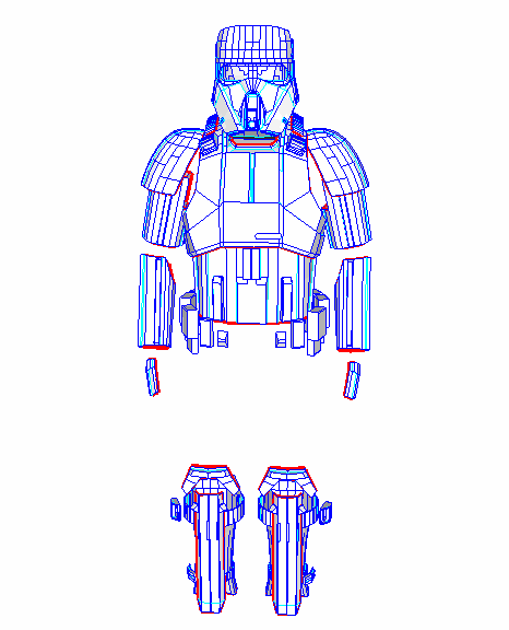

I'm done modeling! Now unfolding begins!
And well I don't really model everything. My workflow is that if anybody wants something they pay for my hours to model it. In the end I release the file for free.
All my work is mostly commissioned.
