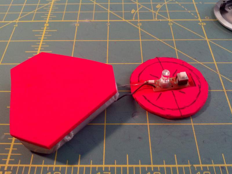

Picture-based description of my cheap repulsor, based on some of the wisdom learned from JFcustom's $2 arc reactor: http://www.therpf.com/f24/inexpensive-5-days-built-foam-iron-man-147915/ THANKS!
Bottom is the LED light, top is the (semi) finished product:

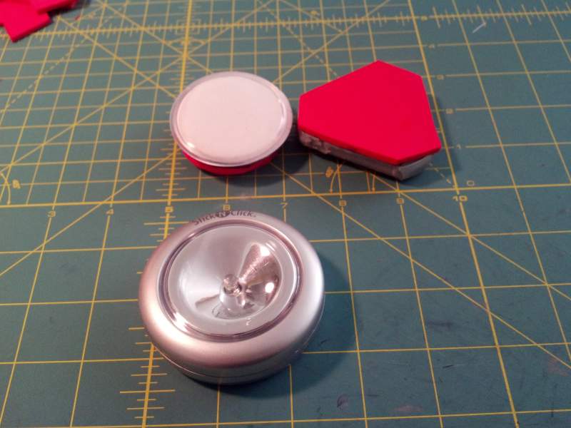

Bottom, the underside of the light. Top: I Dremel-ed off the edges of the round light to make a triangular battery back. I dismantled the rest of the light and set it aside (with some pieces I will use in a sec). I call attention to the little green circuit board in the center, attached by wires. This board houses the LED and switch.
This pic shows my foam cover for the battery case, and the LED/Switch resting on another foam piece, Dremel-ed out in the center to provide some space:
Now I place another 3mm foam piece in as a "spacer"
This shows the spacer on, and the "reflector" and other assembly parts fitting overtop the LED:
I am just using a simple paper to diffuse the LED light, but I will likely use vellum and maybe tint it blue in the future:
Finished product!

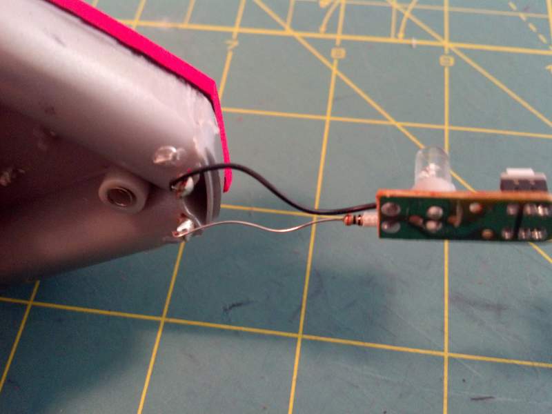

I am a noob, but I know that this is not a practical set up. the problem is that the wires are too short:
Add wire..
Works!

I need more wisdom from you all. Please help if you can.
- Is that the right wire to use? I just picked out one covered in plastic and one that was not. I tried to match the original wire.
- Am I going to short out and burn myself?
- I just stripped, wound and crimped the connections, should I find my solder gun and solder the connections, or will the crimp work long term?
- How should I protect the wires? I plan on running them to the back of the hand, and hiding the batteries under the wrist plate. I was thinking just electrical tape, but is there a better way?
rensole
ok the basics:
1) burn yourself? lol you might feel a little bit of a sting (like a bugbite) if the cable's iron parts touch your skin nothing more ;)
2) you should solder it and THEN shrinkwrap it, wrapping it on its own wont work long term.
3) get/use flexible wires, and then use shrinkwrap (this is how i protect my suits electronics) then some extra electrical tape. under the wrist plate aint a bad ideah tbh

@rensole, thanks a ton! I googled shrink wrap wires and watched some demos, and I learned a lot. I appreciate the guidance.

I did exactly the same thing with my hand repulsors (see post #6 of my build thread below on page 1). I would highly recommend shrink wrapping the terminations at the LED and battery case end, and also encasing these joints in hot glue. The solder joints will come off very easily otherwise. The wire youve used will be fine, but any two core wire will probably do the job. I just used cheap speaker cable. You might also find that once you have built the gloves up, that pressing your fingers into the palm of your hand is hard to do and stresses the gloves. You might want to consider an alternative switch design ;)
