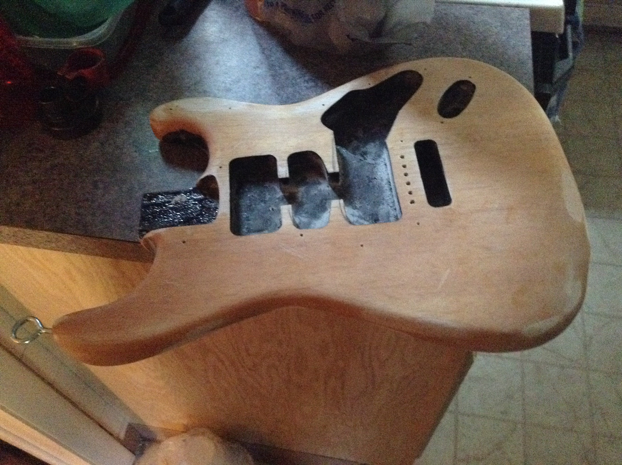

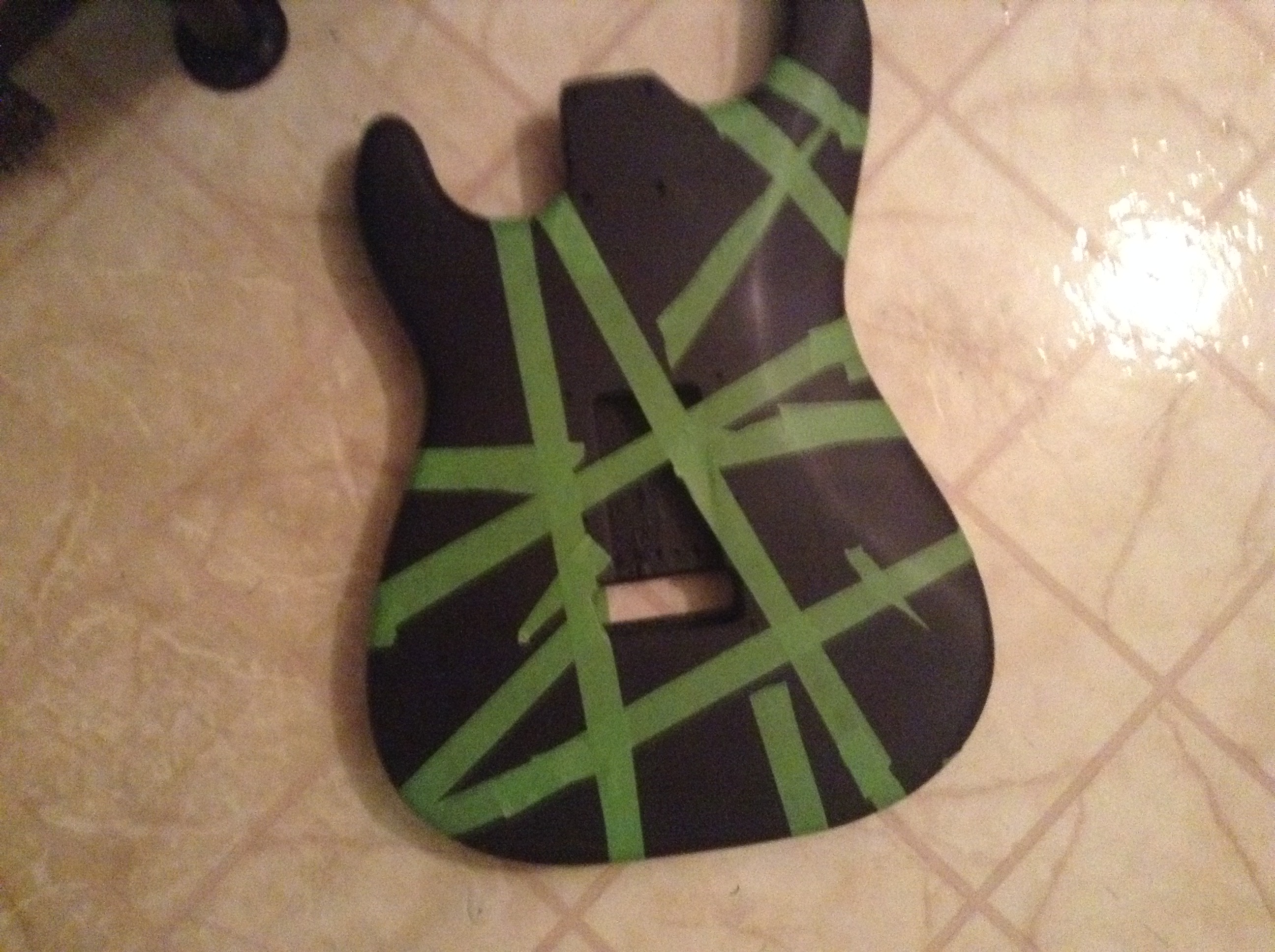

I started with an old squier body that I had purchased from a guy who made a parts guitar. I sanded the finish and paint off and got a nice clean base. I did a test fit of the eye hook strap hooks too.

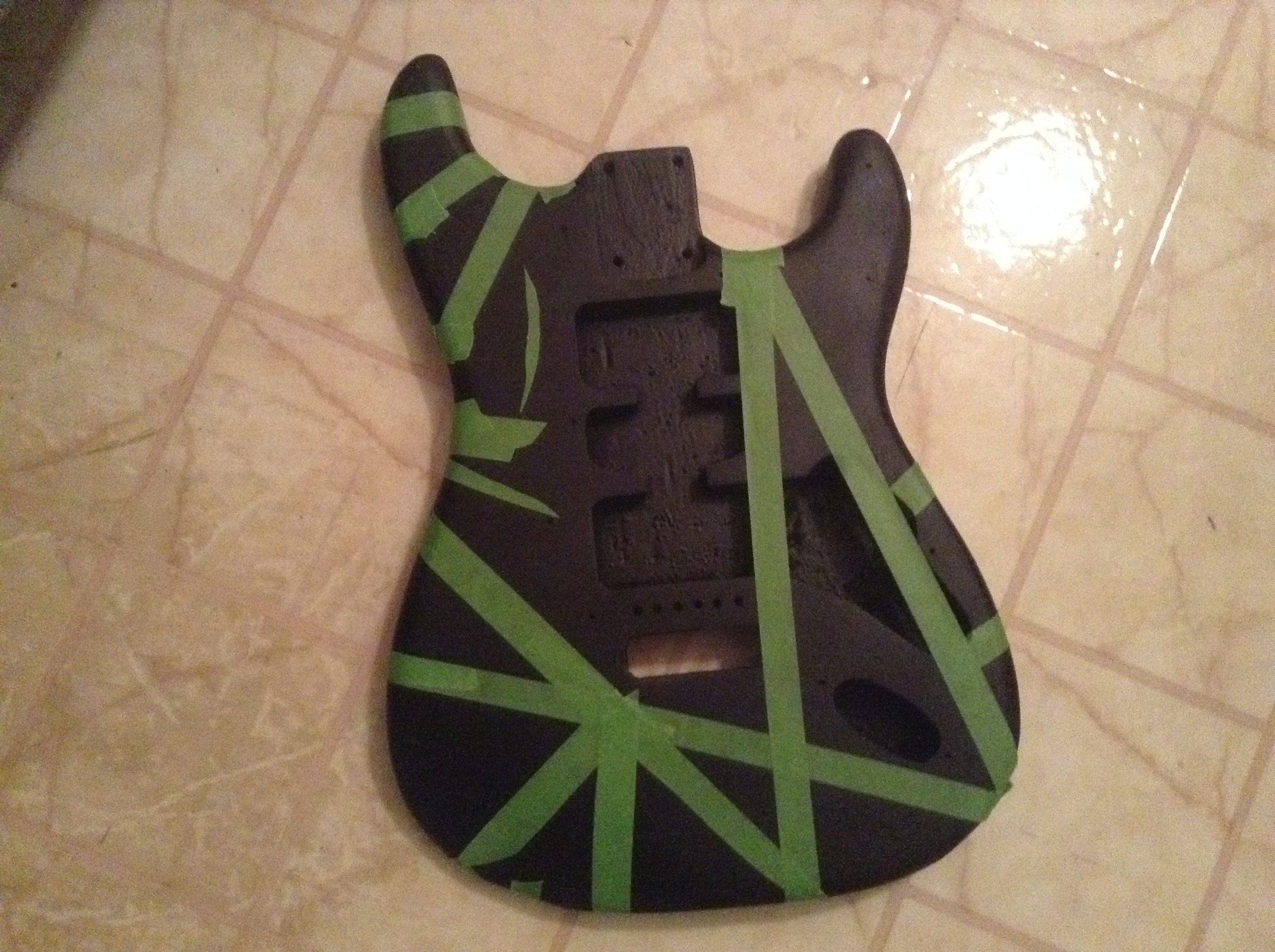

Then I did 3 coats of black spray paint and taped it up! I didn't worry too much about getting it exactly right, I added my own personal taste to it and just did it in like 20 minutes.

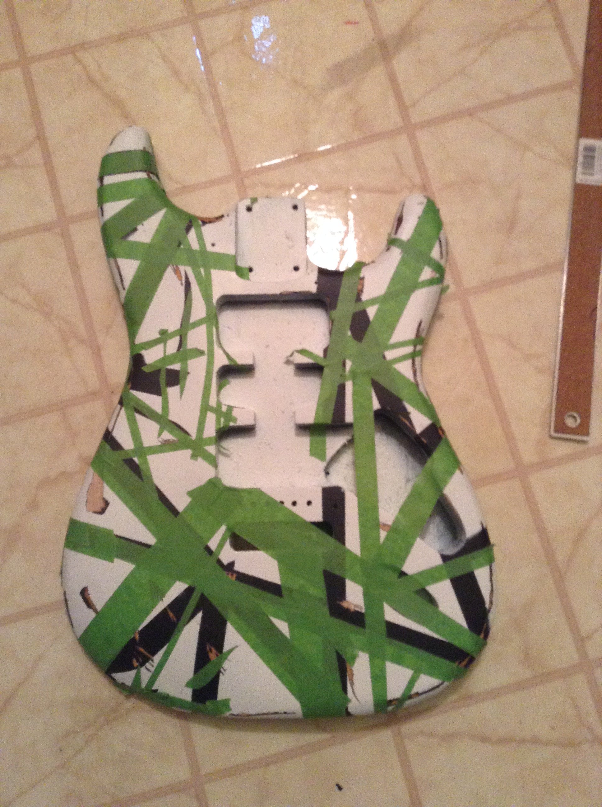

I sprayed 3 coats of white paint on next, and then I scraped a bunch of paint off with a razor blade. After a quick light sand, I taped up the white paint to get ready for the red. Again I didn't worry about precision but just threw on the tape.

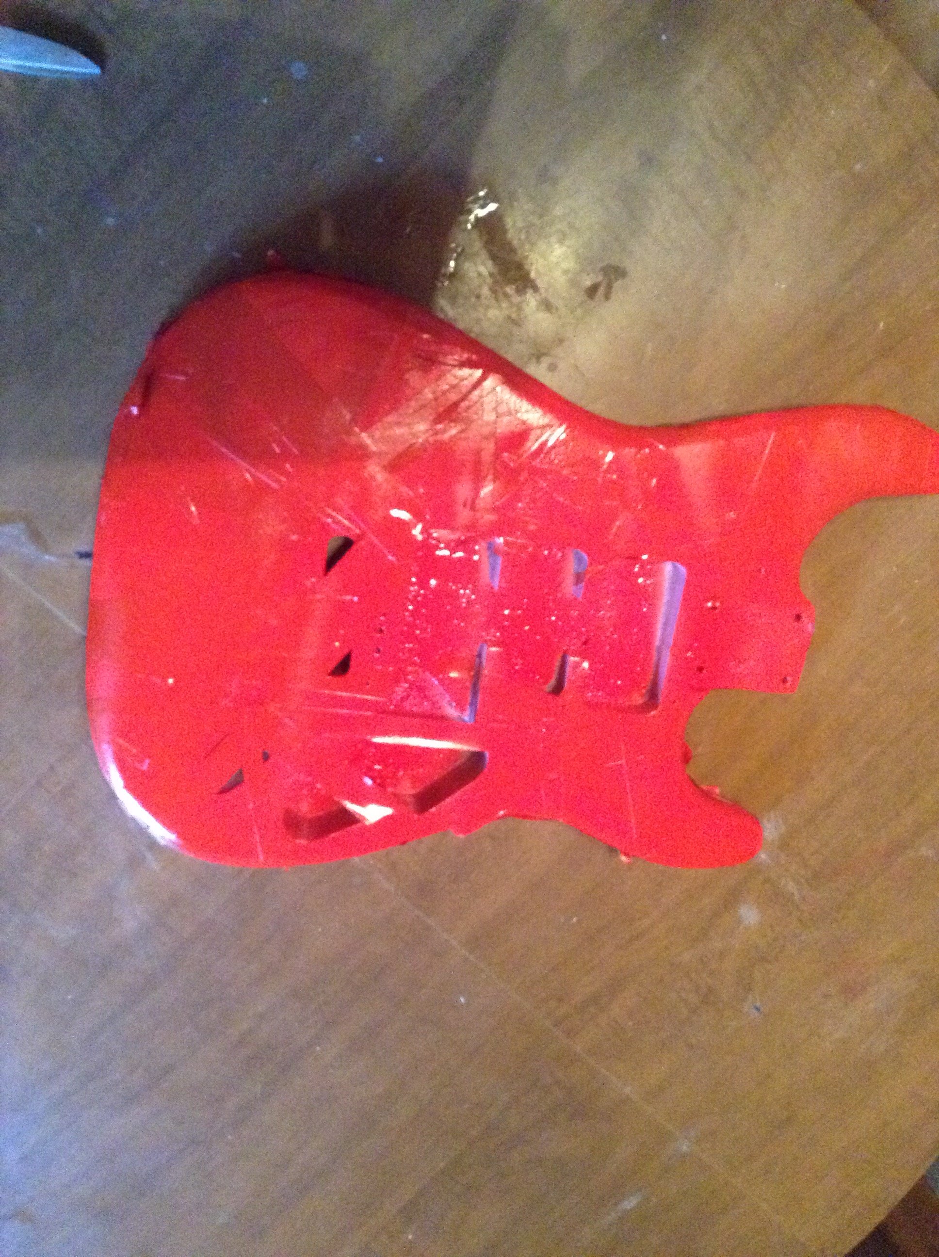

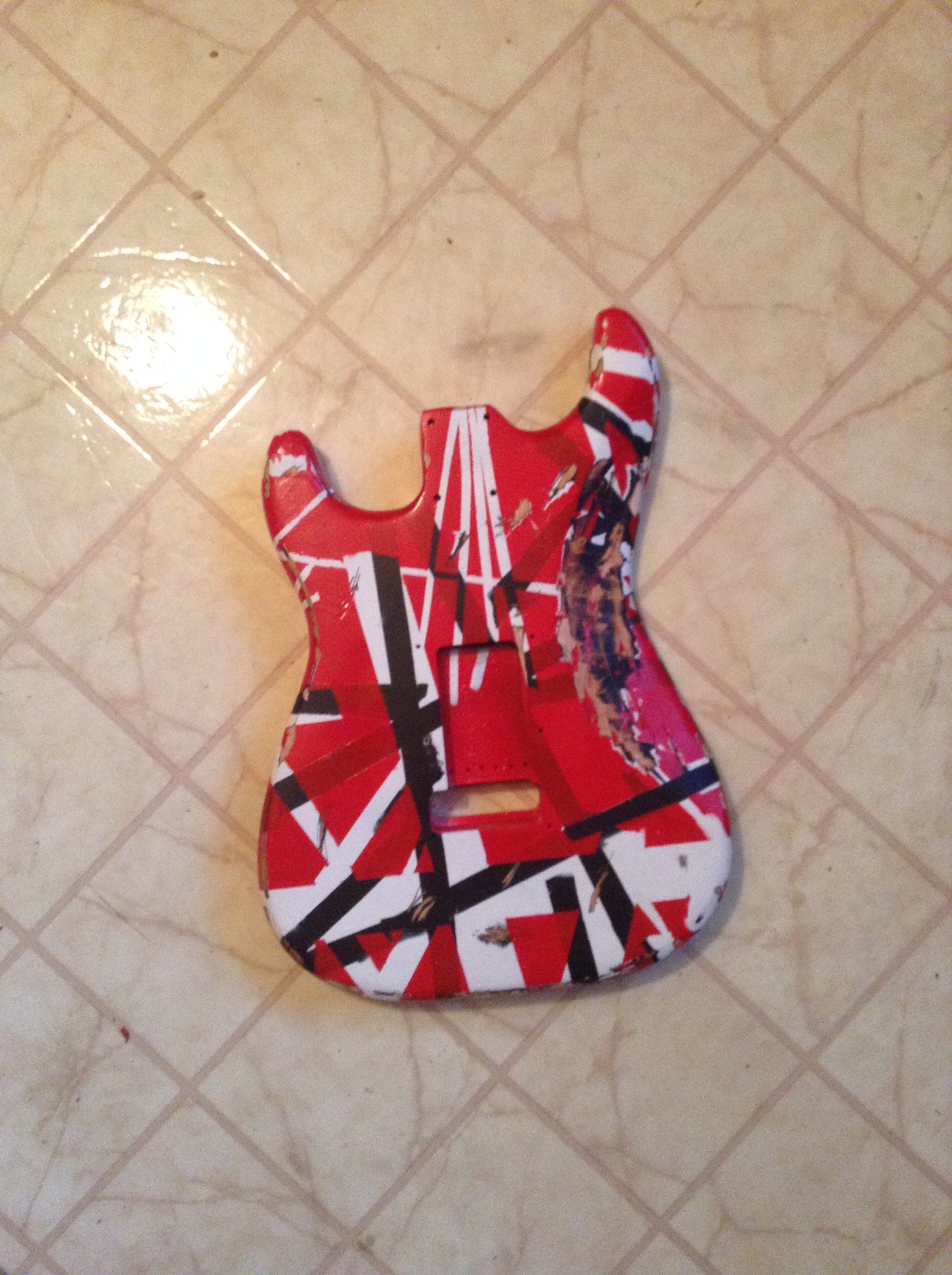

3 coats of red paint later....Before and after taking off the tape. Finally getting to see the product! Looks awesome! I went at it again with the razor blade and took off even more paint, dirtying it up.
Finished product!

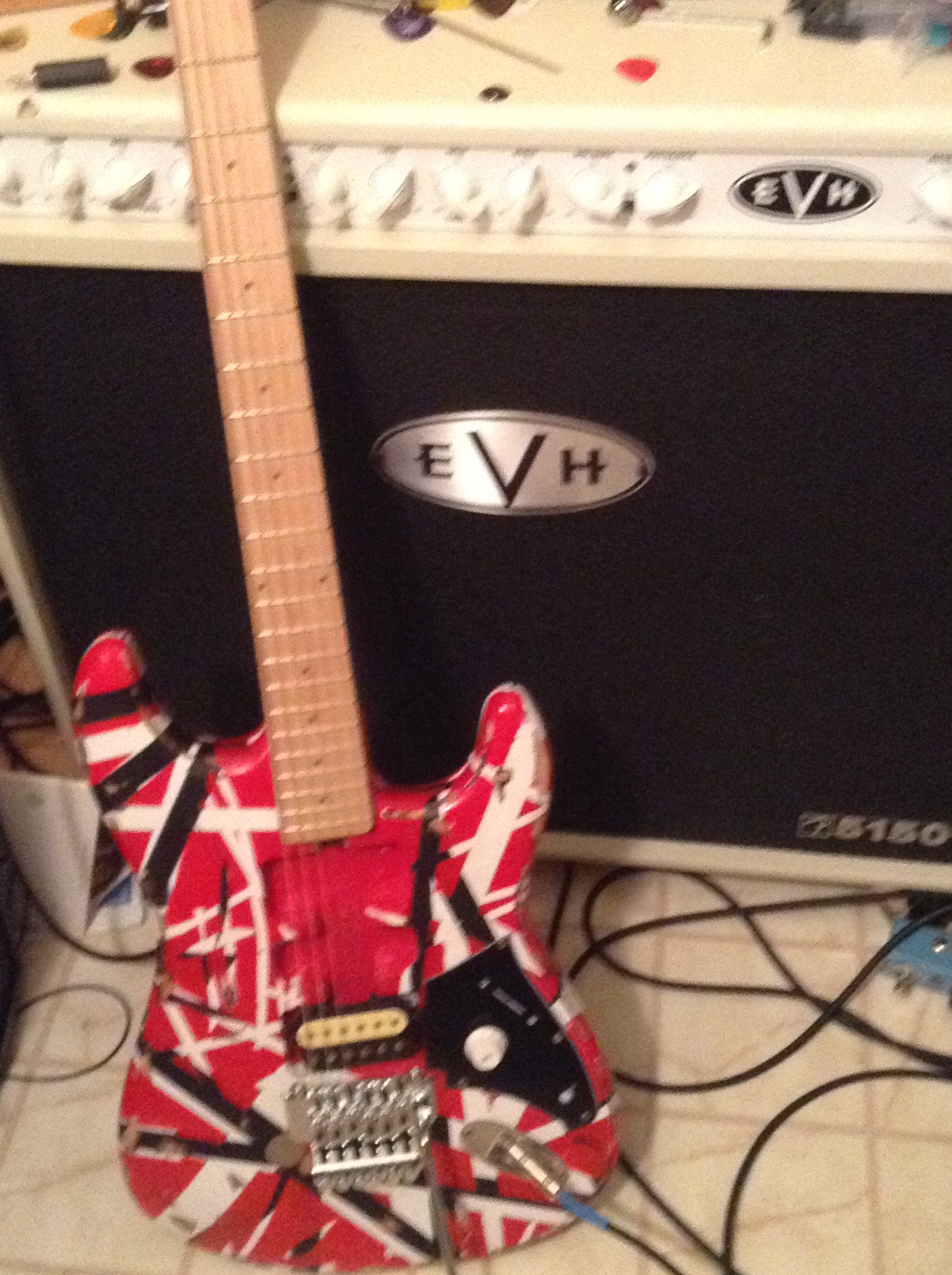

The neck and hardware bits came from a Sterling Sub AX4. It's a cheap version of the Music Man Axis, one of the guitars that Eddie used for a time. The Axis has the most comfortable and fastest neck I have ever played on, and the AX4 isn't too far behind. The pickup is not an EVH one, it's the custom DiMarzio from the AX4. I may upgrade to the EVH Frankenstein pickup at some point. I also need to mount the pickup at a slant like the original guitar has.

This is my first step into the world of custom guitars, but it's awesome! I wasn't sure that this one would turn out to be playable but it is. I mounted the bridge just a hair too high, so the low string is a little close to the edge of the fretboard. I may fill in the holes and redrill some point, but for now its great!

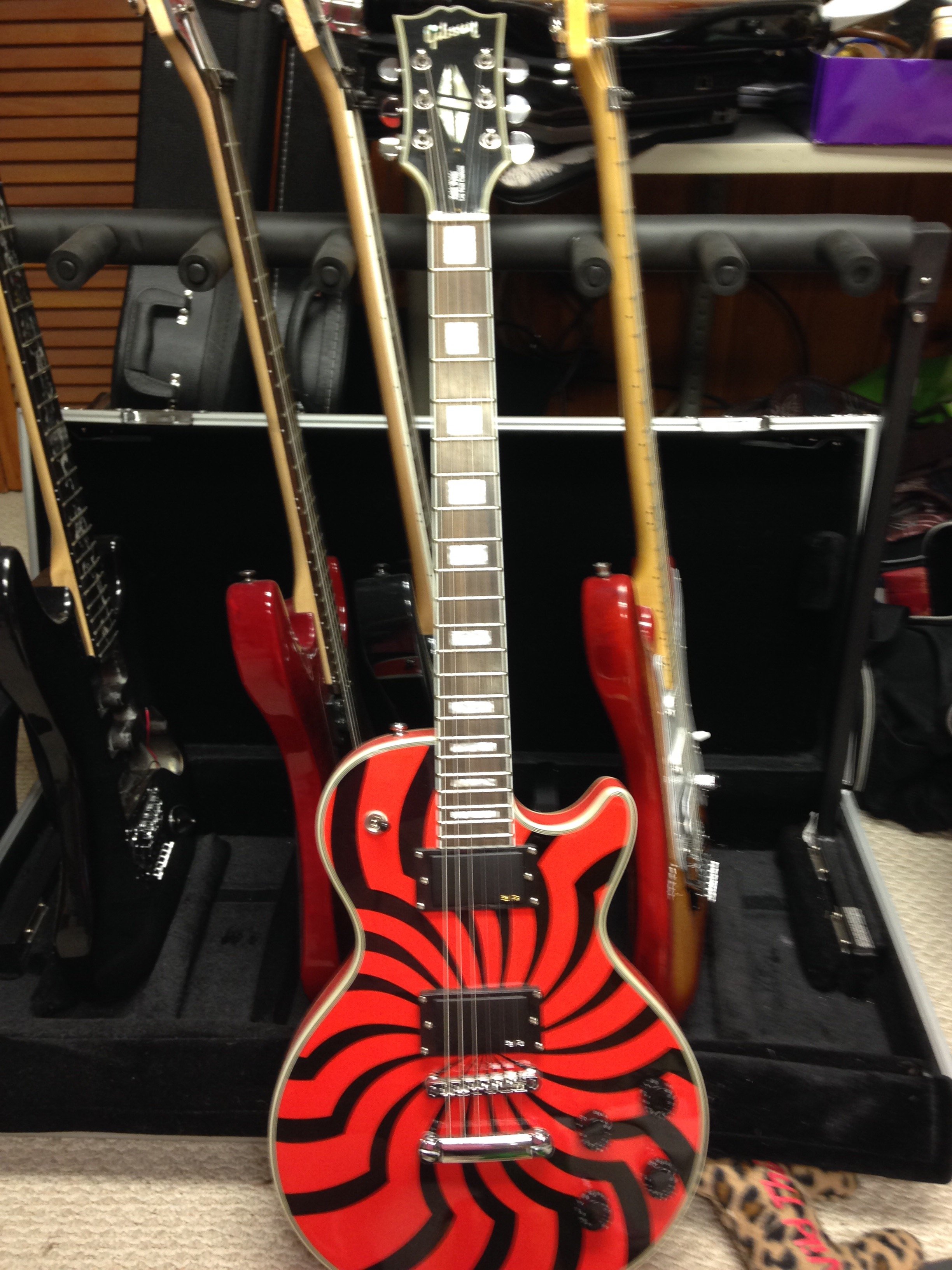

Ive been building guitars for 20+ years and i have yet to make his model. And i have made over 100 guitars. Im a big les paul guy. I just finished the last of all of zakk wyldes models

Les Pauls are great guitars. It used to be my favorite kind, and the first one I bought was a Les Paul. Once I tried the music man guitars, it was over though. I have not played a smoother neck than on the music man axis. Even the entry level models are easier to play. I have to fight with Les Pauls to get what I want.
