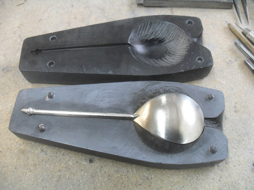

Here is an example of a 14th century spoon being made in the correct period manner with a mold carved from Wonderstone (from Africa) and pewter poured into the mold.
These pieces are made by Robert MacPherson and his wife. www.billyandcharlie.com/
Pewter melts anywhere from 170–230 °C or about 330–440 °F, so if your 3d print will tolerate that temp, then you could make a number of these from a strong food safe metal,(Just buy a pewter ally without lead) relatively cheaply.

I agree with Imgill on the pewter suggestion. You can get high temperature silicone fairly inexpensively, though it will be more expensive than the normal silicone meant for resins. I have worked with pewter before, and for items that are relatively smooth without a lot of fine detail, we (I was helping a person do a demonstration, keeping an eye on the temperature and pouring the demonstration pieces while he would explain the process and answer questions) cast at around 550°F. If the item has a lot of fine detail, like one time we cast a thin butterfly with lots of small holes in the wings, we would cast at 650°F.
