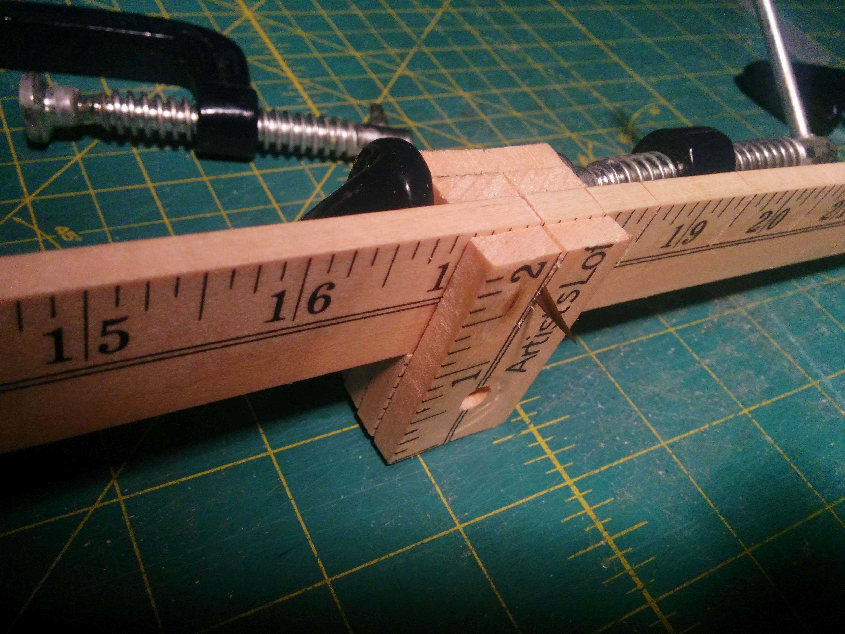

So first I had to create something to cut a perfect circle out of the foam since my largest circle cutter only does 10 inch diameters,
Using a wooden ruler, some clamps, a screw, and an exact-o blade, I made a nice easy to change large circle cutter, it can do up to 30 inch circles with no problem.
I used a Japanese pull saw to cut the slots in the ruler, the blade was just small enough to allow the knife blades to slide in snugly and the clamps were just to keep it from moving around and add weight.

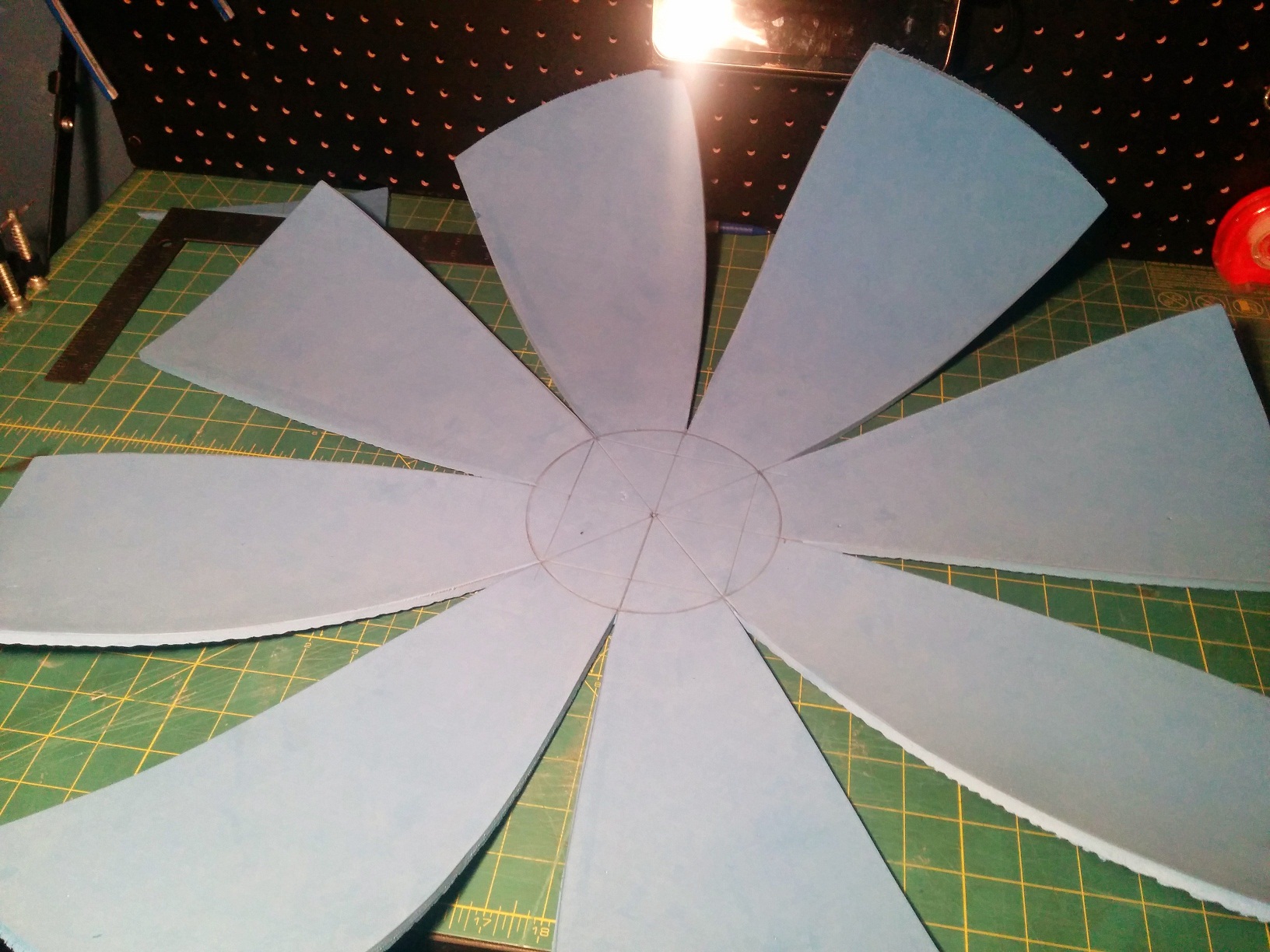

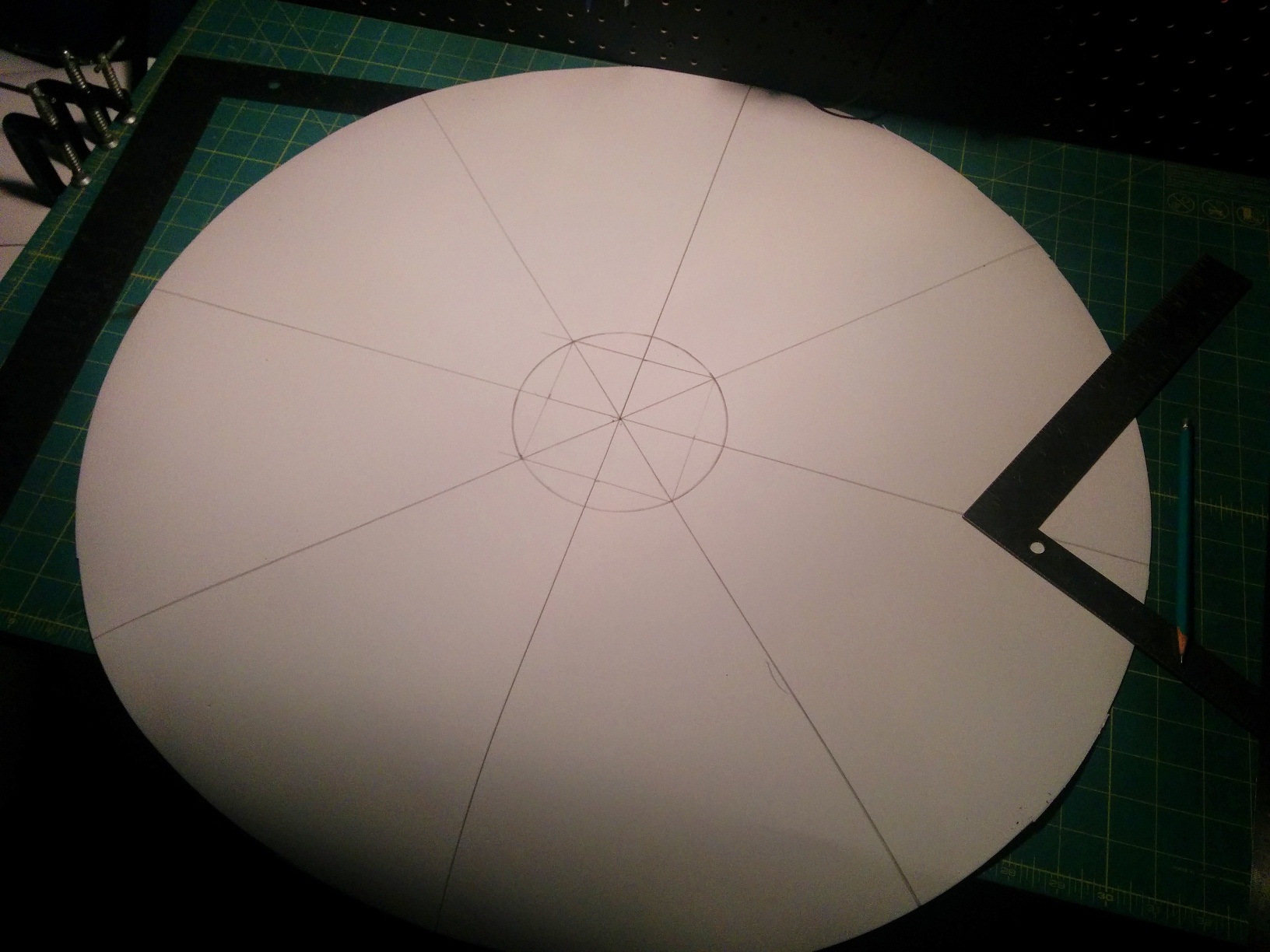

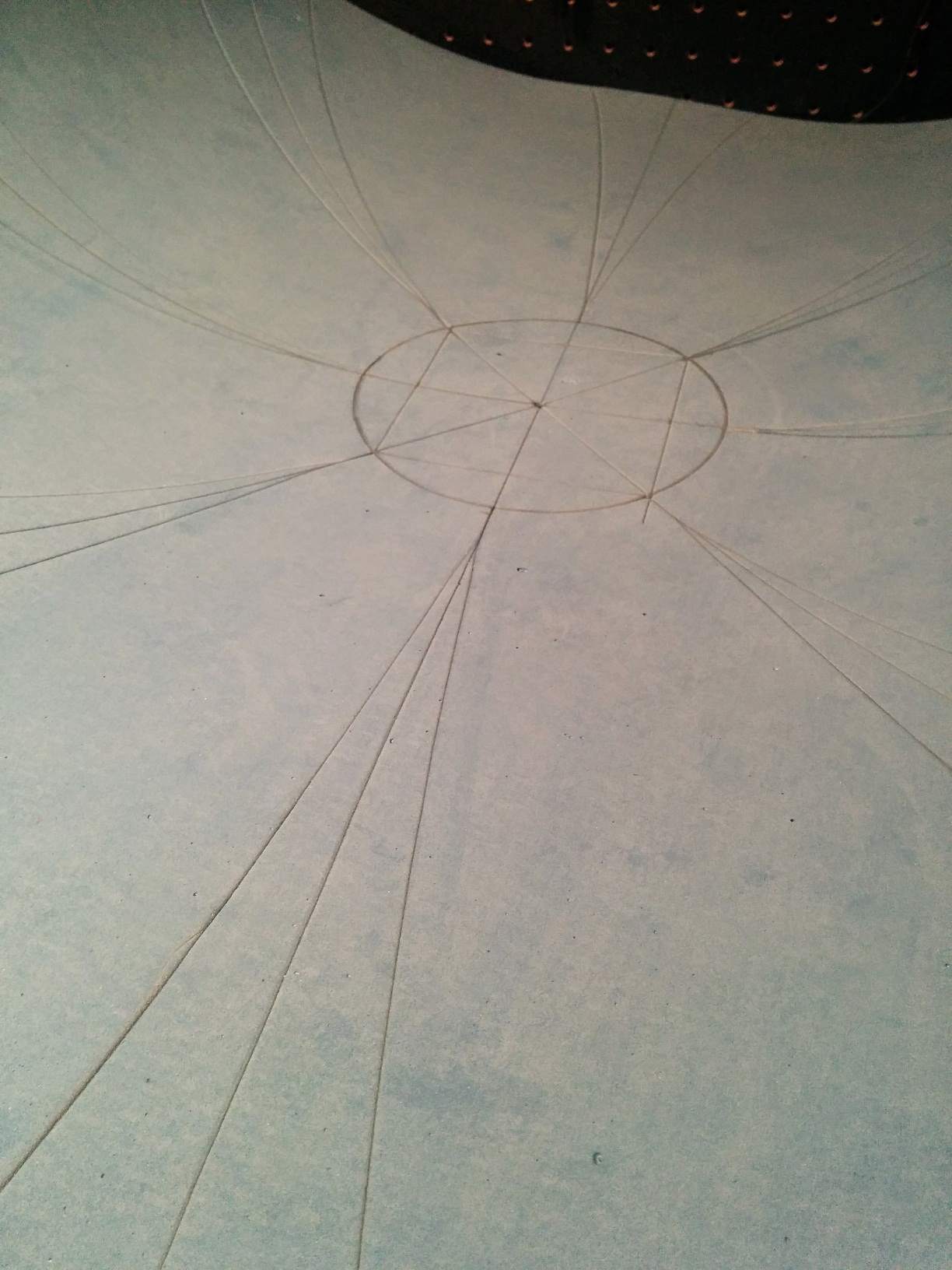

once I had it cut out of the 1/2 inch Eva foam, I used a right angle to figure out where I would have to cut the sections out to curve it as well as figure out how much i would have to cut away.
once that was done I cut out a similar sized piece of foam, this time only 1/8 thick, to use as a backer to keep it in the correct shape

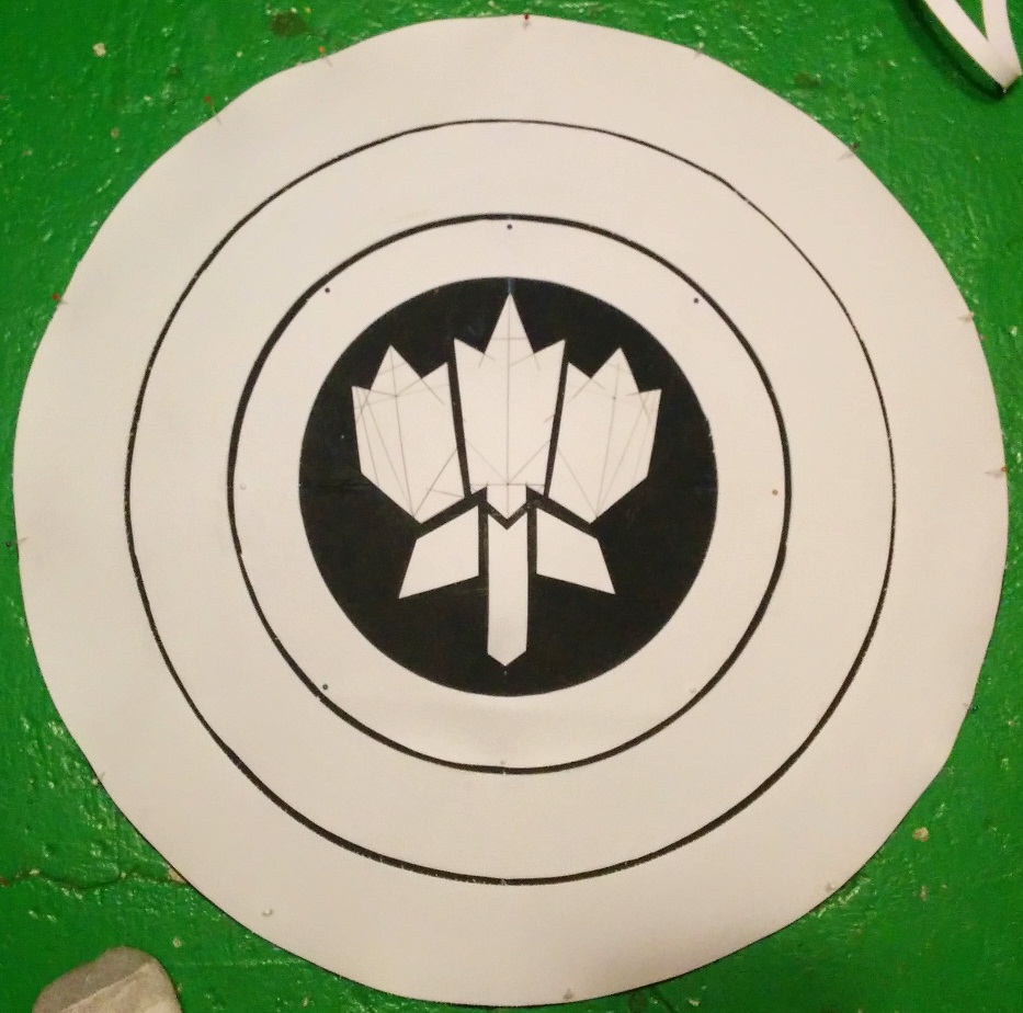

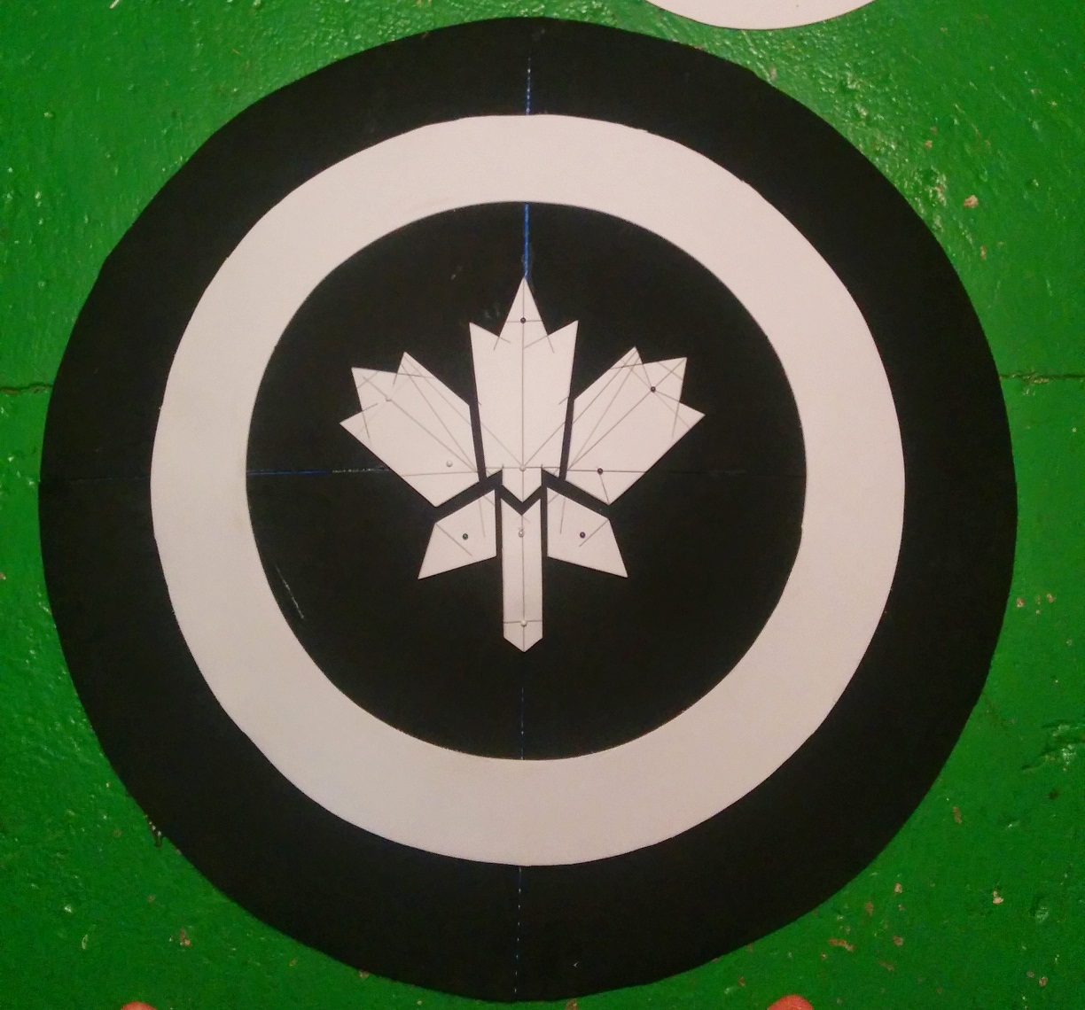

I didnt take any pictures of the next few steps but I cut out sections to create the shield look that I wanted to get

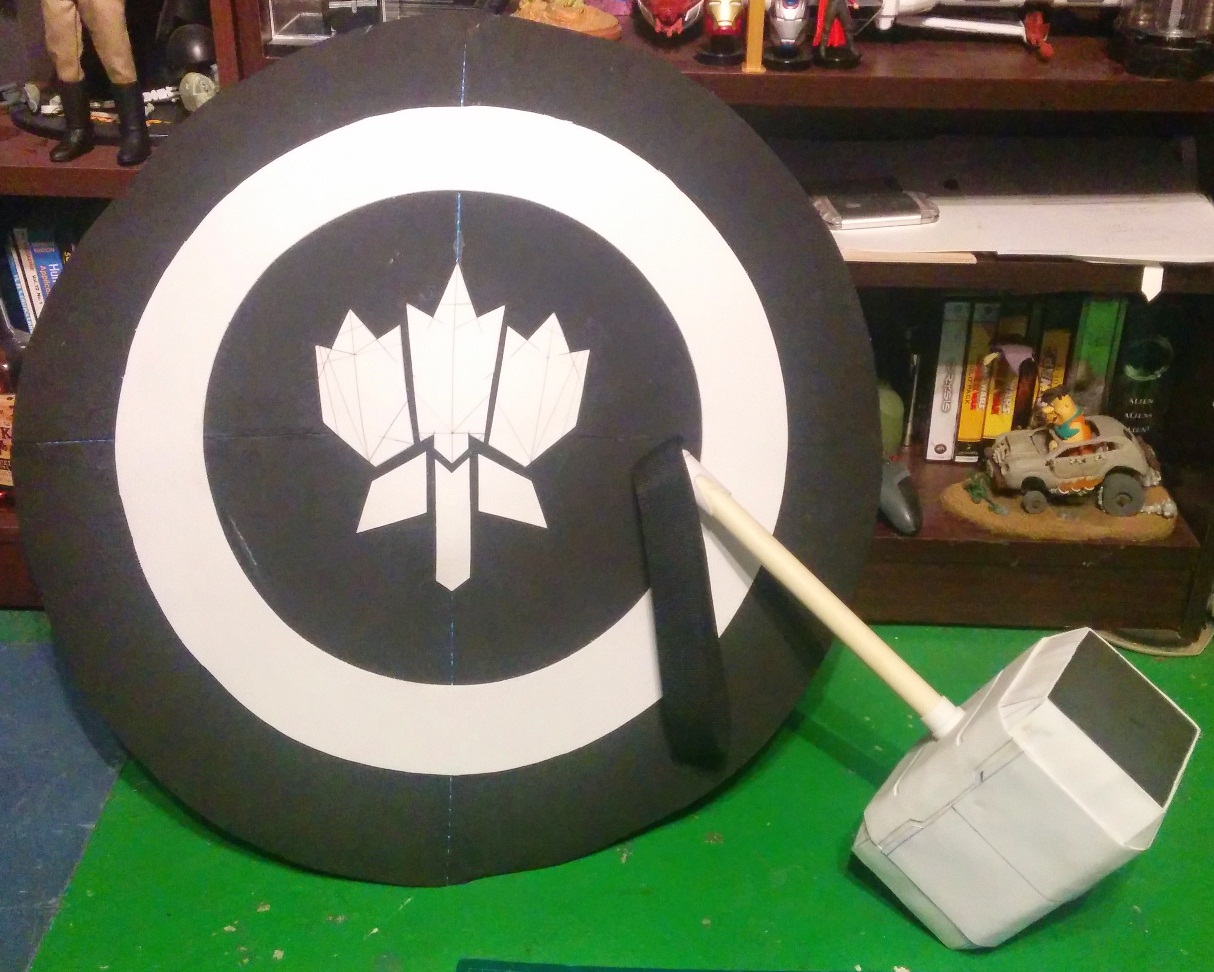

as well as my own spin on the center emblem since I live in Canada
here is a size comparison next to the EVA Hammer Ive also been working on

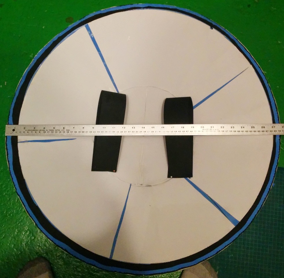

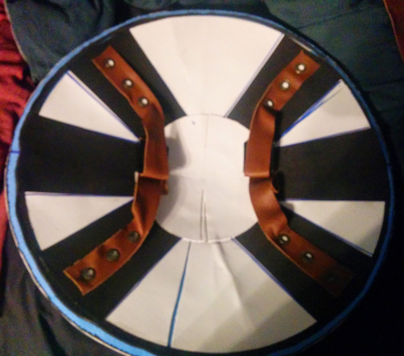

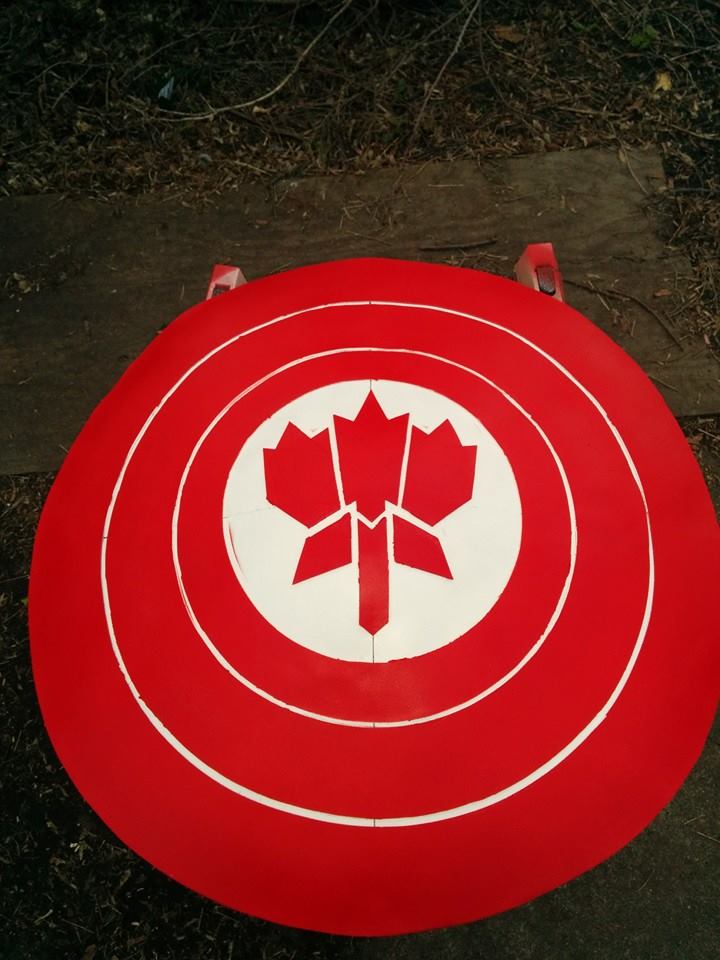

once that was finished I added some extra support parts to it and using some leather strips I made the arm supports for it, I may alter it so I can get it to sit on my back like in the movies but for now it sits quite nicely on my forearm.
once I play with it a bit more I will paint it White and Red to match the Flag.

It finally stopped raining long enough to get outside and paint, I masked off all the areas I wanted to keep white and gave it the good old Canadian white and red, a few bits still need to be trimmed but ill do that after the paint dries.
