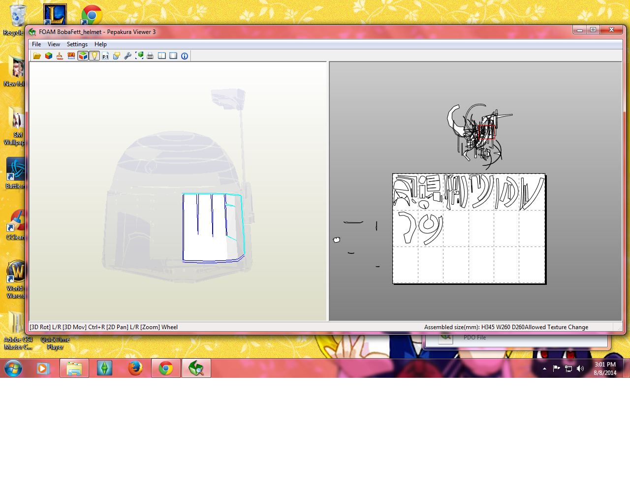

I'm working on putting the helmet together now but I feel like there are pieces that didn't print? I'm figuring it out to work for how I need it but you may want to check the original helmet file and make sure all the pieces are on the papers. I took a screen cap. That red highlighted piece the right back piece which is missing from everything that printed. I find it VERY problematic because that's a lot of missing pieces.
Sorry I don't have access to my computer right now to check the file but by looking at that screen cap I'm guessing that the piece to the left of the highlighted piece would of been printed? If it has been printed, flip it and use it for the right side. Hopefully that's the case, if not as soon as I can access the files I'll edit them.
