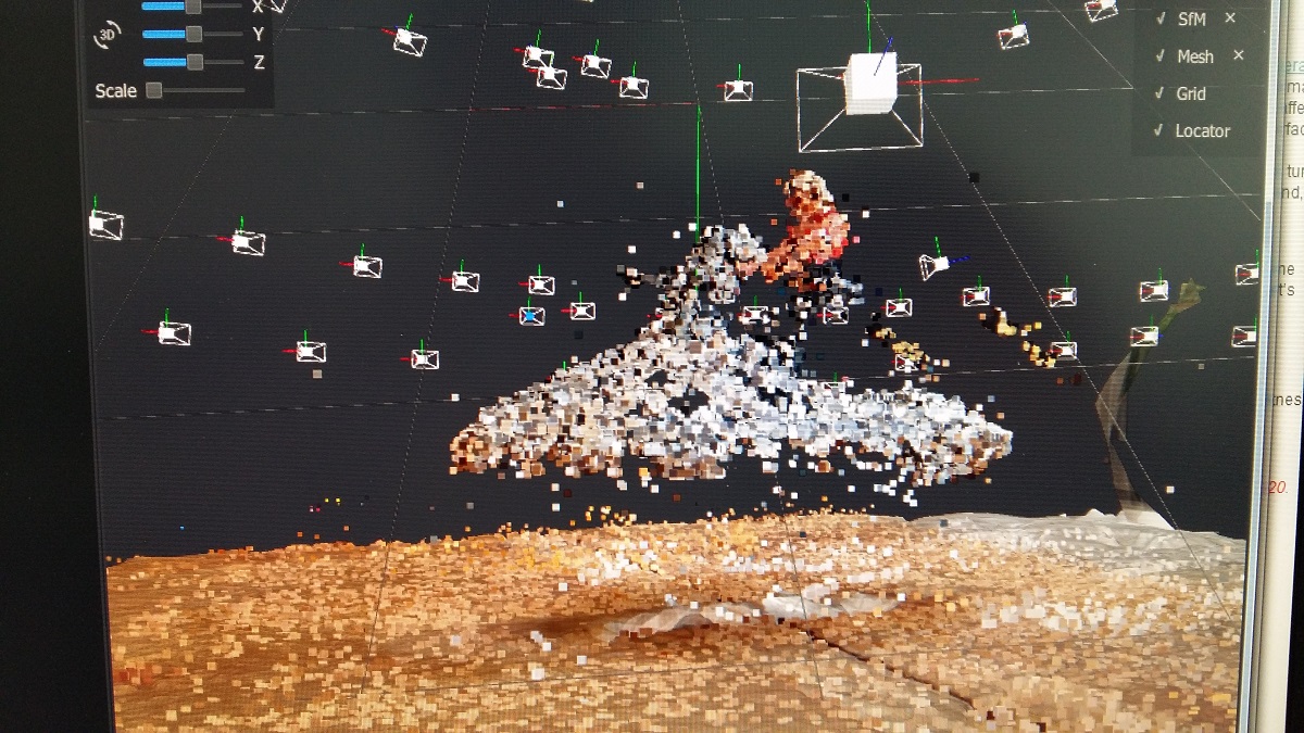

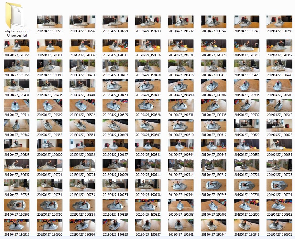

I was hoping that Photogrammetry would answer my prayers to get a 3d model happening (I've seen some AMAZING 3d prints produced from 2d photos imported into Photogrammetry software). Sadly, the surface of the model proved to be too "metallic" and shiny and this meant that the Photogrammetry software couldn't render a usable .obj file to be imported into 3d printing software.

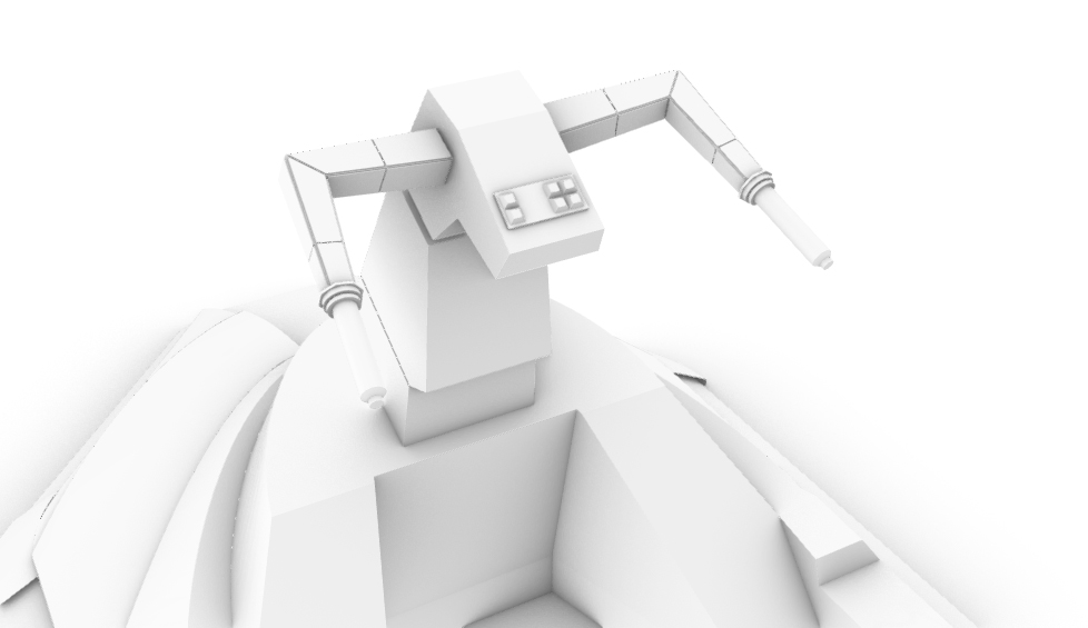

I exported Stevestarkiller's sketch-up model as a .obj file but because that model was never created with 3d printing in mind as the output, the result is unusable too.
So, I'm back to where I started in 2011. Looking to commission someone to produce a new model that can be exported for 3d printing.
Here's the results of the photogrammetry imported into the "Meshroom" software. As you can see, it was an unusable result.

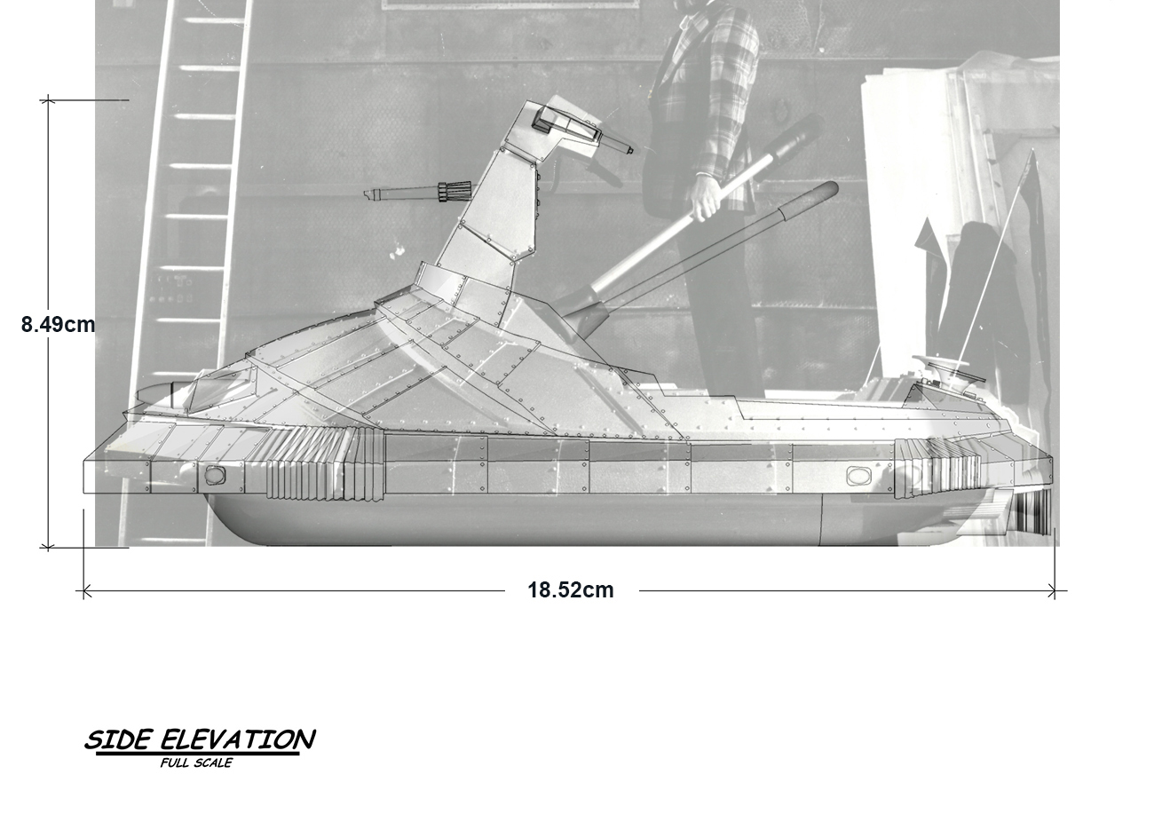

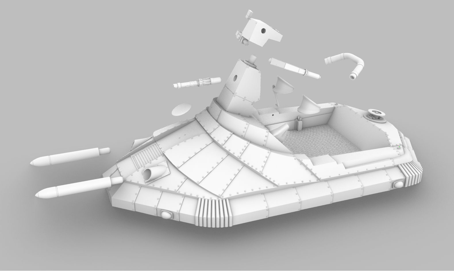

Here is an overlay showing the side elevation from Stevestarkiller's sketch-up model and the best side view reference photo that I've got of the actual prop. I scaled the photos based on the overall height from the bottom of the boat shaped hull to the top of the control console. As you can see, the panel placement around the skirt are out significantly. As is the position and number of the ribbed bumper strips on the corners. The rear of the hull should be flattened more and the front part of the hull and sloping parts that the control colum attaches to needs to be pulled forward more.

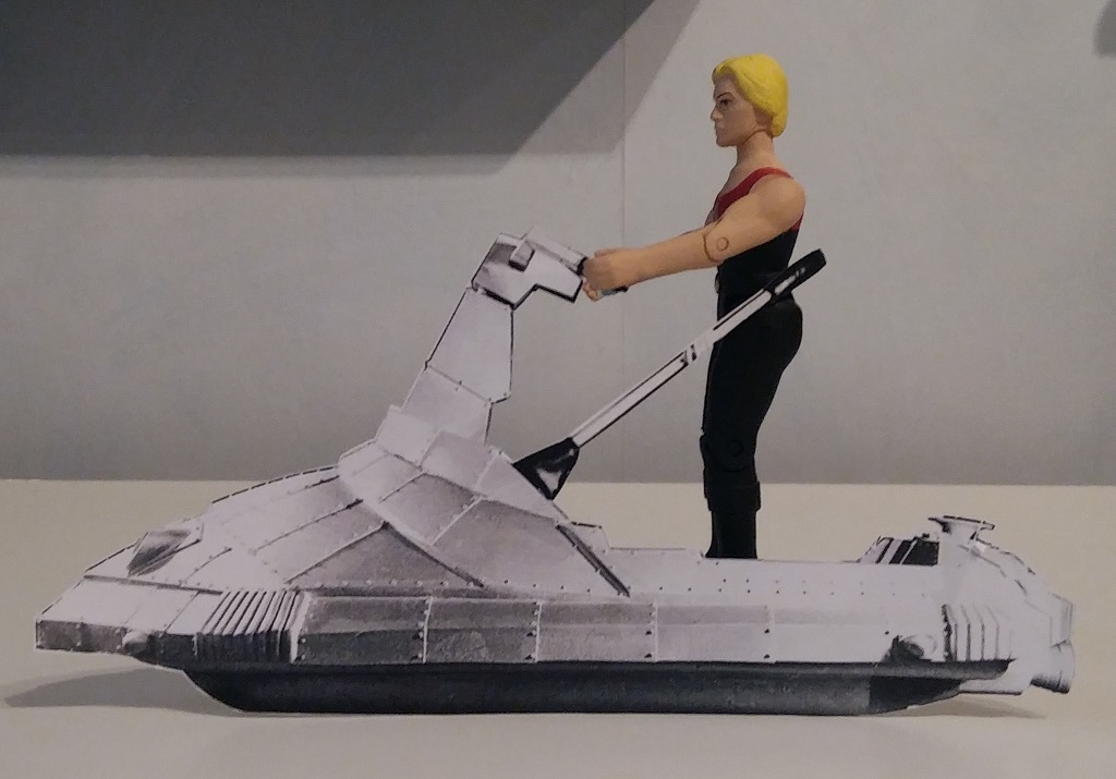

Here's a printed version of the prop photo scaled to suit the size of the figure when I was experimenting with finding out what would be the required size of the rocket cycle scaled to suit the figure.

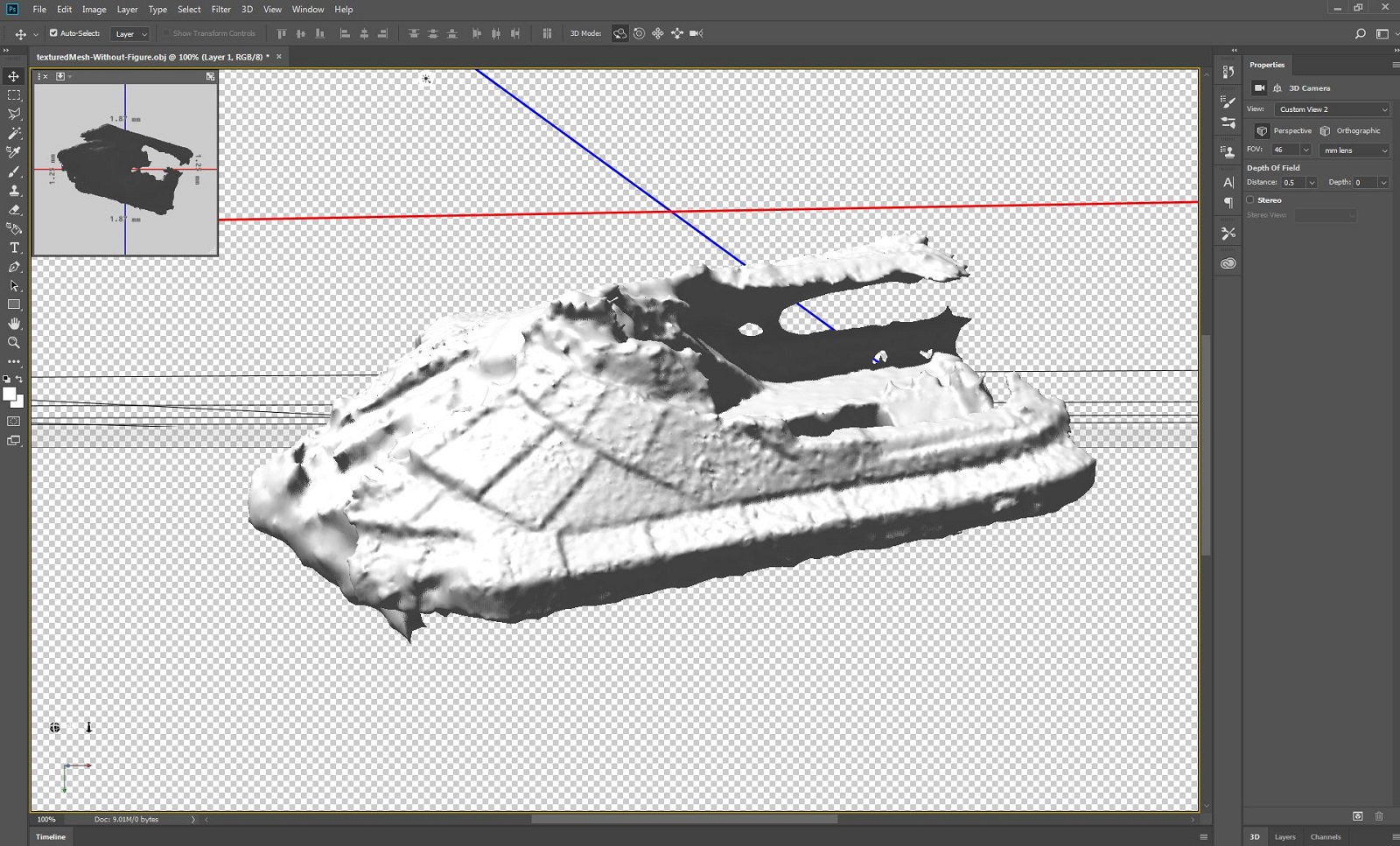

Here's the disappointing result of the .obj exported from the Meshroom Photogrammetry software. Looks like the rocket cycle after it must have crashed onto Arboria when it ran out of fuel. LOL.

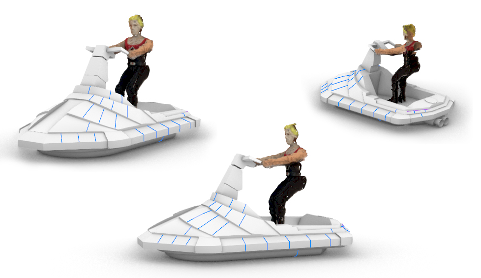

bigpetr has done an INCREDIBLE job of matching up the geometry and proportions of the full size prop and we have reached the stage where the basic shapes are completed, so now the detailing can begin. Working with bigpetr has been fantastic. He is extremely patient, very detail oriented and tries his absolute best to figure out all the tricky details to ensure that the model matches up to multiple photos of the prop. He had to start it from scratch because the older sketch-up model that I had commissioned had errors in almost every part (although it was the best we could do with the limited reference material that was available at the time).
I also took lots of photos of the 3.75 inch tall action figure (in flight pose) and sent them to bigpetr so he could use Photogrammetry to create a 3d model of the figure to import into the rocket cycle computer model so we can get the scale correct. The Photogrammetry didn't work too well, but bigpetr was able to get enough of it to give us the info that we need for the scale. (You can see partially formed, photogrammetry Flash in the montage of photos here).

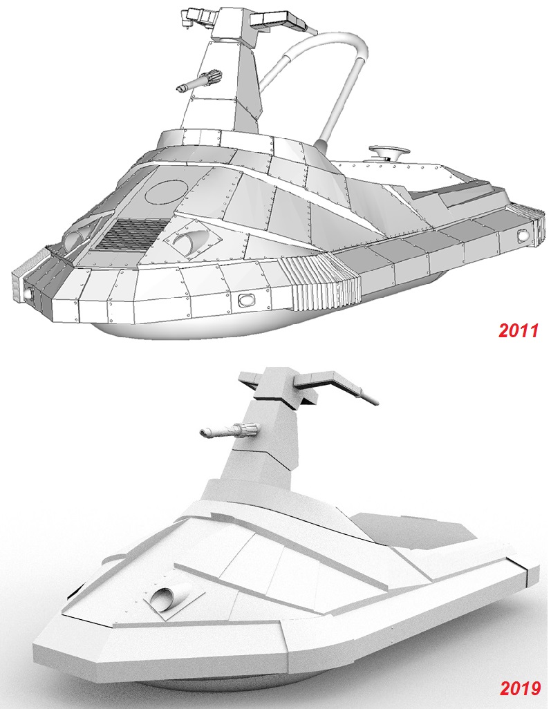

Here's a comparison between the first computer model done in 2011 and the WIP version of the 2019 version which has had the benefit of being photo-matched and also scaled accurately thanks to some collectors providing precise measurements and photos of the blaster props that were used to create the gun on the front of the rocket cycle center console.

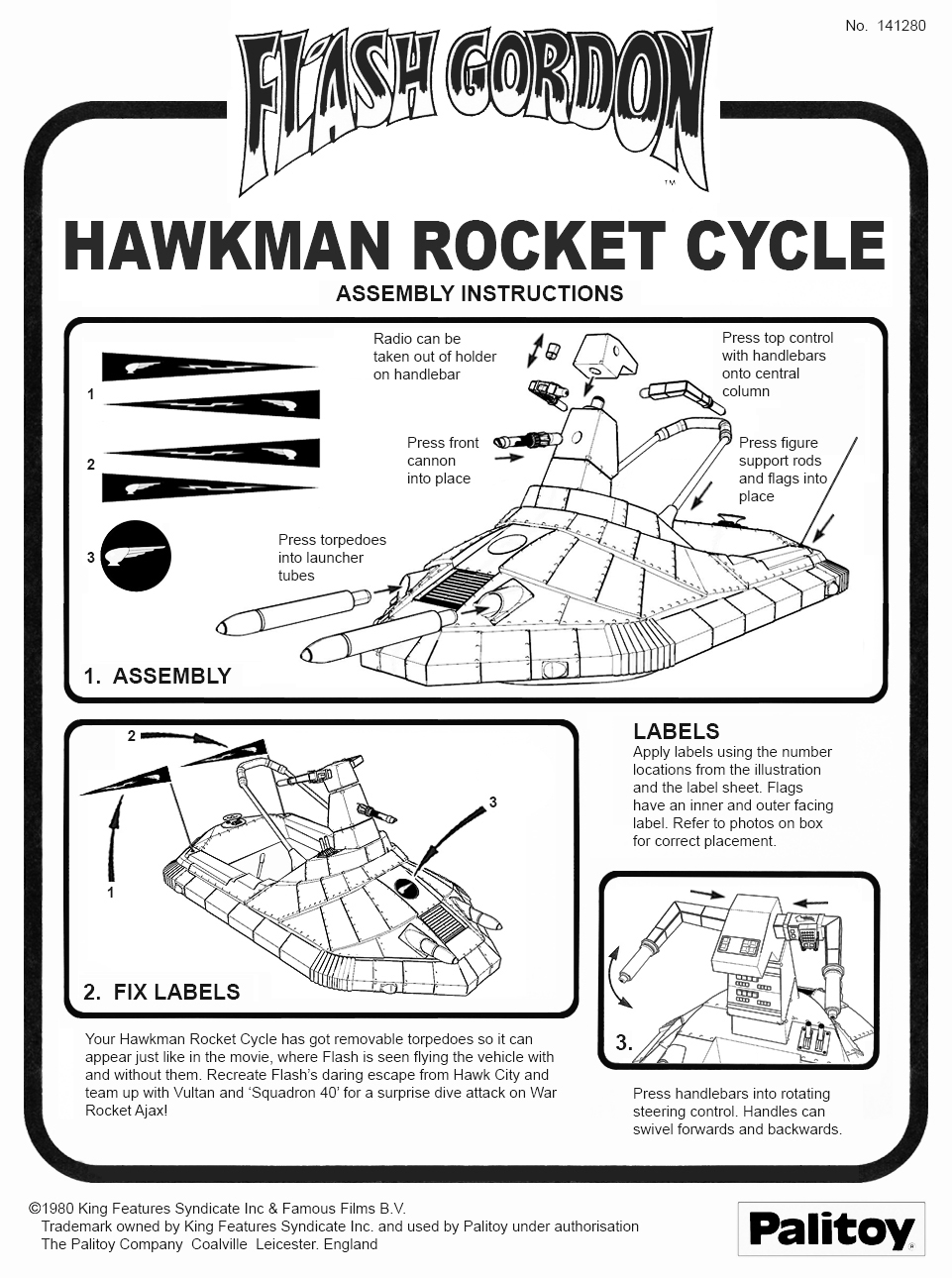

Just finished the instruction sheet and the boxes are being prepped for printing.
The superbly accurate computer model has been completed and is also being prepped for printing and should be started next week.

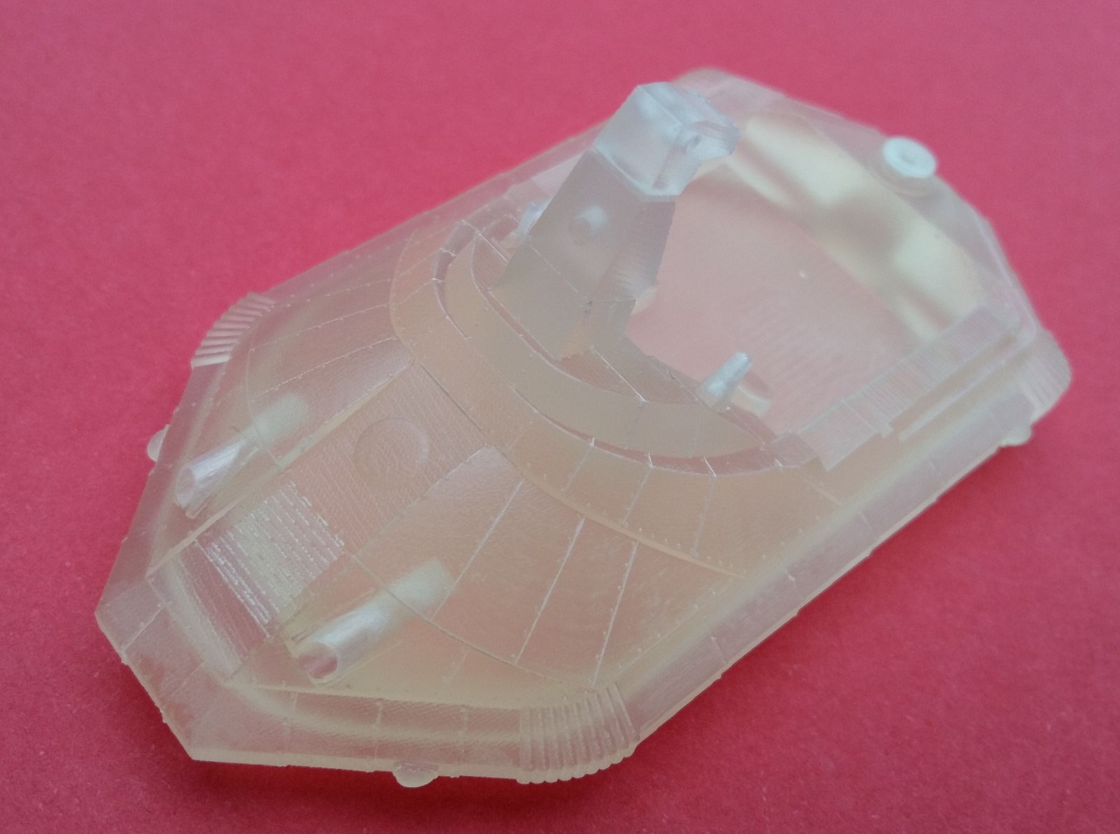

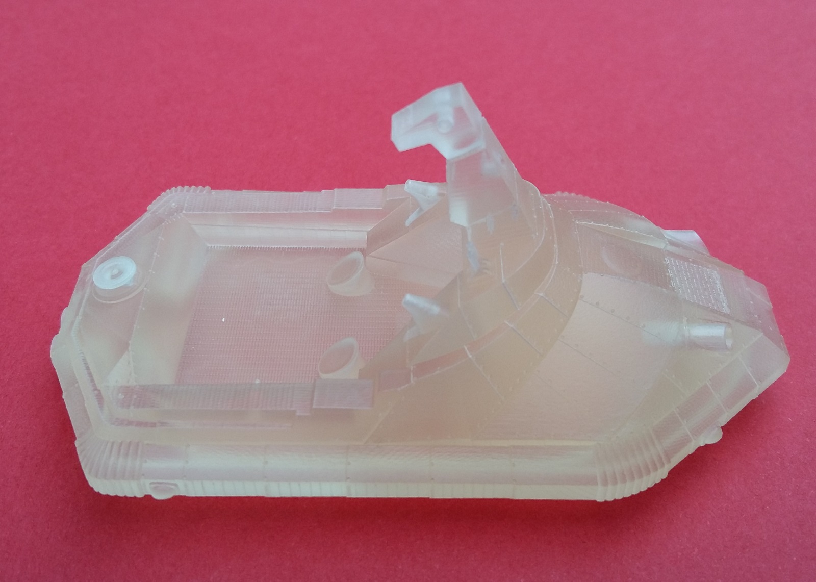

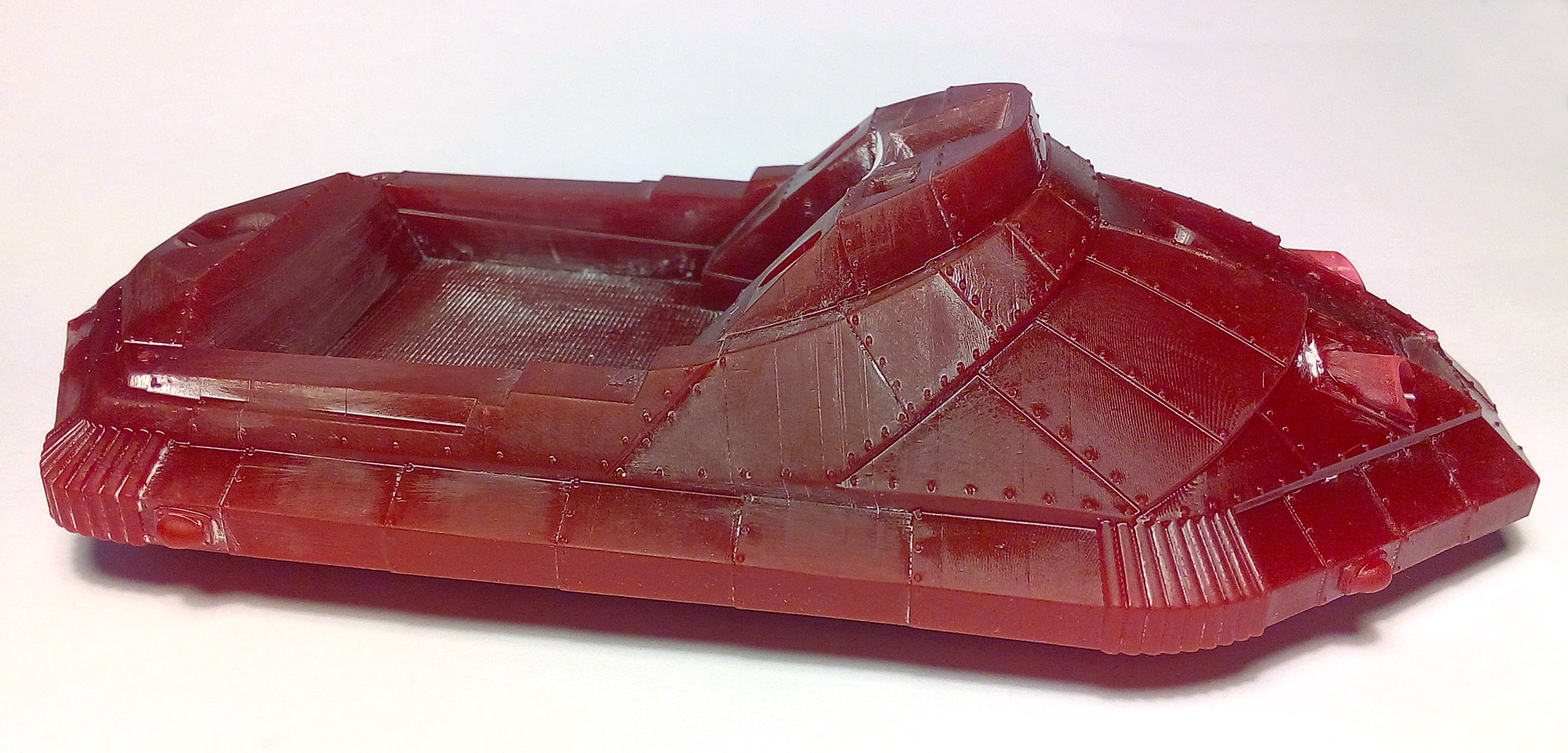

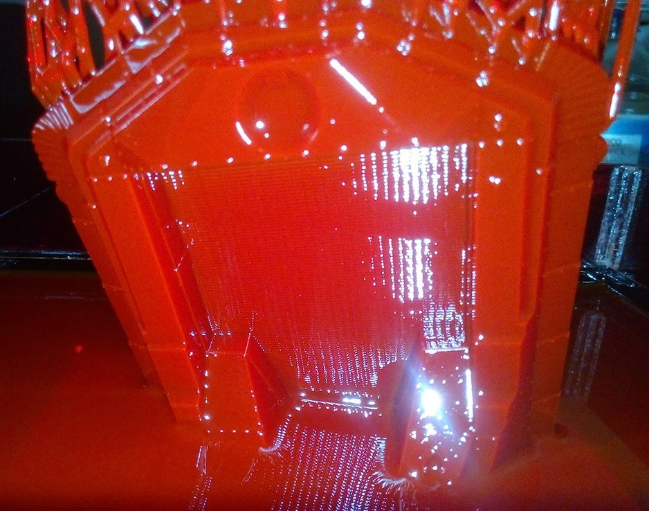

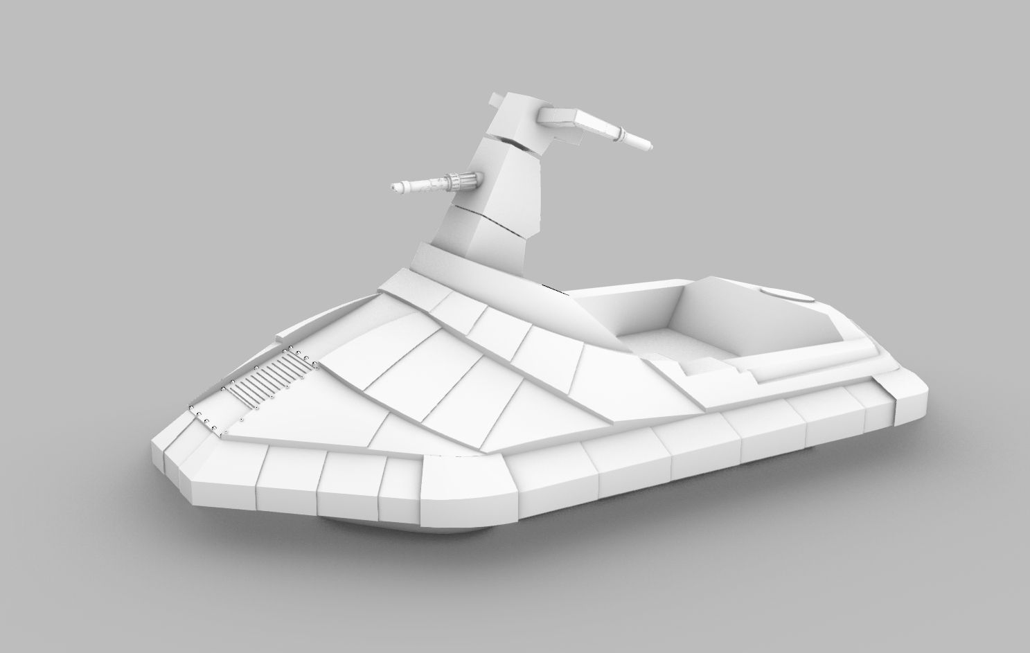

Here's the first 3D printed prototype. This was done on an FDM printer and has low quality surface details. It was a test print to check the scale etc.
The final version is being printed in resin on an SLA printer.
Great to finally hold this in my hands and put Flash on there!
My box has also been printed and assembled. Good times!

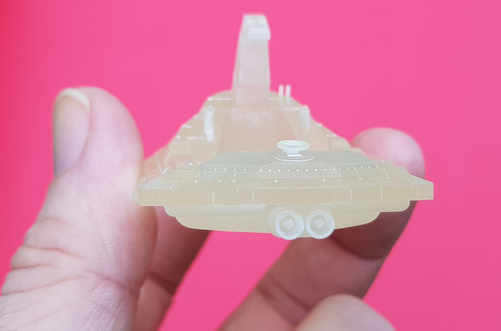

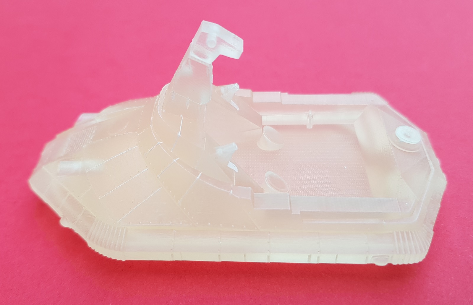

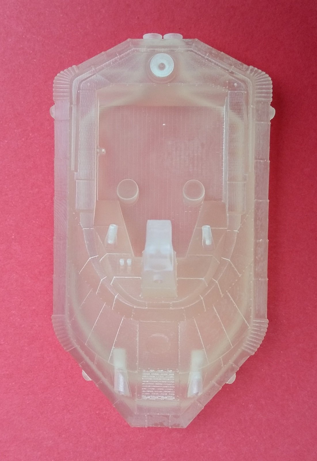

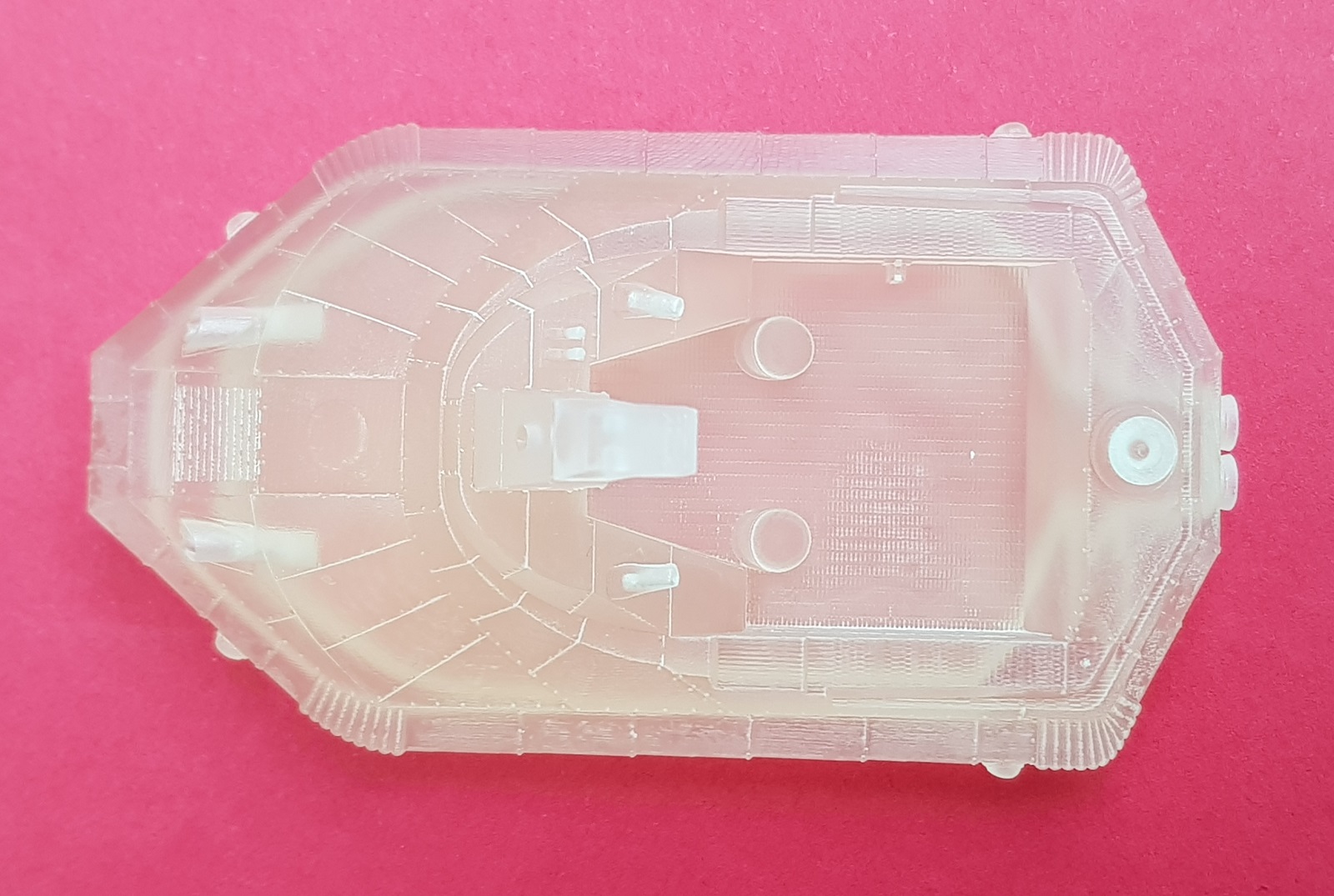

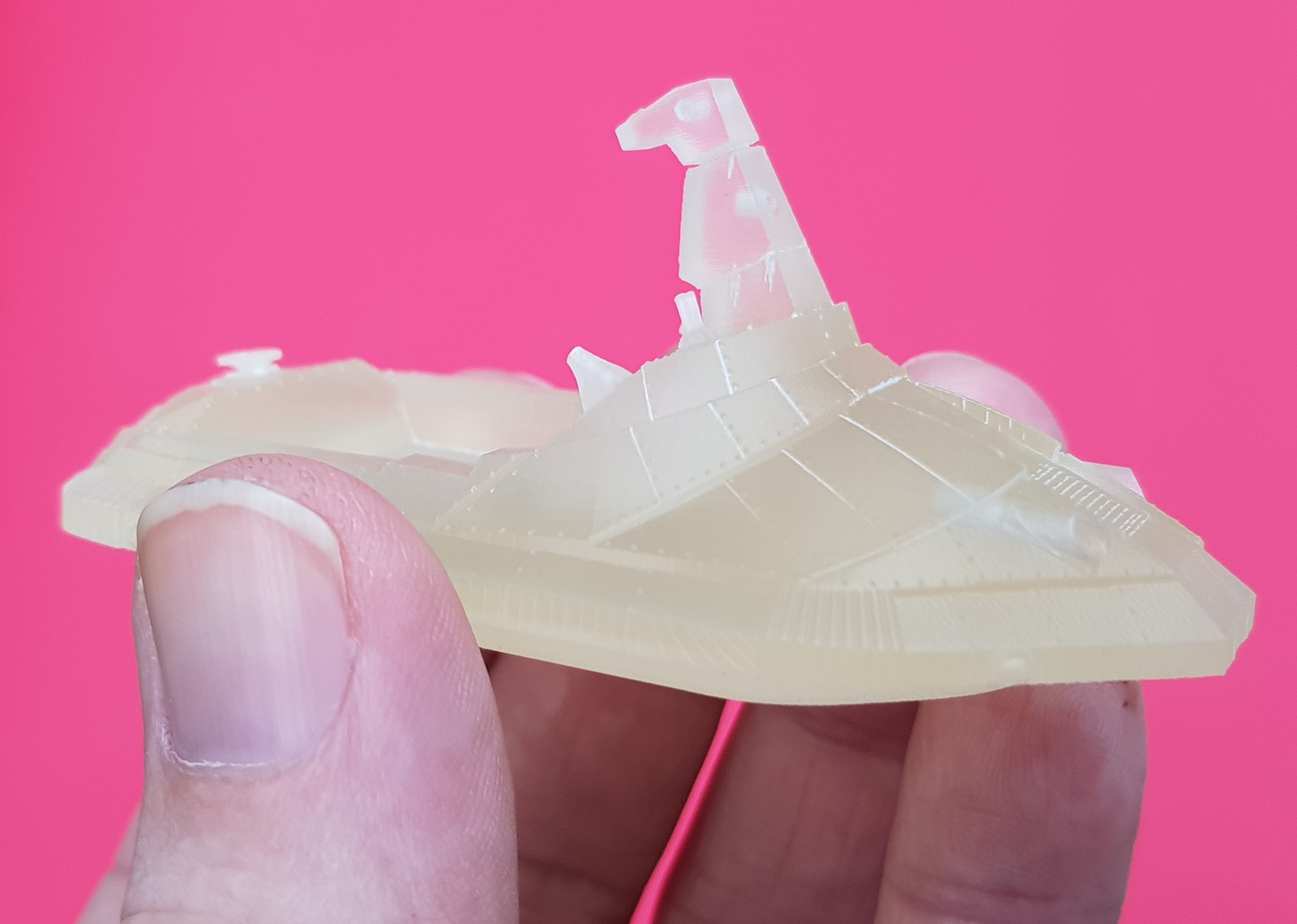

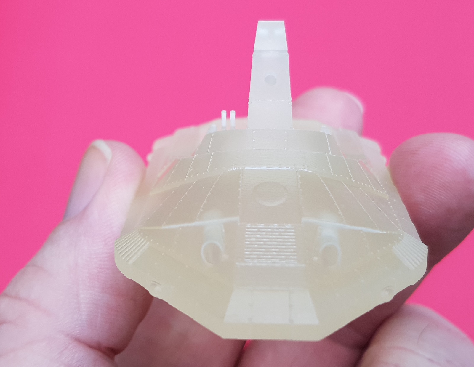

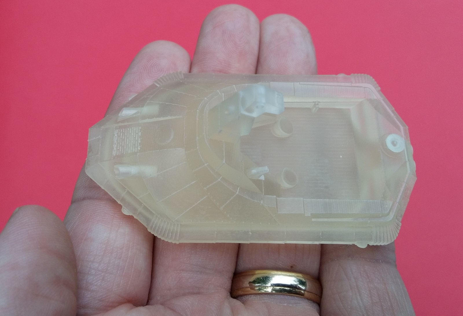

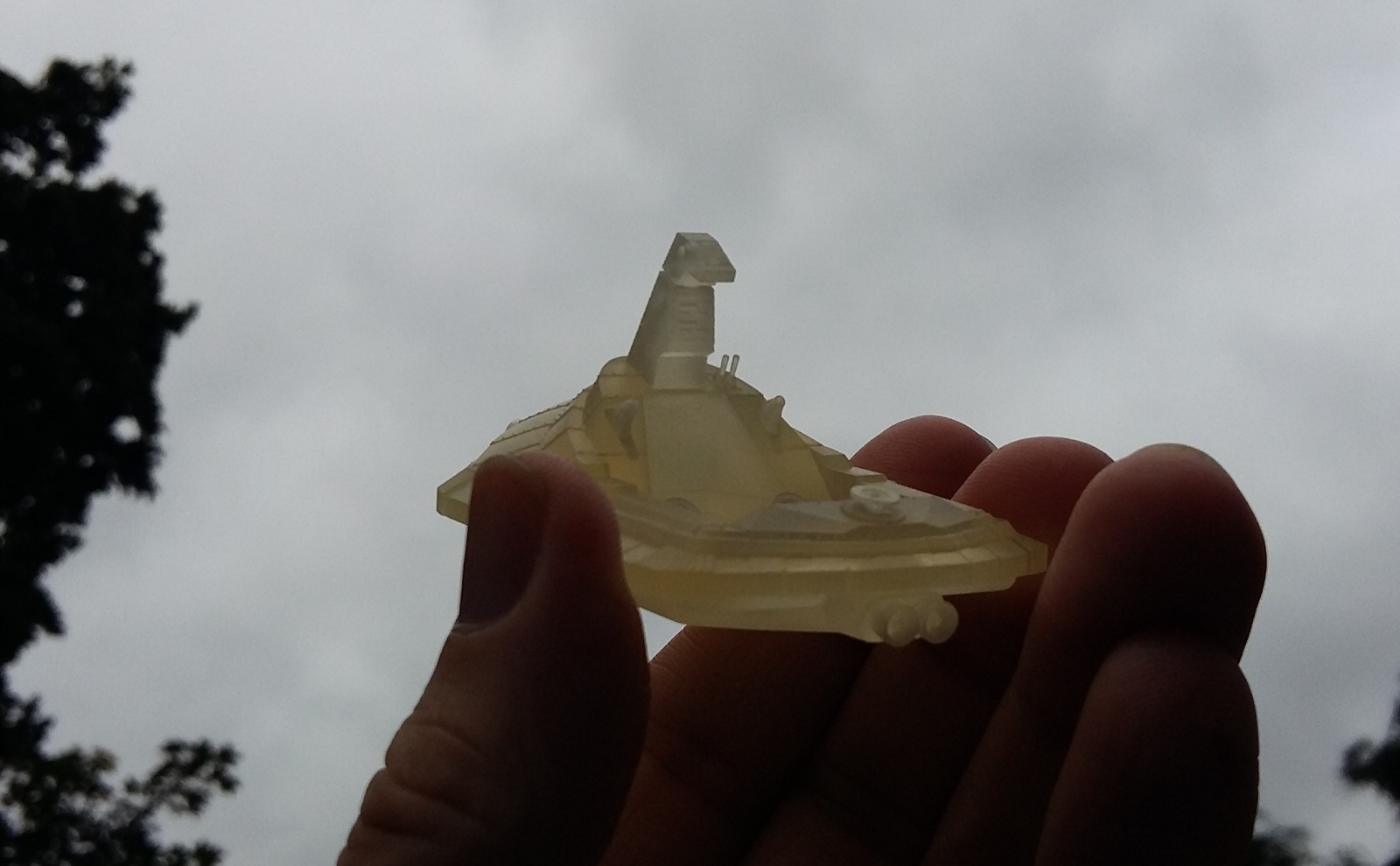

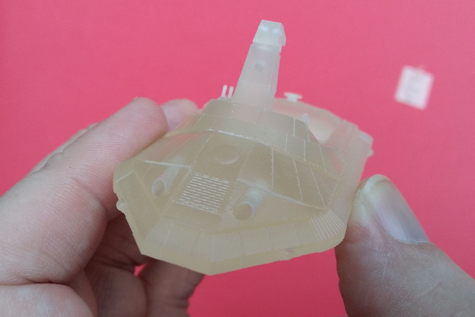

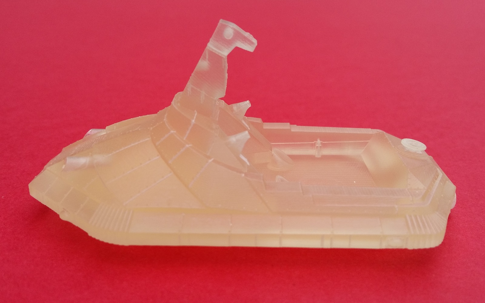

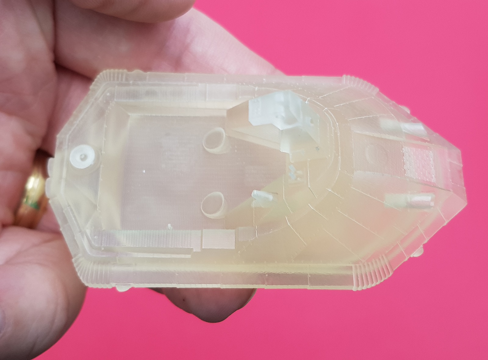

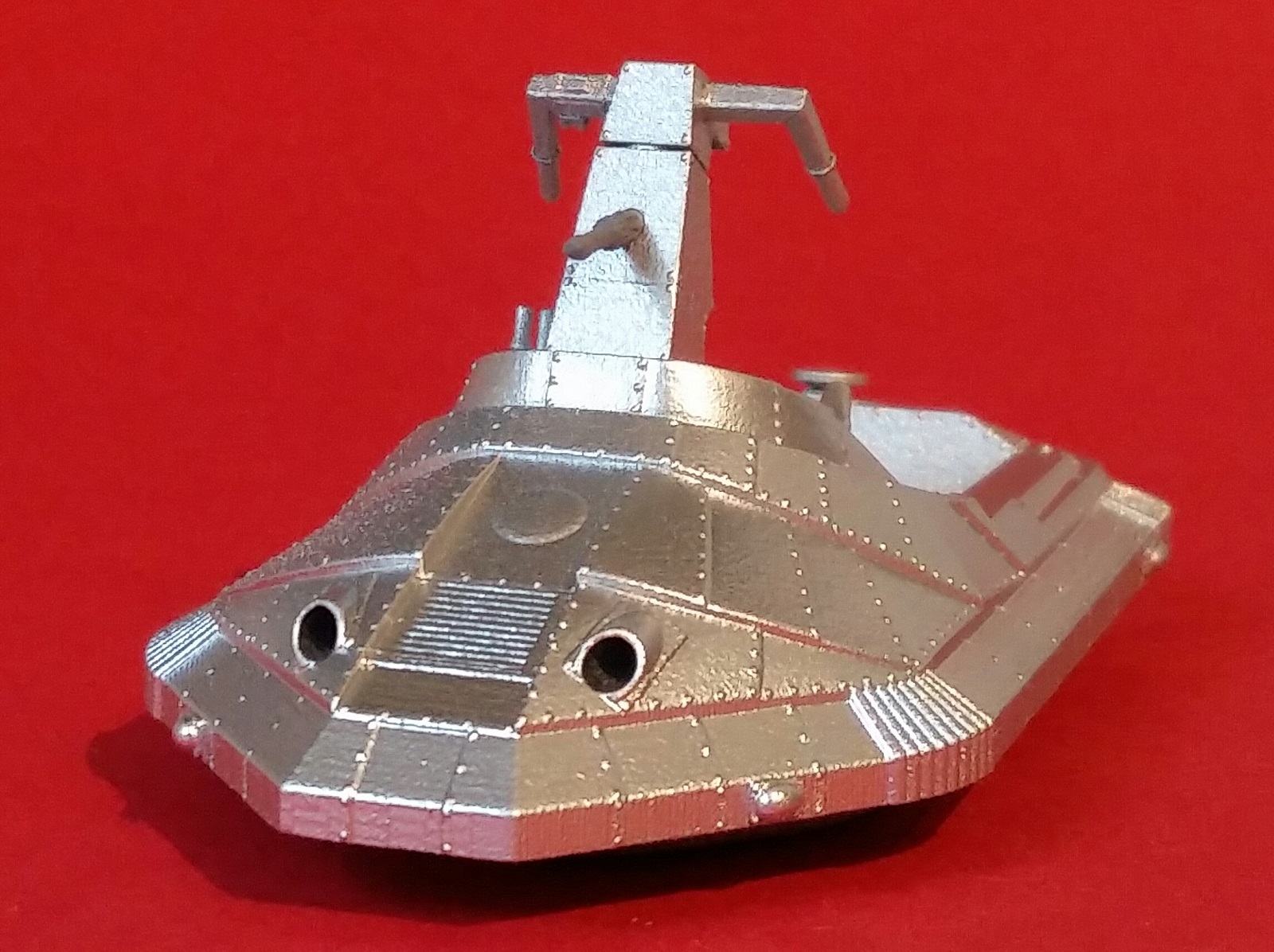

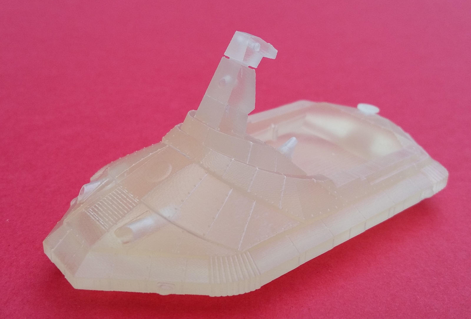

Just got home and received my tiny 79mm long 1:43 scale Detail Plastic print from Shapeways!
