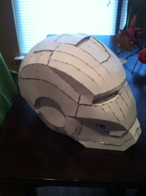

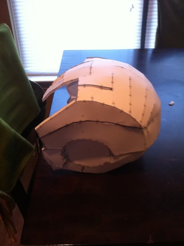

After reading through lots of threads and looking at tons of pictures I decided to try my own project. So here is my first attempt at the Iron Man Mark VI Helmet.

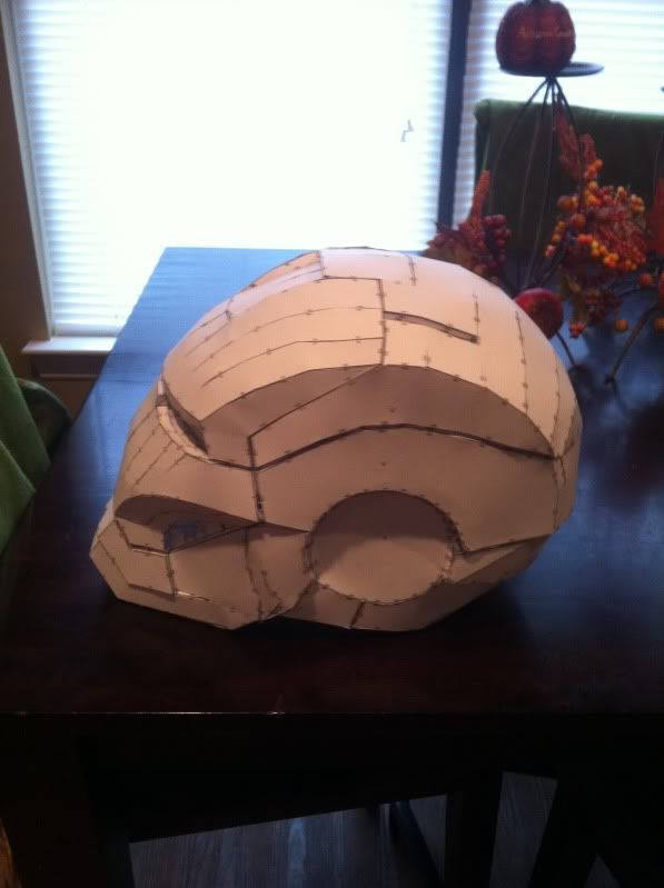

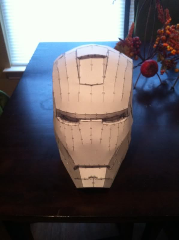

Well heres an update. I finished my pep work on the helmet. Its not perfect, but I think its pretty good for a first time.

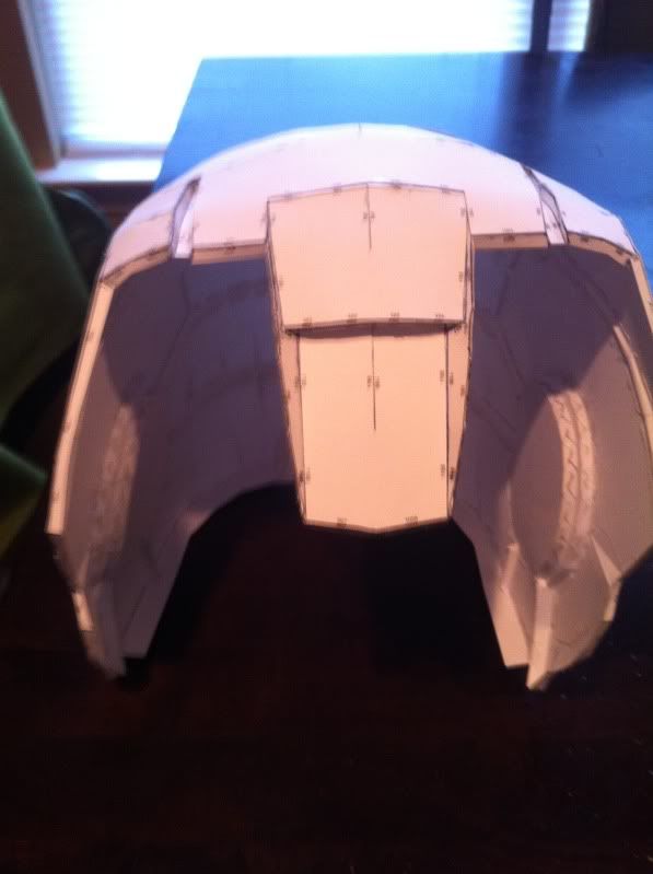

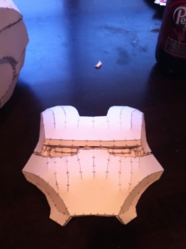

And this is how I attached the faceplate and jaw for resining. Hopefully it will keep everything straight and be easy to seperate after it hardens.

Very clean! I'm starting the exact same helmet too. I have all of the major pieces done, but I just need to work on the little things. Seeing your photo on how that part sticks out from the rest of the helmet (photo #2) is a huge help. I'm a little bummed that now I'm probably going to have to take that part apart, but I'm glad I saw it now while I'm still in that area.
Good idea on the paper clips too! Pretty crafty! ahha
Thanks you. It really made a huge difference when I put it all together with the clips.

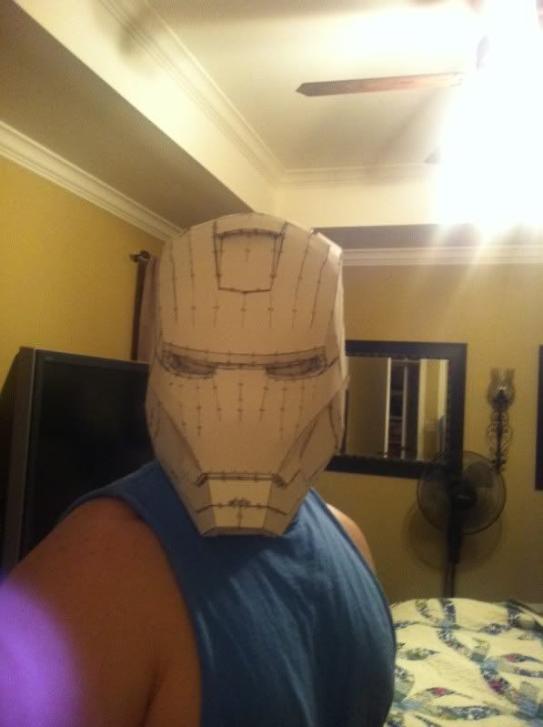

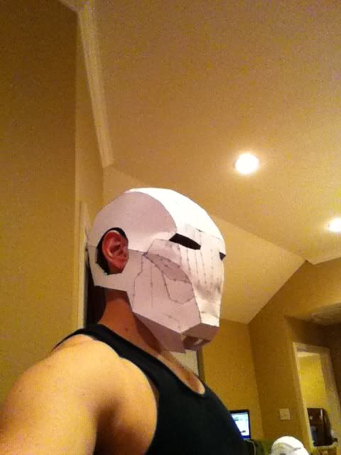

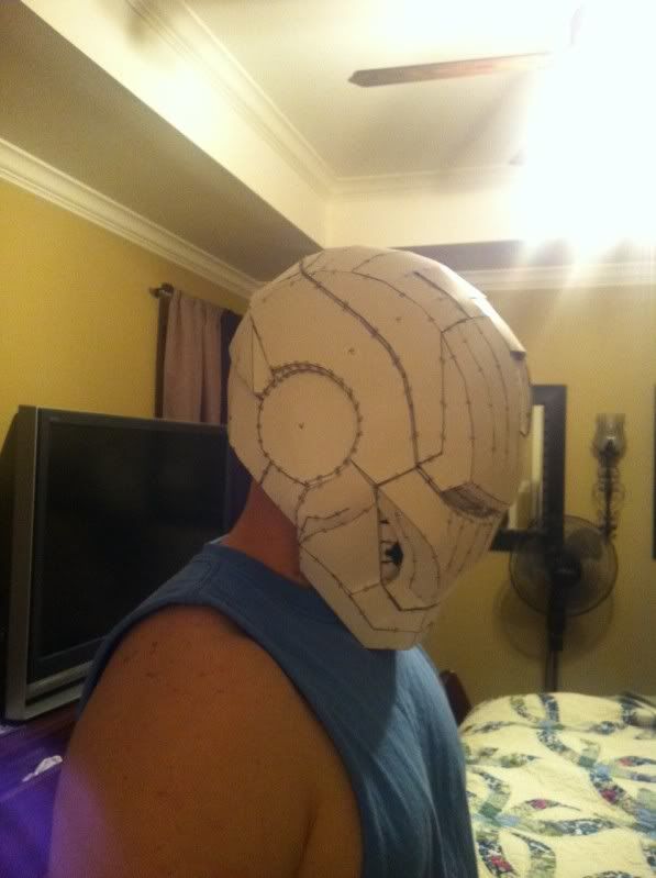

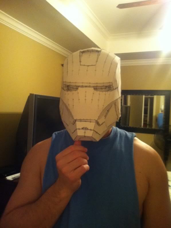

Mine is also too big. But it was great practice. I put some pics to show how it fits me. I am going to finish this one out and them build a second one. I "plan" on doing a whole suit. LOL

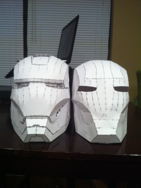

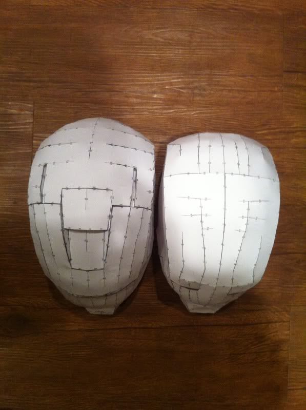

Since my first helmet was way to big I pepped out the tester helmet. I scaled it down to .93 this time. Its definatley much narrower but I think the depth is still to big for my head. Maybe I should scale it down some more. What do you guys think?
Original on Left, Tester on Right
Nice work on the sharkmark, not a easy helmet to pep just completed that one myself! I recommend gluing the face plate to the helmet and cutting it off in the finishing stage, you will get a MUCH better fit to the two parts if done in the finishing stage. I look forward to your progress
Thank you for the advice. I thought it might be better to resin the whole thing together and the "pull" it apart before bondo. But I will trust your advice. I've seen your work, it's great!!! What scale did you use?
