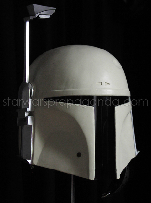

The helmet is a direct cast from the PP2 Fett helmet (from Rogue Studios) which is the actual helmet used in all the action figure packaging back in '78.
For those who don't know, this style casting is the most accurate in all fandom.
I'm slowly putting together a full size ESB Fett display.
It's going to be awhile before I get to painting this helmet, so in the meantime, I wanted to finish the interior as much as possible.
It's not an exact match (as I realize that is unrealistic) but it's definitely by far the most accurate attempt at an accurate screen used or production made Fett helmet to date.
I'm sure as time goes on, I'll continue to tweak it.
Here are some pics of the real deal screen used ESB hero.

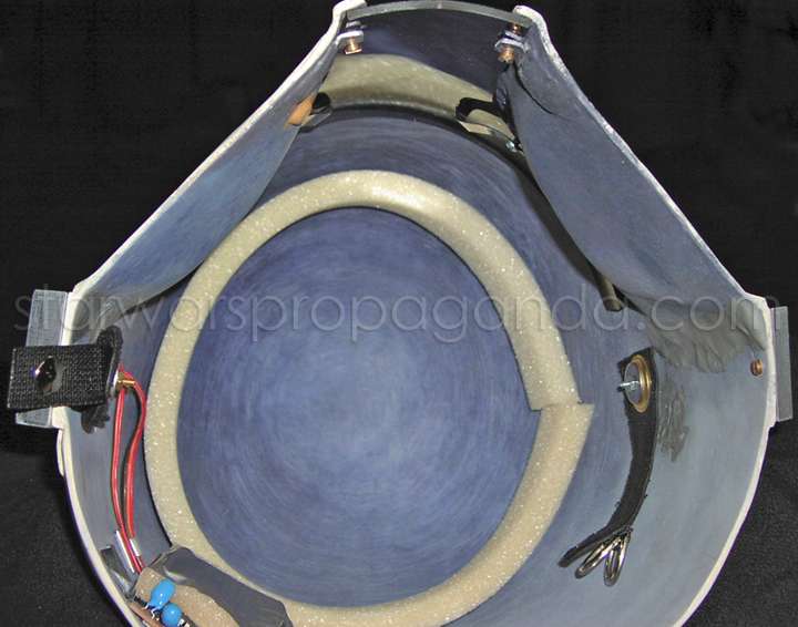

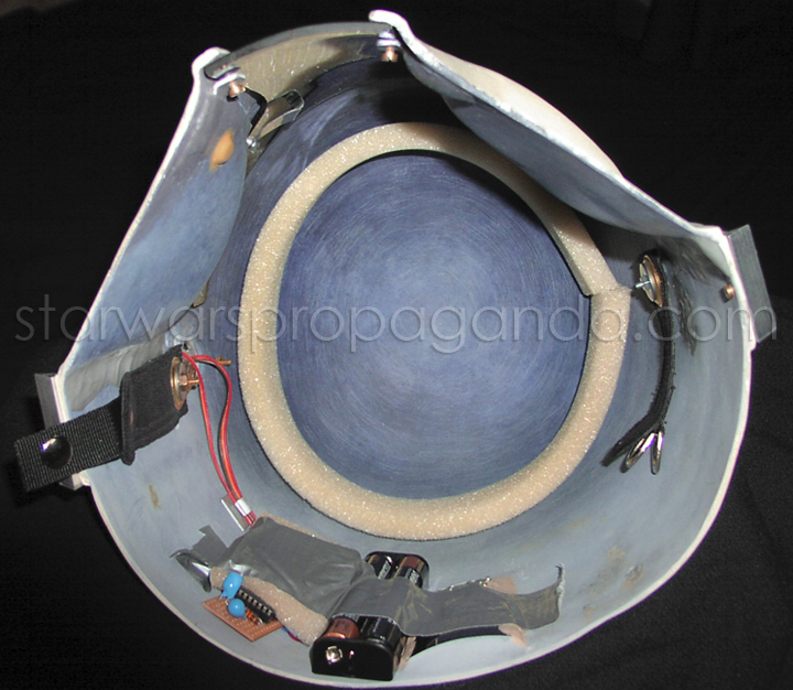

And here is my replica so far. Still looking for the correct helmet liner (which happens to be the same as the type 2 ROTJ trooper helmets.
INTERIOR

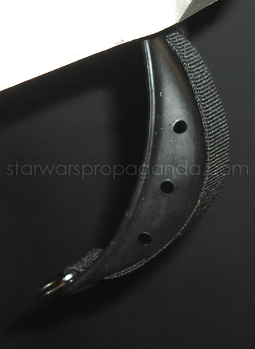

CORRECT CHIN CUP

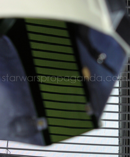

.125" DARK GREEN VISOR

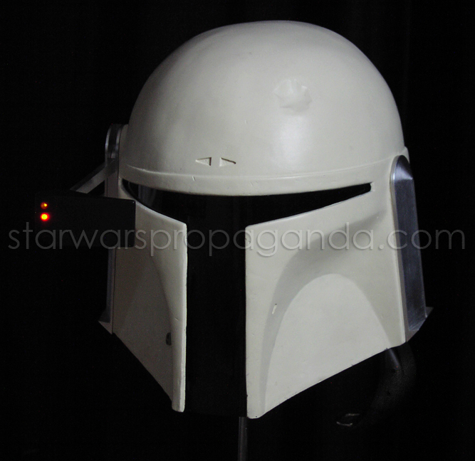

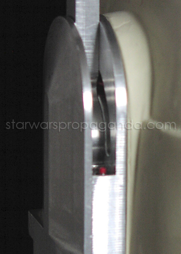

PUSHBUTTON TO ACTIVATE RANGEFINDER LIGHTS
EXTERIOR SHOTS
RANGEFINDER LIGHTS ACTIVATED

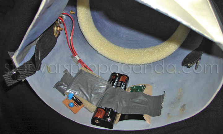

Off to a great start ! I was going to use a mercury switch inside the rangefinder for the LED's, your way (screen accurate) seems much easier !

The thing that bugs me the most is the interior surface of the casting I have. There is just no way to recreate/replicate the randomness of the original interior surface. Every fiberglass piece is going to be somewhat unique.
As far as what was inside the original ESB helmet vs. how it looked post filming, I decided to go post. Because NO ONE (that I or anyone I know of) has ever seen the interior during the ESB production. Going by anything other than what we see in that photo is pure speculation.

but the conection from the mother board to the battery look to be a 9v... Oops a closer look, look like your on the ball.. Maybe they modded the pack to work with the conecter.

Yes, I've not yet found the correct vintage 4 AA holder. The one I have is the closest I've come across.
About the visor mounting.
I'm pretty sure the visor mounting method was specifically designed to allow the visor to install/uninstall easily. Otherwise there are far better and less complicated methods.
They used metal tabs at the bottom for the visor to slide through and as you tighten the screws, it secures the visor in place. There are also some metal clips that are attached to the upper inside mandibles that have a screw that as you tighten down, it applies pressure to the visor which causes it to press tight against the mandibles. It looks sketchy, but that method actually works like a champ.

Anyways I better get to the reason I'm posting again, the liner look like te one my Dad had in his old construction helmet from way back.. 70's
the one thing that triggers the memory is the grey wire that ties all the black bands together, iirc the hemet was fiberglass as well & has a removable (zippered) ear warmer flap, red quilt type look to it.
