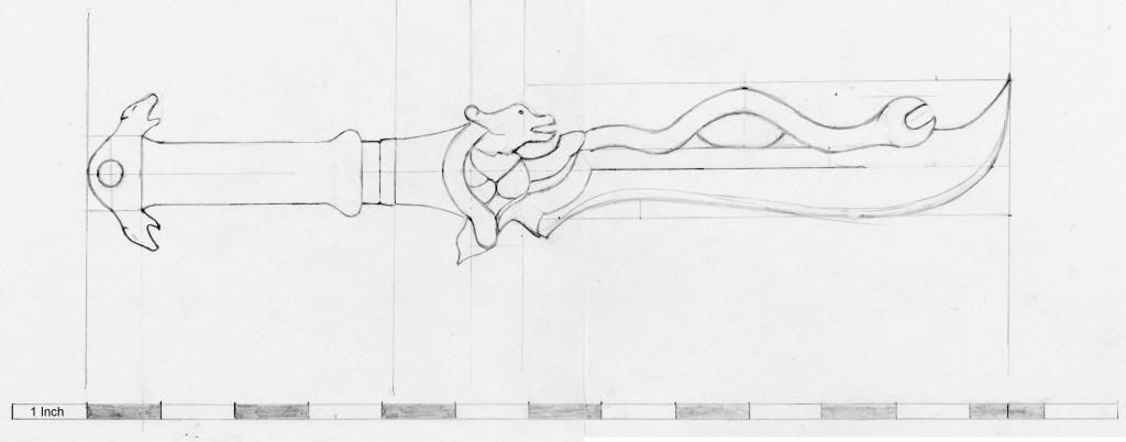

I’ve collected Props for a while, and now want to attempt a scratch build. The prop in question is from Far Cry 3, the Ancient Chinese blade.
I’ve collected as many reference photos as I can, a friend has drawn It on a tablet so I now have something to go from in rough scale.

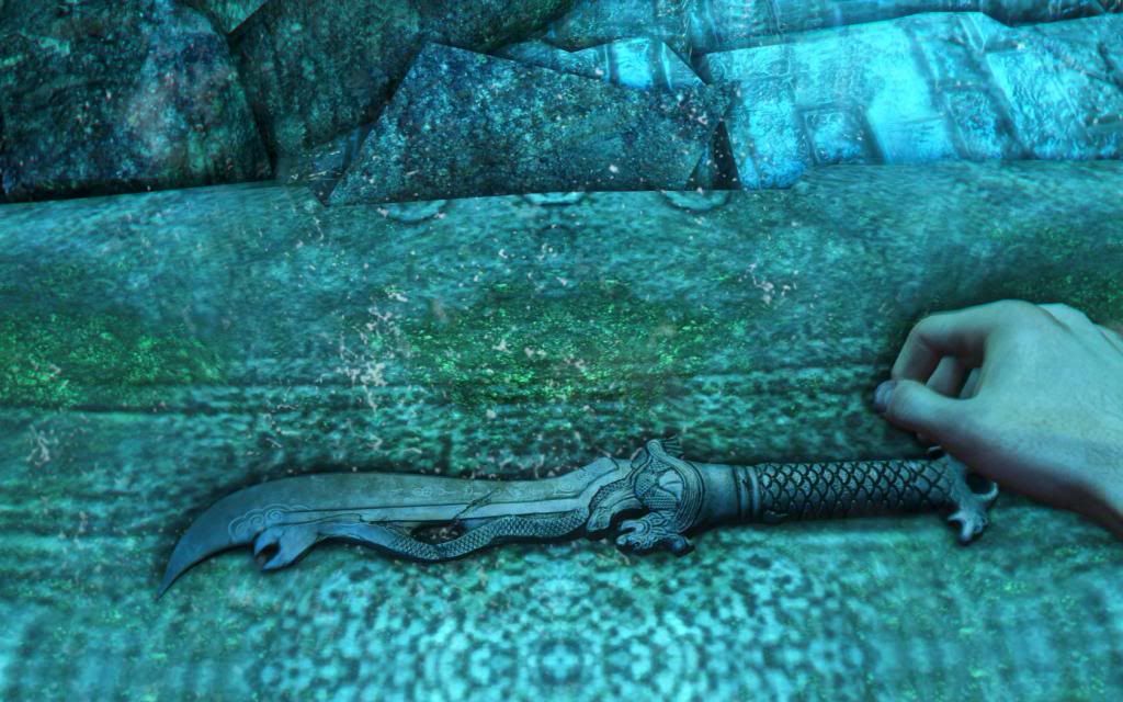

I know some PC games have a 3D model viewer, is this common? Is far cry likely to have it? This would be great reference material if possible. My main issue though, is what material to build it from. My initial thoughts were to build a simple version in wood then adding detail with putty on top… ? But I am not sure how well the putty would adhere to the wood or if it would show seem lines.

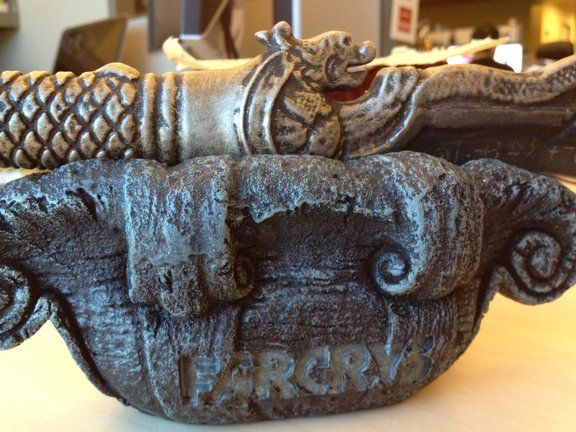

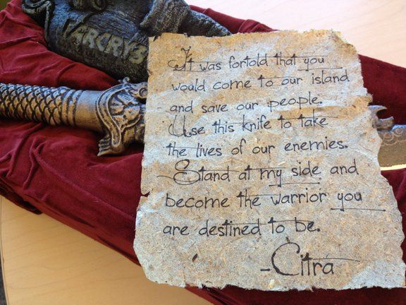

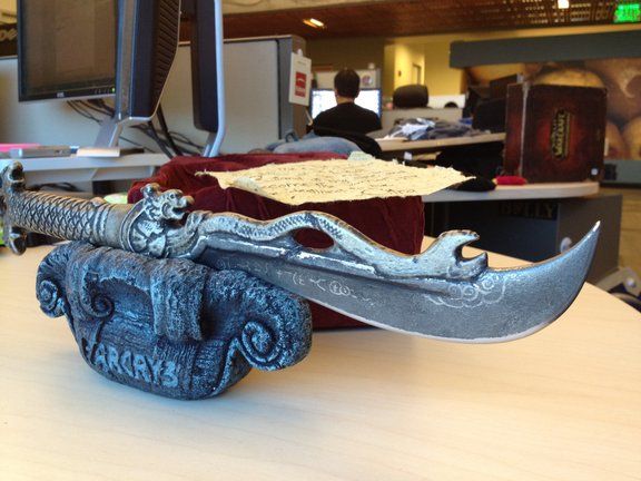

I think your scale is a bit off, this "promotional" item they gave away was pretty big. The Citra note is about the same size as a regular piece of notebook paper. I'm not good with scale, but I'm guessing the dagger about 15~16 inches long.
Hi Maaso,
I think you're dead right.
At first i thought it couldnt be longer than 13" but after doing some crude calculations on the scale i think it is no shorter than 14.75" and no longer than 16", so im thinking around 15"-15.5" what ever feels nice after i create some templates.

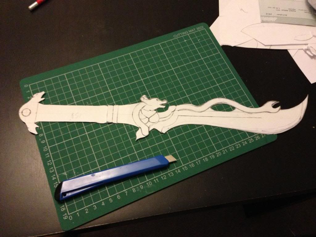

A tiny update, a move from digital to the real world i have a template ready for using with wood.
I have tweaked the the scale and certain details from the 'master' drawing to make it more accurate. When i can i'll get the coping saw out and cut the 2D blank out of wood, get some milliput and start the puttying process.

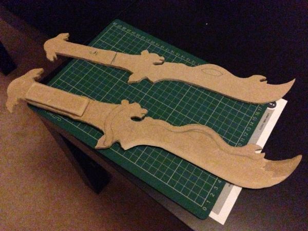

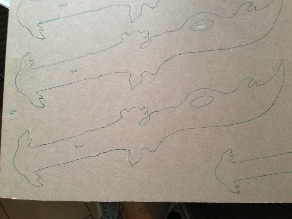

A little more to mention, got the templates drawn out onto a sheet of wood. I drew out two sizes of dagger to work with.
Cut out the larger the other day, sanded it down, refined the shape some more. The tip of blade was a bit delicate and had blunted a bit so I have dipped it in glue for the time being, I added some bulk to the handle to save on putty, will be adding more bulk to it tomorrow as well as cutting the holes. With any luck i can start puttying this thing soon!
I also cut out the smaller dagger today, now wondering which is the best size, i will continue with the larger and see where it takes me.
