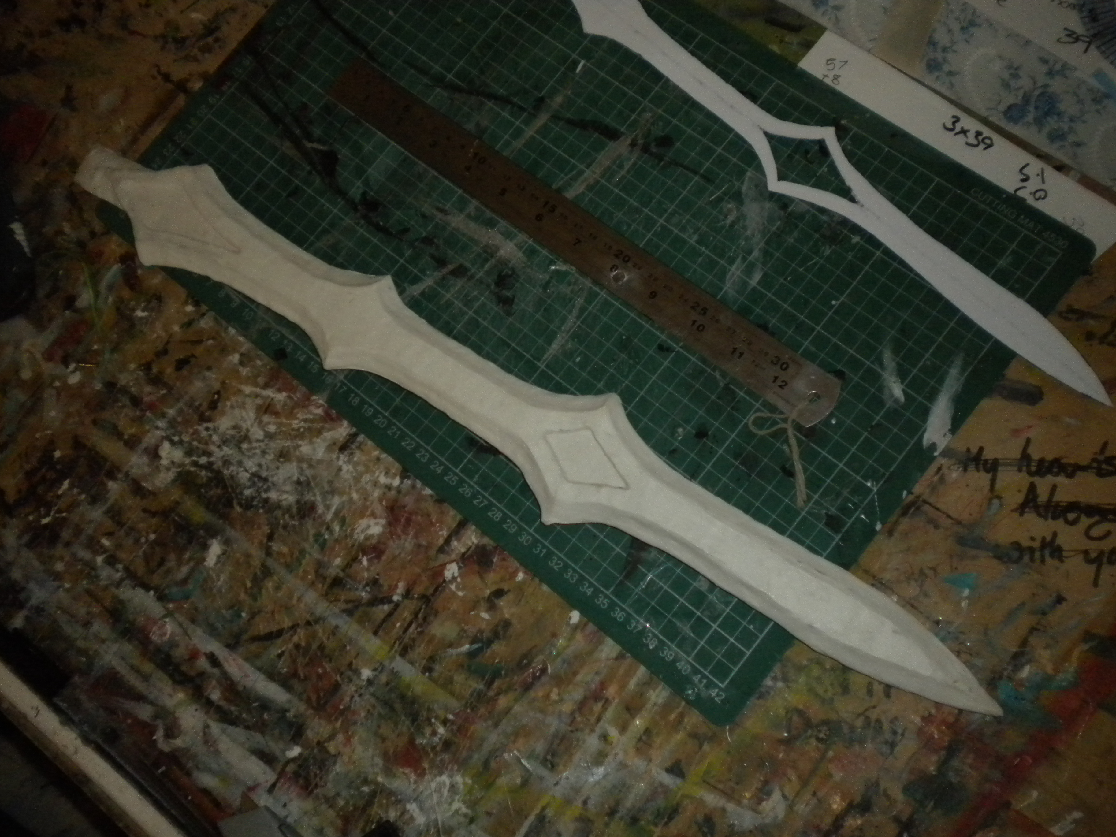

I am also curious on what style of sword this will be. Could you show a picture of your clay mockup?
this is great thanks everyone for taking the time to reply, it going to be Lady Sifs sword from Thor: The Dark World and here is a picture of my clay model:
I think you're probably right about clay not being the best for casting, I was quite pleased with the results at first but the more I look at it the worse it gets haha, there's a lot of little waves and uneven areas that would probably look really messy if I cast them, I think maybe I'll just start over, a lot of the methods you guys have mentioned sound better than trying to make this one work,
sorry I probably should have mentioned the sword is for cosplay at a comic con, so I don't think wood is a good option as they wont let me in with it, I also don't really have the equipment for wood work,
I really liked the Daedric sword tutorial you posted Novacat17 and I have a dremmel and a hot wire cutter I could borrow that could come in useful for that method, I think maybe that type of thing could work better instead of the clay, I have all the layers cut out in paper so I can reuse those and I also have an old sleeping mat I can cut up like RvanAken suggested, its not the best sleeping mat but it might be good to at least practice on before I spend anymore money as I'm on a pretty tight budget at the moment, I've made things out of craft foam before and just layered it in PVA glue then a primer spray and its painted up pretty well do you reckon that would work here too instead of latex? I appreciate that you have to spend a bit of money but I'm really trying to use stuff I already have as the budget is getting a bit out of control on this project!

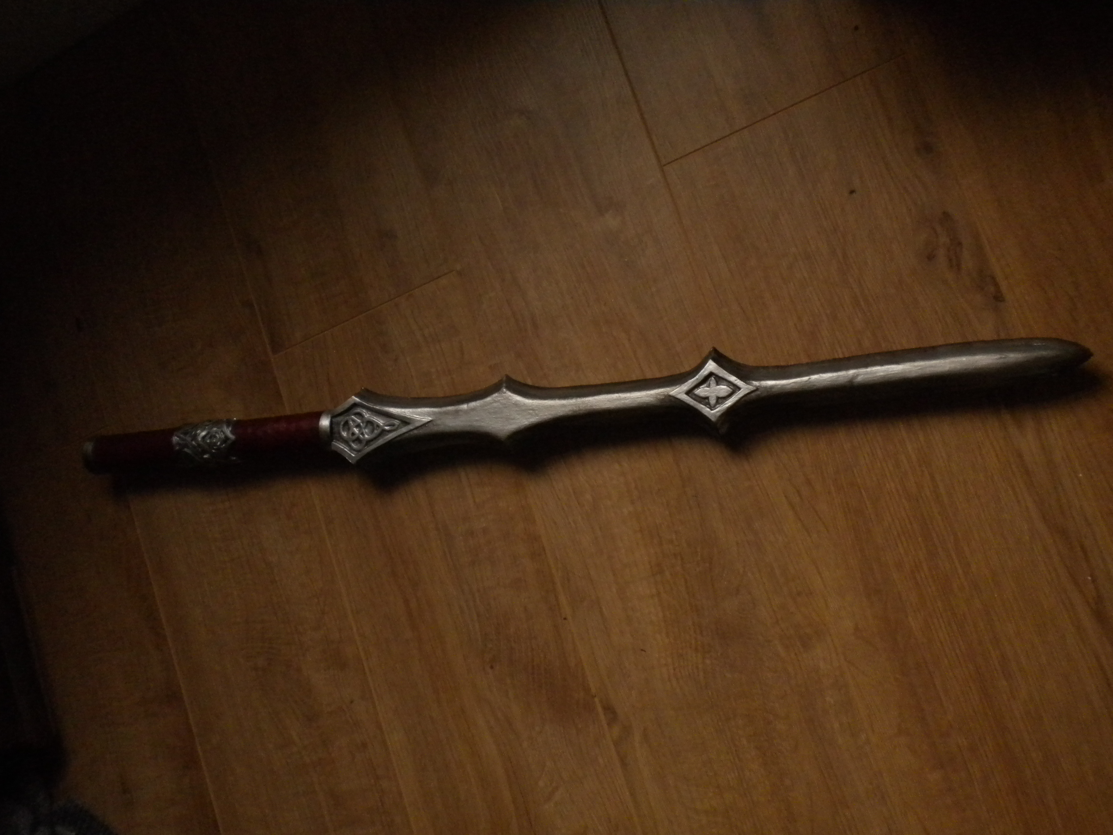

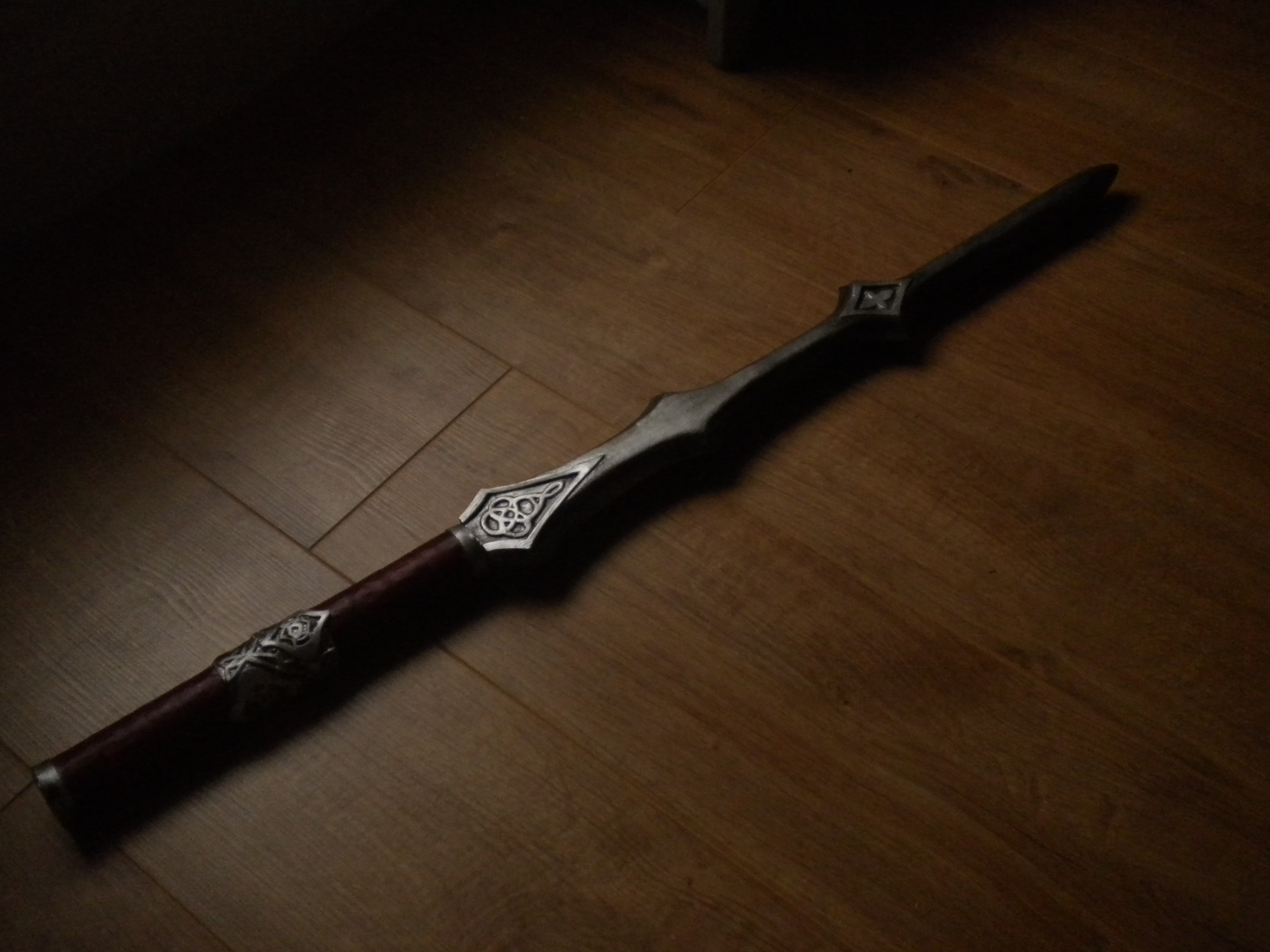

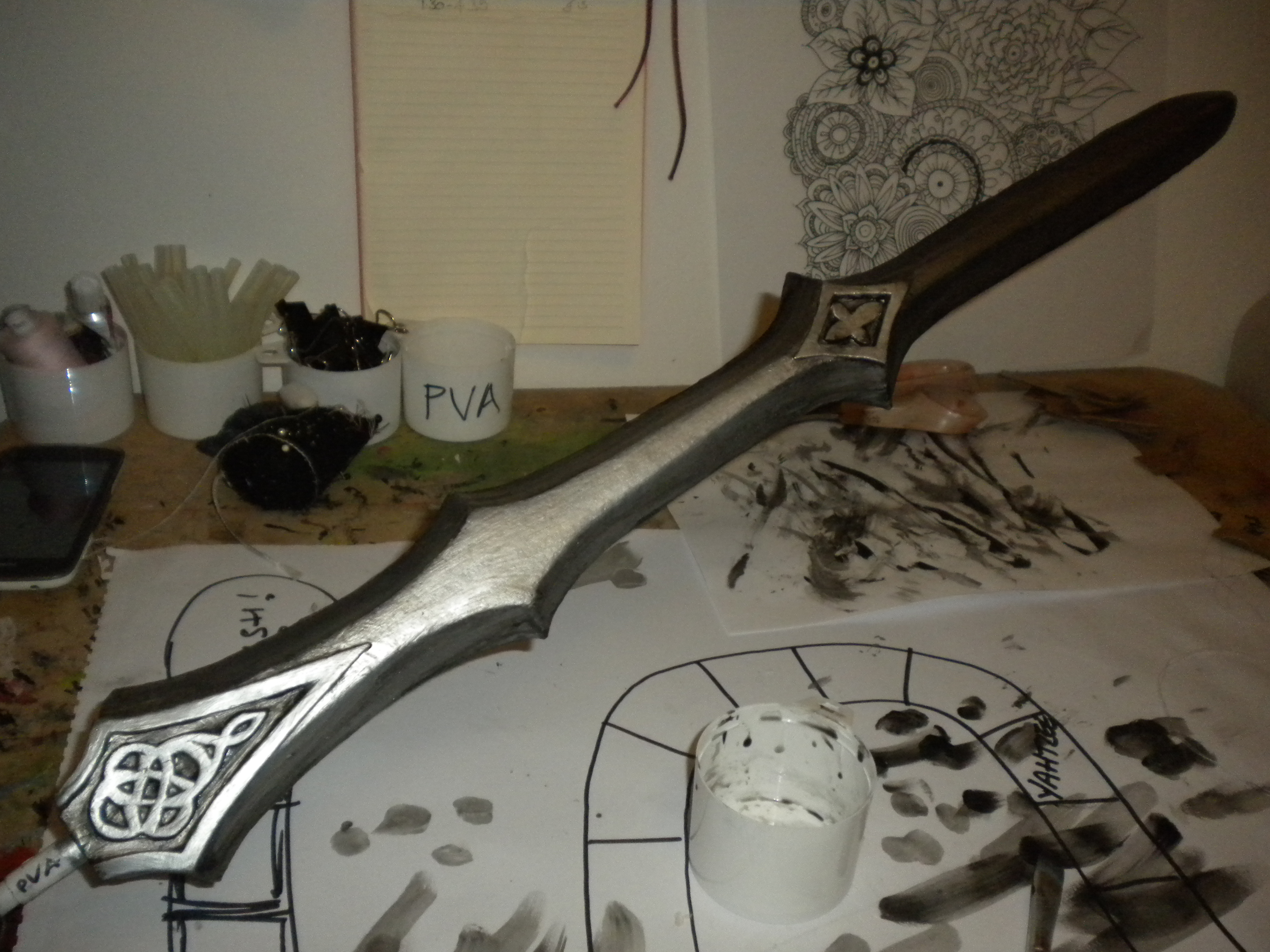

Hi Everyone, I know I posted this question quite a while a go now but it has taken me several attempts to get my sword done, anyway I wanted to let you know how it went! this is version 4.5 (I say 4.5 because on one attempt I couldn't even get the foam glued together haha)
I think there is still room for improvement in several areas like you can kind of see where the pieces of foam join together and it's a bit rounded on the end, I kept trying to make it pointier but it was just making the sword shorter and shorter every time I shaved a bit off so I gave up haha but I'm happy with it for the moment, and I've learnt so much getting to this point so thanks so much for all you're tutorials and advice it has been invaluable :)
That looks really great, especially for a first attempt! I stumbled on your thread and really love how you took the general suggestions from people and created something really cool. Great job. Do you have any in progress pictures you can share?

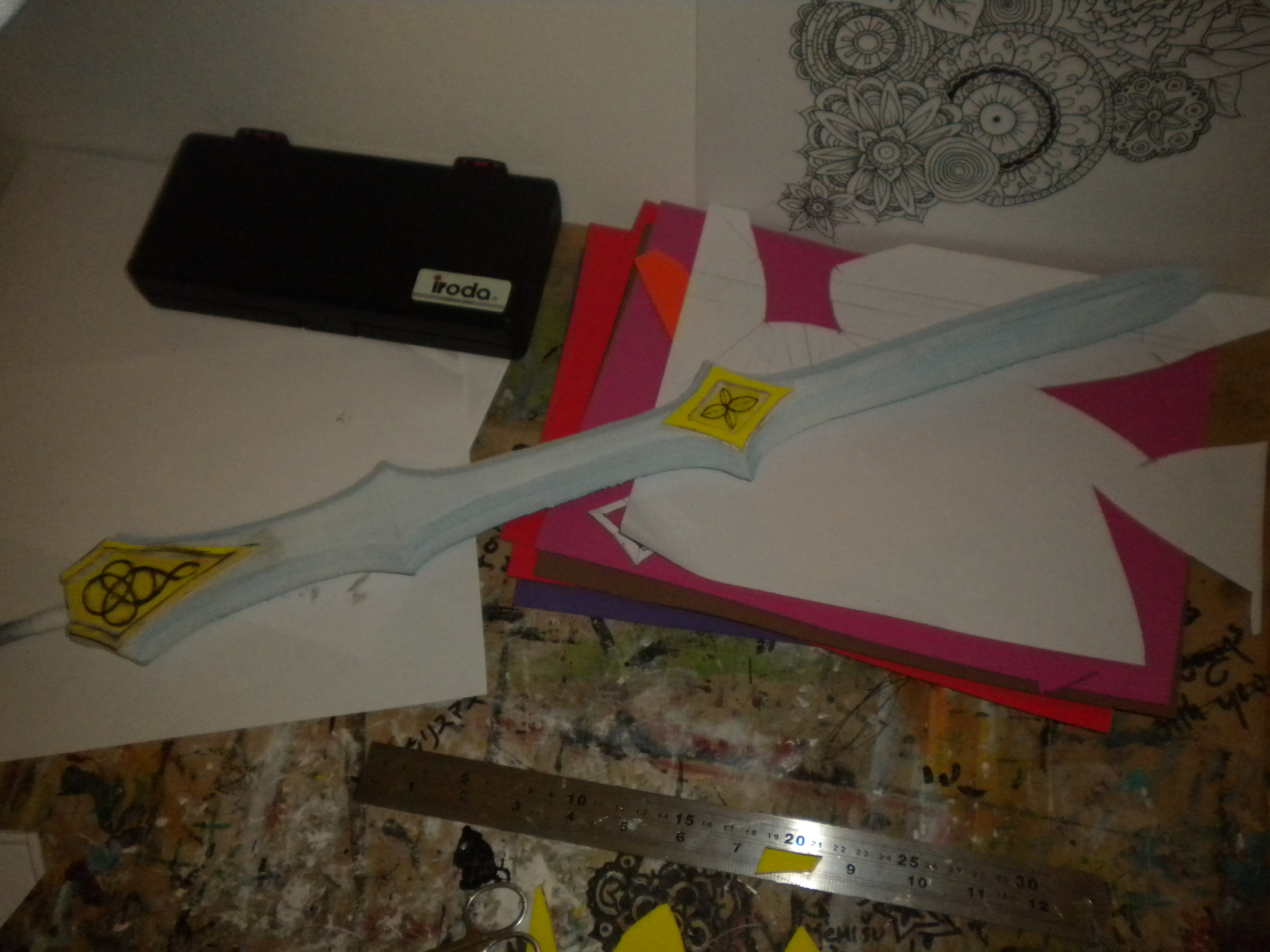

thanks! yeah everyone's been really helpful, I'm a bit rubbish at recording my progress but I did take a couple of photos:

That sword turned out great. Good job.

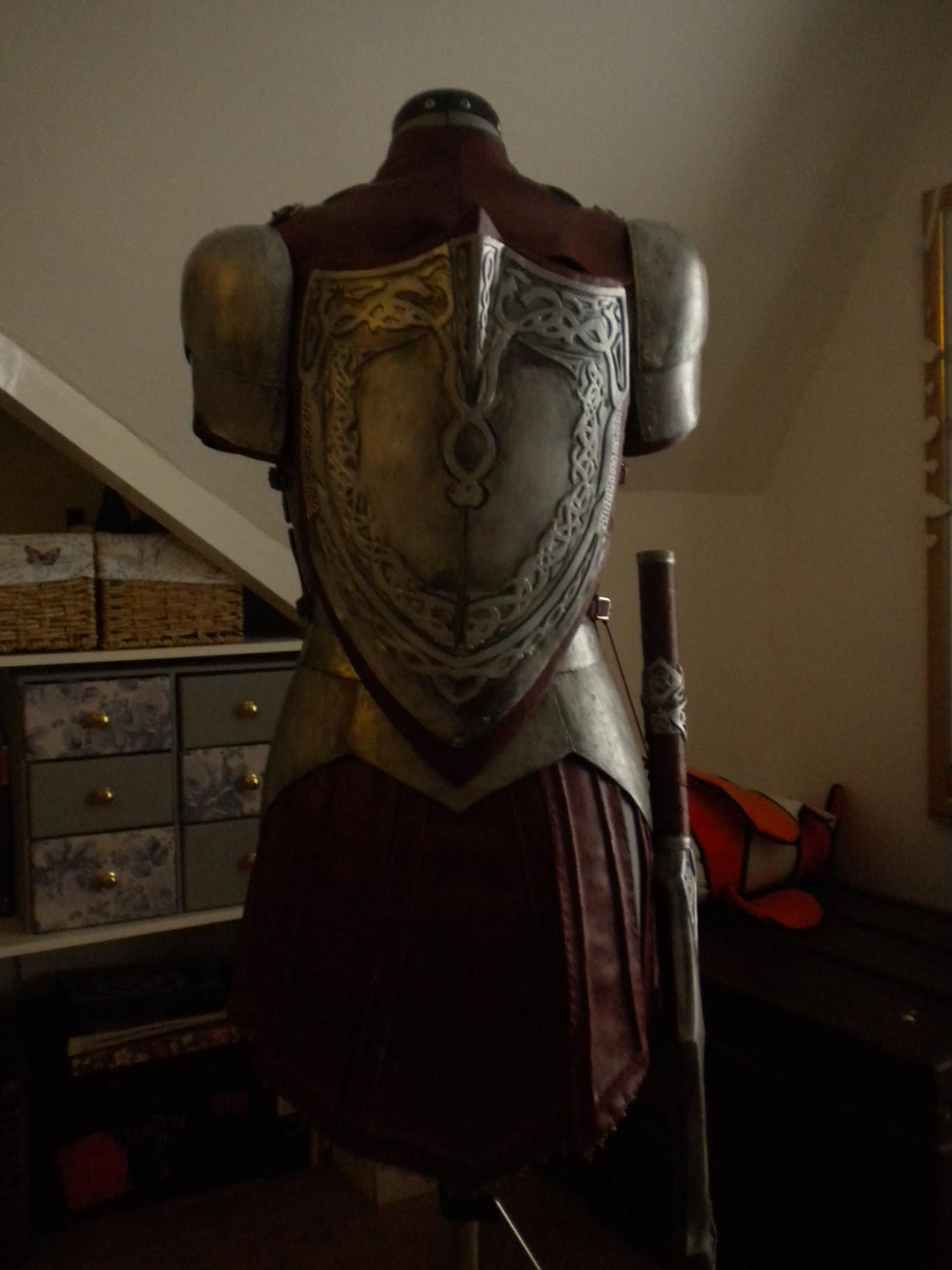

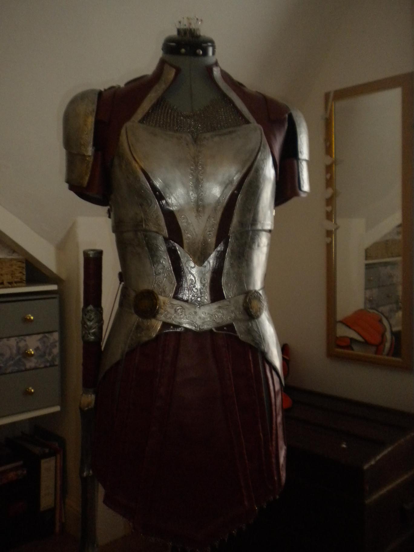

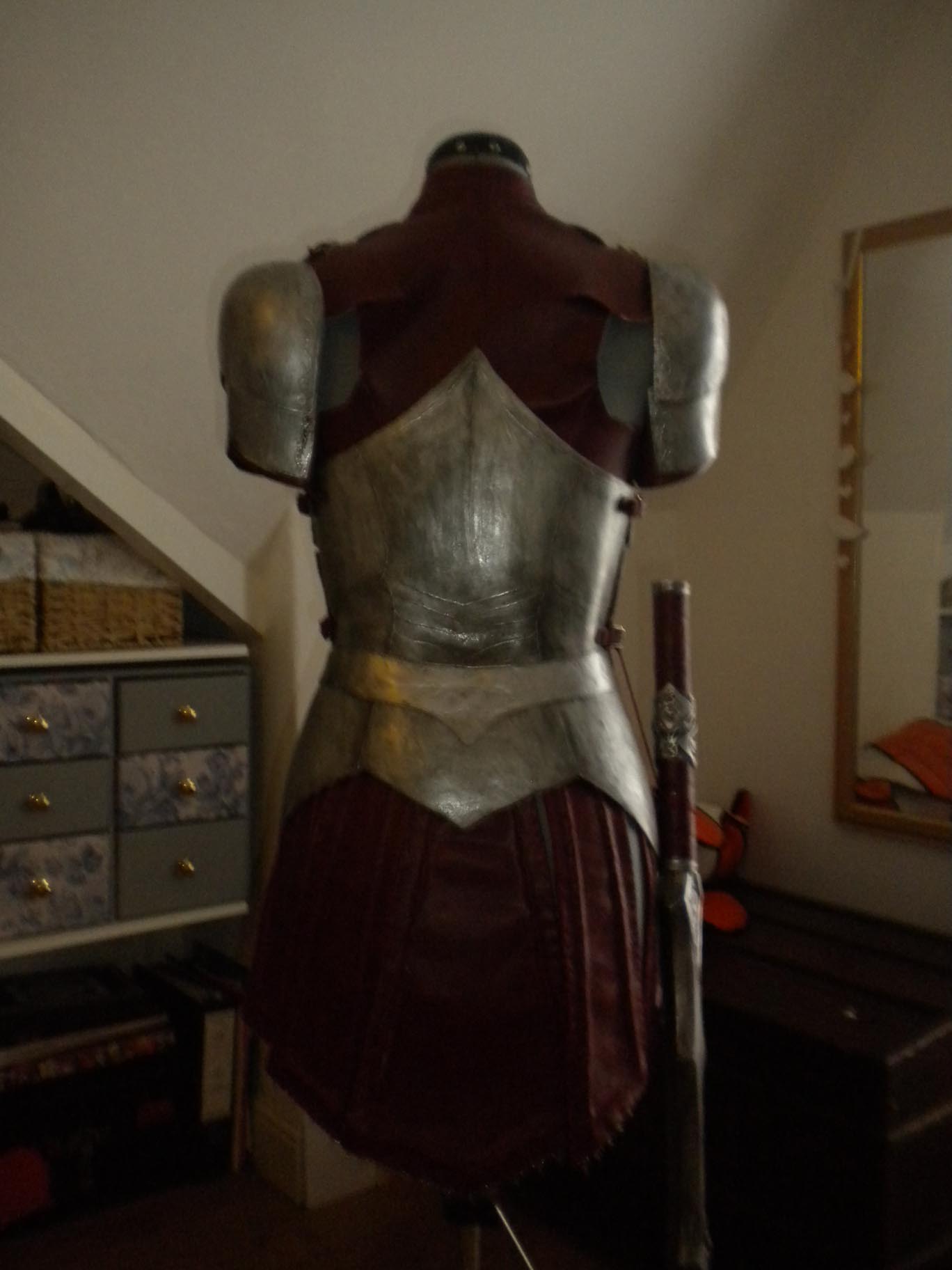

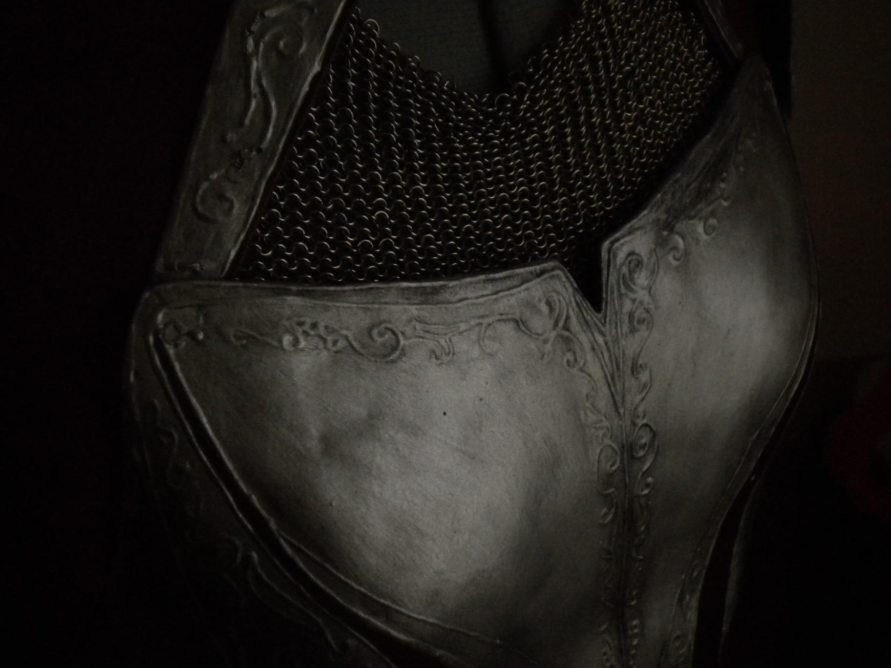

thank you, I don't have any photos in the costume yet because it's not quite finished so I'm kind of saving it, but I've got some of how it is so far:
I still need to make the leggings and a chain mail skirt then its pretty much done!
If you wnat more feedback and advice, look up the plasti-dip artists group on facebook. Reading through the thread all the methods mentioned work, some more difficult than others
