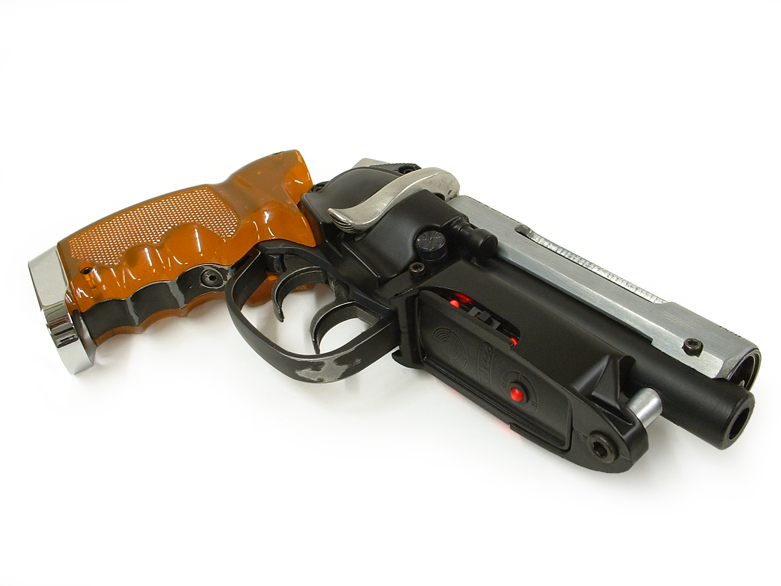

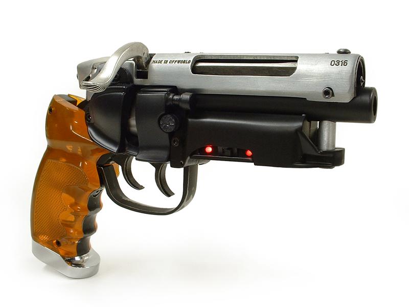

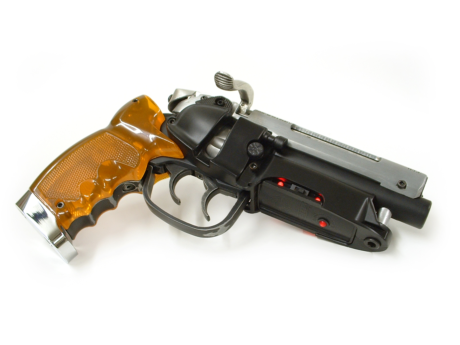

Ok, so I started out just wanting one in my collection, had several over the years, and then as time grew, kept upgrading. My ultimate is a Coyle, and I have a deal in works, but until then I wanted to share my current baby.
It started out life as a metal Off World production model. Then I swapped out the bolt, rear bolt piece, and cocking handle with a casting of Coyle's and fit it to my blaster. Then I stripped the OffWorld receiver and buffed them to blend in. Then I decided I wanted some weathering, it was just too NEW looking and did not go with the bare metal look. So I scuffed it up in some areas, and decided to use a matte clear on the shiny black pieces. I also didn't like the black plastic tube that held the magazine and barrel together, so I machined one of those.

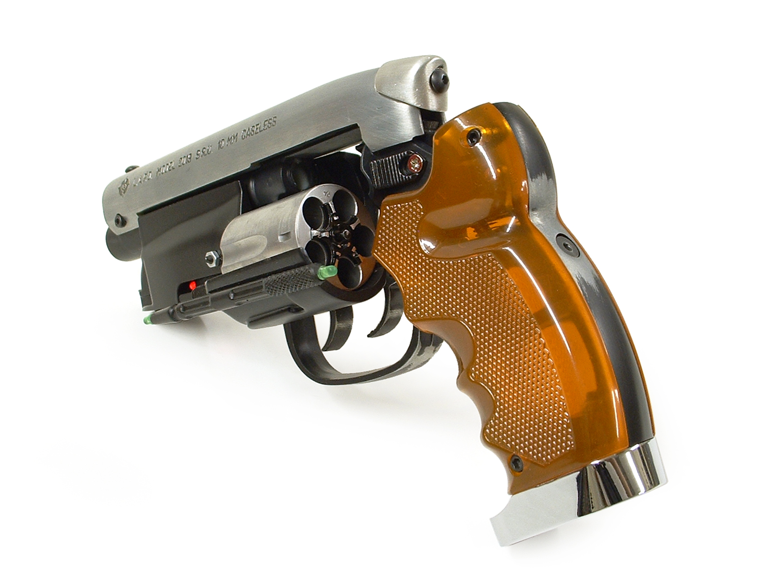

Then one of the things I love on the real one is seeing that metal cylinder when the cocking handle is up. So I ordered a real .38 Special cylinder (since that is what this OffWorld version is based off of). Got it in and was disappointed it was too large around. I had to strip it down and try to make it all fit. I had to mill new holes in the ejector piece to fit a real cylinder, and shave the ends of it. Next was chucking it up in the lathe and taking down the diameter to fit. After that, I buffed it to match the receiver, and got it all installed last night.
I am very happy with how it turned out, and wanted to share some pics. :)

Is that as far as the bolt retracts?
Nope it goes back a little further. Still wanna tweak it some though.

Just my luck! Good news for you tho! Mine was a Taurus .38 special. What did you get?
Hmmm you wouldn't think there'd be much difference between manufactures, but apparently so.
Maybe for direct clones (i.e. Taurus PT 99 and Beretta 92) but there is a great deal of difference between firearm parts from different manufacturers. Same way I couldn't buy Pistons from Ford and cram them into my Chevy engine.
Nice pistol! I really dig the mods you did on it. A possible reason why the cylinder didn't quite fit: Taurus is renowned for over-engineering their firearms. And it's quite possible you got a cylinder that is rated to fire +P ammunition. Hence the slightly larger diameter. The chamber spread may be slightly wider than a standard load CA cylinder as well.
