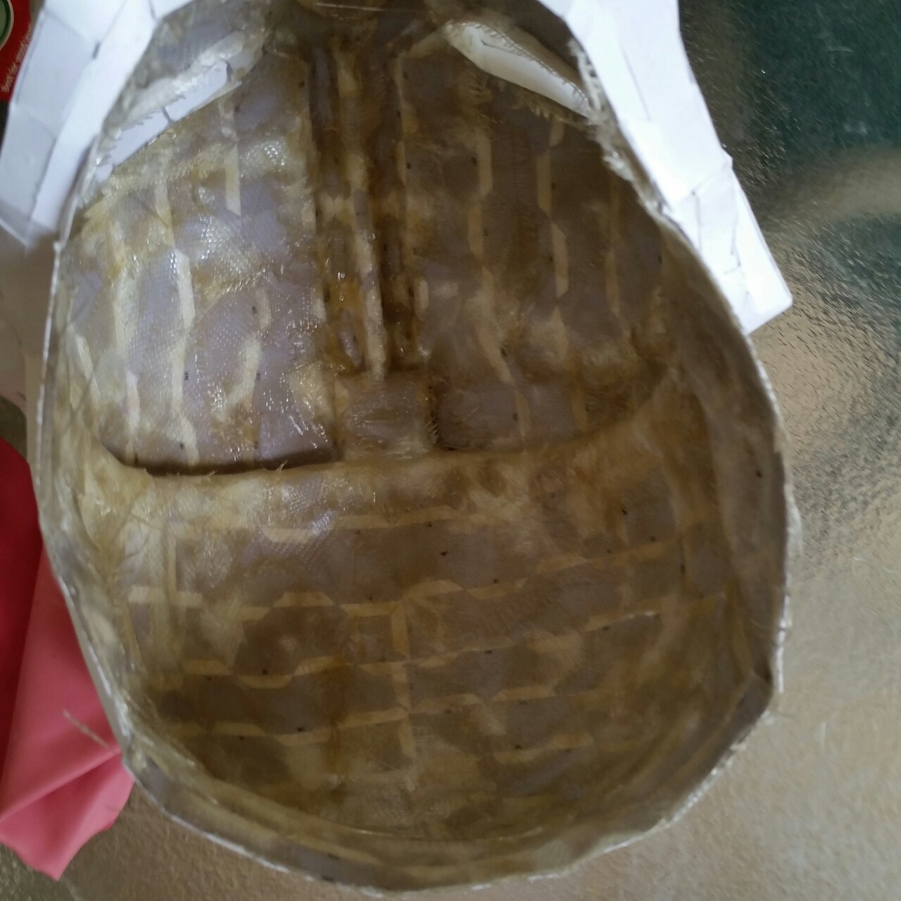

Need help with a fiberglass helmet project I started on. This is my first time using fiberglass and resin, and I think I goofed, as it came out with alot of air bubbles. Any way to remedy this, or is it scrap at this point?
looks pretty good to me.
Use a dremel or a drill to make holes in the bubbles and fill it with resin.
If the bubbles are tiny enough you may even be able to use "bondo" glazing compound. It fills very small bubbles easily without having to mix a hardener. It's also much easier to sand.
