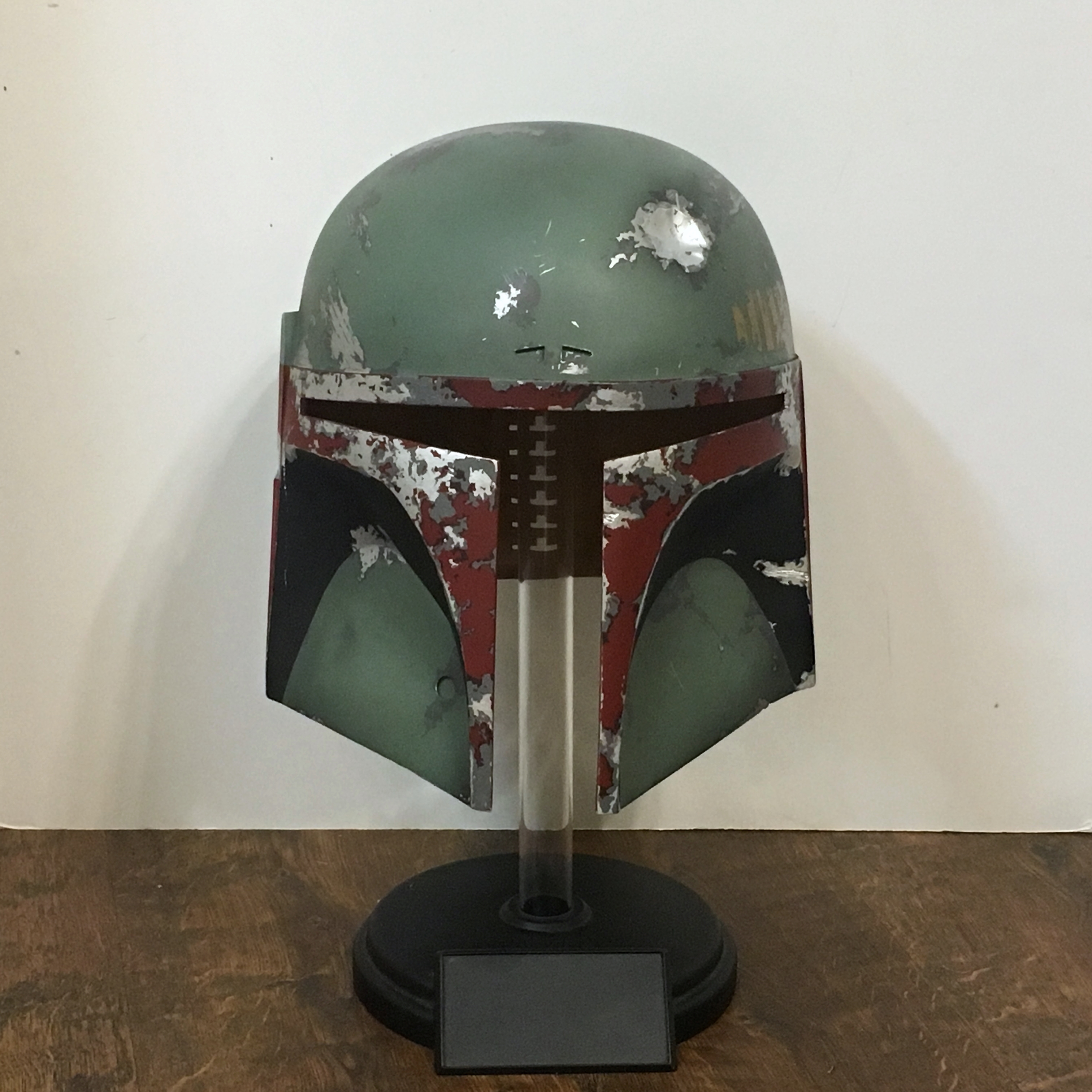

Thanks Dann! I am not using one brand of acrylics exclusively but I am using acrylics exclusively. The reason I use acrylics is mainly because they're non toxic easy to clean and I like that they dry super quick and can by diluted with water. I'm also pretty pot committed being that over the course of 3 years I've made well over 100 different personal swatches of acrylic paints straight from the jar and of custom mixtures. I've spent a ridiculous amount of time and money on acrylic paint. The first Fett Helmet I ever painted I used some Humbrol acrylics because of a thread I found with a Humbrol paint by numbers for the ESB Fett Helmet. Unfortunately I have zero experience with humbrol enamels but personally I'm not a fan of their acrylics (with the exceptions of their gray #79 as a topical paint only). I do not like the way they feed through my airbrush with any amount of thinning.
Paint by numbers link:
https://www.thedentedhelmet.com/for...visual-guide-esb-rotj-helmet-esb-armor.23134/
The helmet below is the first helmet I painted in a layered, masking technique following the list of colors from the link above with the exception of the below listed colors.
Silver: Testors Gloss Metallic Silver (enamel aerosol spray)
Dome Green: Humbrol #73 + Model Master POG 1946 1:1
Mandible Red: Model Master Brittish Crimson

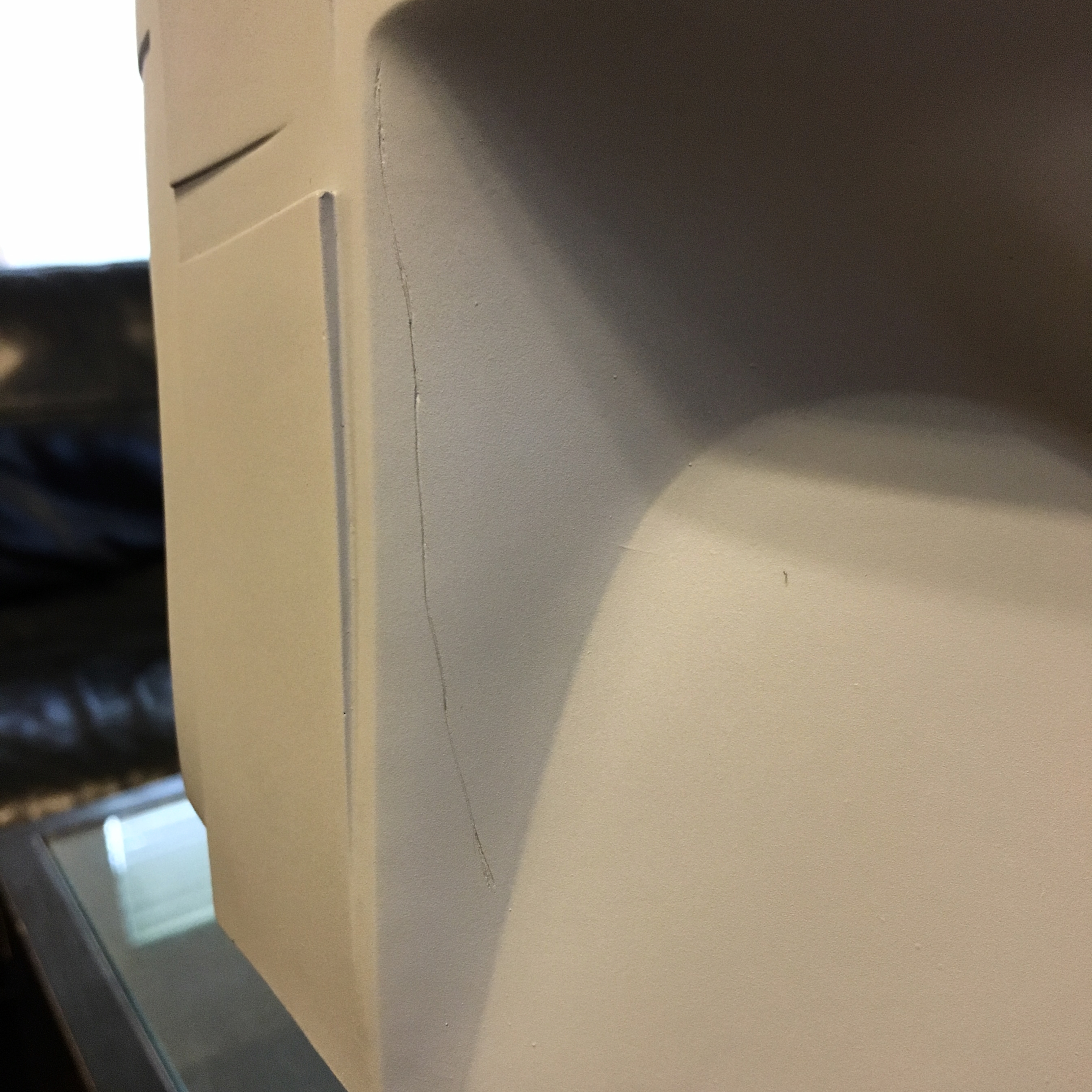

Do you know if that's a crack or a seam-line up the right cheek/earpiece/brow of the original?
Looking forward to seeing it all finished, NoirShadow is going to be getting a beauty of a replica!
I love this idea with the vacuum bag of dust :D I save the grime weathering for the very last stage of the paint up. I do want to clarify that this will be an ESB (as seen on screen) paint-up so it won't have quite as much grime, scratches or damage from the accumulated years since it was filmed.
It is most definitely a crack, and it was apparent during the filming >>>
This is the crack that I made for this commission >>>

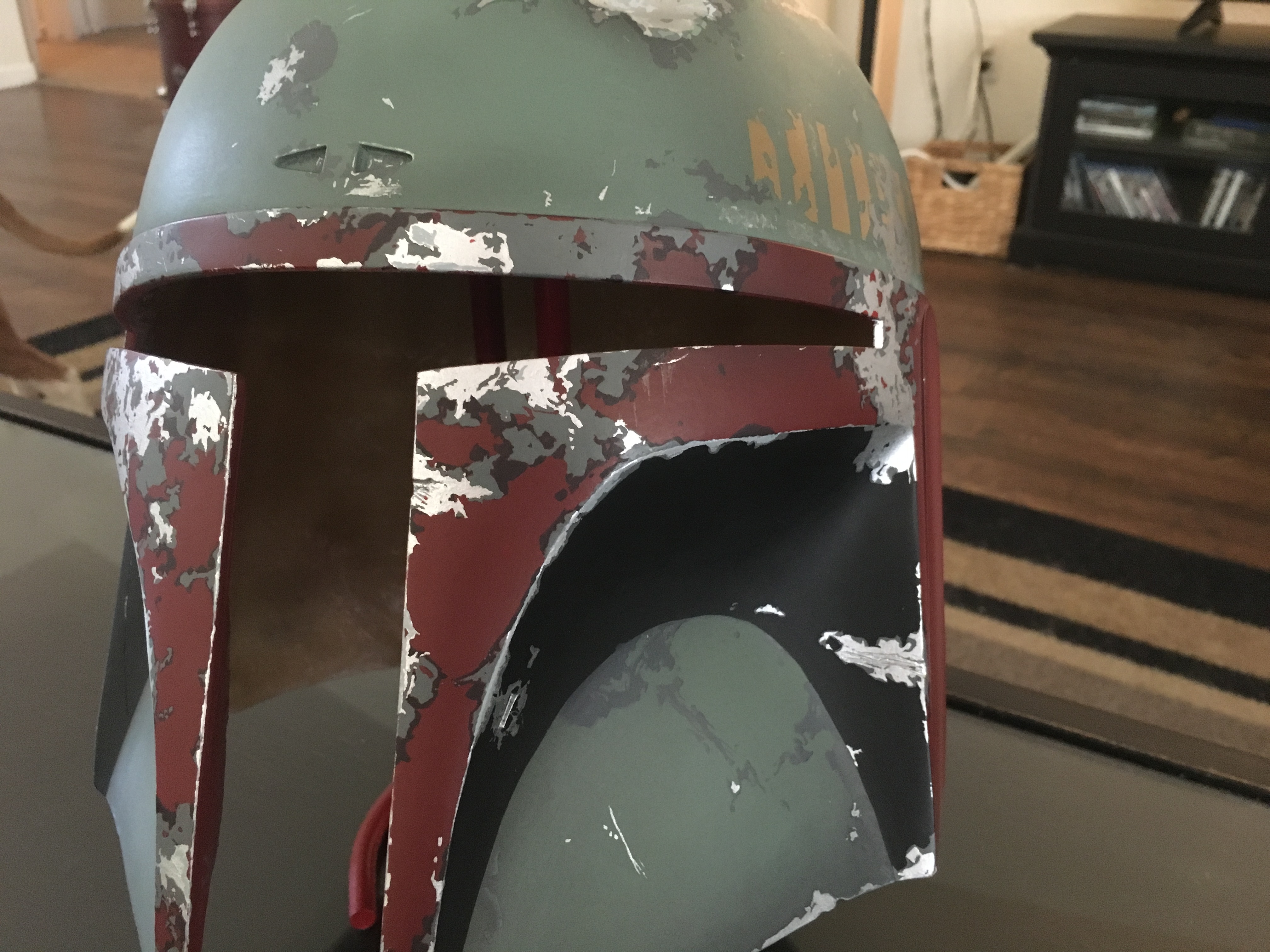

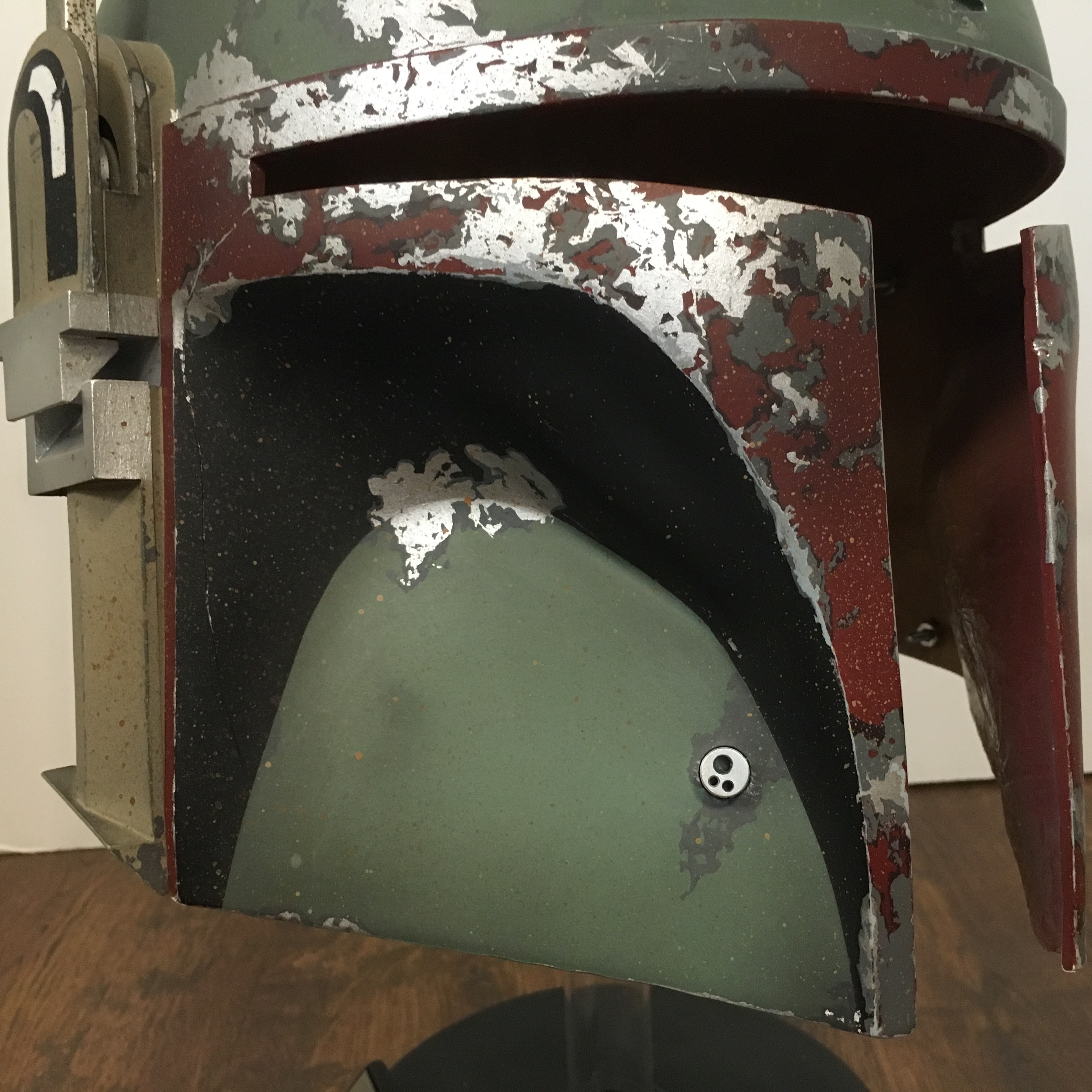

Quick update on the mandible progress...
The Mandibles are probably the section that takes me the longest. So many minuscule scratches that make you go cross eyed. I'll recap a little bit into the process side of how I tackle this.
On this helmet I am doing all the damage layers topically. I Use stencil's to mark out the general region of the damage and then use close up reference photo's to more accurately shape the damaged regions. This part is very very time consuming going back and forth from my computer screen to the helmet. Then I paint all the major silver damage, then the gray, then the dark purple meanwhile going back and forth between reference photo's. Then I'll go back to the silver to do the minor silver damage on top and sharpen out the silver damage previously topically painted.
Fett Face 6 Right Mandible.jpg Fett Face 10 Right Mandible.jpg Fett Face 11 Left Mandible.jpg
Hey Fettastic ! Very COOL! I love that you put the 'crack' in the replica!!!
In that high res. photo it looks to me like the crack even veers over to the lower right corner of the eye slit.

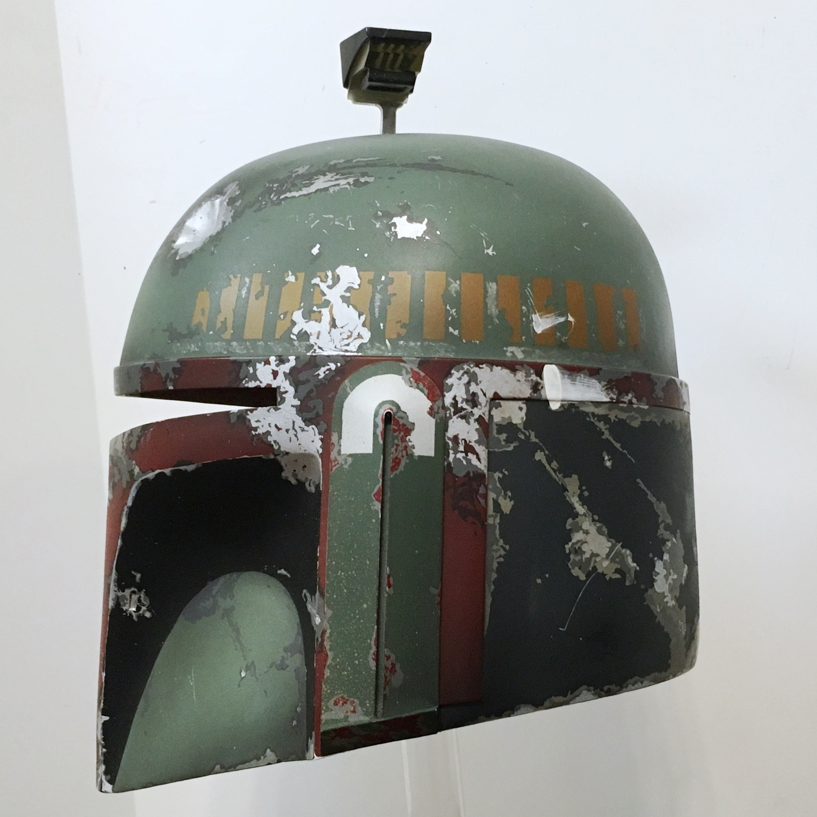

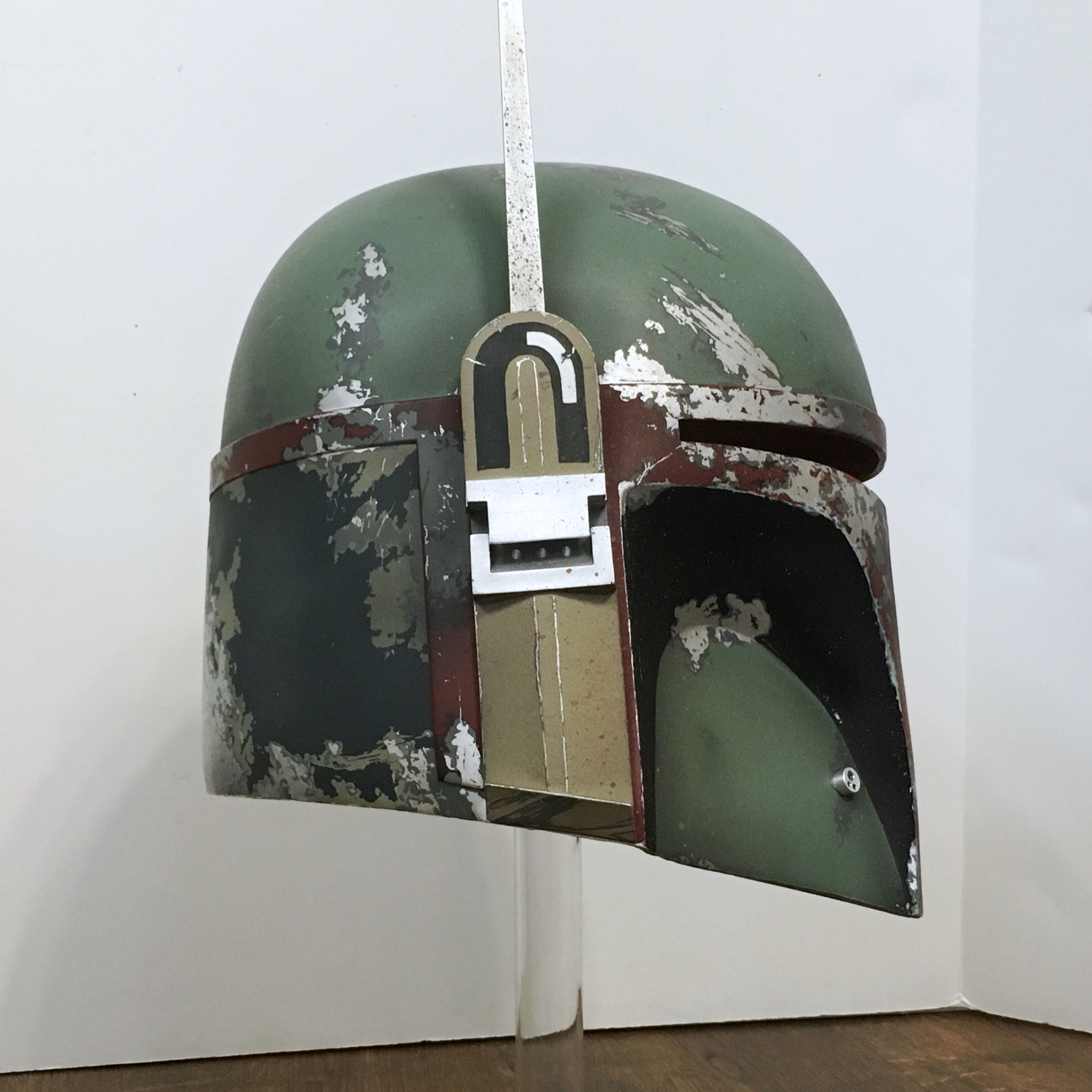

Getting close to finishing the paint on this one. Still need to apply the white thumbprint, and the white smears on the killstripes, grease stains, the spatter, grime, and some other small details like the ear markings.

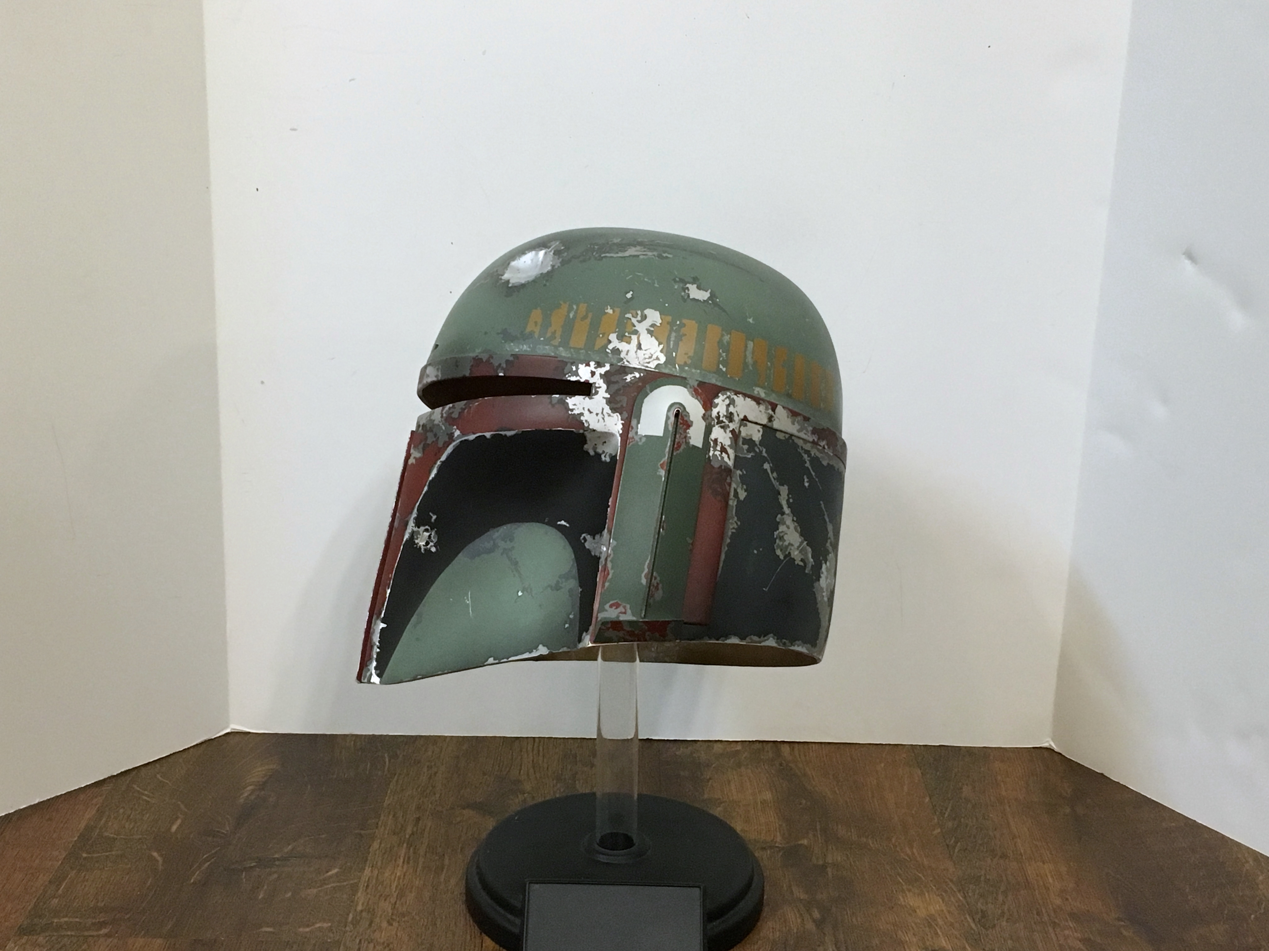

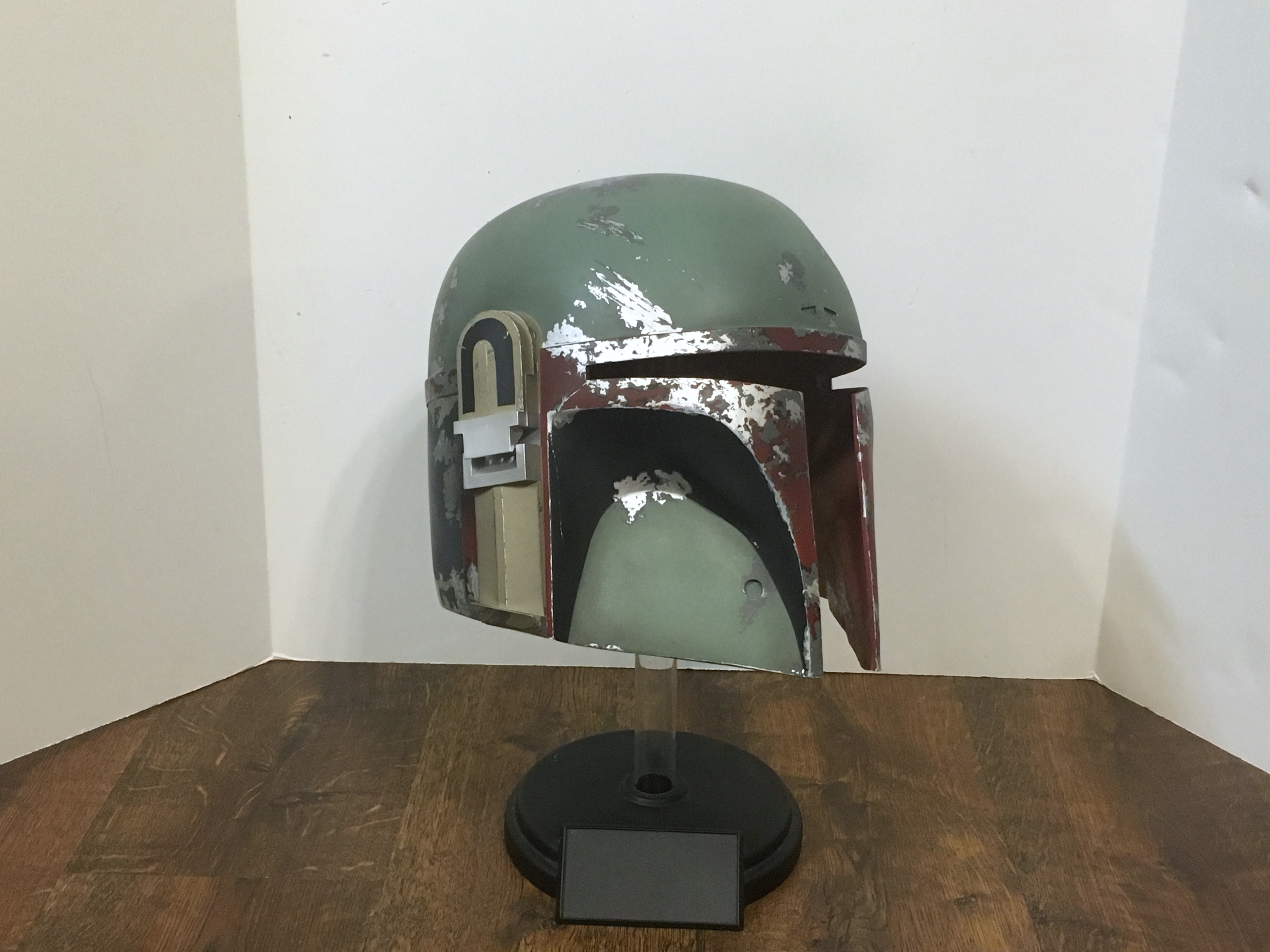

Small update. I added the white finger smudges and details on the killstripe side and added the white arch on the right upper ear cap. The smudges in particularly are kind of stressful since I actually smear white paint on the beautiful paint job.

Finally installed the servo and light kit from JC27. It includes the electric servo, wireless receiver and transmitter, LED's for the topper and perspex block, micro switch, and Alco Switches. Amazing kit but I would not recommend for the novice. The Servo is very, very sensitive and absolutely has to come to rest at both the up and down position with support or it will not function. The timing and position has to be perfect. The Servo is operated by the wireless transmitter and receiver. When the servo comes to rest in the down position it activates the micro switch, which then sends power to the topper LED's.
