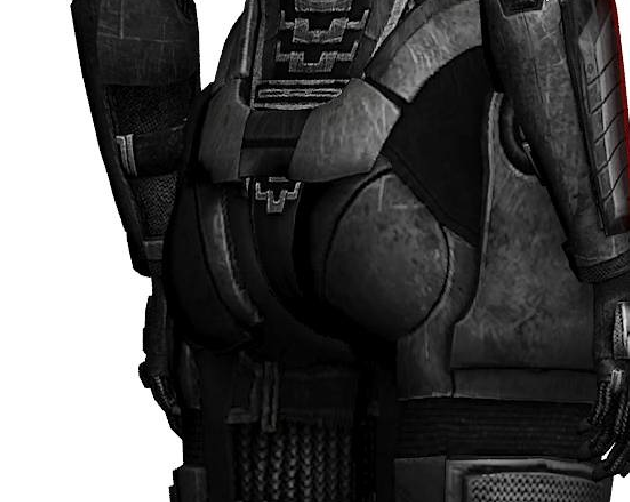

I will permanently attach them to the underarmor, with glue, someday. Going to wait until I have the ass plates done first. :thumbsup But that way I know every time I put the costume on, things are going to be sitting where they should be.
^ Probably uncomfortable.
I think that is what most people with foam do though, pretty straightforward method.
The same as the upper thigh part of the legs, I think the backside will be 9-10oz leather too. It would hold up to being sat on, over and over. I thought about using plastic like the rest of the suit, but styrene ass plates would end up as panty-shrapnel. Like, seriously, no thanks.
