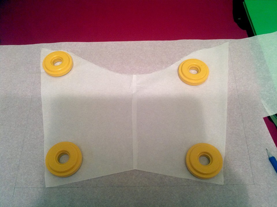

I took the sleeve pattern for the catsuit and traced it on to paper. This way I know the sleeve cap will fit in perfectly. I only shortened the pattern piece by folding prior to tracing. Once it was traced, I cut it out and then cut it in half. The SOB oversleeve is open in the front, so I basically moved the sleeve seam to the top of the cap as opposed to under the armpit where it was. I taped the pattern back together and then redrew the outer lines to bring them out wider instead of angled as they originally were and straightened out the bottom edge.
I then cut out the newly traced pattern and then cut it out of the fabric.

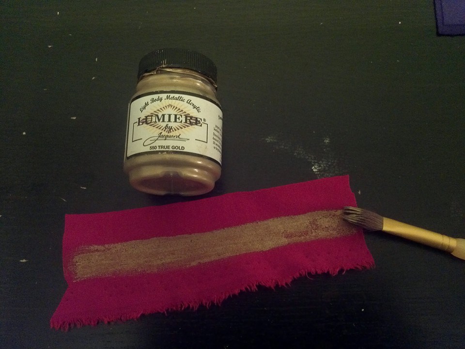

For this test, I just used a dry brush but I'll need to get less paint and make things even drier to get a good weathered look. Because this fabric is stretchy, when I pull it apart the paint will seperate with the fibers so if I was painting this on a surface that was going to be stretched, I'd stretch it as I was painting to ensure I had good coverage. As this will be on non-stretched parts, I don't need to worry about that.

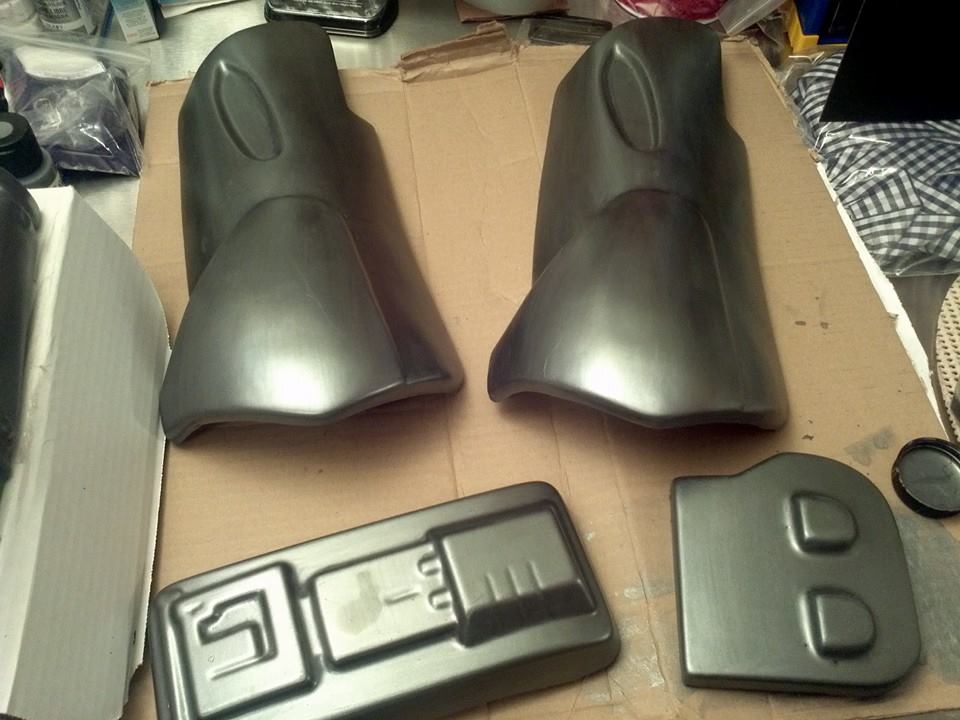

I also started painting my ODST kit. I ended up using acrylics and a paint brush as I had a heck of a time finding gunmetal spray paint. Plus, with it being cold again, this allows me to paint whenever I have the chance and not worry about curing issues. So far I'm super happy with how it's turned out.
I managed to get about half of it painted with three coats.

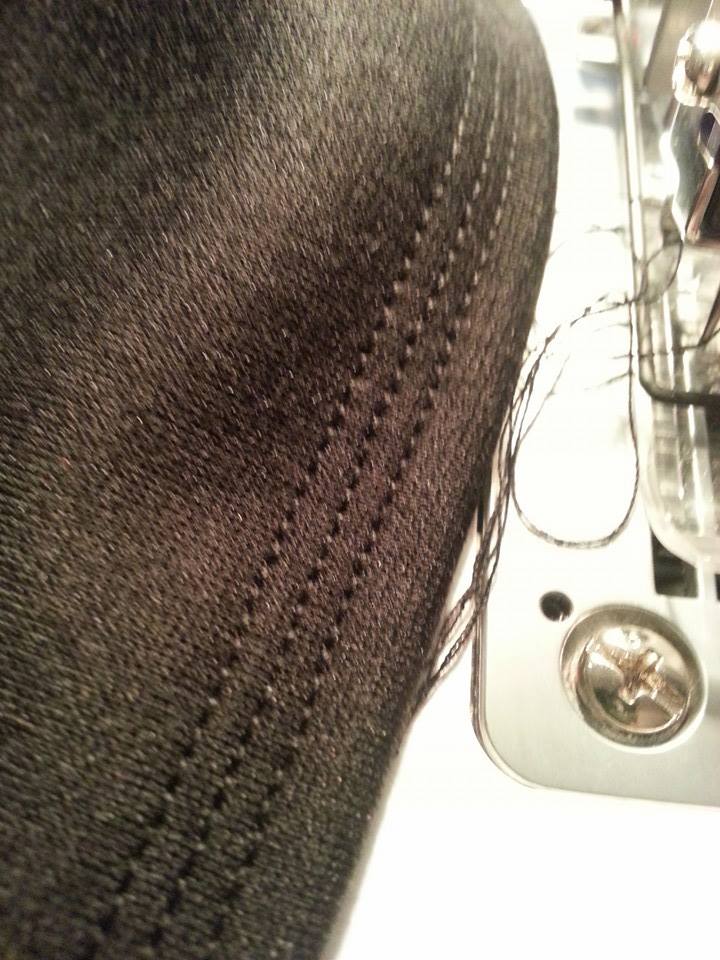

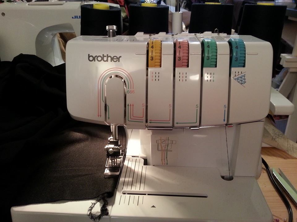

First up, my Coverstitch machine. If you do a lot of sewing with stretch fabric, invest in one of these. I LOVE IT!! Of course, it can be used on other fabric as well if you need that type of hem and it does belt loops, binding and a zillion other things. So what the heck is it you ask?
So that's what it looks like. Sort of like a serger really. But what it does is different.

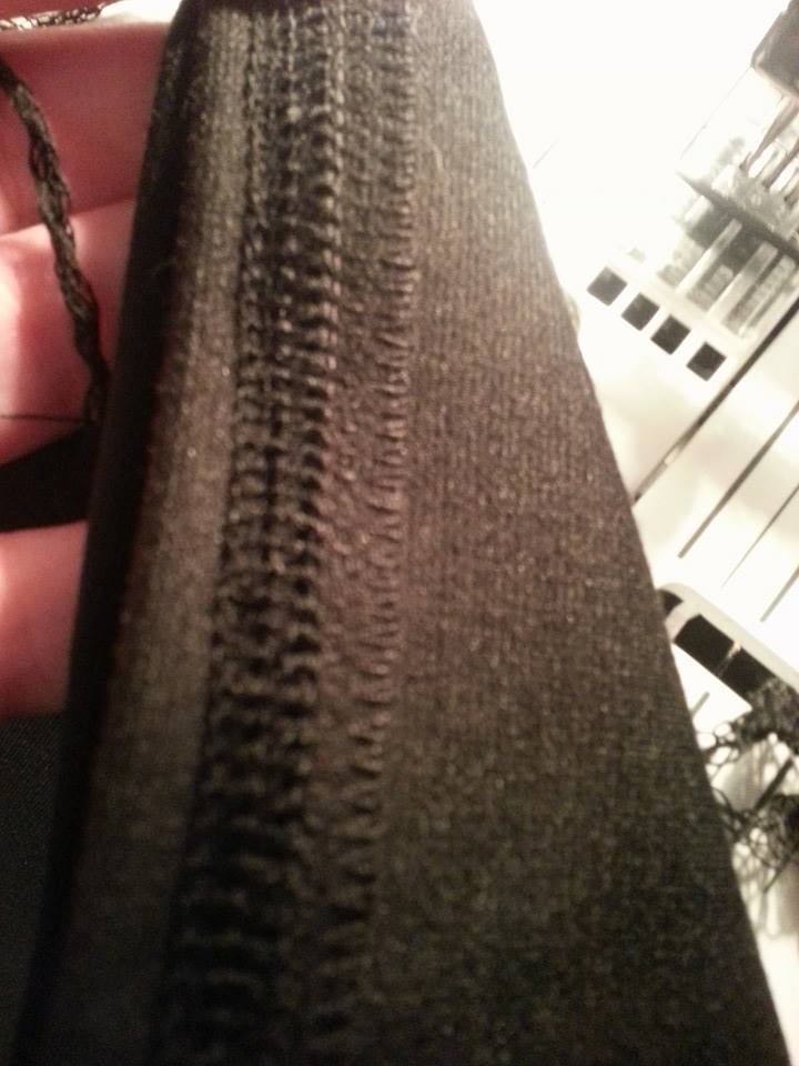

So there's the good side of the fabric. You can have two or three needles/rows of stitches.
And there's the underside....all finished nicely just like if you had done it on a serger! Normally I would have folded the raw edge under before doing this, but the fabric I'm using (ponte di roma) is a heavier weight stretch fabric and I didn't want to have the hems too bulky so I serged the raw edge first and then used the coverstitch. I LOVE looking at those three lovely rows of stitches. It's like sewing porn! ;-)
So, that item I was sewing is the undersuit to my Sister of Battle. I used the basic catsuit pattern from KwikSew. Keep in mind that the hem needs to be flat in order to use the coverstitch machine so you have to do the hem before you sew up the arm or leg seams. Also, if you haven't used the KwikSew catsuit pattern, be aware that the sleeves are ridiculous baggy but because of the differences in stretch between fabrics, I cut the pattern as is, sew up the arms and then take them in from there.
The catsuit is basic black with the zipper up the front. It is covered front and back, but it's easier for me to get in to with the front zipper. Something else to consider. I use a regular zipper on these - long of course - instead of an invisible one. Sometimes invisible ones can be a little tempermental and not as strong because they have such tiny teeth so I prefer when it is possible to use a regular strength zipper.

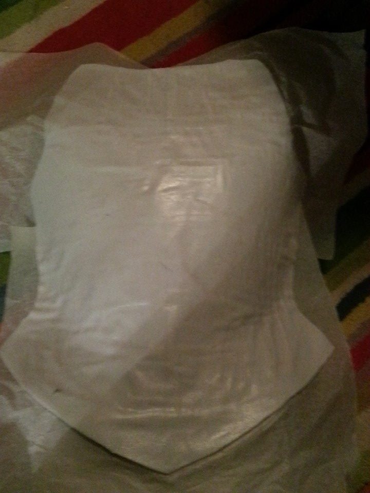

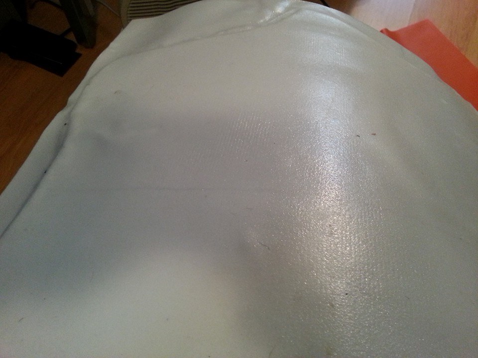

This is my first attempt at the chest plate. I used the two layers of Wonderflex with a sandwich layer of craft foam in the middle. I cut the craft foam to the exact size I needed the chest plate to be and then sandwiched it between the two layers of heated plastic. I was using some steel armor I own to help get the right shape. With that inner layer of craft foam it was FAR less moldable in more than one direction. So the waist area flaring out to the hips was a problem. I eventually gave up on it after hours of trying to get it right - but as luck would have it, it's going to work okay for the back plate so it's not a total loss at all.
Soooooo....second attempt. ARGH!!! Two pieces of Wonderflex with a layer of wax paper between it and the metal armor. Thus.....the wrinkles. ~sigh~ How utterly frustrating. But, it's got great shape and there is a whole bunch of detail layering that will cover all of that up. However, even with no craft foam, it wasn't as easy as I hoped to shape. My conclusion is this - it's the mesh embeded in Wonderflex. Lesson learned - if you want to do big pieces, use Worbla - no mesh to mess with.

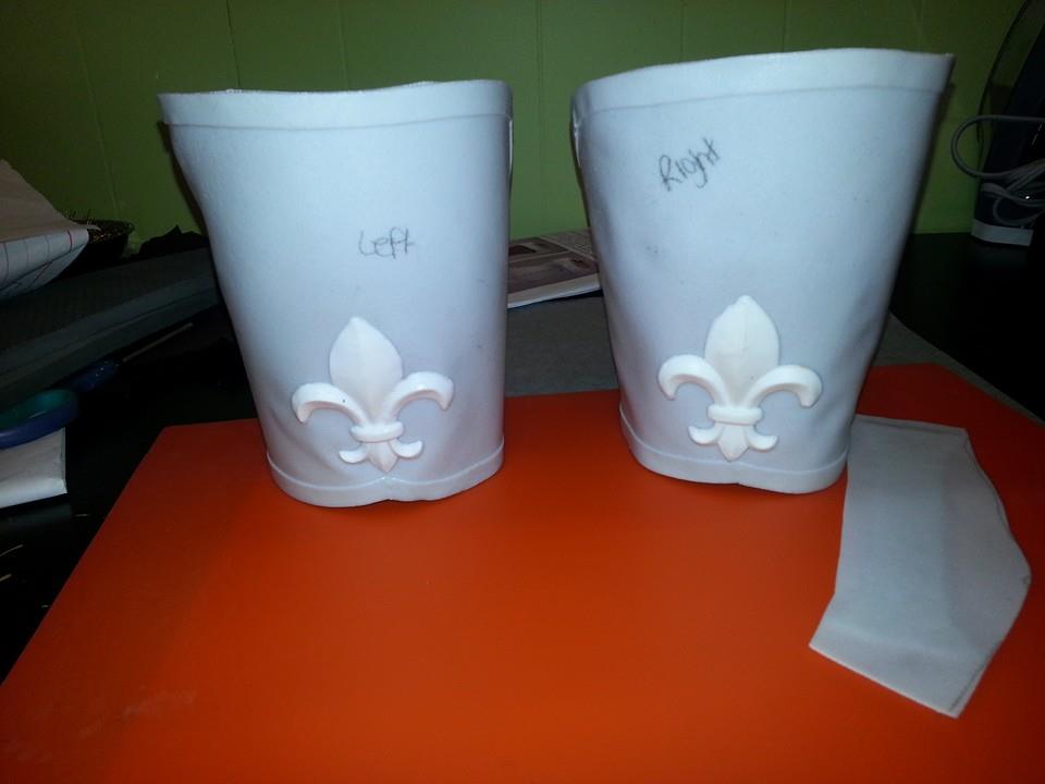

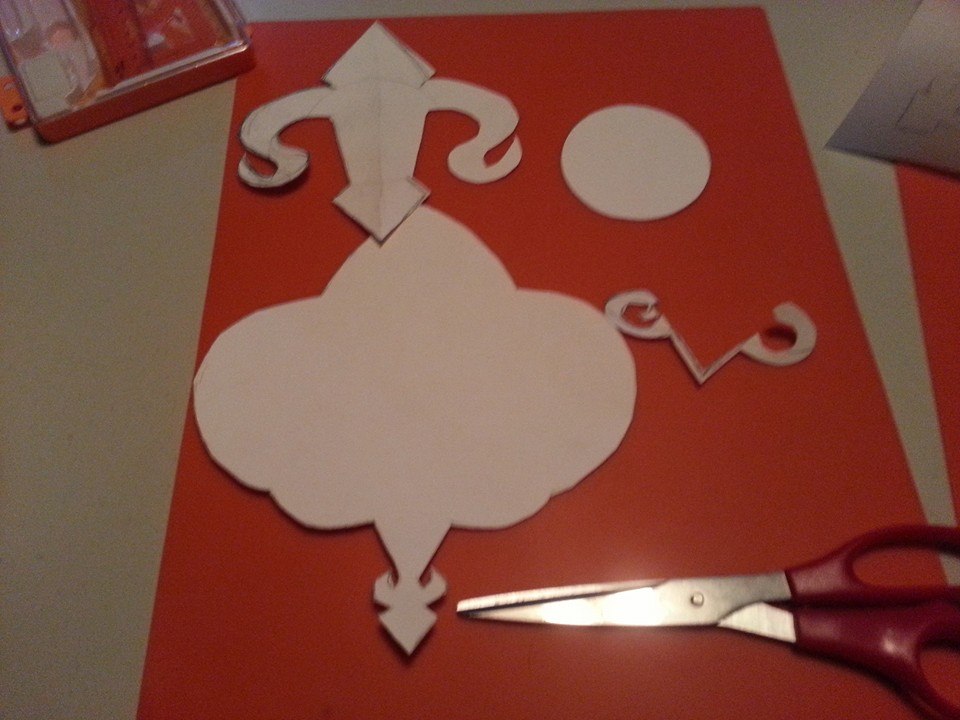

Remember those paper cut outs a few paragraphs back? This is what they turned in to....
As you can see, there is some trimming and such that needs to take place....and some shaping so that they are shins and not giant flat things, but that my friends is my knee armor on the top of my shins! In the example I'm basing mine off of, she has skulls in the middle of the knee. But if you look at the shapes....the fancy fleur de lis with a circle on top where the skull goes - you'll see what can't be unseen. A skull with ponytails. Once I saw it, there was no way I could take those knees seriously anymore so another fleur de lis (no the one shown in the picture) will be going in the centre instead. I'm supposed to look tough....not like I need to add a Hello Kitty bow to the top of each skull....hahahahaha

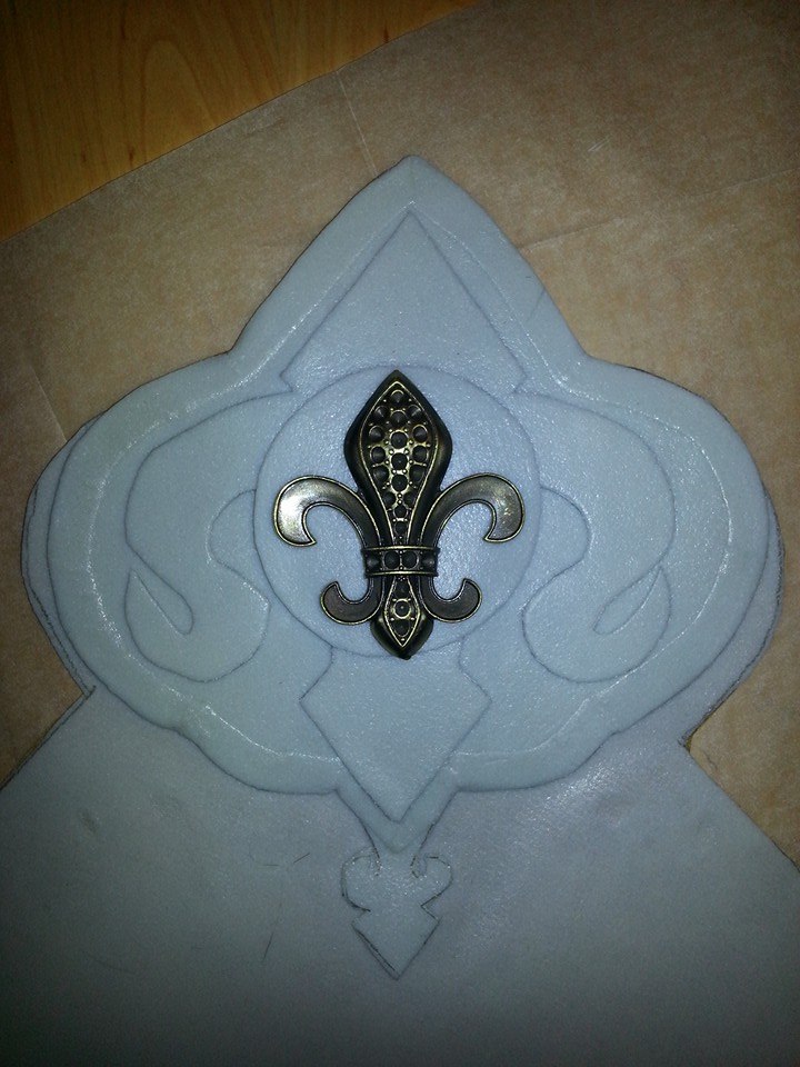

I'm sure you can see that these still have some things to sort out. I needed the fronts to be slightly flat to attach the fleur de lis to but that made everything go all woobly. So lesson learned. Wait until the piece has completely cooled and THEN start spot heating for stuff like that. Both the forearms and the biceps are two layers of Wonderflex for the base and one layer for the detail bits except for the centre "I" on the forearms. Because this had strips going under it, I wanted it to be a little more beefy so it wouldn't look like it's melting over the strips, so I made it two layers, with the very centre strip being the third layer.

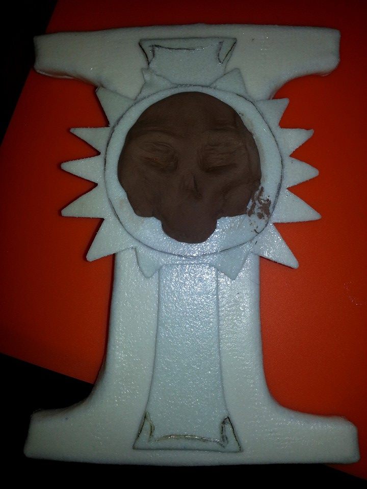

This is the big "I" that goes just below waist height kind of like a giant belt buckle.
This really has some substance to it. The main "I" is floor mat foam covered in one layer of Wonderflex. I did the bottom side up and then the top side down. It worked okay, but I think next time I'll do the top side down and wrapped around the back, and then a piece the extact size and shape as a back panel to cover all of the ends. It seems to work cleaner that way. The detail bits on top are all two layers each. The skull....(kinda, right? Don't laugh...it's my first try....it's a skull of something.....hahahaha) is sculpted out of Model Magic. Once I practice with Friendly Plastic (beads of plastic you heat in boiling water and then mold) or maybe even with scraps of Worbla, I'll redo it. He's cute, no? In a tough way. ;-)

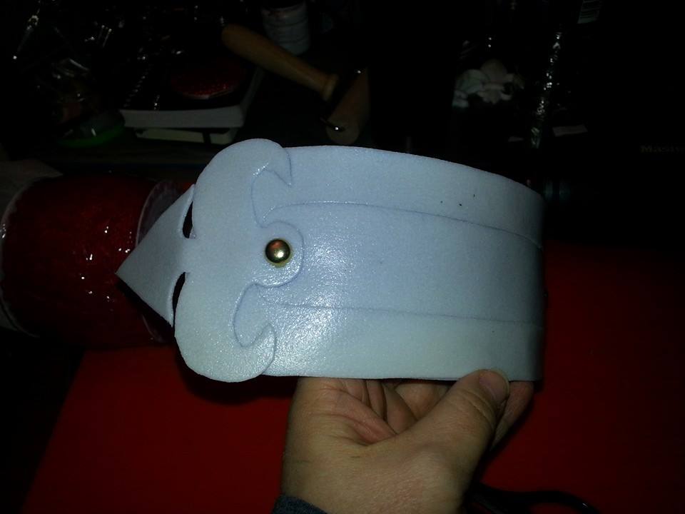

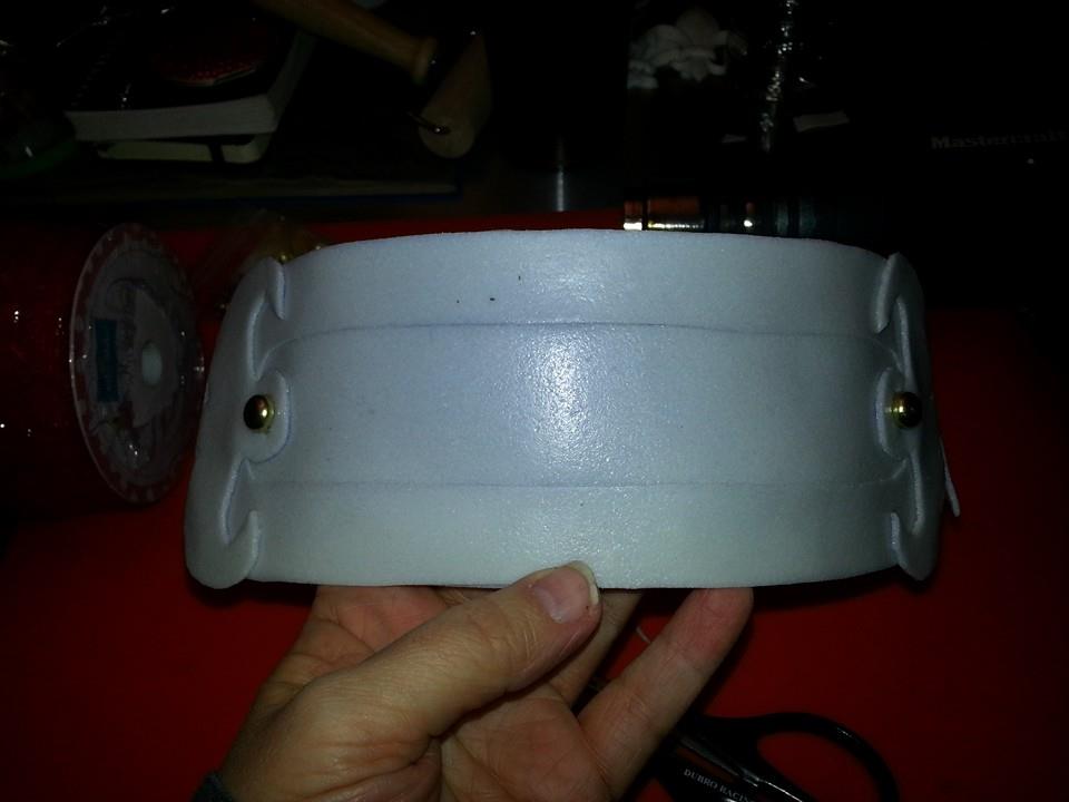

And lastly I built this belt thingy.
1656333_10152328872522990_827546131_n.jpg 1969315_10152328872582990_1497362540_n.jpg
I don't know what it is. All I know is a belt comes through it and it sits on your waist. Soooo....I built it. The gold bit is a spot from Tandy Leather. That's what they are called....spots. They have little prongs on the underside and when the plastic is soft, I just pushed it in. Should have been silver though. Oops.
