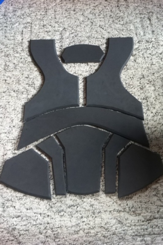

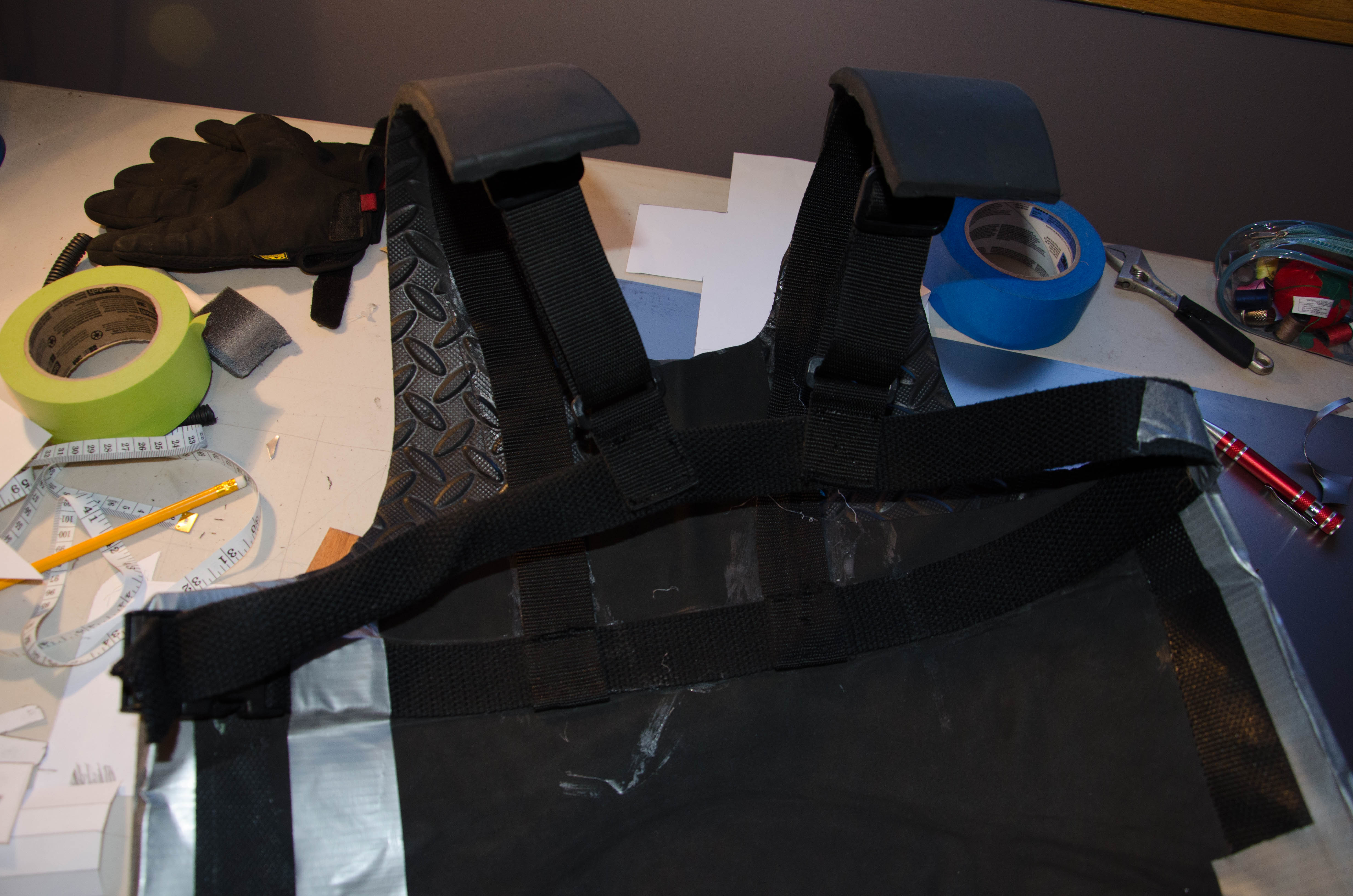

I started with a basic template that I found online that I've seen several other people on here use, and cut it all out with a beveled edge
Sanded the edges a bit, heated & shaped them, then glued them onto a full size backing. Most people I've seen tend to just attach the pieces at the seams without much of a backing, but I definitely like the thickness & sturdiness of the two full layers.

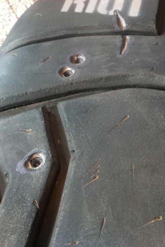

Next I took out the woodburning tool for some damage effects

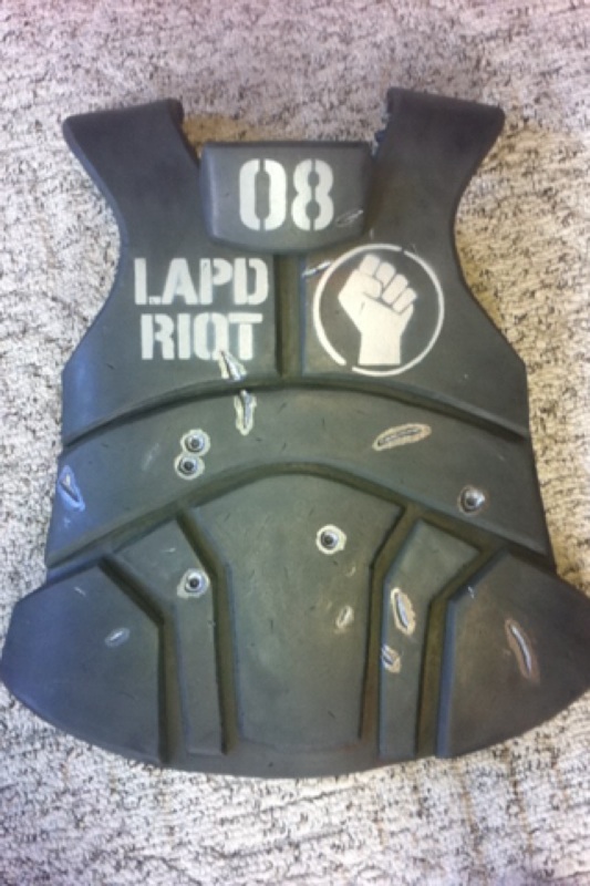

Next was painting. I did a sealer of dark gray Plastidip, then a base layer of Rustoleum Oil Rubbed Bronze, and then I painted in all of the battle scars in silver acrylic. Next I took Rustoleum Camouflage Deep Forest Green and rubbed it on with a rag to give it a used worn look. I absolutely loved how that final color turned out, the picture doesn't properly capture it. I painted the stencils with Krylon Pebble so that it looks a little dulled down and not like brand new white paint. Then I retouched some of the battlescars with more silver. I dabbed metallic gunmetal gray around the outsides of scarring, but I'm not a huge fan of how that looks up close after it dried; too shiny for how dark the color is. I think next time I'll get a similar shade but in a flat/matte.
I finished up my weathering with an acrylic wash. I was worried a dark color would ruin the nice shade of dark green I had made, so I used a sandy tan color on it - made sense since they're primarily in the desert. I think it was a good contrast color to fill in the cuts & scratches against the dark green without really ruining the base color
Overall, I'm pretty satisfied for a first attempt, but I'll most likely be giving it another try and probably just giving this one to a buddy. Going forward on my second attempt, I'm definitely going to re-do my stencils a bit to clean up the big gaps between the pieces. I also thought the neck protector was a little small on that template, but I'm thinking I need to tackle making the helmet before I expand that at all. Next on my list: I'm gonna spice up the New Vegas armor with some FO4 combat armor legs
Feedback, thoughts, & advice for my next attempt? I'm really interested in other weathering suggestions to go well with the dark green color. Most people do black with silver popping through, so I don't know how well dry brushing some orange/red rust on would really mesh with that.
