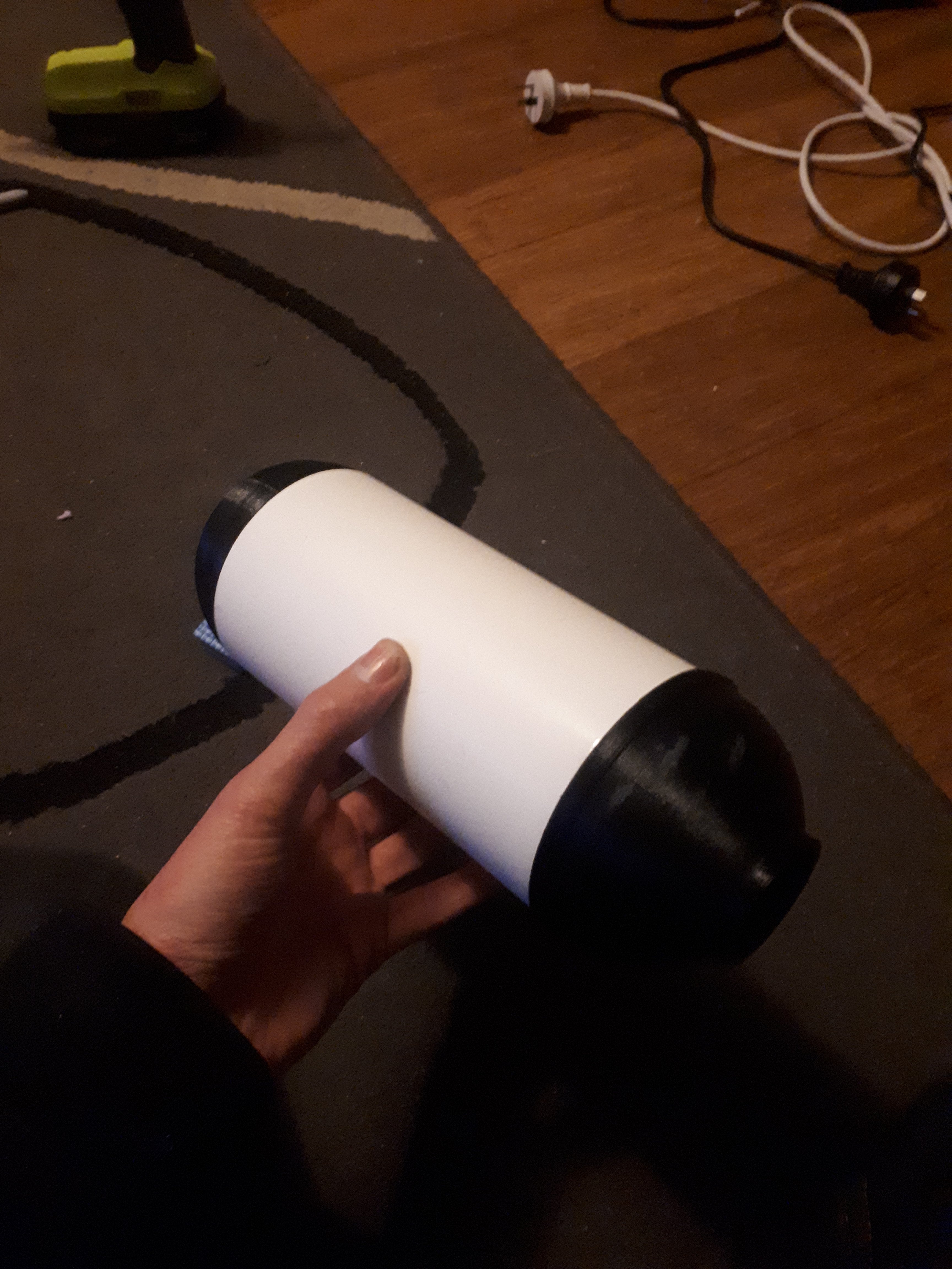

The two tanks on the back were interesting to say the least. I managed to get access to a 3d printer so I was able to make a top and bottom for a PVC pipe. the top was a basic half dome while the bottom had a hole for a pipe and a small rim along the wider end.
Mounting them were fairly simple, a few cuts into the foam made the sink into the body enough for the shape to work like the real thing.

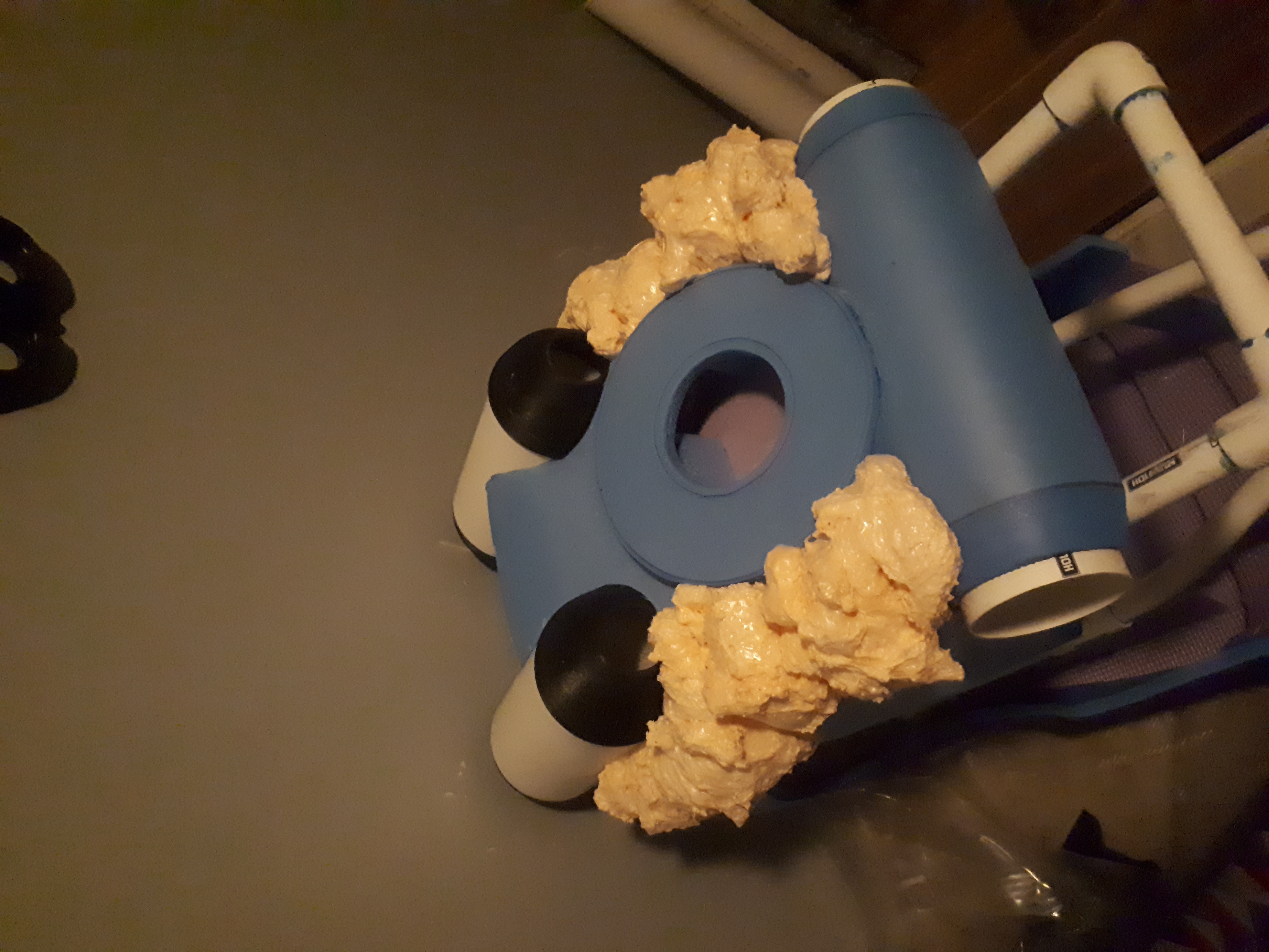

Now for the weird part, i filled the back with expanding foam, its not something ive seen done but i had a can onhand and i figured it would work well and i feel it did in the end.

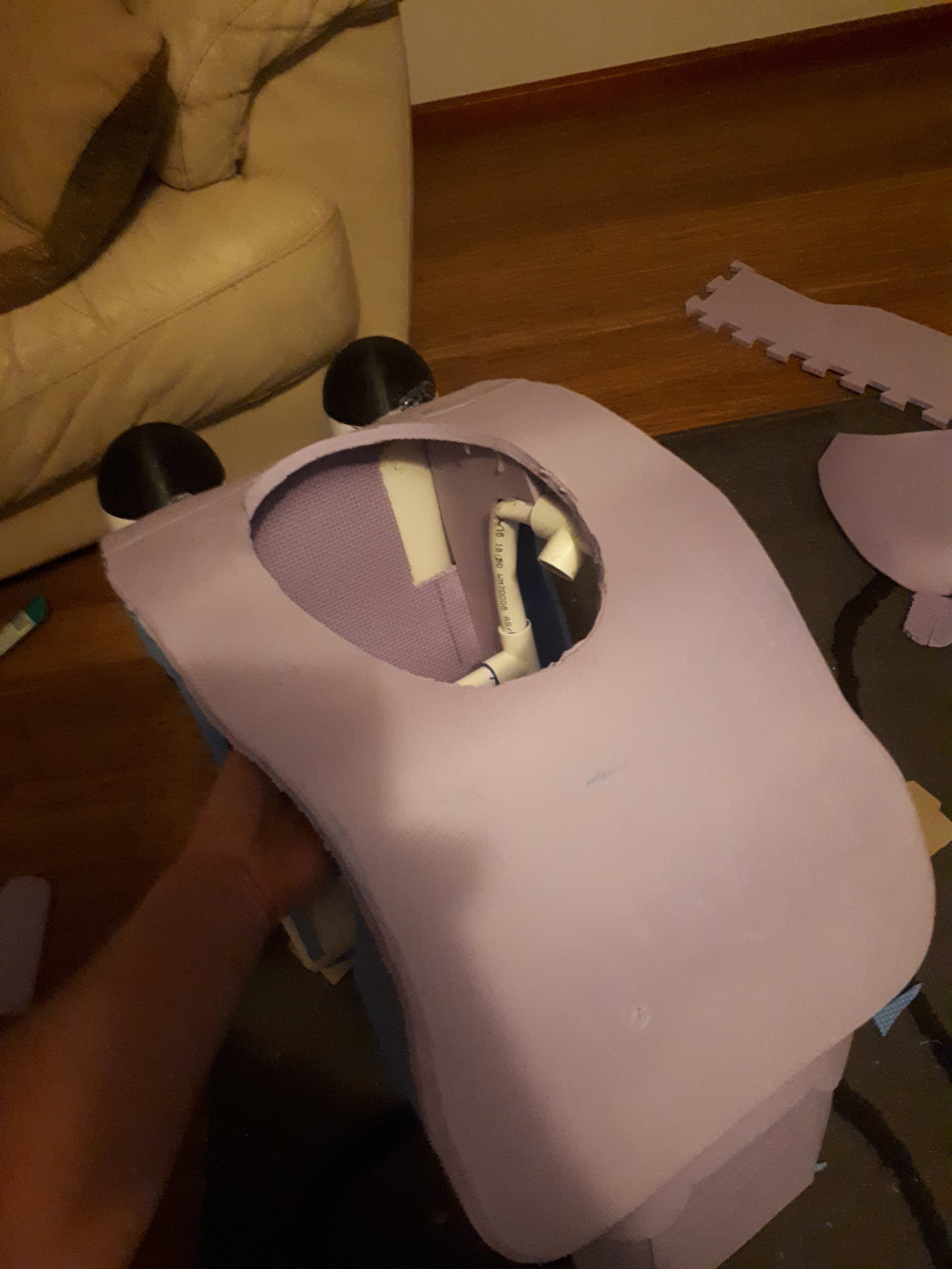

Doing some more work on the sides, I also pulled the front out. I wasn't very happy with the profile and this change seemed to have fixed it in my eyes. Lastly i added another layer on the front to give it the required shape.
