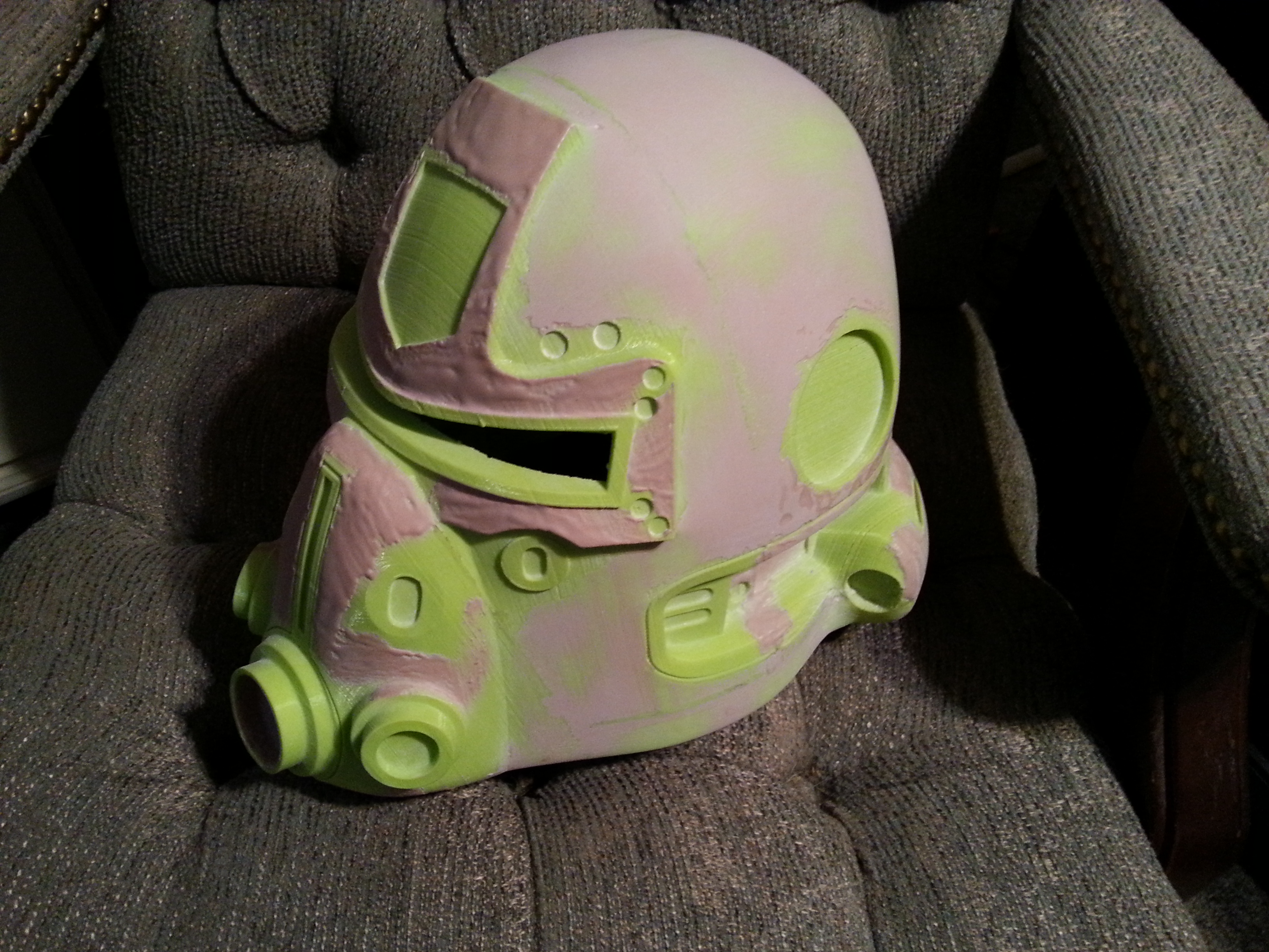

Loads of sanding on T-51b. It's finally getting smooth! :D Will be working on this as time permits.

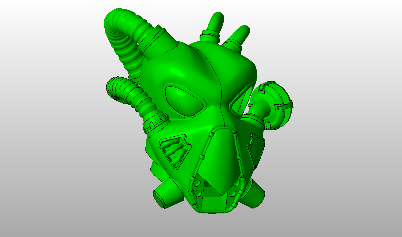

Quick update. While the second half of the Hellfire helmet is printing, I'm modeling the Enclave Advanced Armor Mk 1 helmet, also known as the Remnants Helmet. So far it's coming out nice. :)

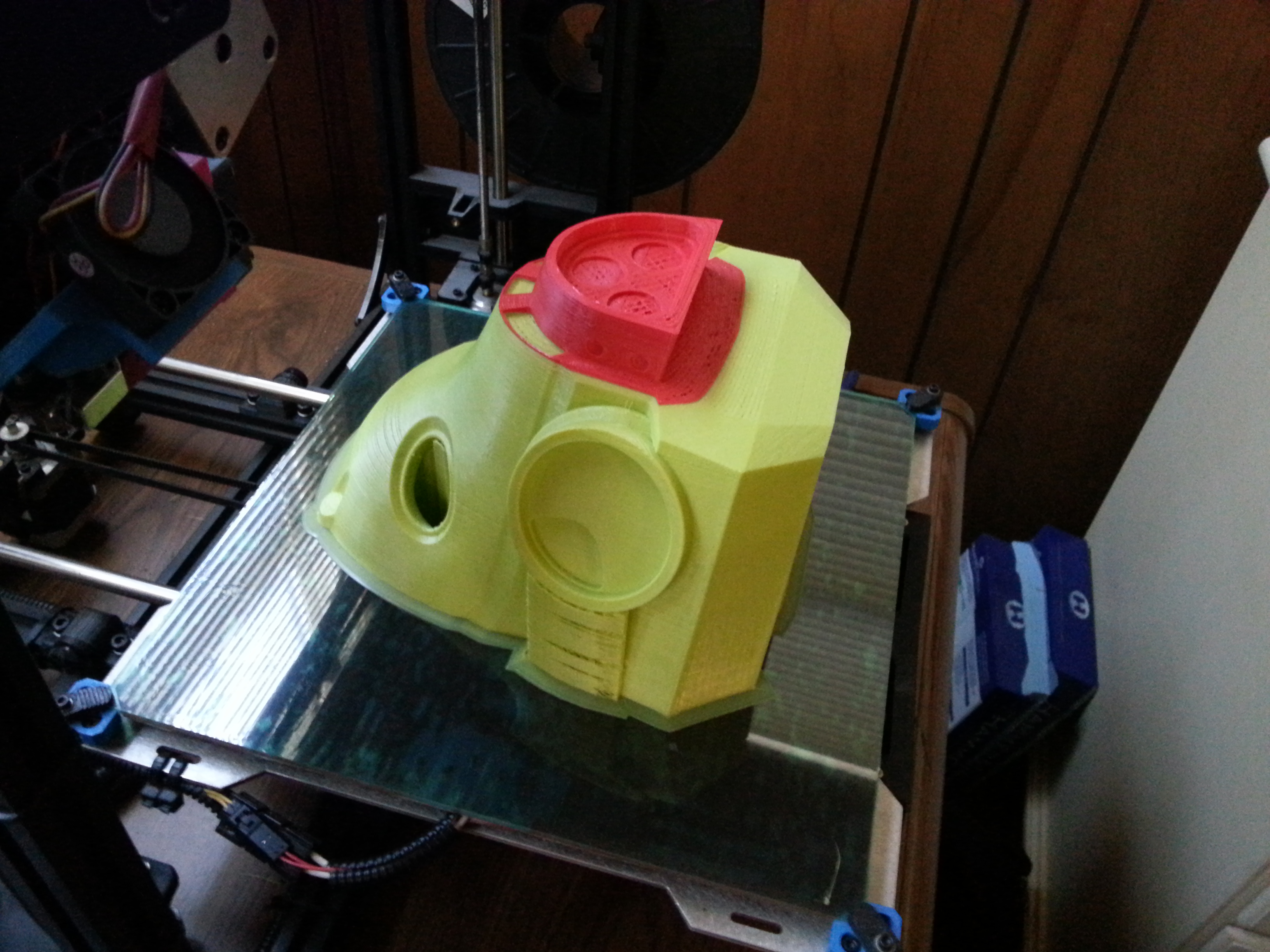

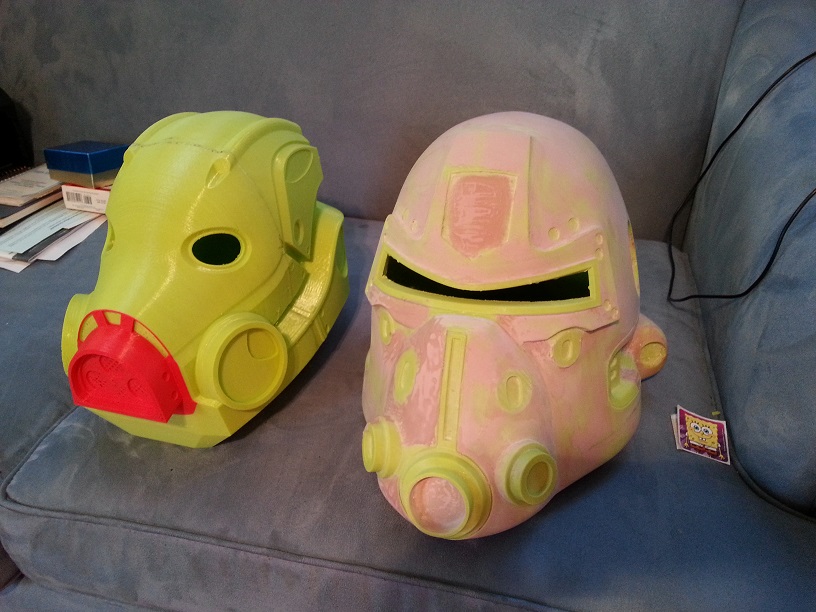

Well, finished printing the main shell for the Hellfire helmet. :)

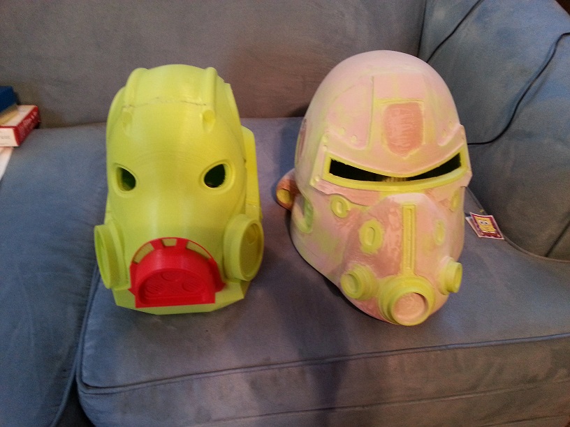

And here it is next to the T-51b helmet for size reference:

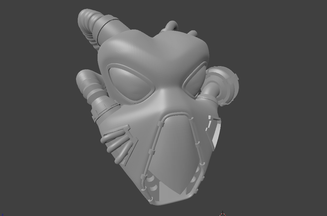

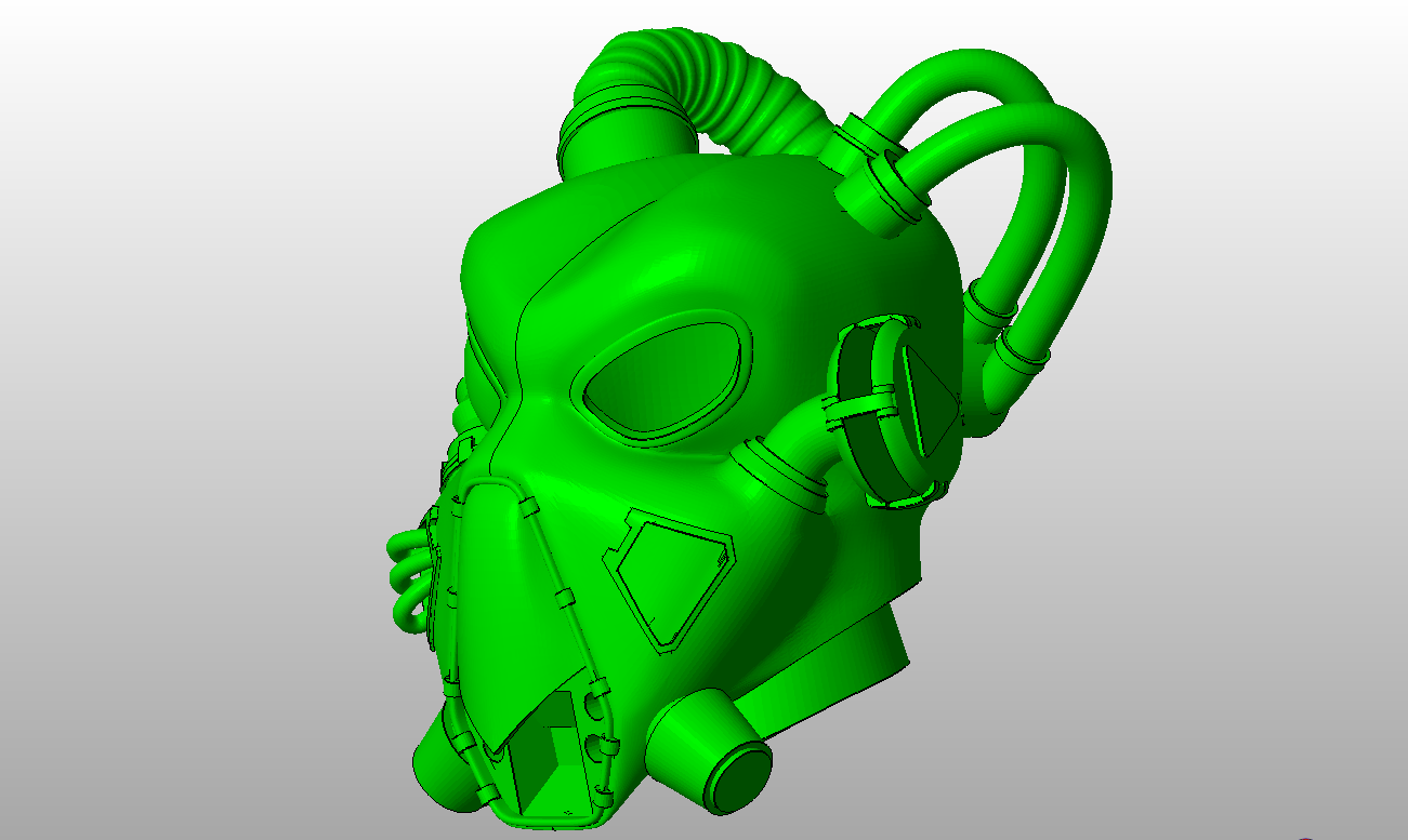

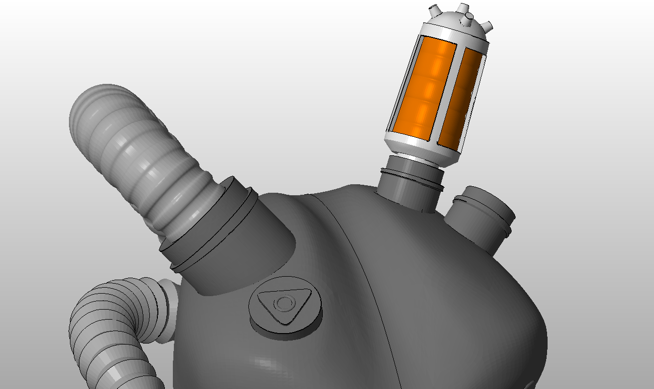

Some more renders of the Enclave helmet. Pretty much ready to start printing this beast.

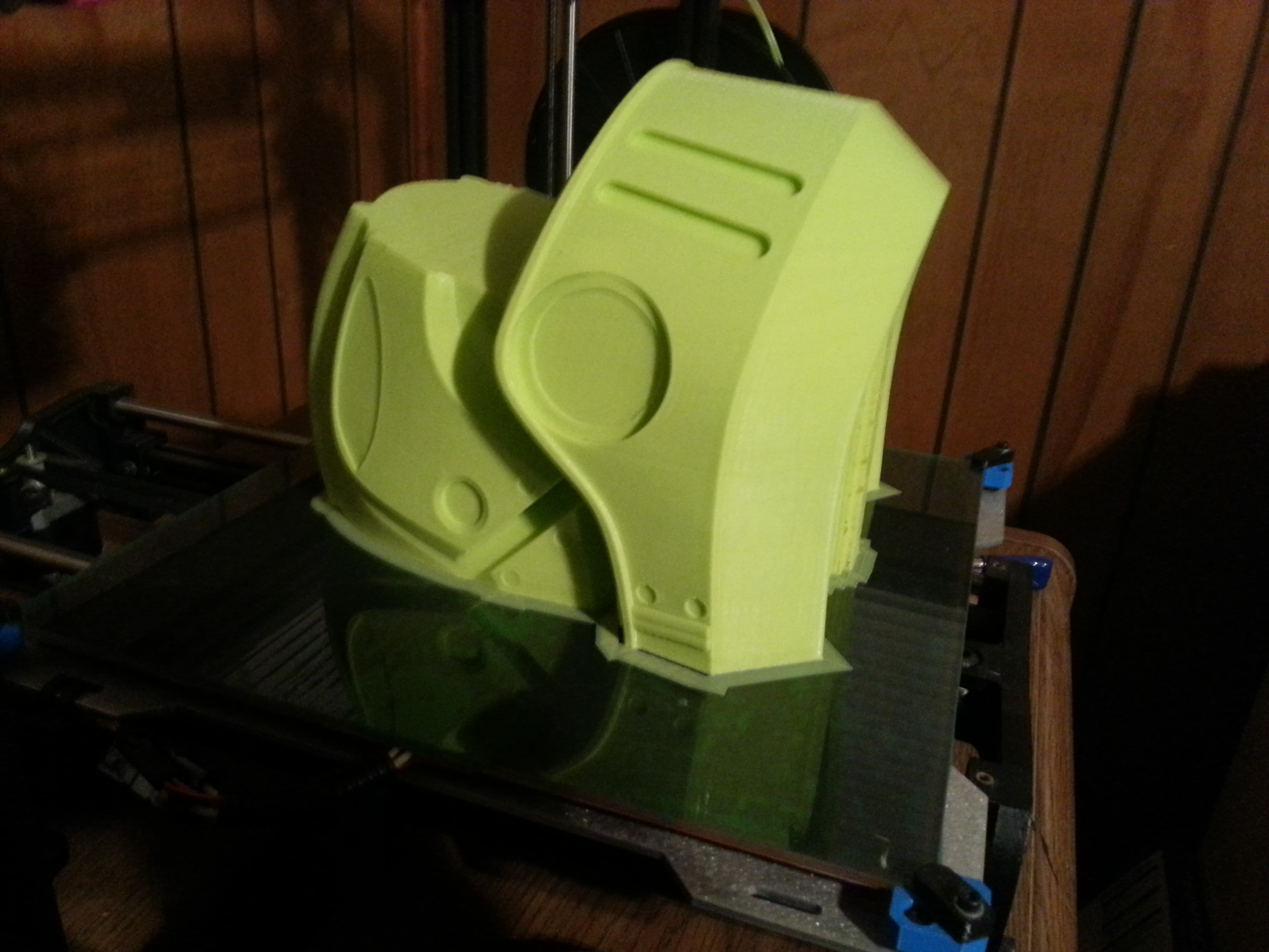

Also, I did (before I left) have a chance to start printing the Enclave APA helmet. However, the size was absolutely way too small. So, I've got it resized and ready for printing, but I will wait until printing the T-45d helmet first, then work on printing this one.
