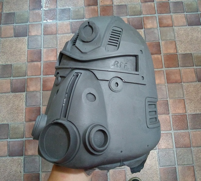

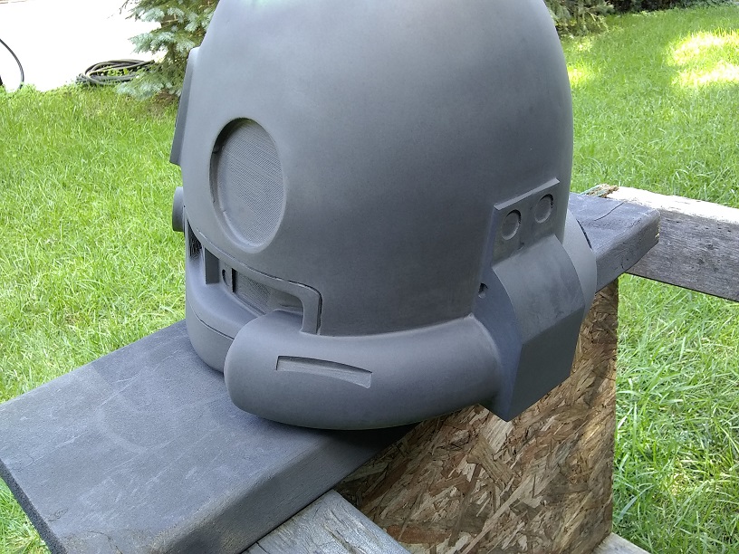

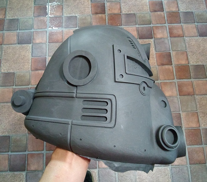

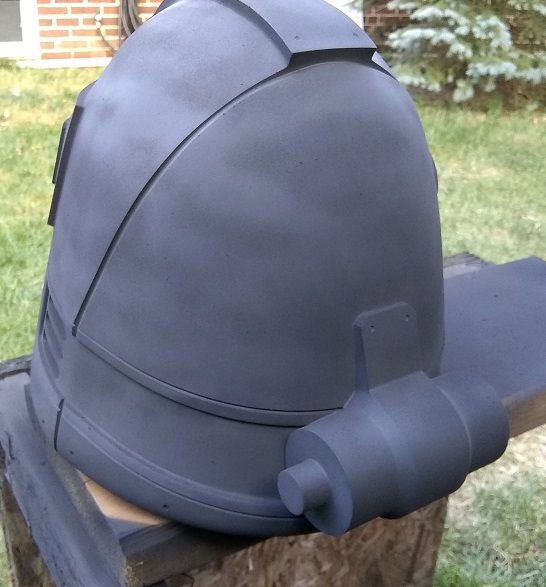

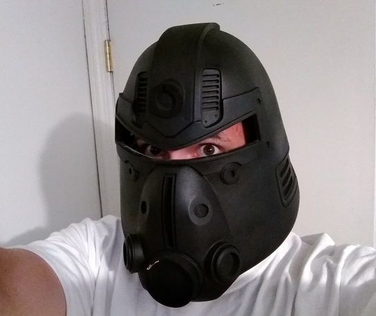

I finally had a chance to purchase some printing resin, and once I received it I promptly began printing the rest of the greebs for the T-51 helmet. Right now I have everything printed except the visor. I still haven't decided what I'm going to with the lower ribbed hoses, but other than that I have just about everything else figured out with an action plan ready to roll. These greebs still need work and filling in some areas, so I'll be spending my free time working on them.
Here's what I have so far, with most parts properly fitting where they're supposed to go.

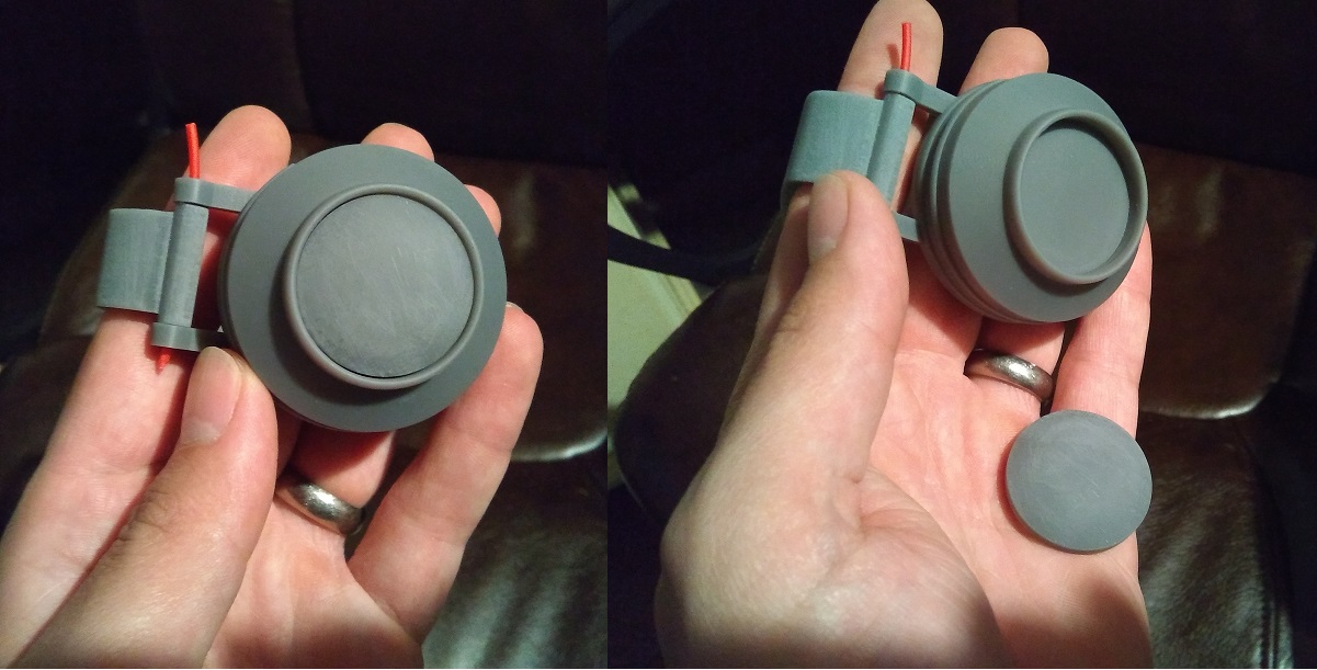

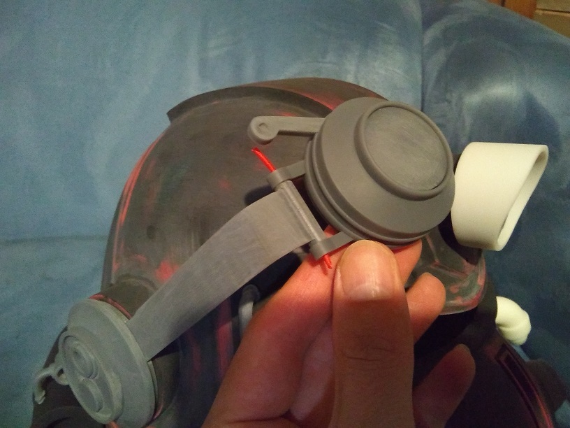

I have the optics bracket assembly pieced out a little better for easier building. Probably gonna need to reinforce the little arms with something when I pour them, but I'll figure that out when I get there.

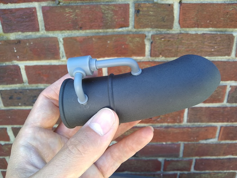

Still need to do more fitting for the rear tubes and the little hose connectors.

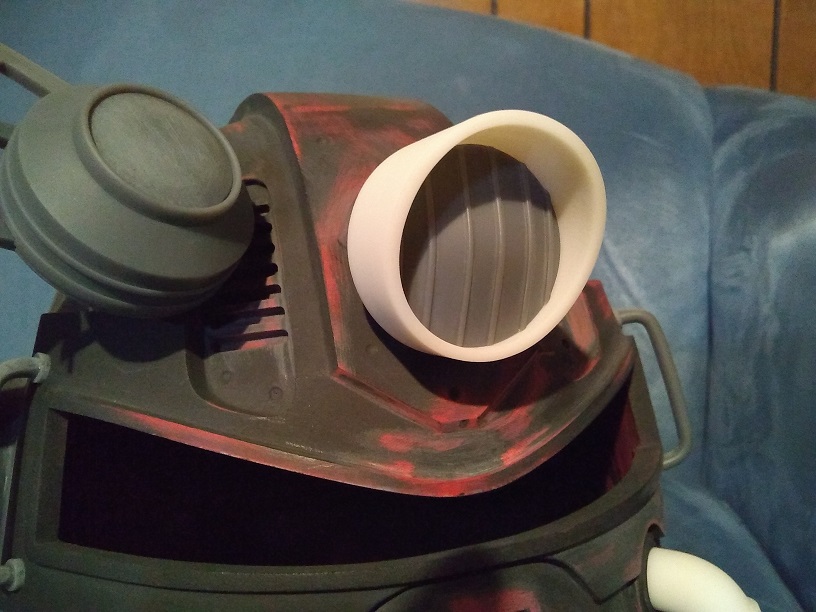

And I decided to tweek the model for the optics assembly. I originally had this as one piece, because in the game it appears to look like one piece. As you might already know, every version prior to this one had a black lens on the optic, and they even showed it this way in the FO76 E3 trailer. In the original concept art for FO4, it all appears to be metal just as it looks in the game. Well, now it'll be a choice for the builder, as I've separated the lens from the main optic, and I can cast the lens in black or metallic.

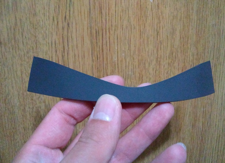

Also, I have the visor printed and semi fitted. This is actually the second visor I've printed, the first was almost perfect but warped a little on the right side. Warped enough that I decided to print it again in a different orientation. I also decided to thicken it slightly, to make it easier to cast. The second one came out much better, but wasn't trouble free either. I had some rather curious bubbles in my print, not really sure what caused it but I should be able to fix it. However, I noticed there is a slight gap at the bottom on the right side when fitted on the helmet. I may use filler to fix this, evening it out. I may even try to print it again at a different angle again. I think I'll try repairing it first though, and see where that goes.

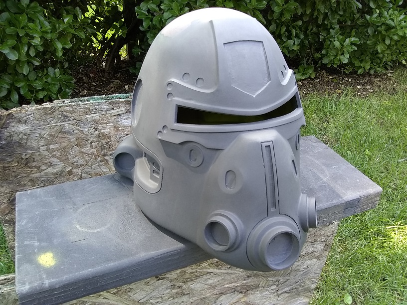

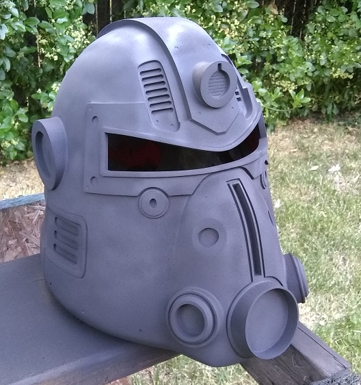

I'm happy to say that the Fallout 4 T-51 helmet is just about done. I've been working on the smaller parts, and finished up the main shell this weekend. I still need to spray the final coat of primer, and will get to that hopefully this weekend. I'll share pics once I do.

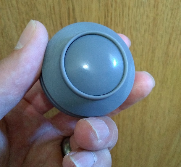

What I do have to show is just a small sample of what's been getting done. I have the smaller diameter hose connectors in the back fit to the larger diameter hose tubes. I also polished out the optics lens real nice and shiny. I also reprinted the visor, and while I still didn't get a perfect print, this one was workable. I have it spray primered, and will start wet sanding and polishing tomorrow.

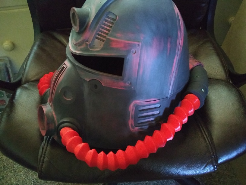

In other news, after two revisions on the exact length, I am happy with the prototypes for the game render hoses. I'm much happier with how these hoses enter the rear tubes. These protos will now get XTC resin applied and I'll begin sanding them down. Yay! More sanding!!!

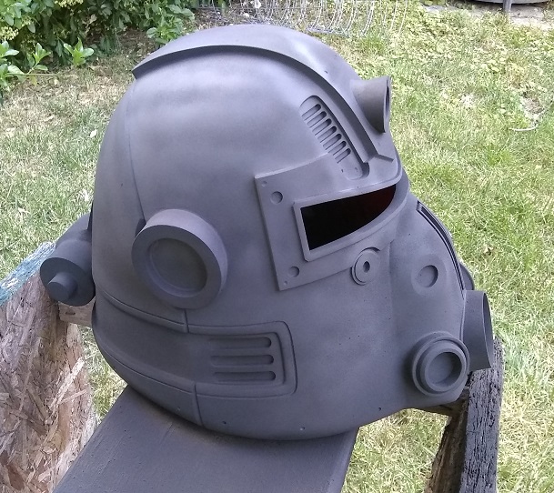

So, I'm waiting for materials to arrive to make the mother mold shell for the FO4 T-51 helmet shell. While waiting, I decided to work on the FO3 version a bit. This is the reprinted helmet.
More on this one soon.
