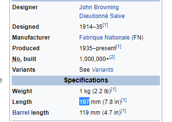

First, let's find a gun in New Vegas with a real-world counterpart! In this case, we'll do the 9mm! if you look on the internet movie firearm database (link to site below) it says that the 9mm is based off the Browning Hi-Power Pistol.
Now, if we look up the length of the gun in millimeters, we find out that it is 197mm. Browning length.PNG

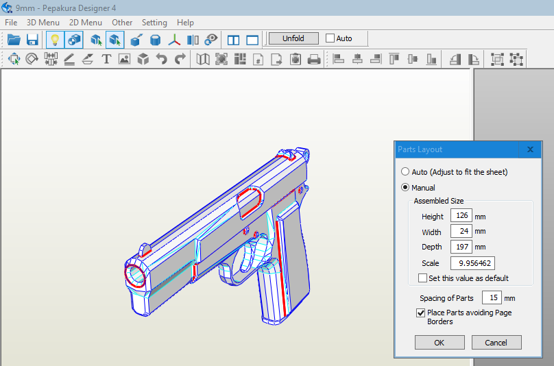

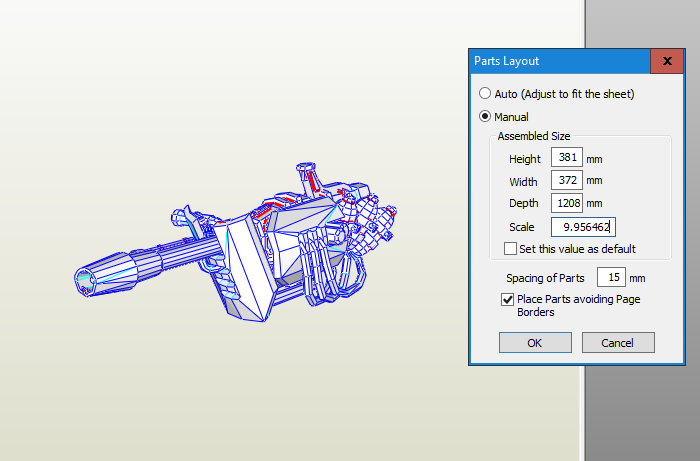

With Pepakura Designer open with the 9mm model loaded, click "unfold" in the toolbar, then you'll see tabs for height, width, and depth. With the model correctly oriented, the length measurement of the Browning Hi-Power will fall into the depth tab in Pepakura Designer.9mm pepakura.PNG
When you enter the Browning length (197) into that tab, you'll get the true 1:1 scale- which is "9.956462" for that gun! you will have to do this for each gun on the site.
