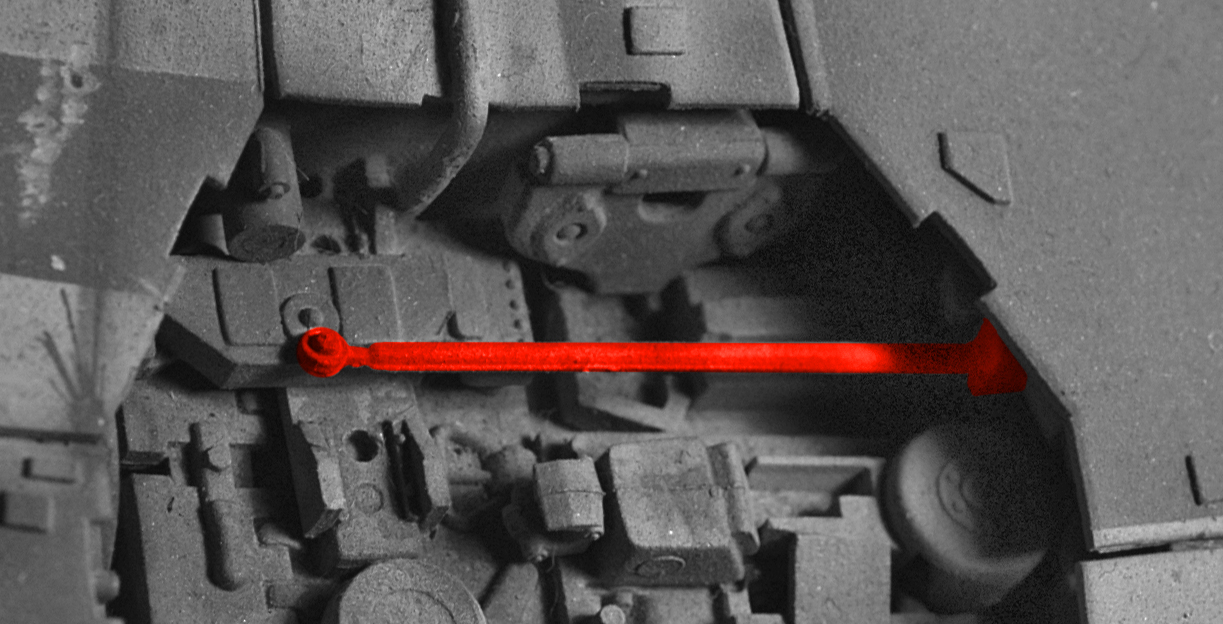

So does anyone know what this long linkage arm may be in the starboard forward recess pit? It is the last piece I need in that pit...
A: 1/72 or 1/76 scale tank track, probably the rubbery stuff.
C: I think I've seen these in the Airfix 1/76 Sherman (??)
Thanks Lee and Treadwell...I had thought the A part was the Sherman track but was still not sure, so it is good to have that confirmation...I have not been able to find the B part in my 1/12 kits yet, i will go thru them again...and that C part is just strange!?
isn't that the M60A1 deck? It doesn't look like the Tamiya one though..
I think it is the 1/35 Tamiya M60A1 deck on the 5 foot falcon...But for the 32" ESB falcon I am not sure, it could be a 1/72ish M60, but I have not seen one that matches??

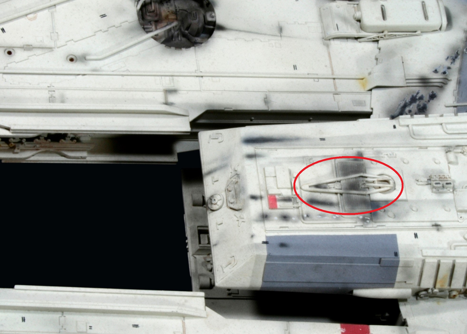

Is this a known kit part?
I don't think this is a kit part. Certainly not any M60. The engine cowl is arched in every scale. This may be scratch built. Many parts of the falcon body were scratch built to match the 5 footer. I have what I believe is everything used on the falcon and I have searched every type of kit. Nothing matches this section of the falcon. If you examine the 5 footer, it suggests this was scratch built to match as is the long plate it is sitting on
