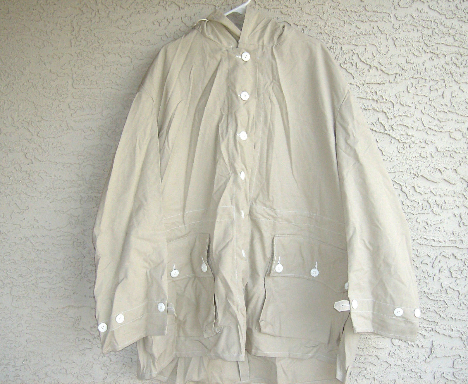

The "hoodie" is known to be a white Swedish Army snow-jacket. It was intended to go on top of regular gear only for camouflage in winter, so it is made of a single layer of white muslin. It has buttons that would have been removed.
It should be very cheap to make yourself and not that hard if you already have a jacket pattern or can copy it from any old jacket that you have around. Most people tea-dye it beige and then spray-paint it like they do the pants.

Here's a picture of a fan-made Endor camp parka (not mine). Like Darth Lars said, it's a basic snow-oversuit with the buttons removed:
Wow Friendly Flyer - that's some paint job! I take it that it's a work in progress?
For reference, this is the marking inside the Swedish snow parka:
This is what mine looked like when I bought it:
They are huge - by the way!
