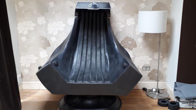

Hey guys...so this is a bit of a rush job for a client and hopefully a fairly quick build that I'm fitting in between other stuff...u know how it goes
So I found a pretty decent 1/6 scale file on Thingiverse of the throne and with a bit of editing and remodelling I scaled it up x 6
Every printed piece is filled with PU foam and assembled, then given a fibreglass shell...here's where I'm at
It's a mighty big and heavy piece of furniture to be sure but it is for the supreme ruler of the galaxy

Should be able to get all the measurements you want from multiplying the original model x 6 https://www.thingiverse.com/thing:1274287
So finally got all the Bondo finished... It seems there really is no such thing as a quick build in the Star Wars universe
Next up, adding the other control panels on the arms and the greeblies on the capital...and then paint

What did you use for the pedestal? Does it allow for rotation?
Thanks...I actually used a ribbed drain access riser. And yes the bottom of the chair has a hole cut into it which the riser plugs into and swivels

How much does that sucker weigh???
Cheers dude...not sure of the actual weight but it takes 2 men to carry it

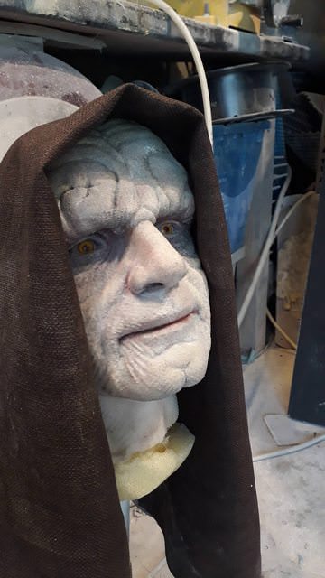

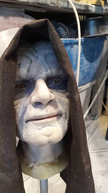

As promised, as I have a throne, I thought I'd have myself a go at Palpatine too. Casting a silicone head and hands for the miserable old git to fix onto a sitting mannequin
Here's the head
