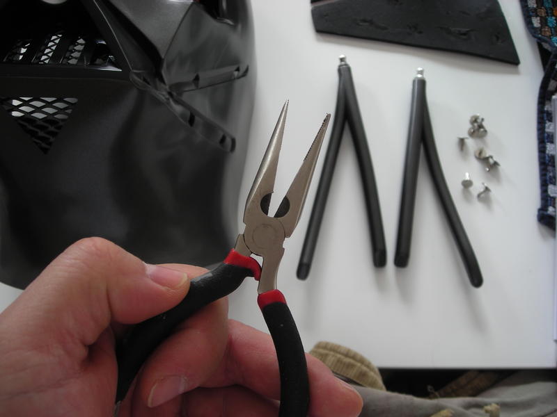

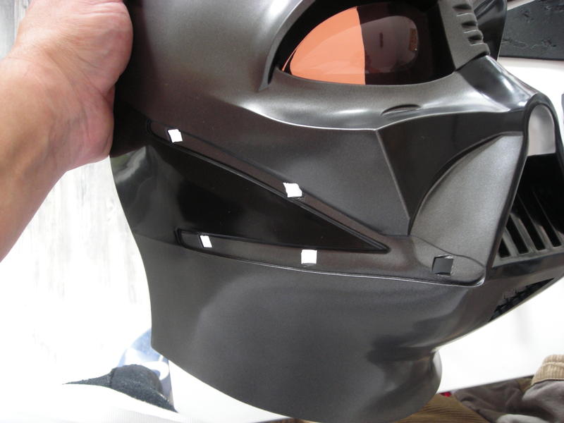

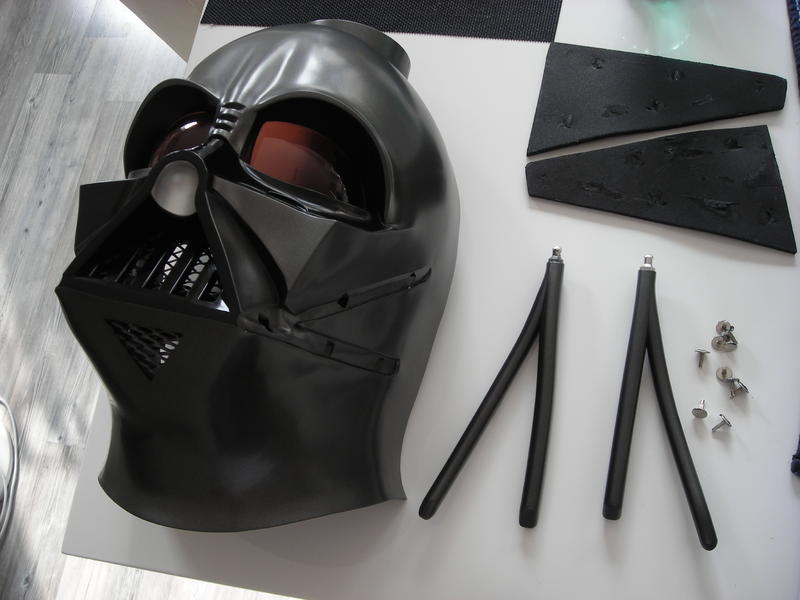

So...I did it...I really hate this ugly boys on the side of the facemask...:D
Now I can rework them or add some new casts of an other Vadermask I have.:)
http://up.picr.de/26481323re.jpg
http://up.picr.de/26481331qy.jpg
http://up.picr.de/26481336bu.jpg

Wow, are you saying the rivets just pull out? How hard was it?
If you have the first out you know how it works.You must turn them when you pull them out.
They are very hard in the holes...but not clued I would say.
Be careful that you don´t press the facemask too hard...the plastic on the neck is very thin.
They just prise out quite easily with a screwdriver.
I thought I was going to have to cut loads just to get started but it's going to be fine. Hurrah.

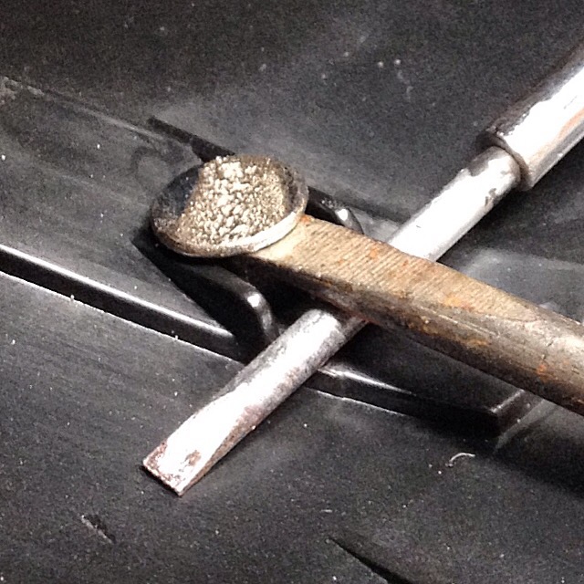

It will get filled with car filler after the tubes are finally glued back on.
I could try and do all this neatly and....
A. Just repaint the adjusted parts or,
B. Repaint the whole thing.
The answers always B.
Yeah looks great spacebob.But its a big gap on the right side now.Lots of putty you need!;)
And yes a complete repaint is a must do after the work with the tubes.I also will repaint mine after the upgrades.
When I first looked at this picture when I logged in I thought it was a strange spoon filled with aluminum dust that was about to be melted under a flame.... Then I went back and page are read from the beginning and it all makes sense now :$
What and how did you do to the side tubes?
Looks better.
Well the stock side tubes are a hollow u shape so grinding and sanding them into a round is all thats needed. Because they no longer touch where they should after trimming, some gap filling adhesive or polyester filler is going to be used to glue them back on. After that the same old drill, fill, sand, fill, sand....
