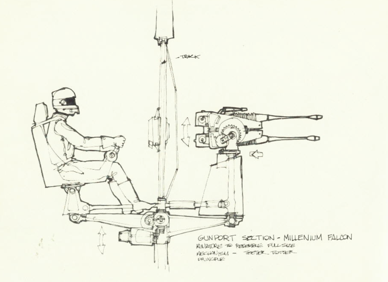

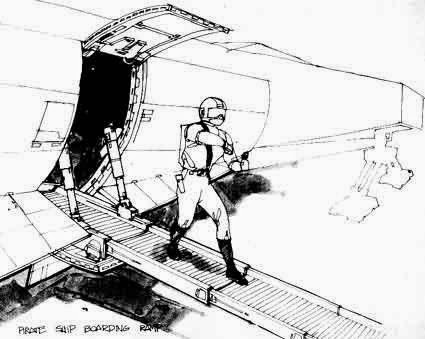

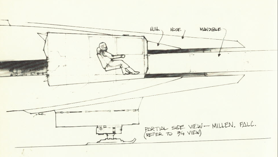

The MPC figures look more like 1/96, possibly 1/87 (HO scale). The Han figure seems to be based on the Joe Johnston sketches which showed helmeted figures in and around the "pirate ship".
14720648190_a9ebf9919e_b.jpgearly-ramp-1.jpgjoejohnstondesign starwars.jpgScreenShot2013-03-21at201549.pngScreen Shot 2015-10-20 at 22.07.43_zpsz2idsnfp.png~original.pngScreen%20Shot%202015-10-20%20at%2022.07.33_zps5oqlesng.PNG
