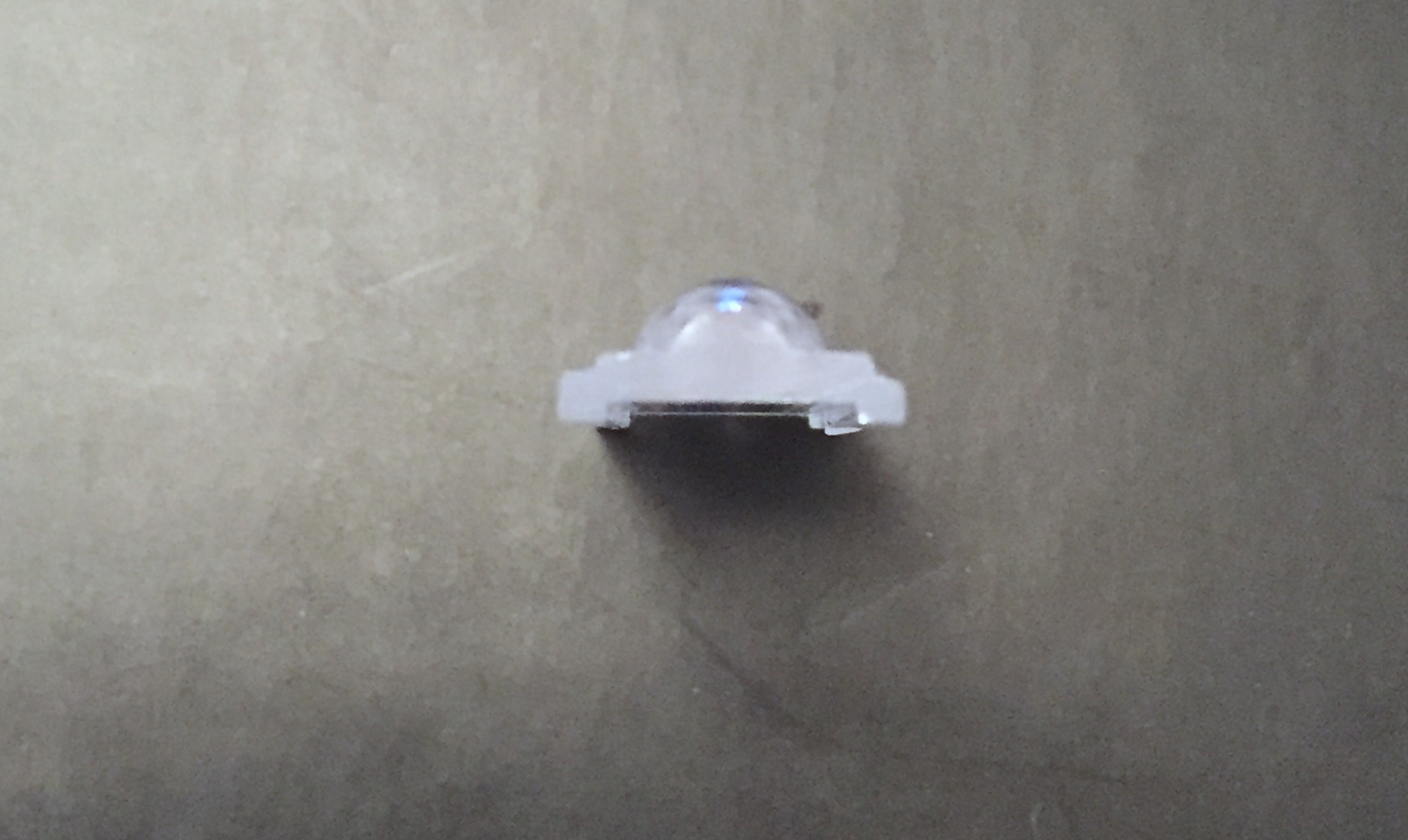

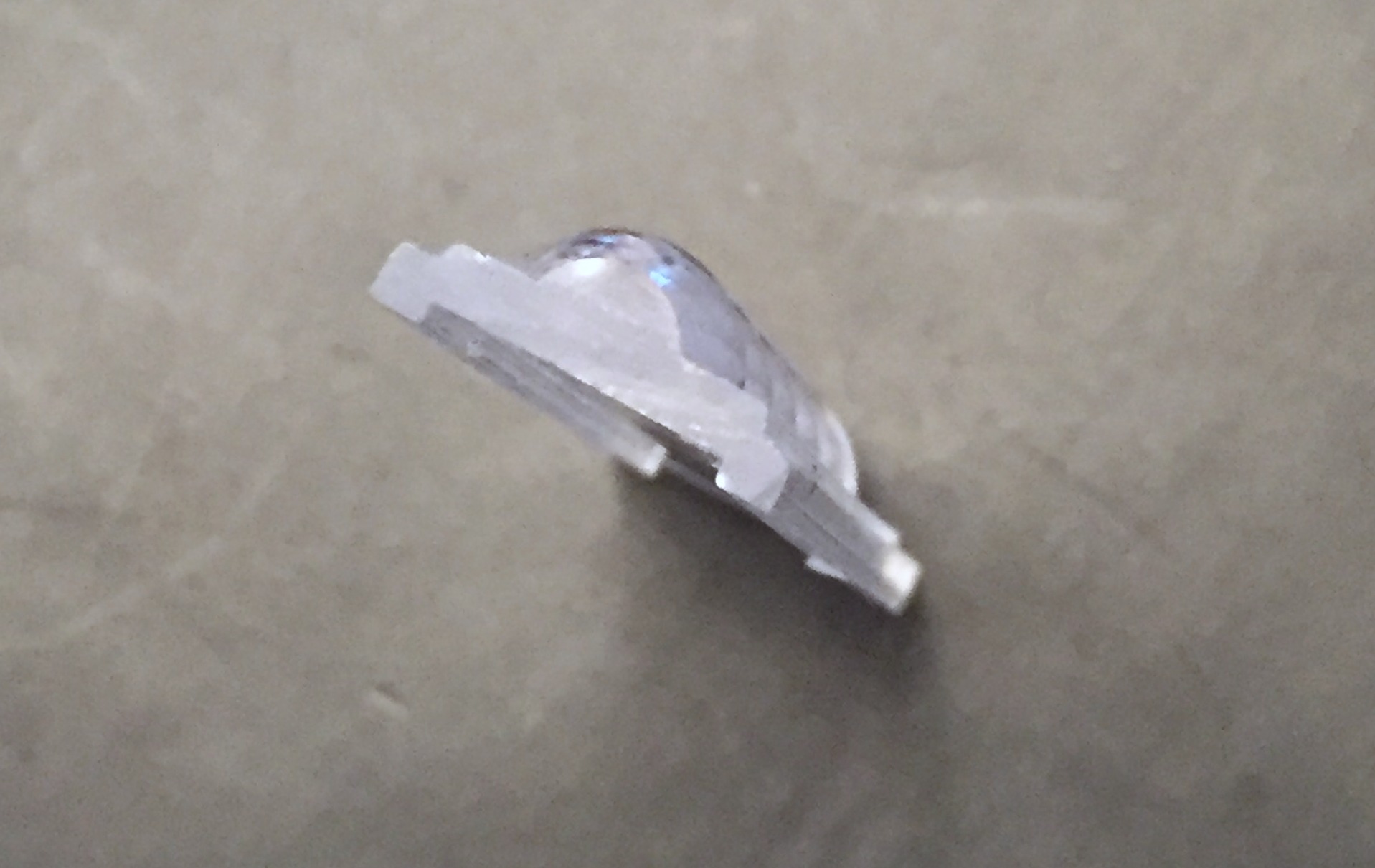

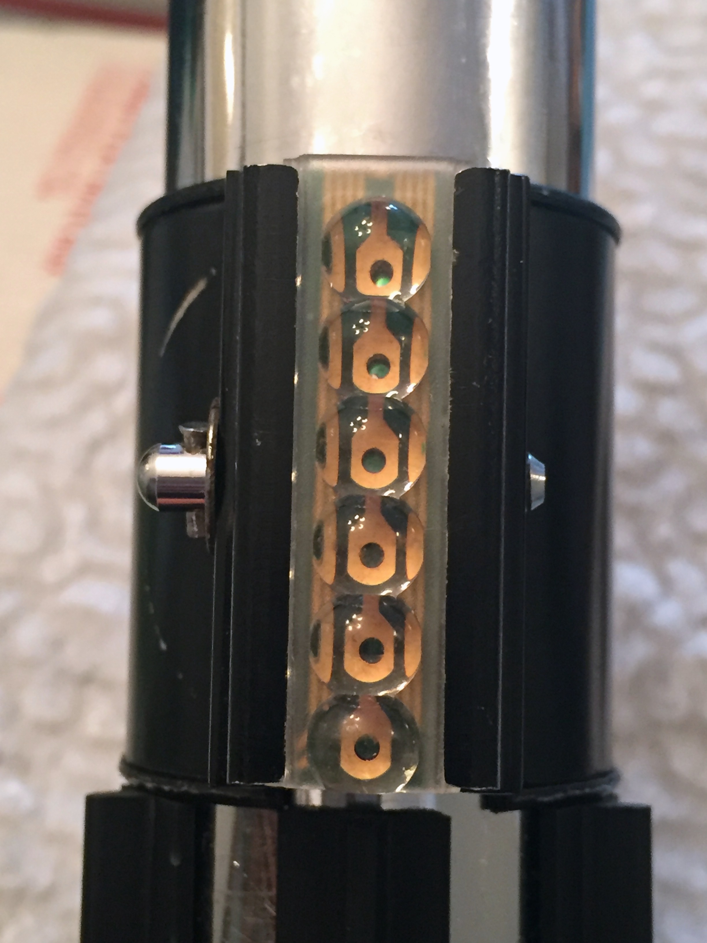

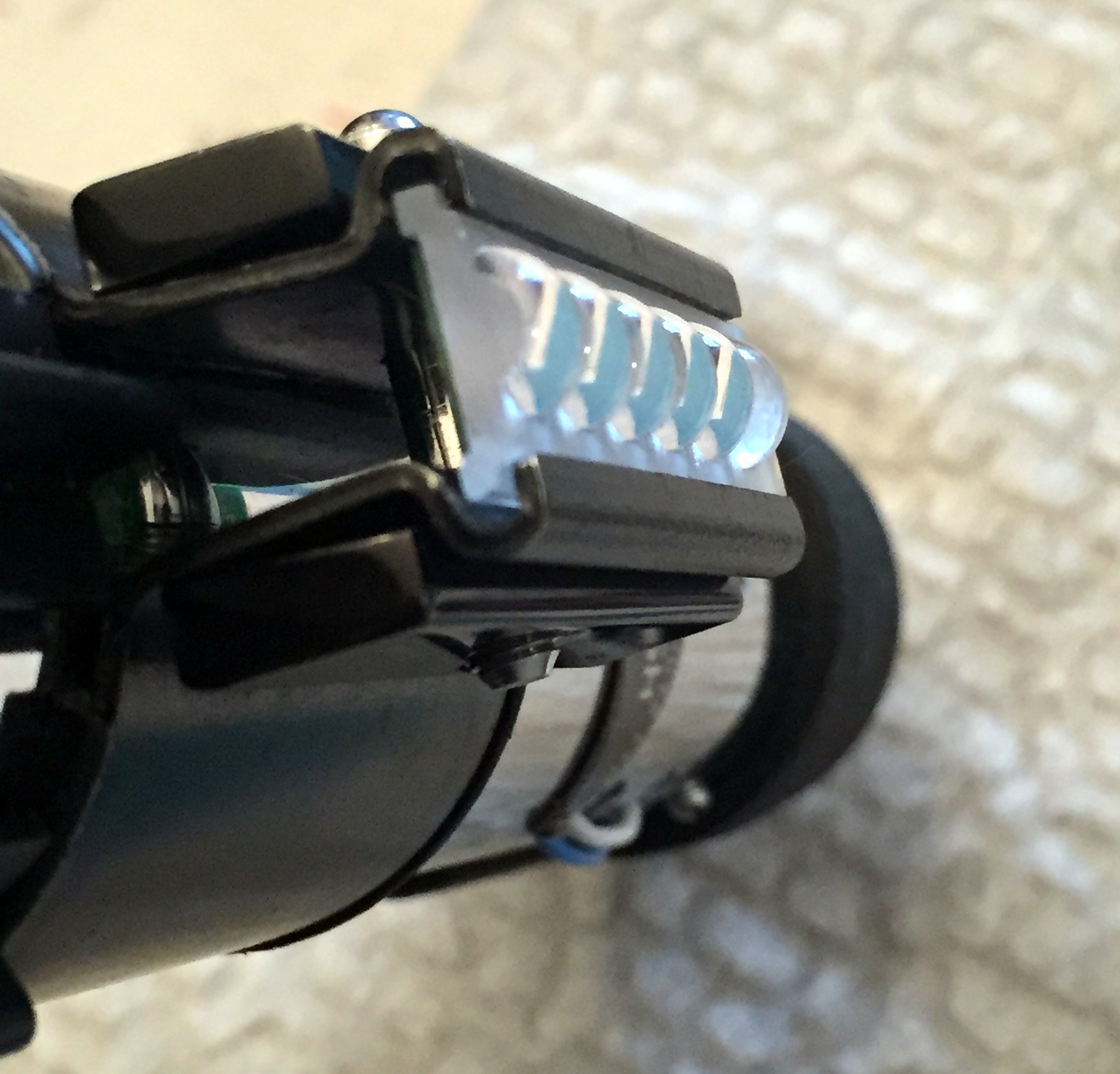

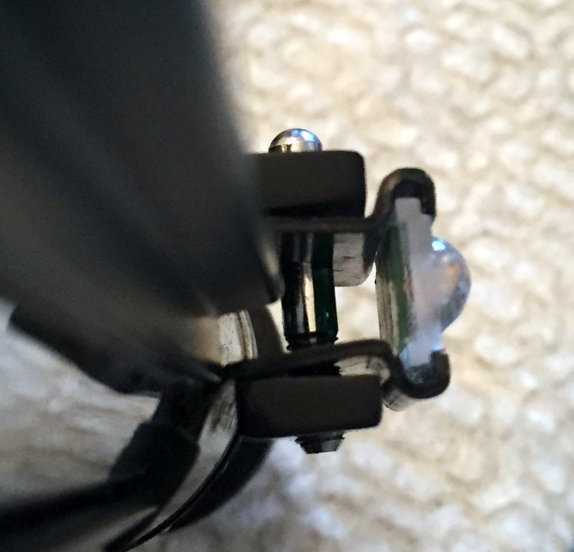

More progress! I finally managed to file down the bubble edges and once again, I am very happy how they turned out (and yes the masking was mostly unnecessary, but there were a couple of slips here and there that were close calls!).
Let me say however that it is a pain in the ass to do... mainly because the surface area you have to work with is so small... but a little patience and perseverance...
I tried to cheat a bit and just use clear tape to secure the circuit board... which didn't work out so great.... so clear epoxy it will be!
I think I'll also shave a bit more of the ledge... I didn't want to go too deep initially because there isn't a lot of material to work with to begin with, but I think a few more mm off is in order to make it a bit more flush with the clamp edges...
Almost there.... :D

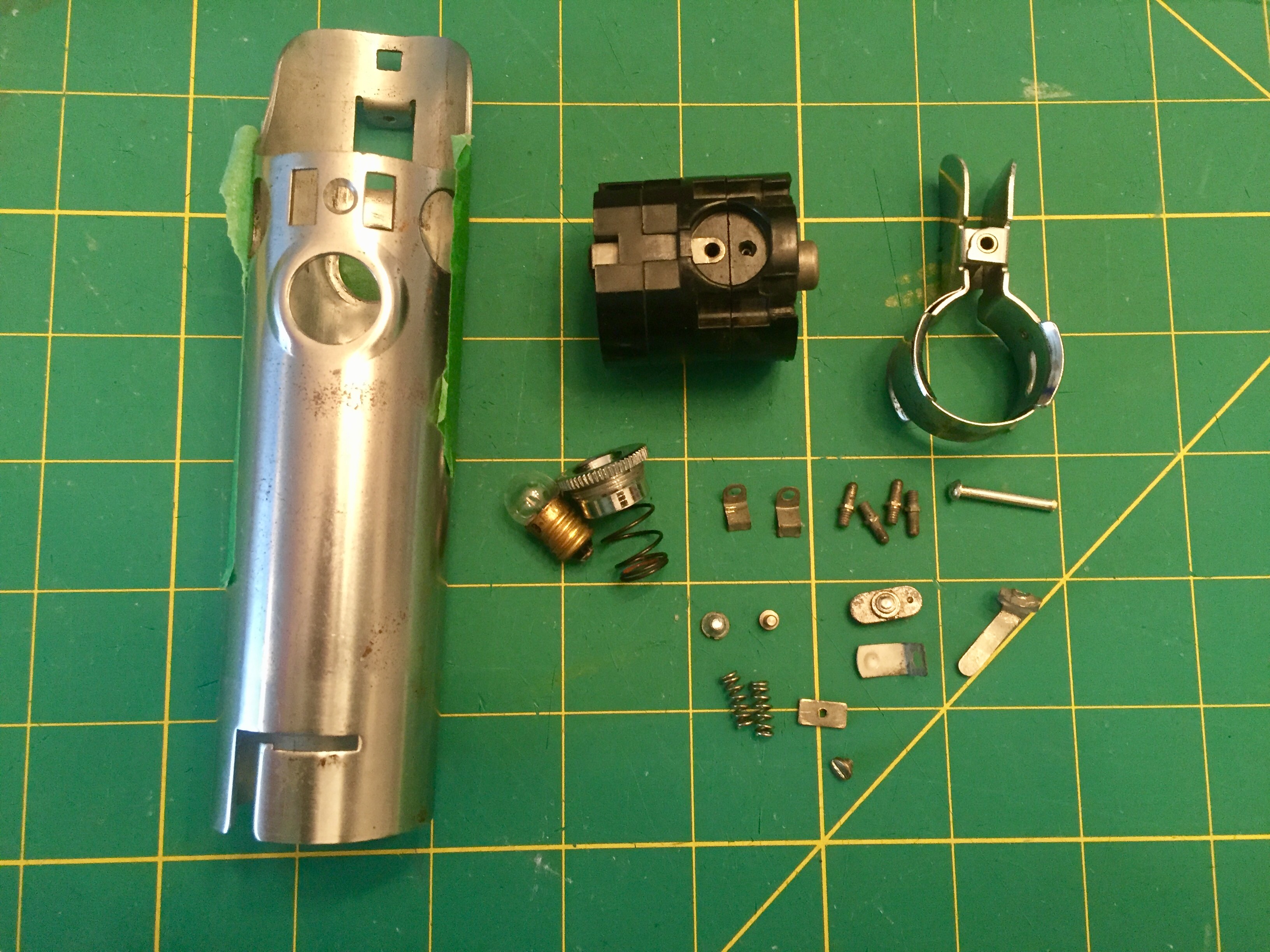

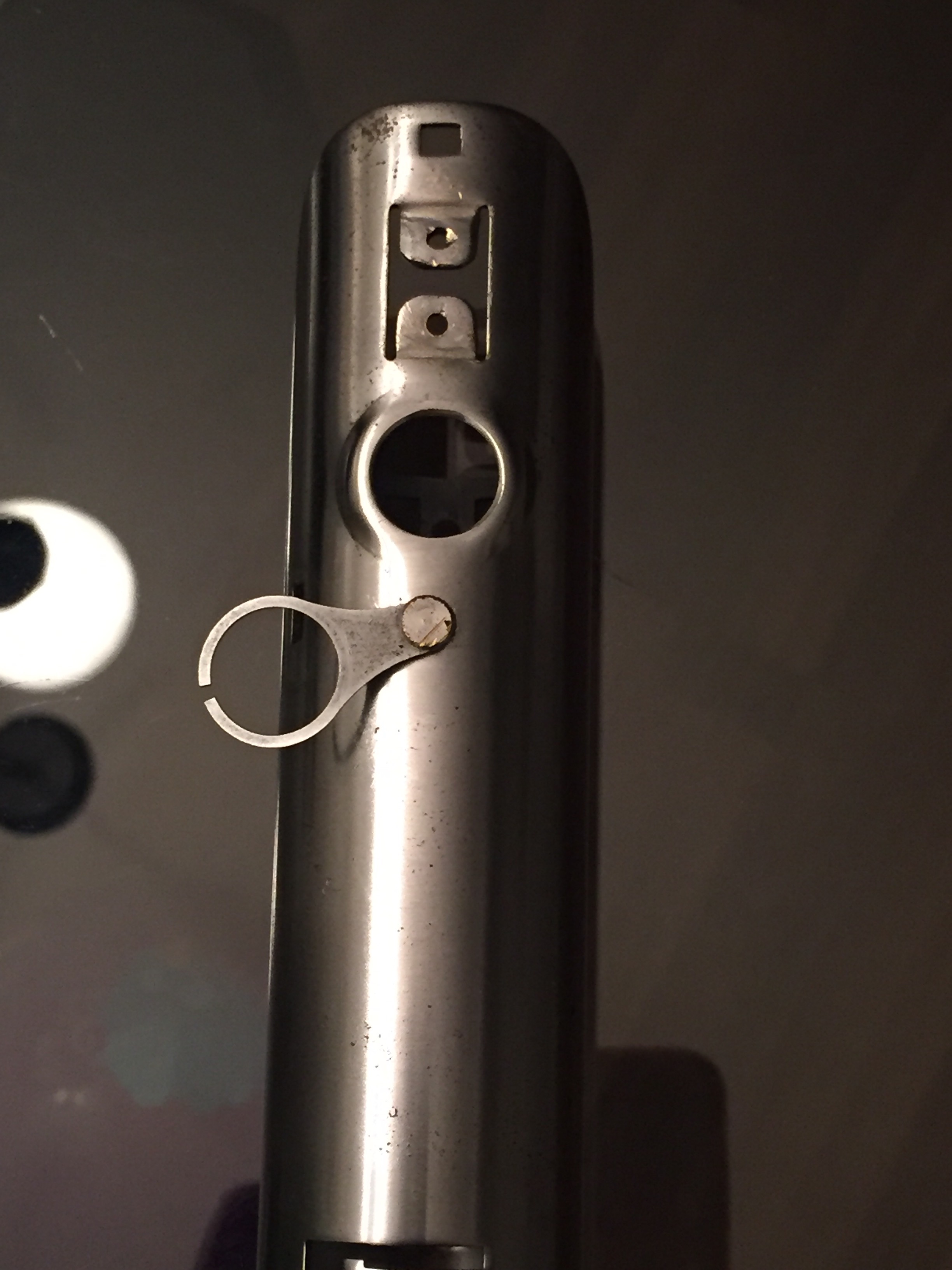

I disassembled my very first Graflex top! This will eventually be used for my vintage Graflex Vader ROTJ stunt saber build.
Scary as hell of course since I was afraid I was going to screw something up or break something but so far so good!
I still need to pop off the beer can tab (any advice? I thought I could just pop it off but it's not a simple as I thought it would be - I think I might just drip it out now that the innards are out of the way) and flatten the bunny ears holder (any advice on this as well?).

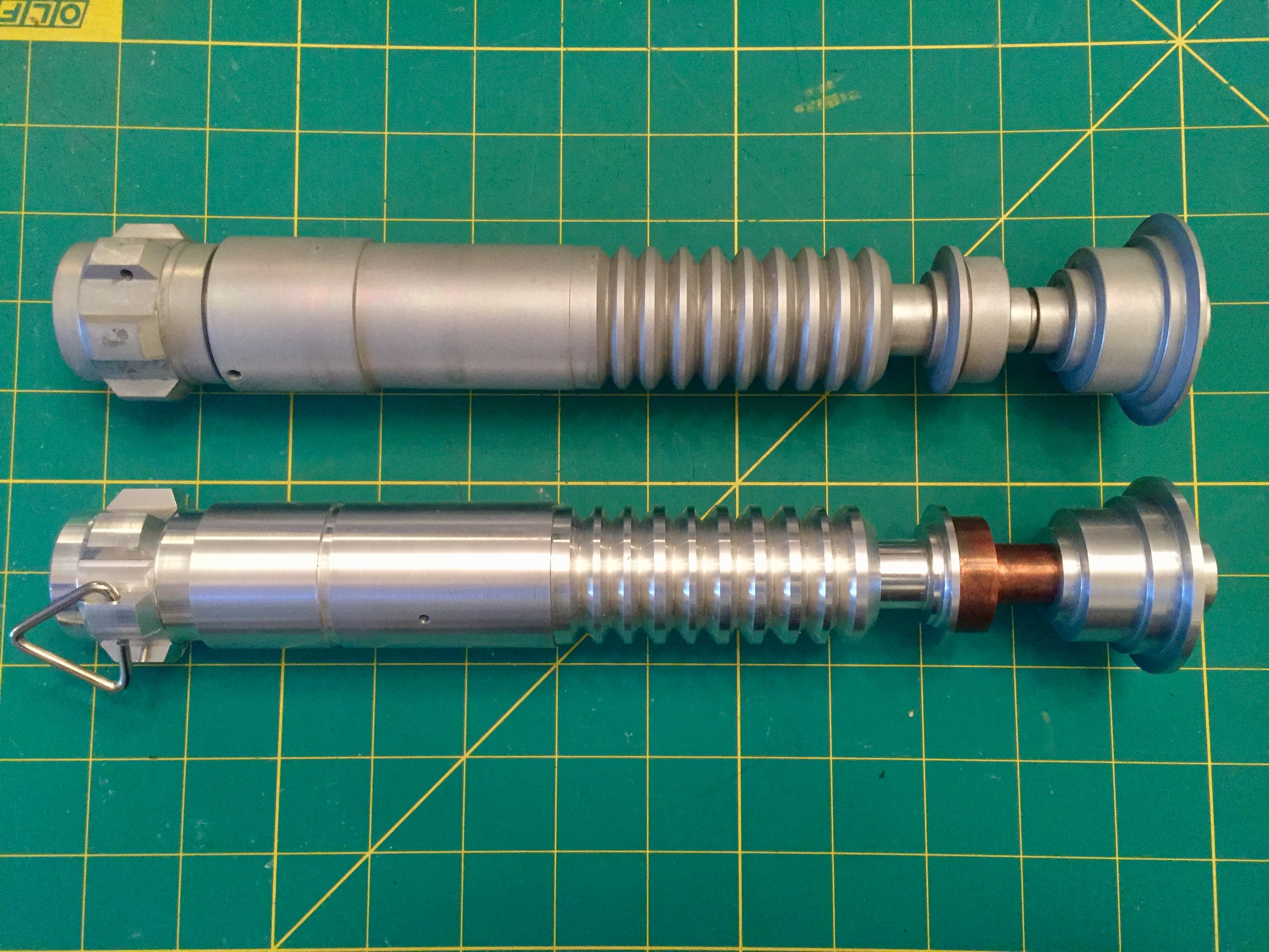

I also ran my unibody Starkiller V2 through the dishwasher a couple of times... very happy of how dulled down the finish is. Here's a shot of it with my Nicksdad for comparison.
I also sanded away the machine marks away from the pommel cubes.

I honestly have yet to successfully flatten the bunny ears tabs. On a Larbel the metal started to split like bread dough, and on a graflex slave I destroyed the bunny ear pin, and then couldn't get them to go past like 30 degrees :lol
Re: Edraven99's Real Parts Lightsaber Build Thread - A Non Obi Related Update?!?
Not inspiring lol...
Hahaha
What I used were big strong needle nose pliers or flat pliers with a pointy tip (you need thin ones to get the angle) and slowly bent them in. after a while I couldnt figure out a way to get in there without turning it upside down and pressing them on the table, if that helps
Hahaha
I was thinking of using pliers for as far as it'll go and then maybe using a vice clamp for the rest of the way if I can find one small enough...
You can usually pry the beer tab out easily enough with a thin flat head screw driver. They usually pop right out. If it snaps, just use a tiny punch to push the remaining nub back the other way. I've really come to love this one of Vader's sabers. Really looking forward to you taking a whack at it! If you find a really good door latch, save one for me ;)
I may be getting a vintage flex with the bunny ear tabs almost flattened already so it it possible. If I do get it, I'll see if I can work out how it was done.
grab that sucker with pliers and twist. it'll snap off.
lol... I've tried pliers, tapping it out, sanding down the bottom, and wedging a thin screwdriver underneath and prying (which broke a chunk off of the screwdriver)... the damn thing is near indestructible!!!
