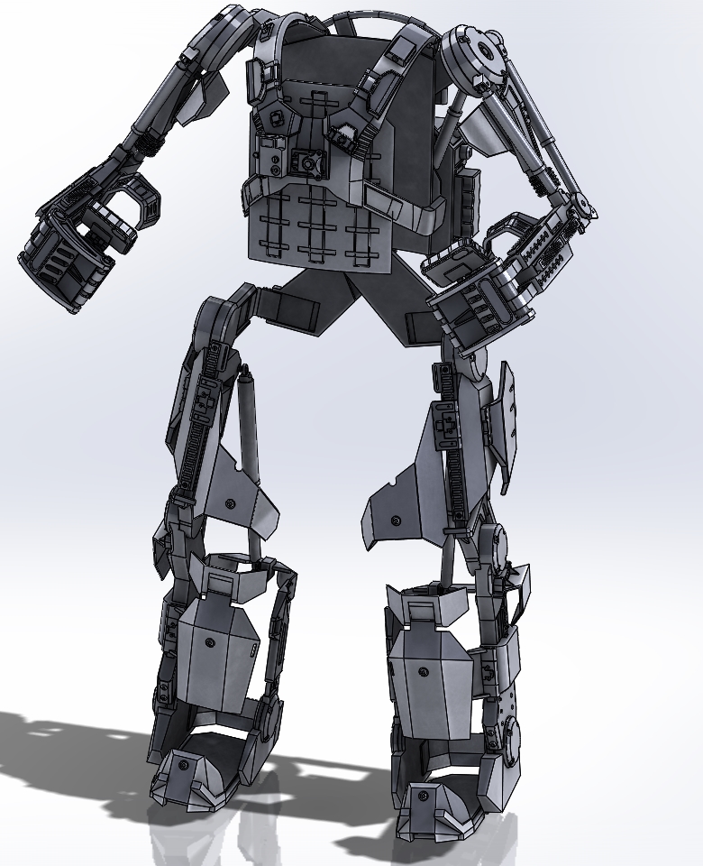

I think for the most part I'm really happy with the model. I updated a bunch of little things based on the images flimzy provided. I'll be double checking all the references before I go to fabrication, but all in all I think I'm playing in the same park as the original for sure.

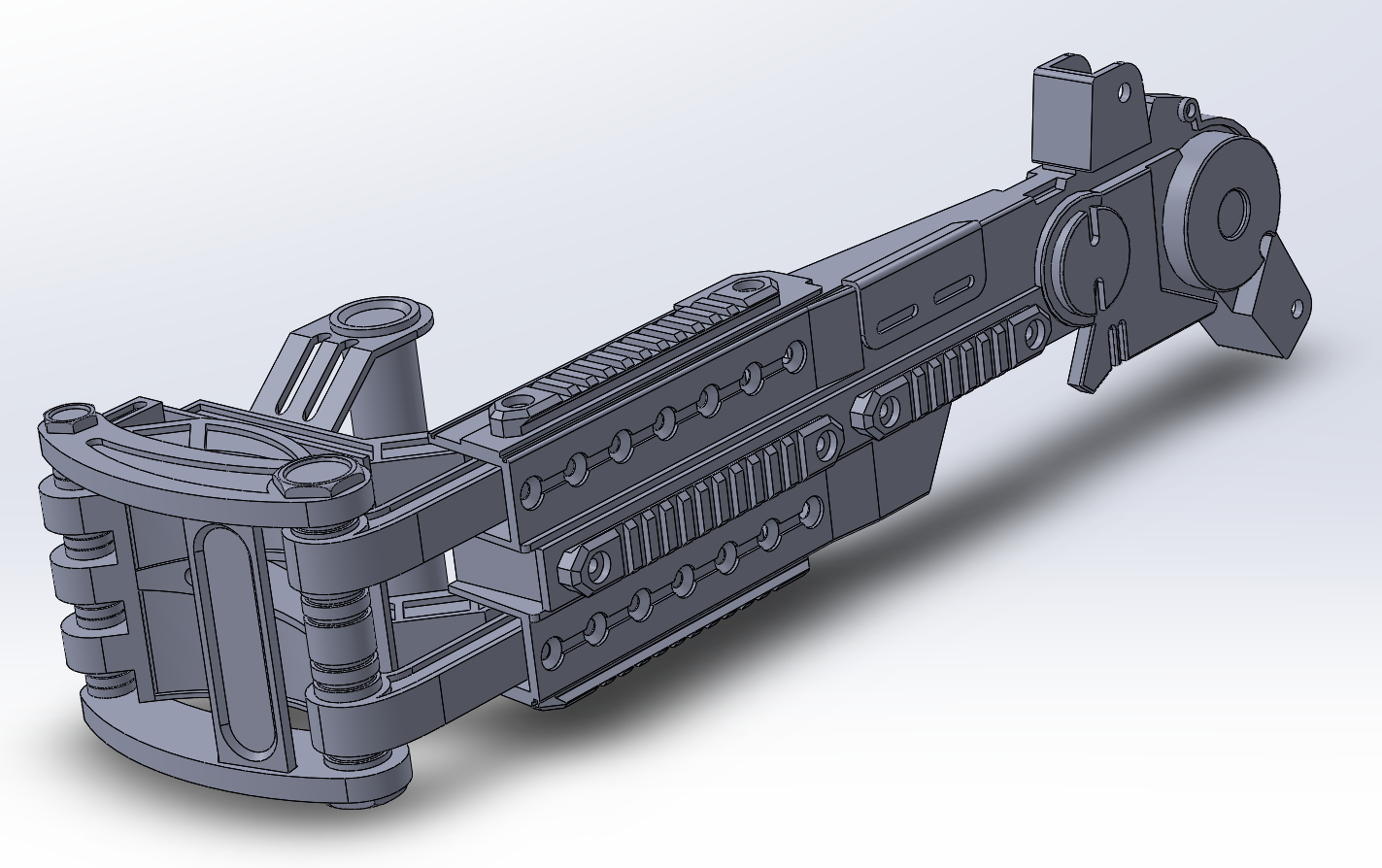

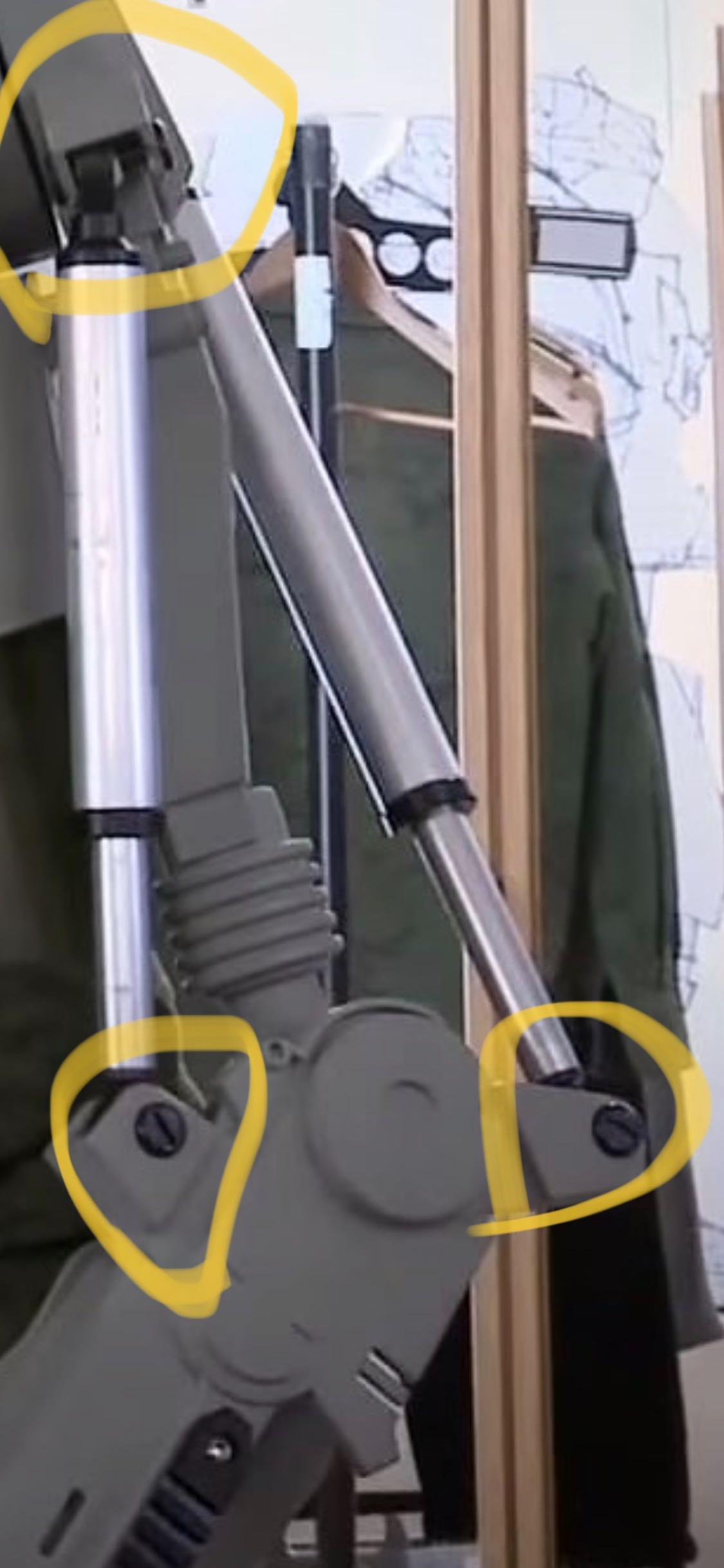

I'm making small tweaks to the model as I'm splitting stuff out. Thanks to Flimzy posting some amazing CAD shots I've been able to see some geometry that I didn't see before. I'm also adjusting scale and stuff based on found parts. I found the binding screws that were used on all the rod ends and because I know the head cap is 16mm I can now adjust the other measurements accordingly.

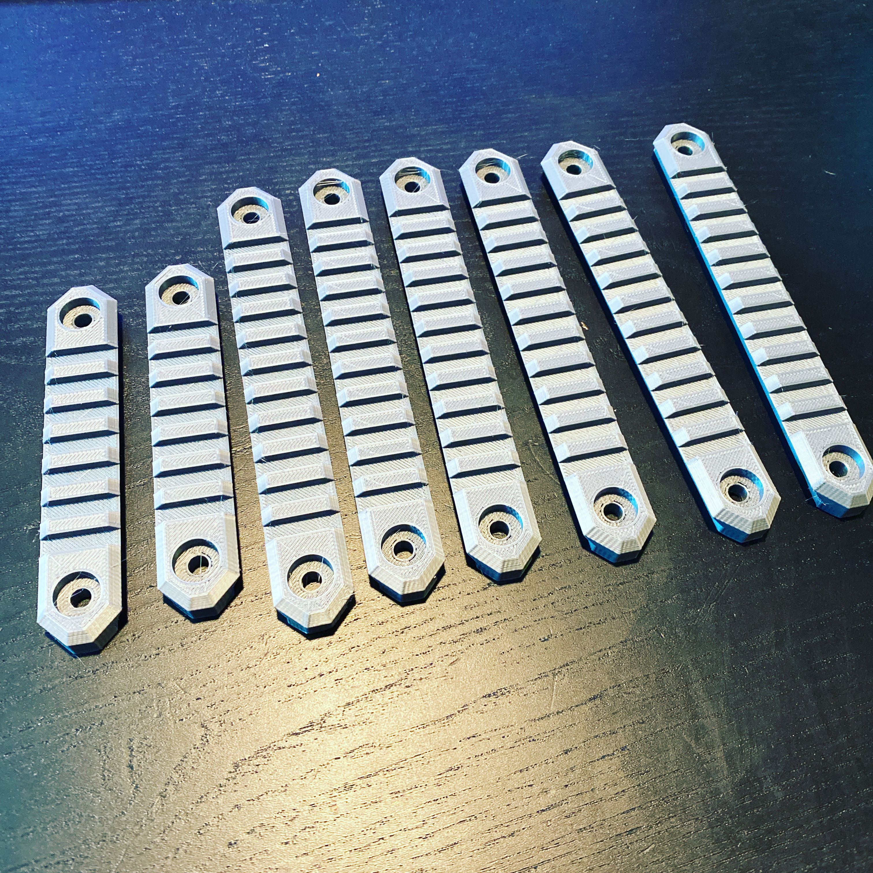

The forearm/hand assembly got an overhaul recently so I figured I'd share that. If you reference my old pictures you might notices a few changes: rail sections, overall scale, added detail, switching to metric units instead of standard... cause duh (the props were made in Europe).

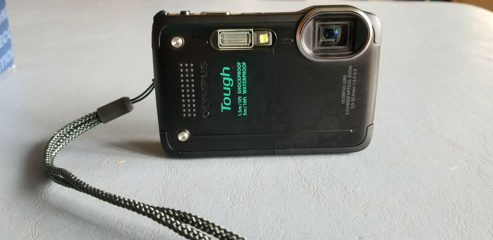

I also made the plunge and bought two used digital cameras off of ebay for the weapon systems screens. The plan there is to maybe make an animation sequence with sound and upload it to the camera so that the video plays on the cameras LCD like a little video player. Olympus Tough Stylus TG-630 if anyone is interested.

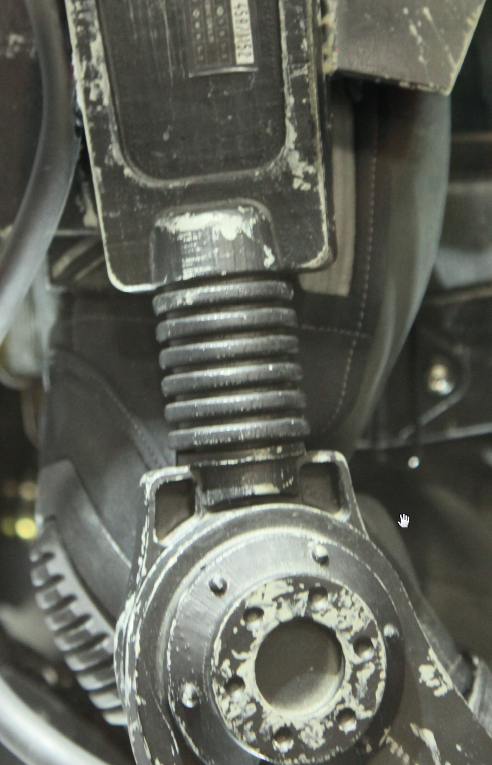

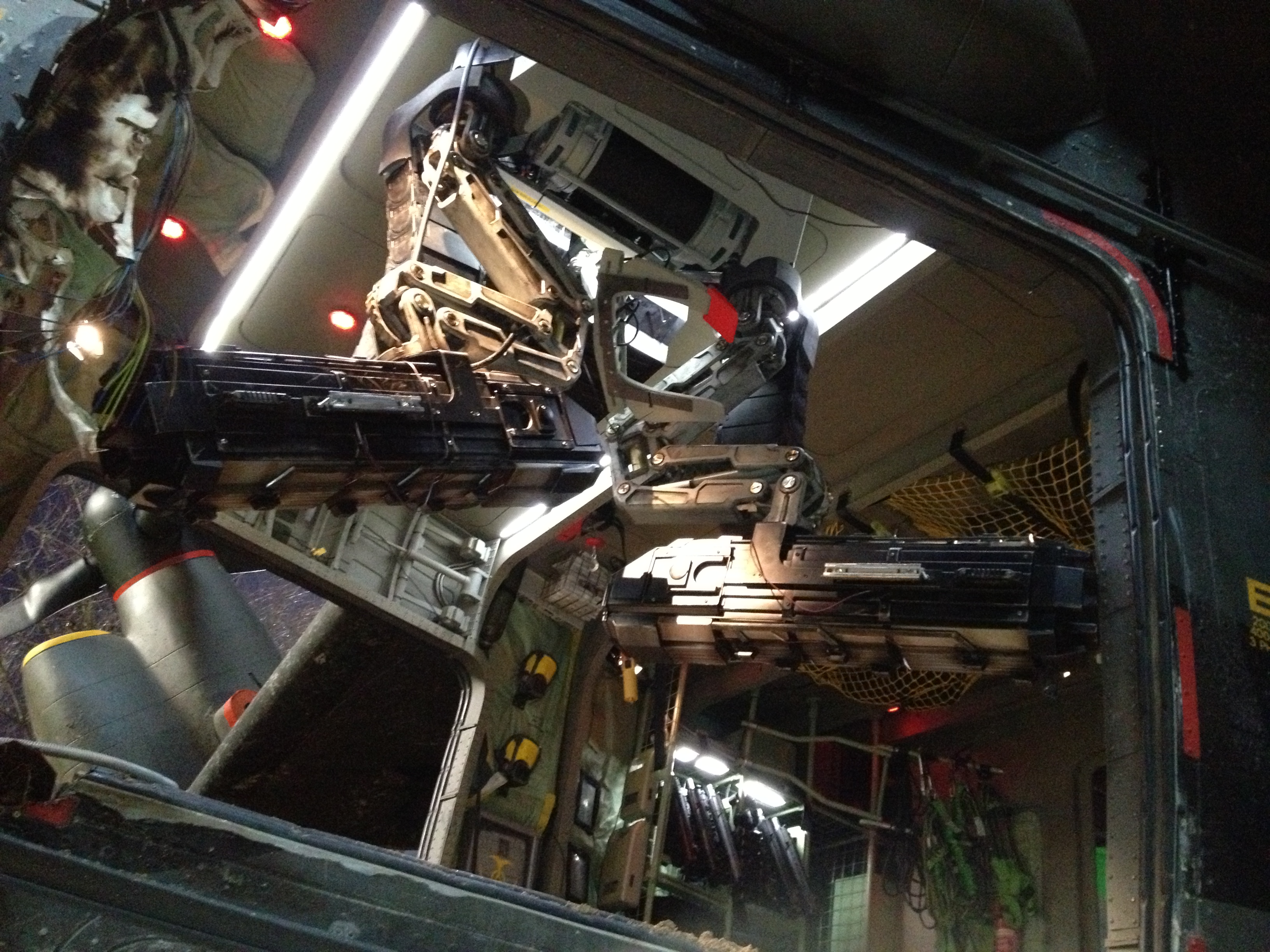

Here's a pic I snagged of the og costumes when they were on display at comic-con a billion years ago, in all its grow line glory. Thank goodness for weathered paint jobs!

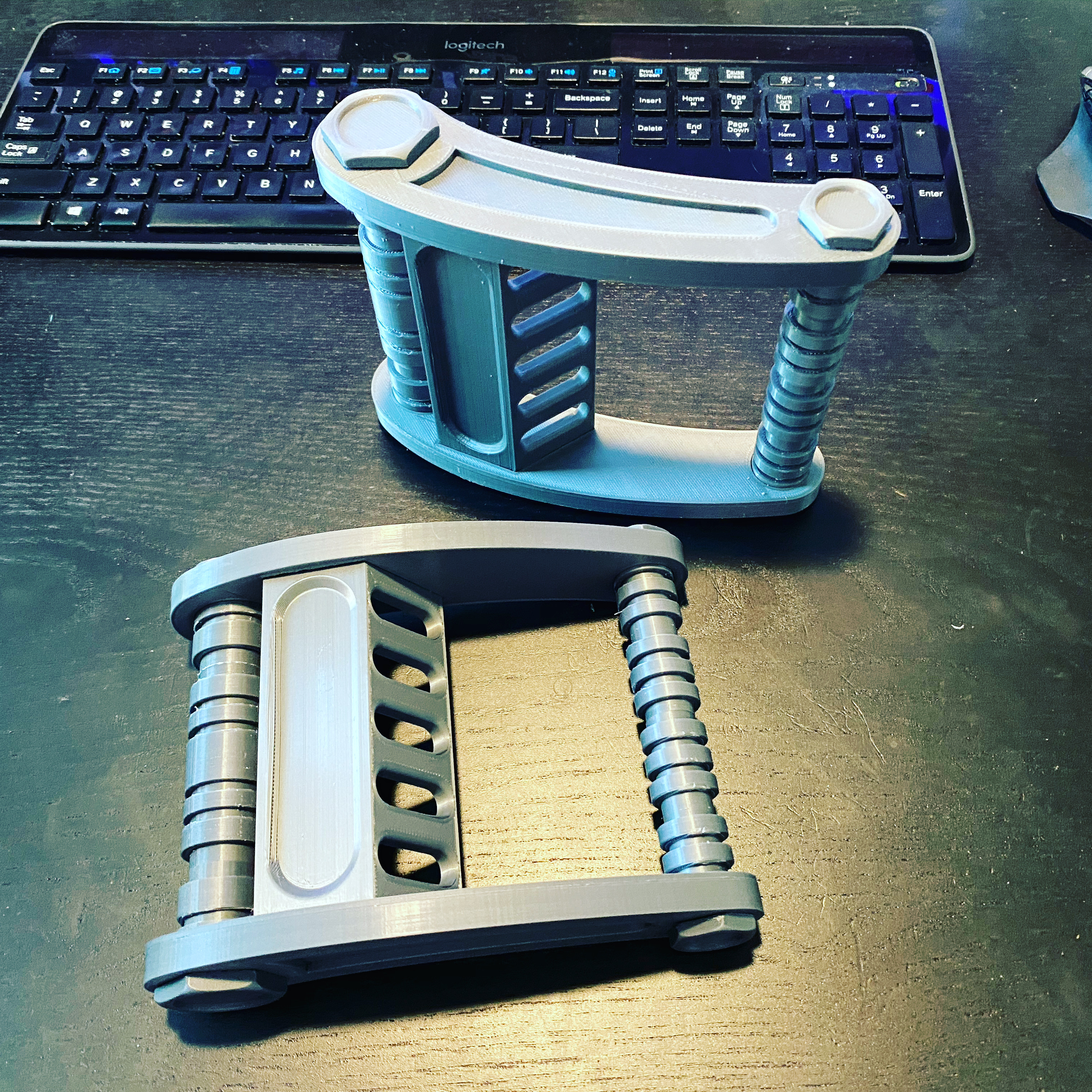

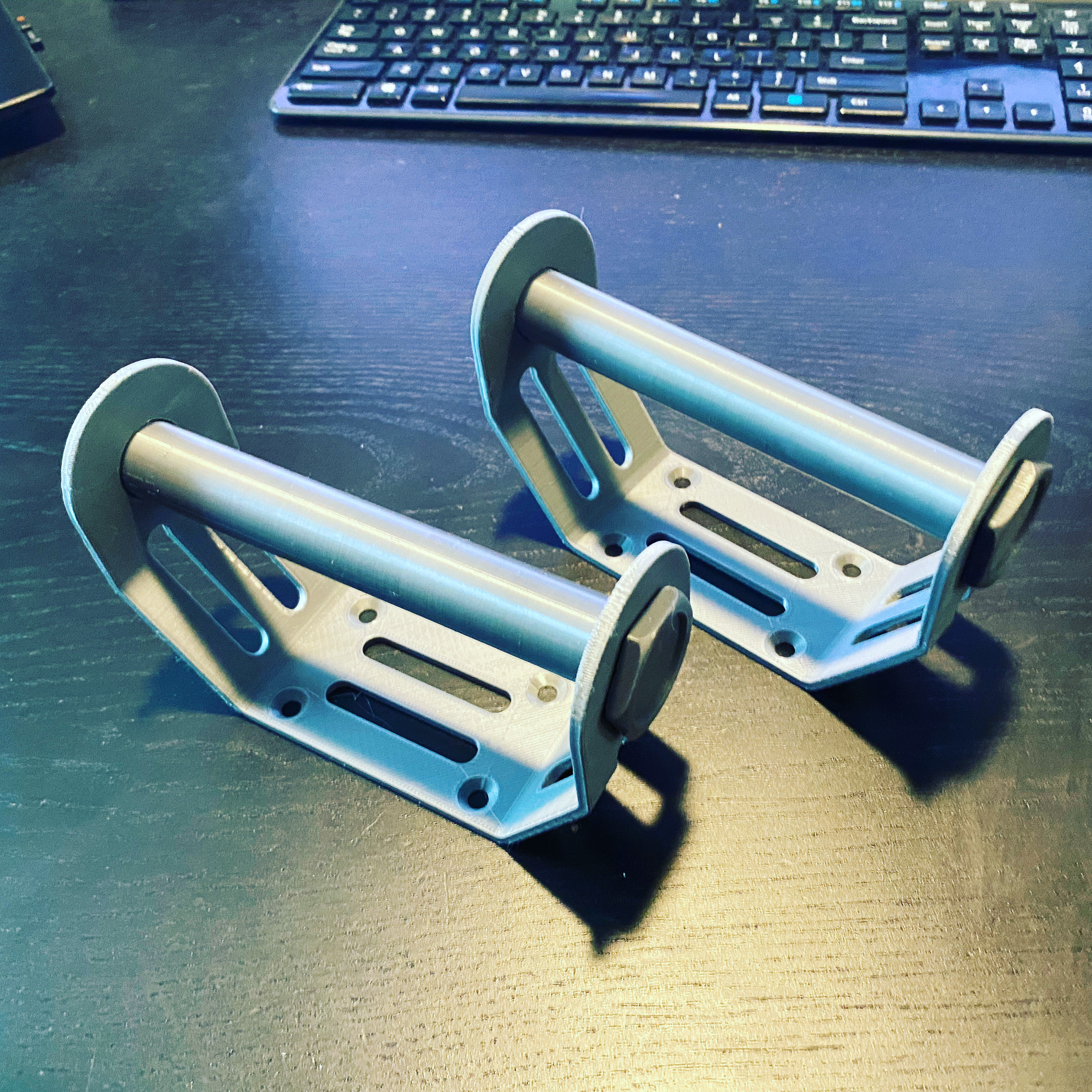

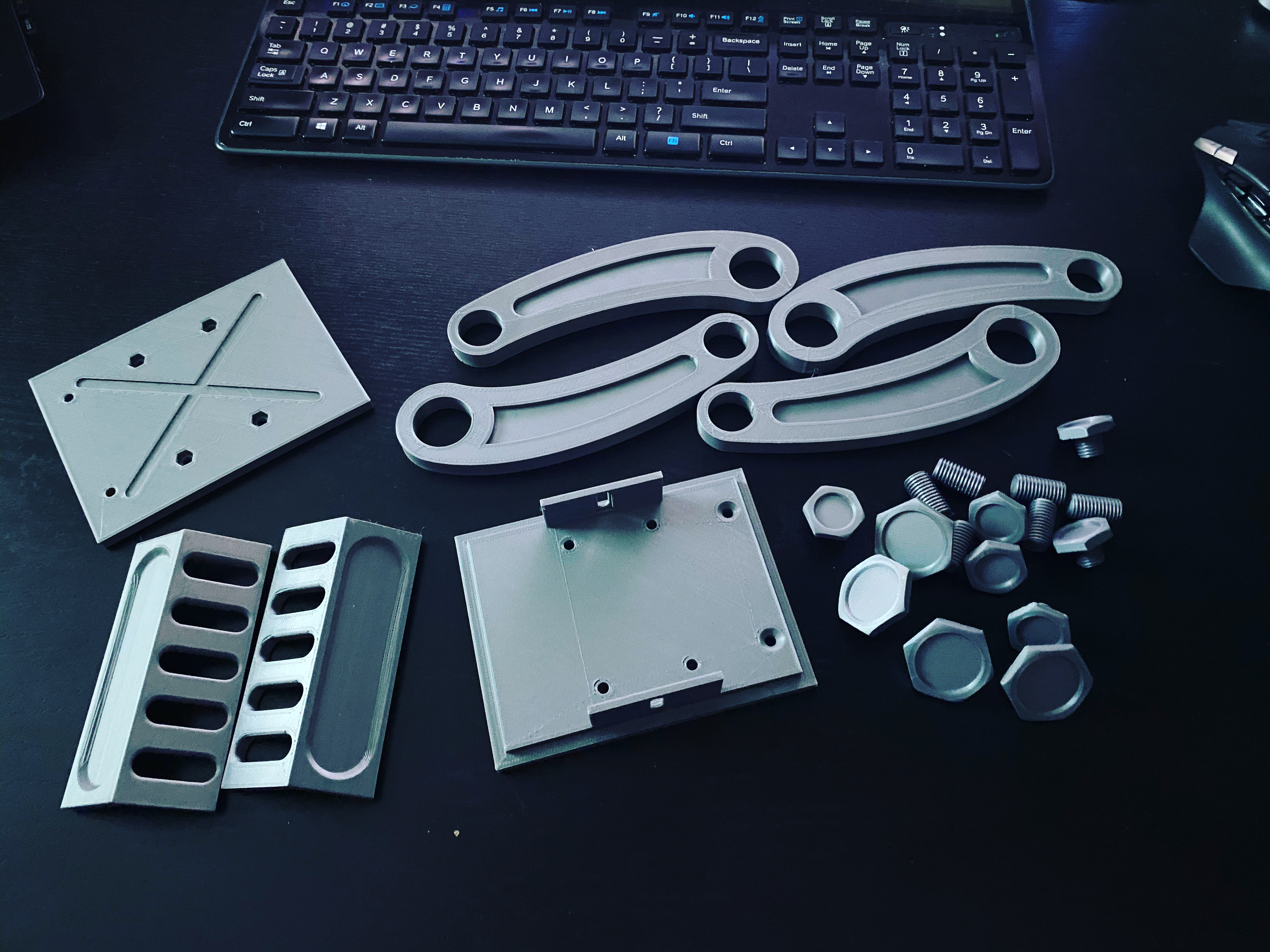

Wanted to drop a few pictures in this post as well. One fun thing I'm doing for any assembly pieces that don't require screws or other fixtures is creating threaded attachments so that you can assemble the part right off the printer. These handles have threaded bolts that screw in to the rod section.
I've enjoyed making the threaded sections so that the pieces just go together straight of the printer.
