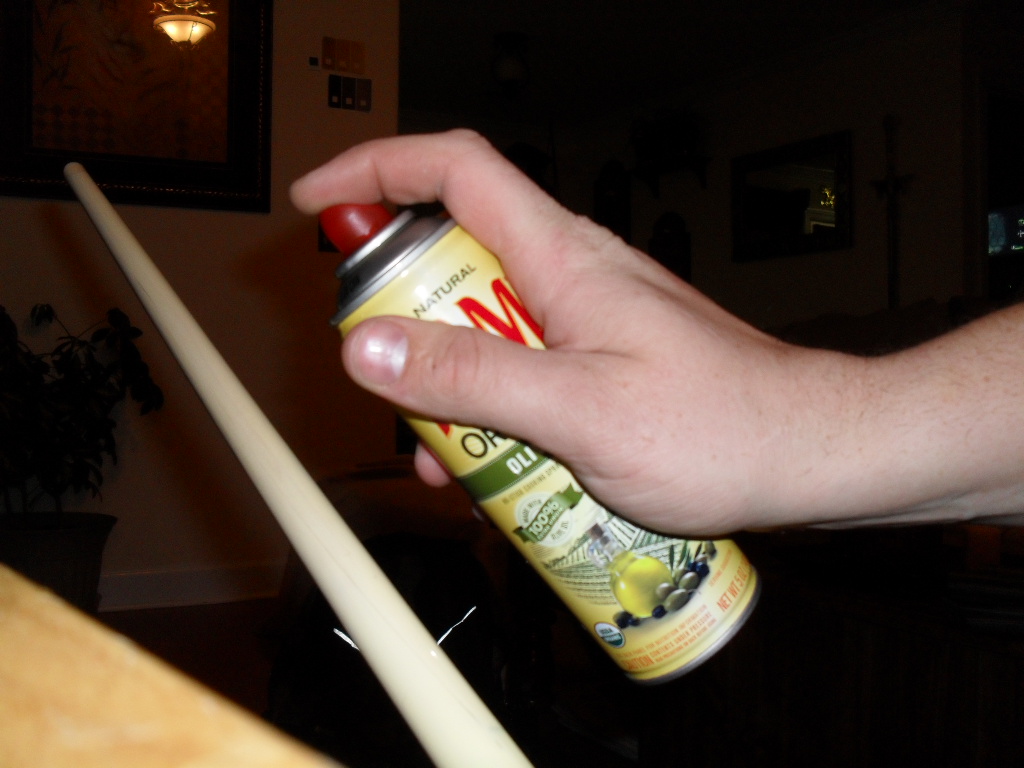

In these pics, I used a cheap pool stick (Wal-Mart $7) and cut it in half. Measure about 23"(inches up and made a line) so I have good length for the finished dredlock. In the first pic I'm spraying it down (drenched) with PAM cooking spray, because when you shrink it down it will get real tight and not want to come off, unless it's well lubricated. PAM has a polymer that acts as a good lubricant to slide the dredlock off when done. I'm sure you could find somehting else, be sure to experiment first. I lost 2 prototype dredlocks because Vaseline did not do the trick.

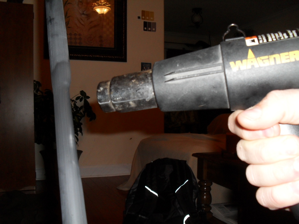

Then using a heat gun, I shrunk down the tubing to the shape it to the pool stick.

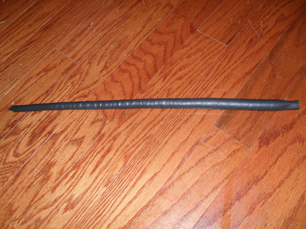

You can see a comparison of the before and after using the Heat Shrink Tubing. I hope this helps as this is the easiest and cheapest way I found to make dredlocks, since I don't like using Backer Rods. Please feel free to post and add comments as I'm always open to improving my methods or may have missed somehting. You can easyily finish 10 of these a night, whe you get the hang of it and heat gun.
Also they are very light and move around a little when you turn your head left and right. Not as flexible as latex but are quit flexable. Filling them gives them a wierd squishy realism factor too.
