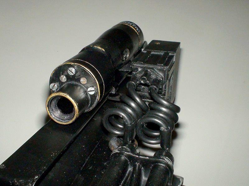

Here's my blaster under construction with replacement screws (M6 25mm x 6mm hex head) but pretty much cut the thread right off installing only the head.
It is a great kit especially value for money, you can get one in a week or it can take 4 weeks, depending on stock and production turn around. A few days ago they had 6 in stock. Even if you simply glue it together without any mods, it's still a good looking kit. Here'a a few photos with only a few screw mods and some simple rub and buff weathering.
