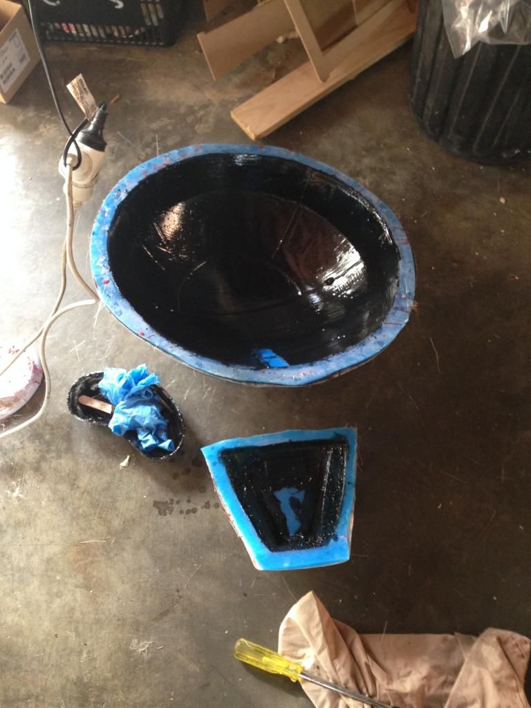

First we did the Dome and Cowl in our silicone mould. We applied two layers of Gelcoat followed by 2 layers of fiberglass. This is the first layer of gelcoat in the mould.

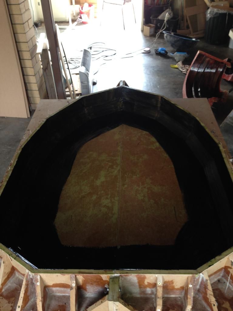

Next we moved to the reverse fender buck and once again did two layers of gelcoat and then ended up doing 4 layers of fiberglass for strength.

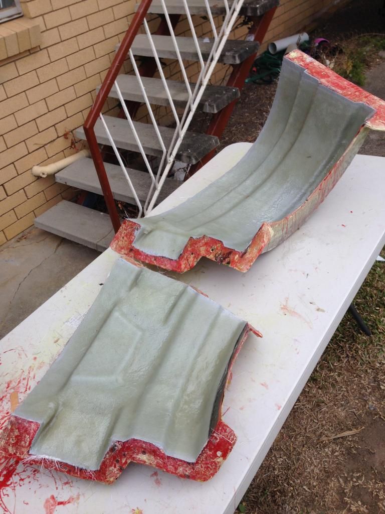

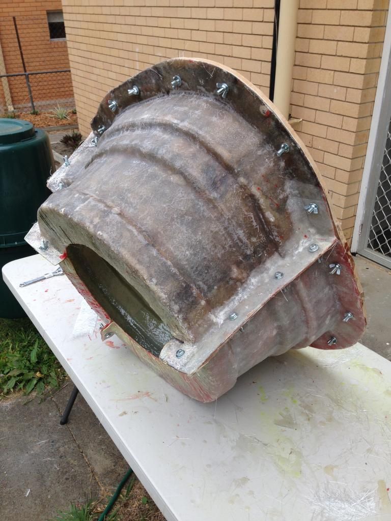

After that we moved on to the shoulders and yep you guessed it, two layers of gelcoat and 3 layers of fiberglass!
The shoulder buck is in three parts so we did all three segment's and then bolted them together, putting three layers of fiberglass over the joins. Once the three layers were together we attached the bottom of the buck and did three layers around the bottom.

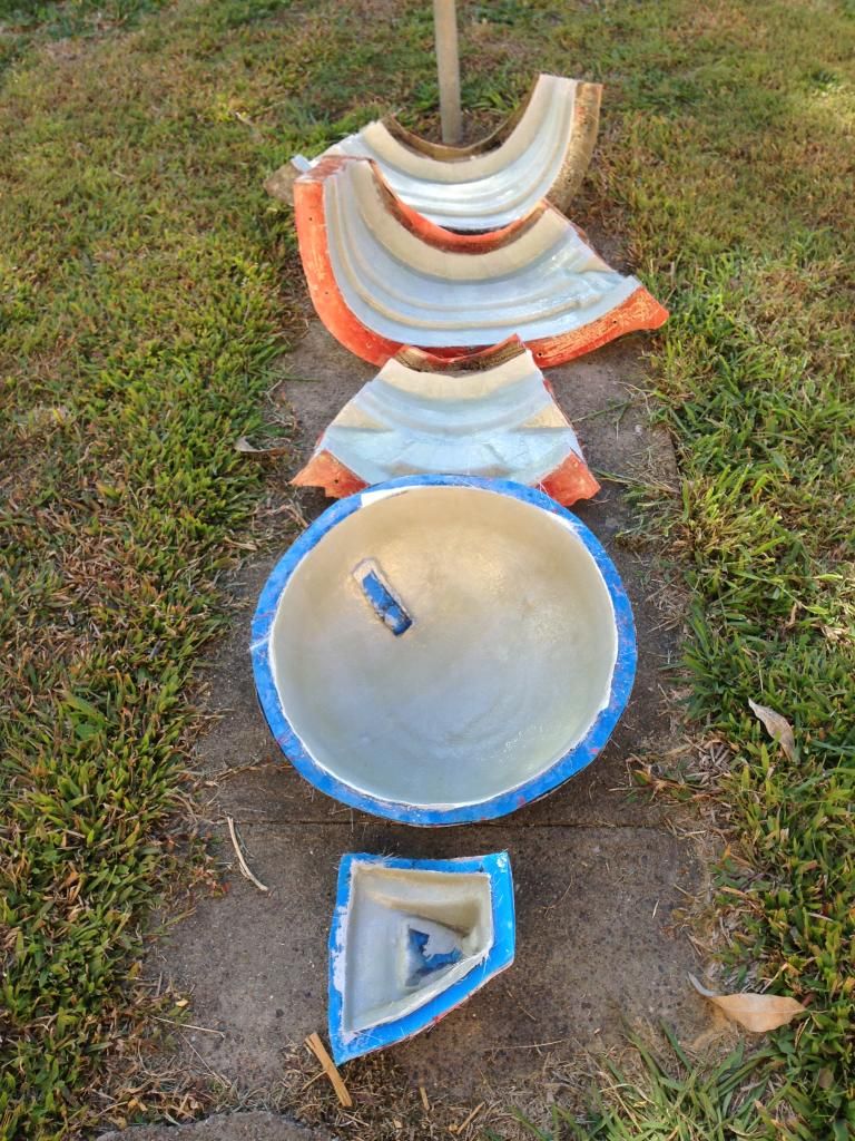

Here are the parts in between fiberglassing, this was honestly a massive but awesome day.
So everything was demould that afternoon and everything popped out fantastically. No issues what so ever and will require very little clean up!

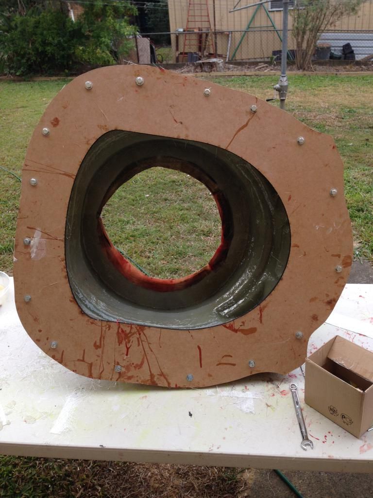

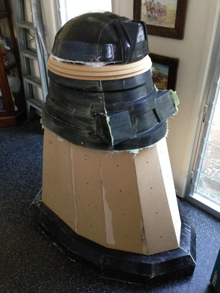

So this is where we sit at the moment, there are three MDF neck rings under the dome and cowl in the photo, I need to build the neck cage next and then start all the clean up work and fine details.

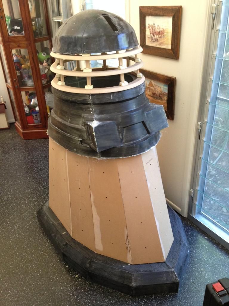

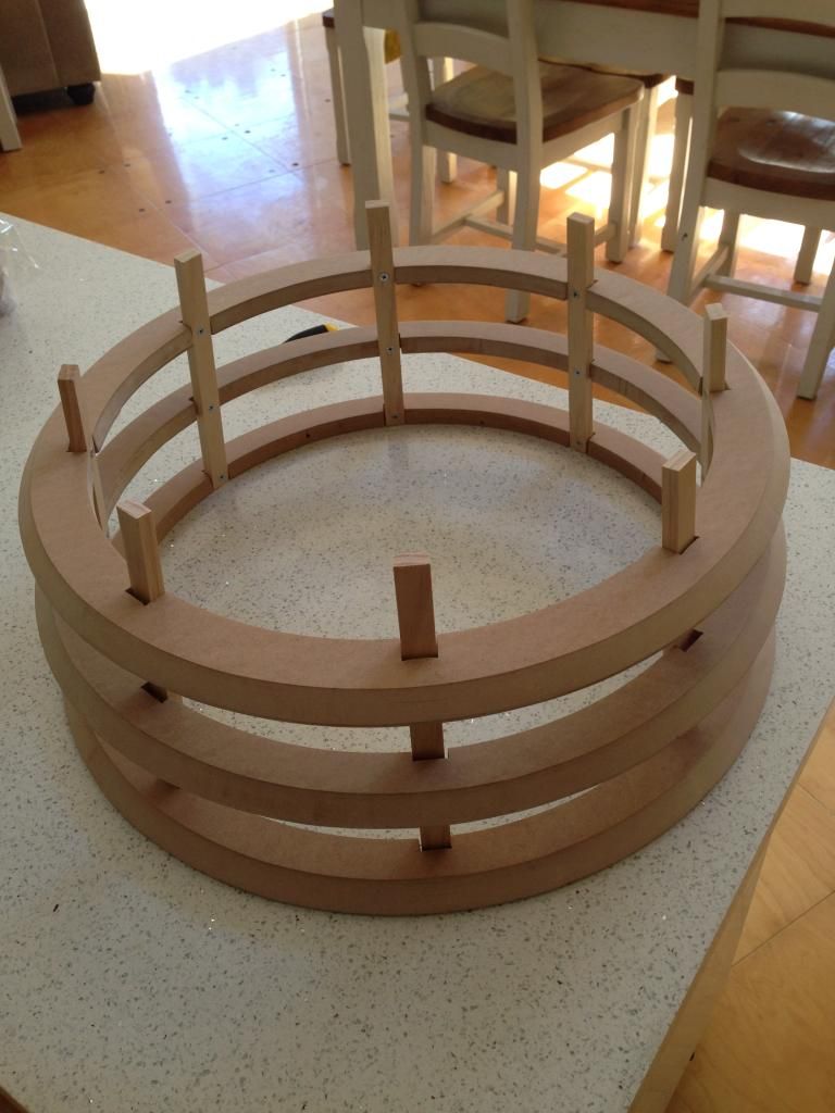

Little more progress on Sec, I have got the neck rings all together and neck ring struts in place with blocks completed. I need the very top ring done to hold the dome in place (as you can see it hangs over the top ring).
Hoping to get a lot more done over the next few days.
Here is the neck completed without the blocks, it will hide a lot of my mistakes!

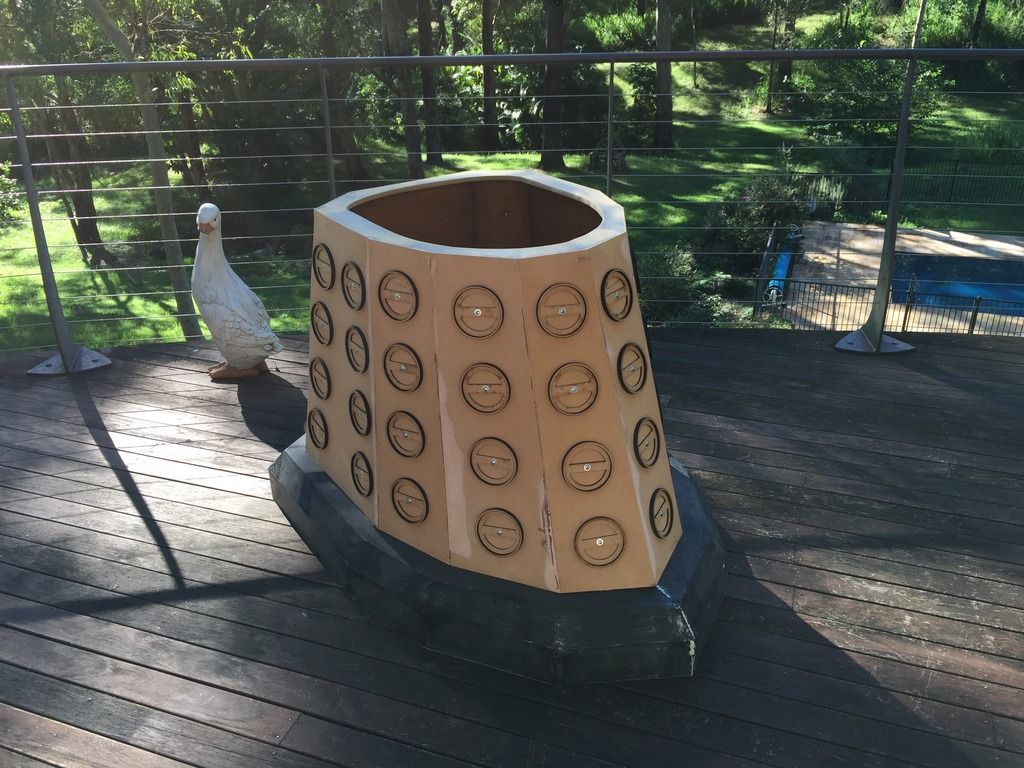

So after a long build hiatus I thought I would get stuck back into the build! Don't you hate when real life stuff gets in the way of building things! Damn real life! But anyway, I have now attached the fender to the skirt with 6 bolts, sanded the and filled the fender to 1200 grit wet and dry (so smooth!) and put together the 'oil seals' for the hemi's. I have also attached the hemi 'oil seals' to the skirt where I will now give the sides of the surround a quick brush over with watered down PVA glue before I prime the skirt and fender.
I have also bolted the shoulders to the skirt now and have started to clean up the slats that run around the shoulders. They have been built out of MDF so there is a little bit of filling and sanding that needs to be done.
