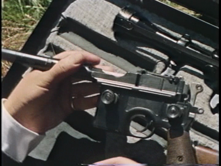

Just watched Adam Savages one day builds of the DL 44 again, @ 4:10 they show the Naked runner mauser, the mounts on the other side, the nut/bolts with what looks like a
washer underneath near his hand side. The rail is not on yet, which kinda makes me think that when the gun was fitted with the scope mount it was assembled like this and given a quick touch up spray of black to paint the thumb screws and any bare areas. Take it off after, and there is the mystery disk. If the paint is thick enough it would also make the area looked as if was milled.

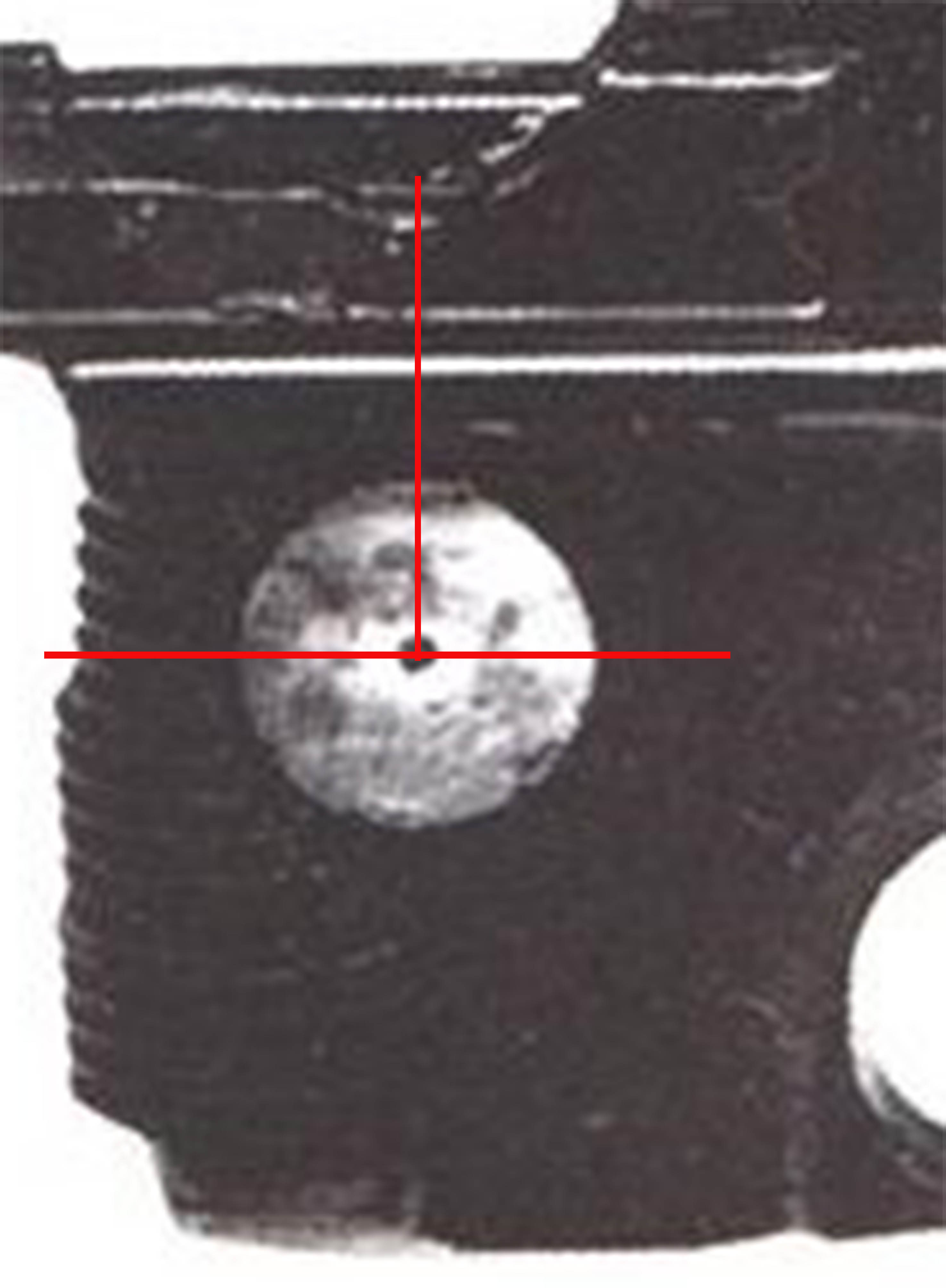

Aison
Thanks for the replies. I have also noticed that on this reference that if you zoom in on the hole, you can see a different reflection of the metal around the hole, it looks like it has
been soldered, so the hole could have been bigger.
blaster all sides.jpg mystery disc location 1.jpg nr mystery disk location possible.jpg
I will read the other thread, it really makes sense this would create the mystery disk if blued or painted while these thumb screws and washers were on. Thanks for the feed back.

I think that the dot in the middle of the "mystery disc" could just as well be only paint.
I think they had glued an "Imperial disc" (pulley from a Michell record player) to the side of the blaster and painted it. Then the disc fell off.
The metal is brighter around the dot - which I think is lack of glue residue.

After reading the greeblies found thread, it makes more sense it is milled, and it makes more sense it is the NR lower reciever that was milled for the spacer washer to seat flat to the body since the area on the mauser is not flat but declines to the front, this would mean that the deeper part milled would be towards the trigger end of the disk. On looking at this photo enlarged, there is a deep cut and lip evident at this half of the circle which fits this idea. The spacer washer would have been a bit smaller than the milled area to I think?
At different times it is also possible that the top part of the gun was changed to another gun and then swapped back for some reason. In the end its just photos and conjectures, I am only trying my best to try and work out something that makes some sense as I am building my DL 44.

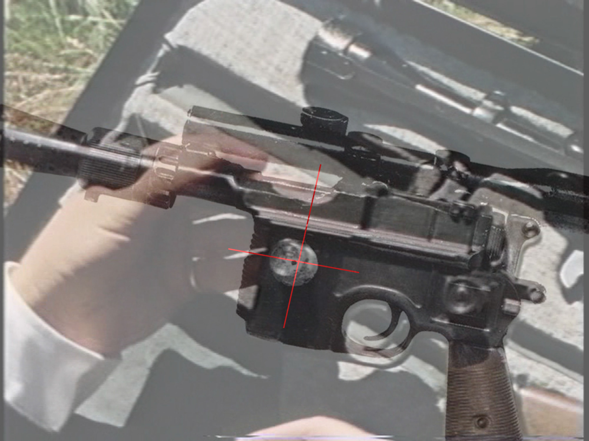

I asked Roygilsing to take a look at the NR photo and the Dl 44 B/W original photo, he was kind enough to make an Giff overlay, thanks Roy, and from down under, as we would say, 'Thanks, you are a legend mate!:) My red line ball park marking was not that far off, it looks like NR gun was used completely, and that the mystery disk is not prop design, but something left over from from the mount machining done on the other side from the NR movie.
@roygilsing Thanks buddy!
DL-44-overlay-naked-runner.gif DL-44-overlay-naked-runner.jpg mystery disk milled.jpg
Click on first image to watch overlay giff. The reflection on the lip also indicates it was machined/milled into the lower receiver.

Nope... not the NR gun at all. Look at the upper receivers... two things:
The forward facing scallops/chamfers in the Bull barrels... different depths/angles.
Also the bull barrel is mounted farther forward on the NR gun.
Now the lower...
The disk vs. mount on the NR placement is different all together. Same AREA, but not the same spot.
The NR lower is a PRE-war variant... the ANH Han is a wartime variant.
Bapty obviously made more than one iteration of this bull barreled pistol.

Thanks scottjua I see now what you mean. That is really easy to see with the giff. Also in the NR photos there seems to be two different scopes used as well. Also on the promo photo using the hensoldt scope, is this the same gun in the vlc snapshot, or a different mauser. Was there more than one NR gun? I noticed on the promo photo there are scratches and wear marks on the scope mount bar, and if you mounted it on the other side it looks like it might match the scratch mark area on the ANH blaster pics. So, was the NR scope + mounts and screws used from the NR gun, and put onto a different mauser for ANH?
What's you opinion on the mystery disc, by design, or that the spot was machined for a previous purpose?

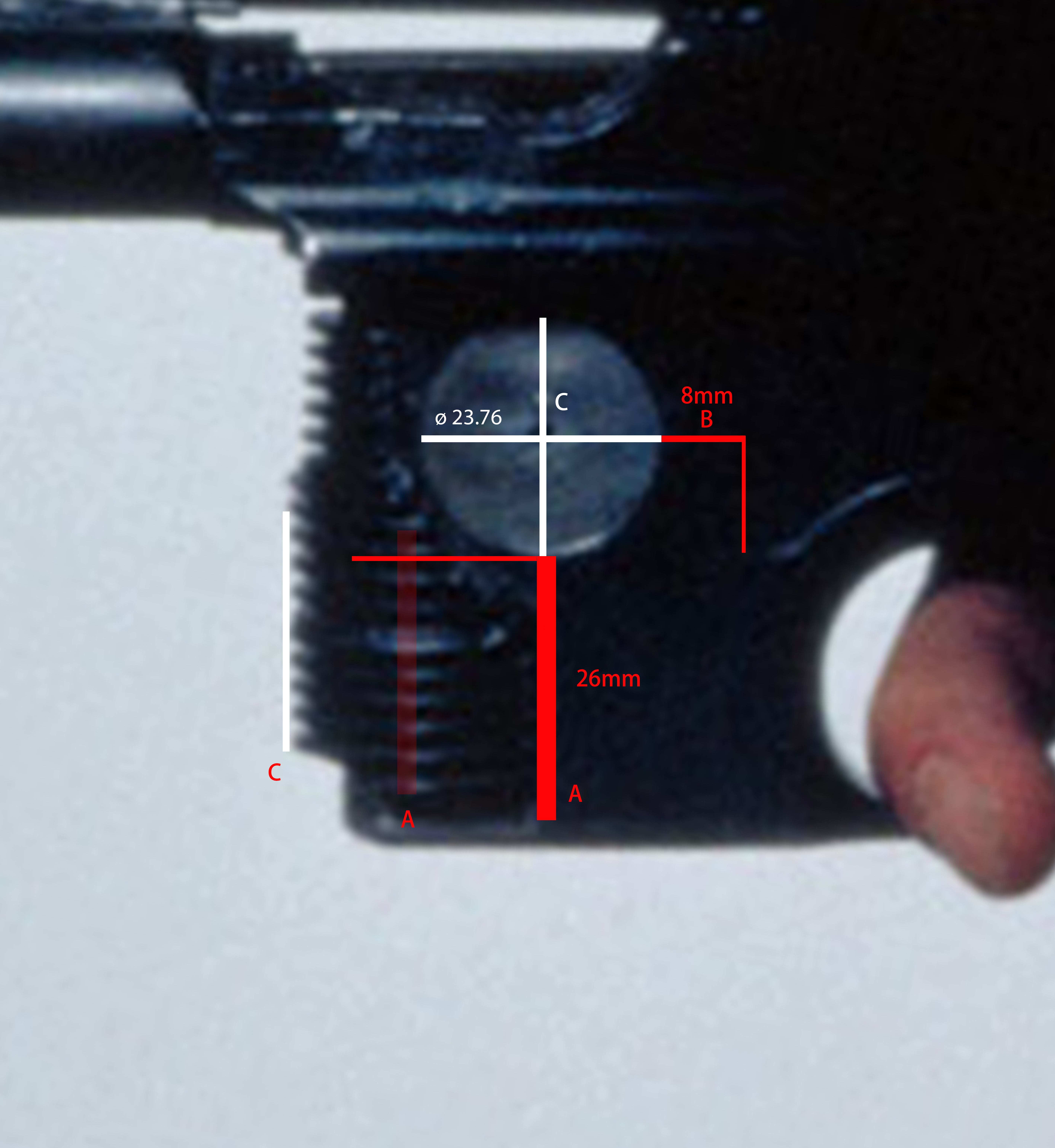

Finally I looked at it and said, ‘It’s a Fu#$@& coin!’ I then looked up American coins and the size of their diameters, Quarter looks good at a diameter of ø 24.26mm, next I thought is there such a thing as a blank quarter, answer ‘Yes.’ Minting errors.

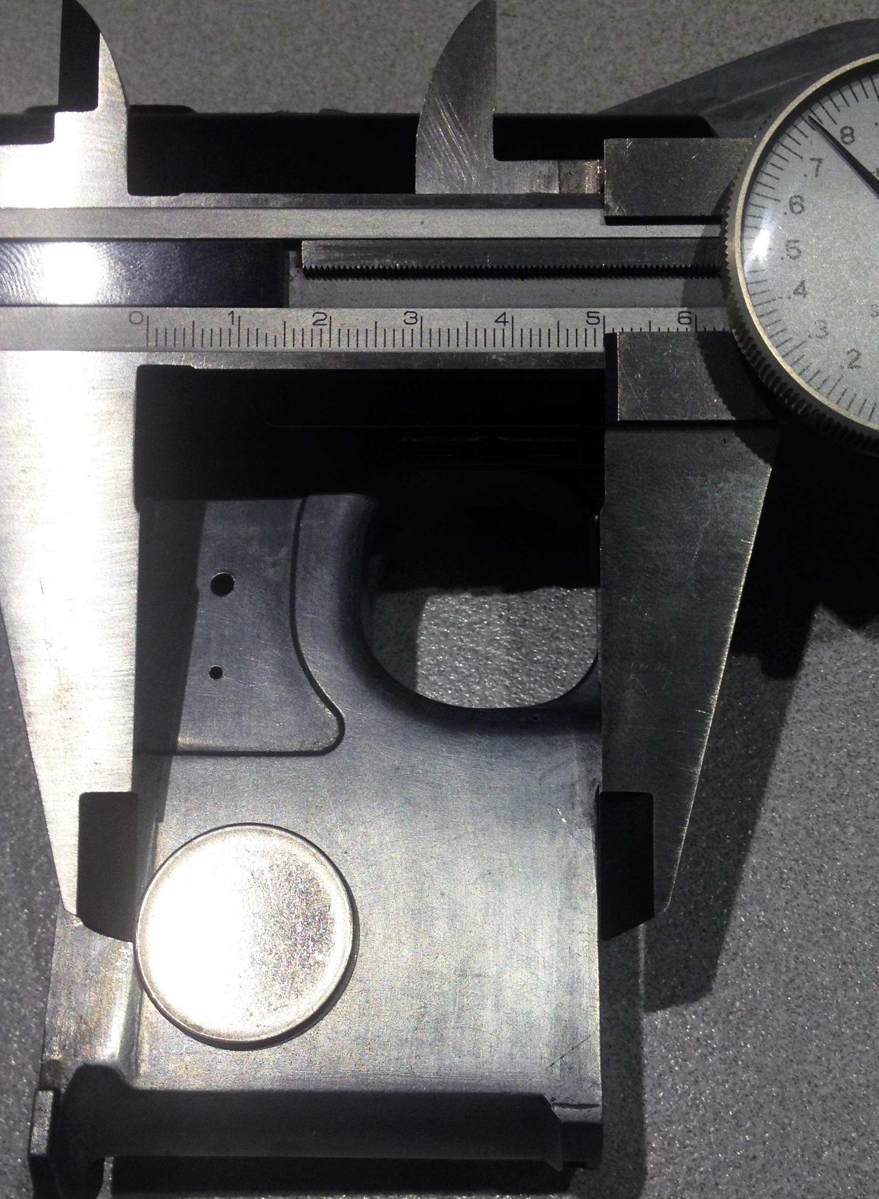

Next I did a scaling in photoshop, I have the Reade models Tomtit dummy engine cylinders that were cut into three sections of six fins. By this I knew I could scale the diameter and then measure the parts. I also own a MR Luke ESB blaster that I have stripped for a re-build, I noticed that it was smaller than a denix, and somewhat more accurate to a real C96 Mauser, and the measurement from the bottom of the disc down to the bottom of the lower receiver minus the magazine plate which also vindicates the scaling.
I sourced some quarter blanks circa 1965, (Nickel coating on the edge is not complete and copper also can be seen which can be seen on 1965 quarters.) had to buy them in bulk as a lot, so a big gamble. They arrived and I measured them, they = ø 23.76mm – 23.84mm. I was wondering why they were smaller, then realized that when they are stamped they would get a little bigger.
The Scale shows the disc’s diameter just stops under or slightly into the 10th fin. The Vernier reads 23.76mm
49.76mm, trom the top of the disc on the eyebrow line to the bottom of lower receiver minus magazine plate on my MR 2003 ESB Luke.

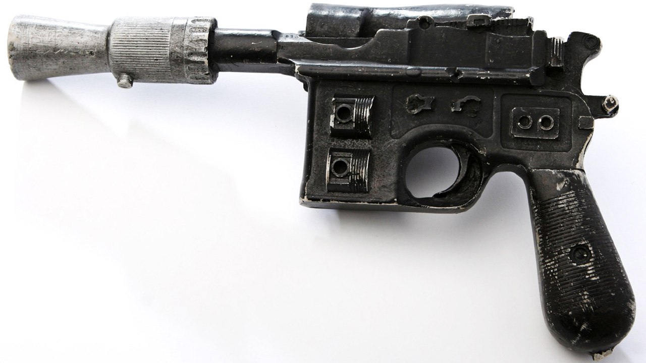

Now I know there is another photo of the beauty prop blaster, that was molded from the original DL 44 which has a circular groove that looks like it is cut out of the eyebrow line and why people think it is also milled out. This blaster makes an appearance in the dagobah scene where Luke crash lands I think. This blaster inspired ROTJ Han. Again pistons are glued on along with other greeblies. It makes sense that Han's original DL 44 after ANH had the grill removed, this coin popped off, glue residue left behind, then it was used to make a resin mold. Han hardly uses a blaster in ESB and we know his and Luke's was shared too.
Here is another shot of the coin and how it would sit, there is a gap where glue would fill, and create the edge that also makes it look like the disc was milled.

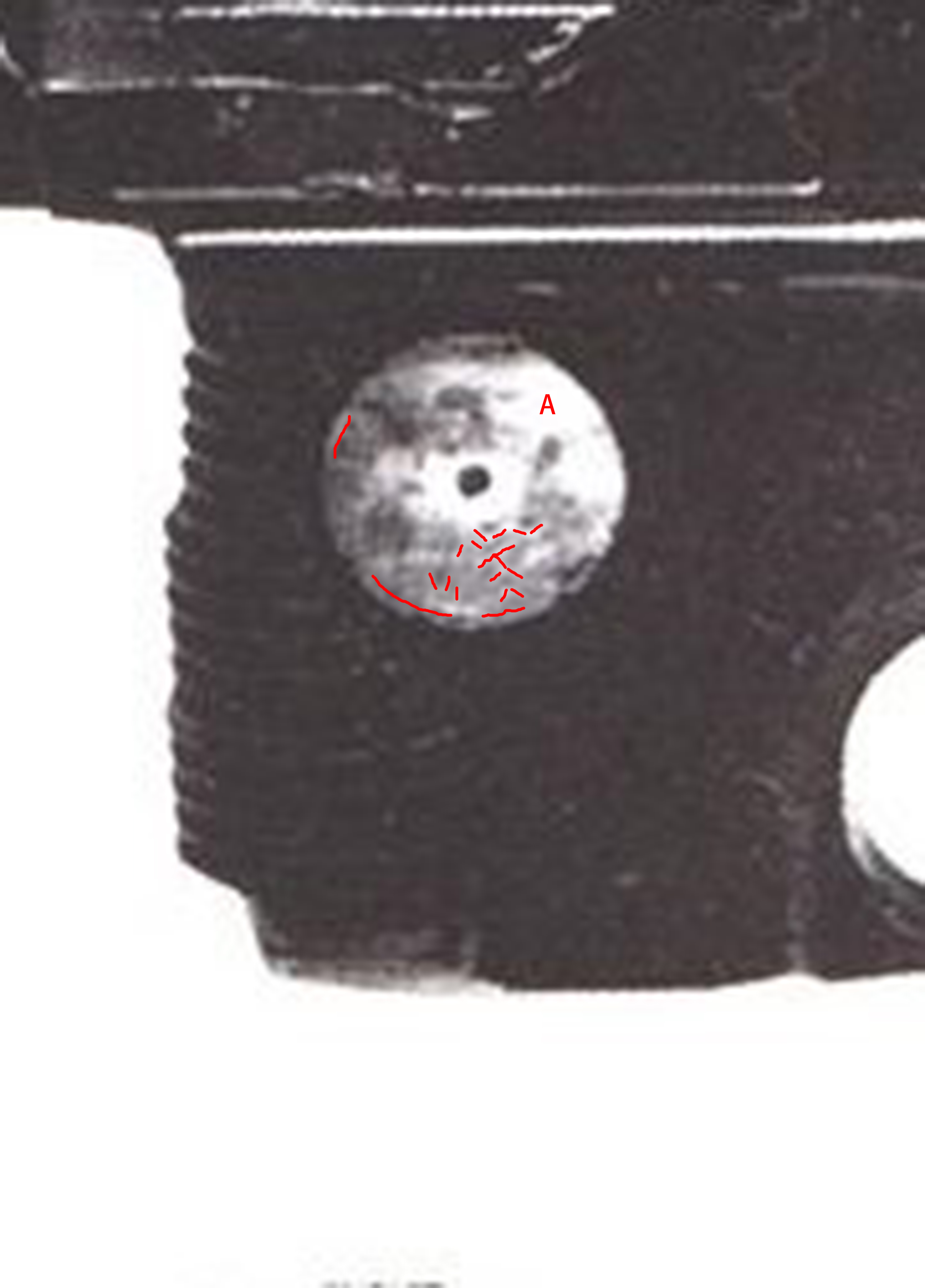

Oh how it shines, notice no black dot, also no black dot in the center of one of the promo shots as well. Also it is clear that there is a darker black ring/shadow around the disc which suggests it is raised and we are seeing edge and drop shadow. (Second photo, contrast is adjusted a touch.)
View attachment mystery disc black white scratches.jpg View attachment mystery disc black white2.jpg
Click on the pictures, download them then look at them using the zoom in picture viewer. I have high lighted on one pic a the little hatching scratch marks. These little scratches, are also an evident pattern on the Nickel quarters I have, if you go back to the vernier pic with one of them you can see them in that pic. (A) the very white areas are how a black and white photo is recording the reflecting nickel.
Well that's the sum of my work, look forward to replies. I have 30 circa 1965 blank quarters, I have 20 more in reserve. If people are interested please post if interested. If there are enough people I will upgrade my rpf membership to sell them. At this stage I am looking at selling them for a ballpark price 25-35 US depending on shipping, I also may grade them to quality and price.
