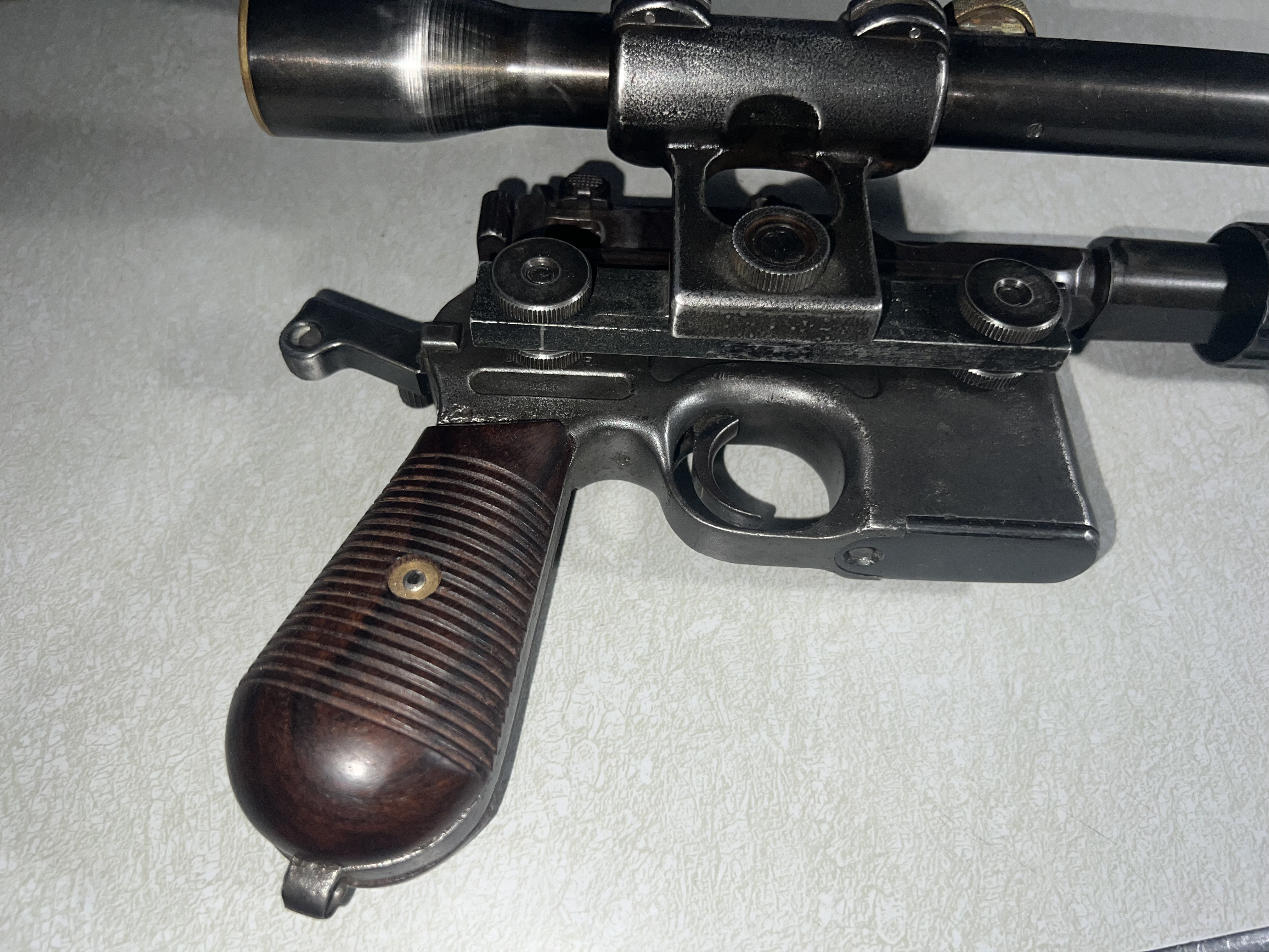

Most people use ANH reference images to mount the threaded rod. In my view the mount sits half way between the rear cut outs and flush to the edge of the Mauser. See reference photo below.

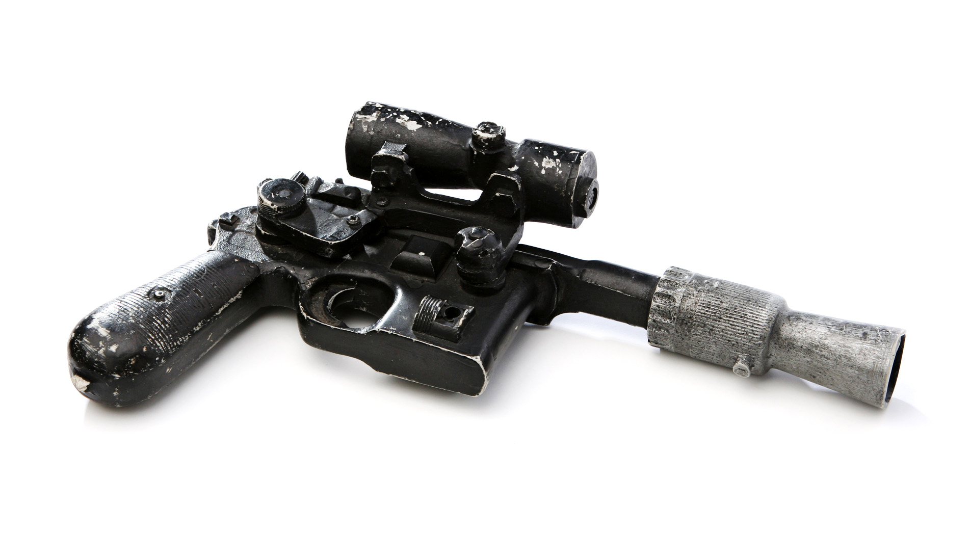

I got something for you, give me a bit to dig it out, but I did this staring at pictures myself and I think we have 2 or 3 ways to cross reference.
We can safely assume the welded mounts were included in the mold made of the hero gun proper. This may help placement of those.
As for the bar, and its holes, these may be of help.
AS FAR AS I KNOW THESE ARE ALL PUBLIC PHOTOS, I'LL TAKE ANYTHING DOWN IF REQUESTED
Sigh, anyway, as always in this hobby there is some decent guesswork and eye-balling - personally I have gotten more accurate results by comparing distances to known parts in a photo that are on the same plane than by trying to measure

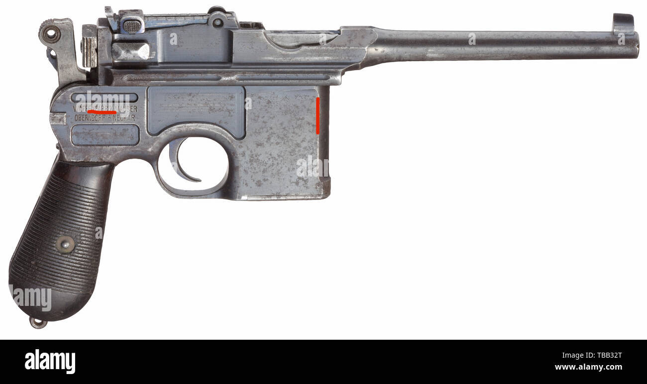

I found this incomplete parts Mauser off of GB for cheap because it suffered heavy rust pitting around the grip and grip frame. Probably not safe to fire, which was fine for me since I wasn't going the live fire route. (The wood grip and hammer are also incorrect, but I'm working bit by bit to get it right.)
However, as you can see it isn't the same variant, since the lower "cut out" isn't as squared off as the prop weapons. Not a Mauser expert, but I assume that means it's a commercial variant or later vintage or something.
But I clearly placed my holes too low when I drilled them. When the scope mount is on, the bottom of the cross bar is right at the top of the trigger well. You can grip it ok, but if you "cinch" up to where the grip is really comfortable, the cross bar cuts in to your index/trigger finger a little bit. Worse the scope LOOKS about 1/8 - 1/4 inch low and possibly a wee bit forward. Although the front of the bar actually does line up flush with the front of the gun. In the pic it doesn't look that way, but it is.
All that to say measure like 15 times and drill once. Don't do what I did...Now I have to figure out how to fix it...
