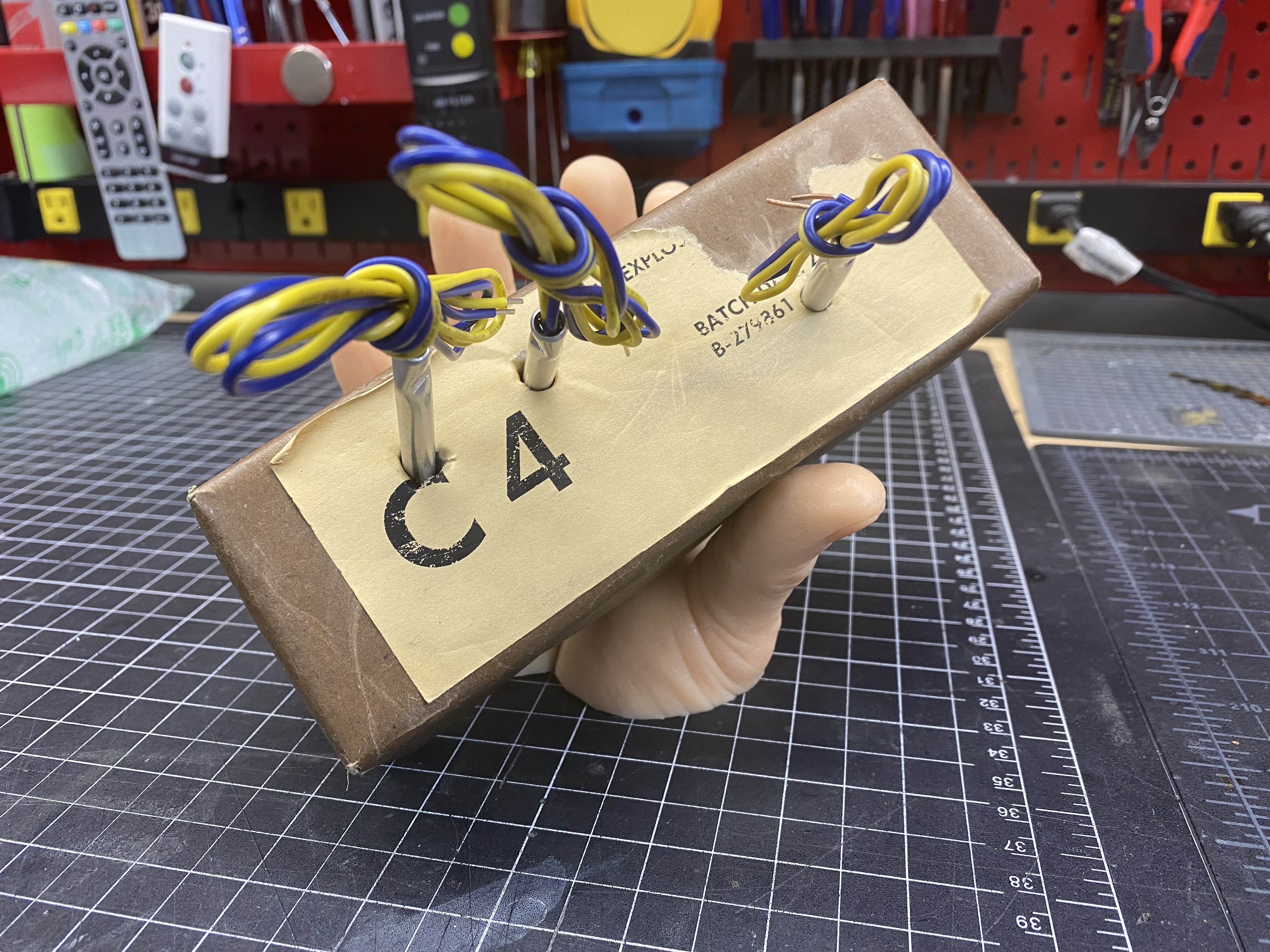

C4 Block
I tried out a few different materials for the block. My "Hero" version with the detonators stuck in it is made from a big 'ol block of Plastilina Modeling Clay to give it an appropriate weight and feel. For the other blocks I did one version using floral foam, but it was difficult to wrap tightly and had almost zero weight. For the others I used floral foam wrapped with about a 1/4" of Plastilina to wrap more easily and give it a better feel.
Finding the right paper for the wrap was a harder than I expected. Plain brown butcher paper didn't look right, but I found some wet wax that looked great. Unfortunately it was only available in a 900' roll, so I can pretty confidently say that I will never run short of brown wet wax paper in my lifetime.
For the label, I reconstructed the design from screen shots and Prop Store Photos. I used Barge contact cement to attach the label to the wax paper and to seal the end folds.

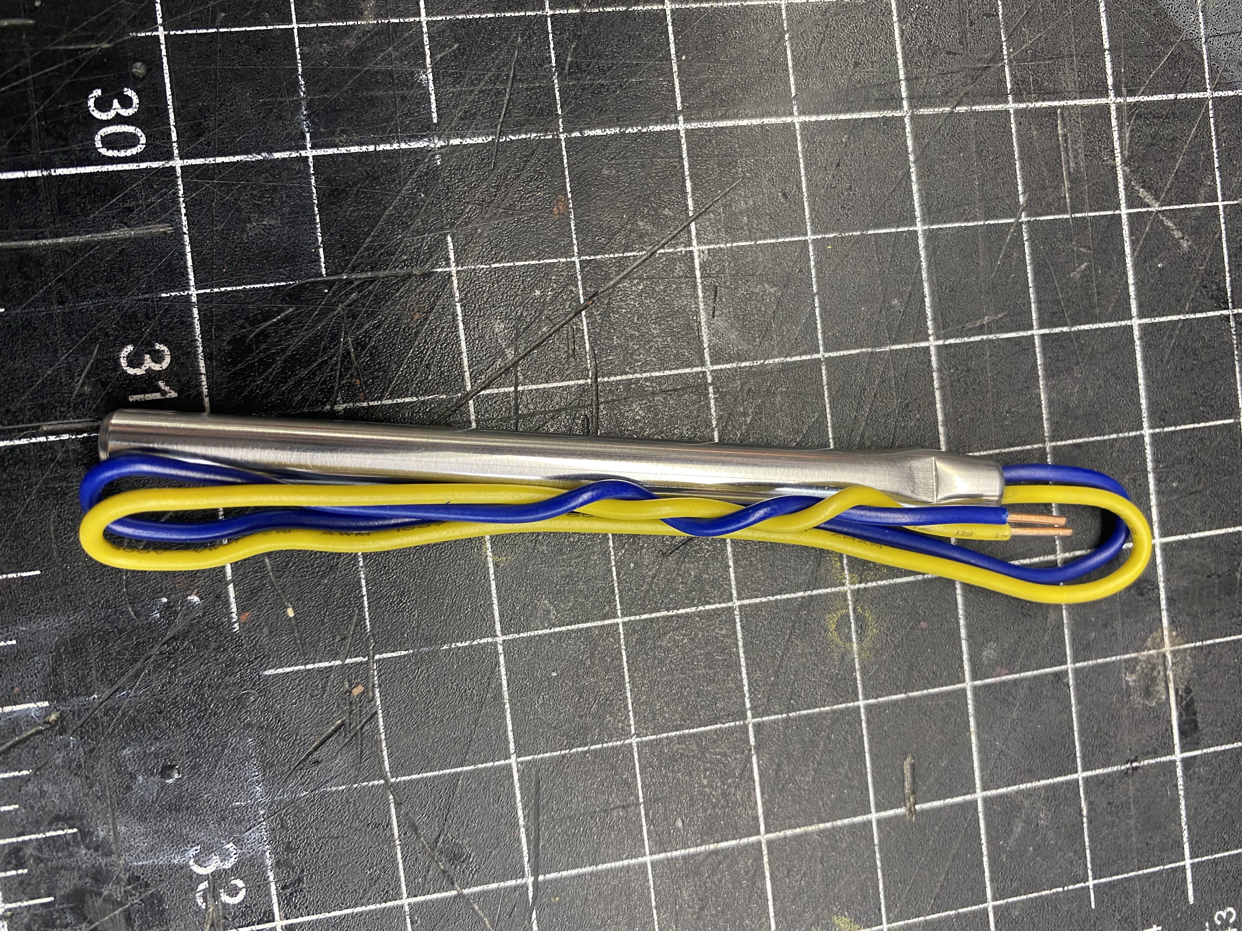

Detonators
I created two versions: the Hero versions are aluminum rod that I drilled on my mini lathe so that it would be solid like a real detonator. The other version is made from aluminum tube which have an open end. I did some tapering and clean up work on the lathe for both versions. The wire is solid core 18AWG wire that is heat-shrunk together, then crimped in place and sealed with UV resin at the top. Getting a quality crimp took a fair bit of trial and error, but ended up rigging up a workable solution using my bench vise and some 1/8" metal scraps.
Detonator Cases
I was originally thinking I would use acrylic tube, but the walls were too thick for the detonators to fit properly and didn't have the right "disposable" vibe. I ended up using PTFE tubes which have a super-thin wall and exactly what I was looking for, but they were harder to source (again, had to buy more than I needed). You would think that finding orange end caps would be quite easy, but boy it was not. After a number of issues with being sent incorrect sizes and colors and an attempt to paint the caps without the paint flaking off, I finally got a pack of orange caps, but they were far too light and "neon" in color. Still, they were close enough that it gave me an opportunity to try something that I had seen used in other applications and I decided to try dying the caps darker- and it actually worked really well! I put the caps in a heated bath with RIT red Synthetic dye and was able to get the exact color I wanted. It took a couple of batches to dial in the timing (they continued to darken after removing them from the bath), but after that it was easy.
