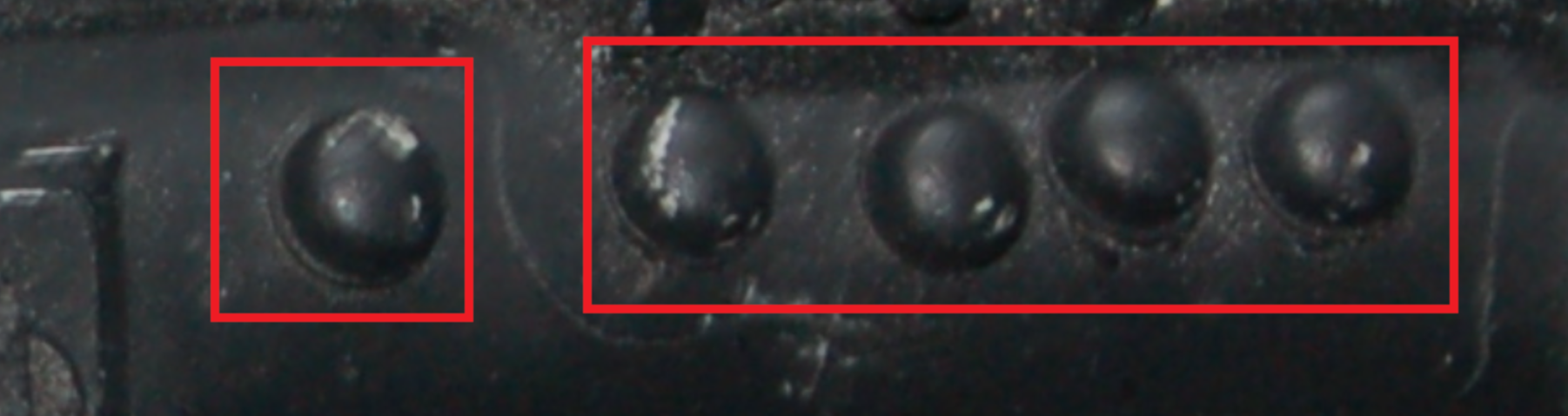

First greeblies are the 5 round parts, they look a bit like regular metal bolts.

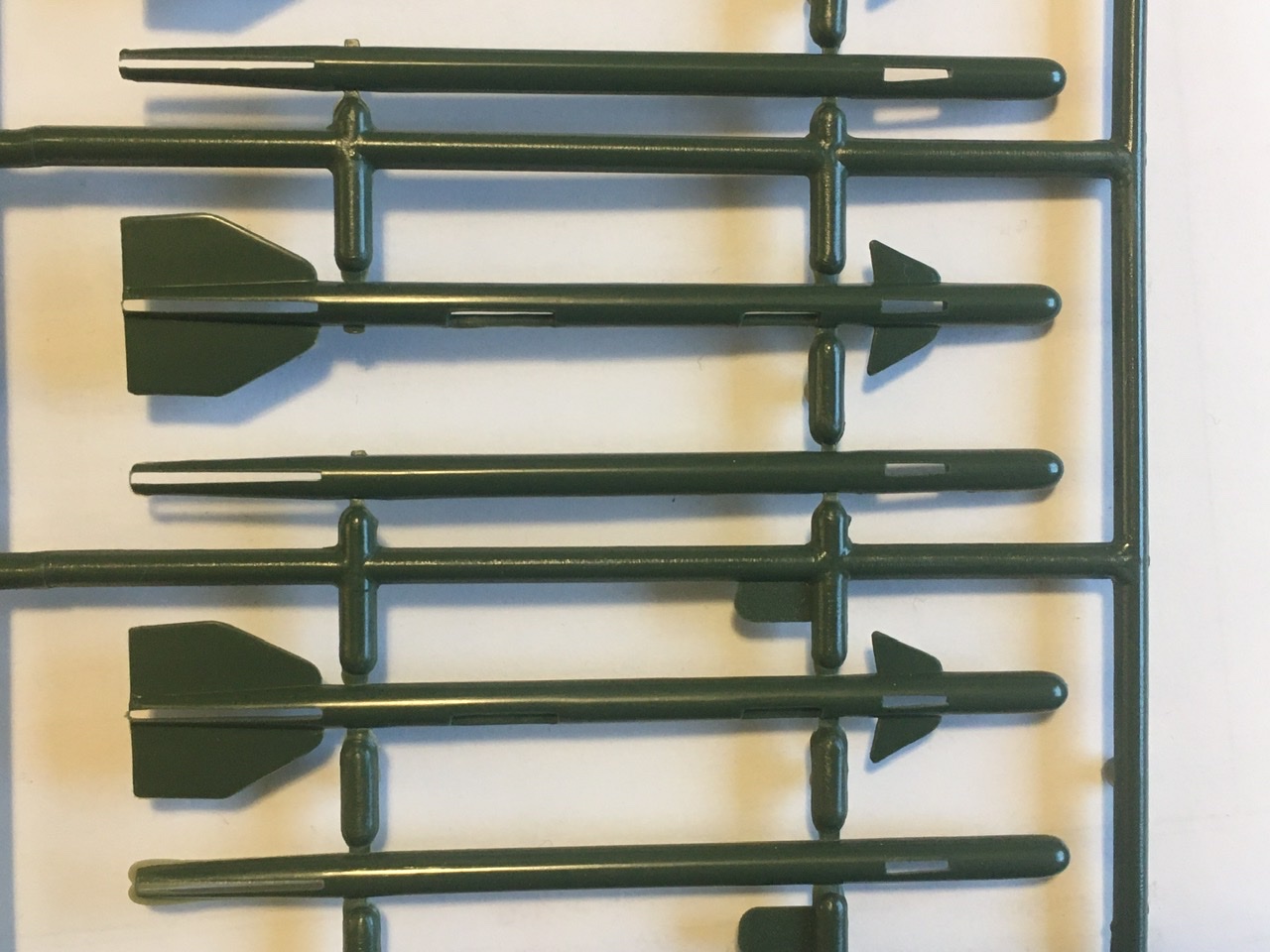

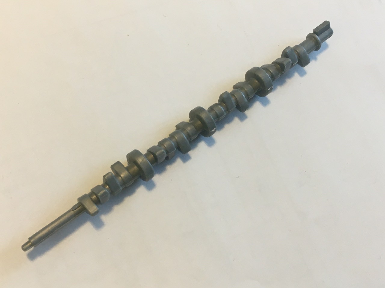

The second pic looks like a model engine crank shaft, and the fifth looks like a model airplane missile. Used to build a bunch of those by hand back in my balsa mode days.
Yes on both counts! There’s a cut down camshaft from the Revell 1/4 scale Visible V-8 model:
… and one of the parts that make up the sidewinder missile from the Revell 1/32 scale F-4E Phantom II model:
That's Brilliant!, Thank You, I've seen that they still make the Visible V-8 Model, are the model parts the same or have they been altered over the years?
There are also Phantom F4E parts on the trigger assembly, on both sides.
The square buttons were most likely self-adhesive rubber feet, but finding the exact right types might be hard. The ones on the magwell are definitely larger than on the rear sight.
The round buttons might also have been rubber feet, but I don't know.

Yes to everything! I dont remember the round dots but those square bumpers were POPULAR back then. I've found them on the back of a lot of calculators.
Not to be confused with the trapezoidal or straight sided bumpers on the DL44 blasters
The square included with Field Marshal's Luke Dagobah DL-44 appears to be the right size and shape I think.
Looking at rubber bumpers online there are small round ones that look very similar to the round things on the Blaster.
Yep... they have the flat ridge around them. They're bumpers!

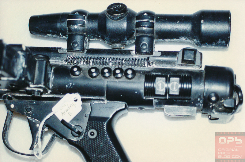

Now, these are the only photos I have, it's of the metal "slapped together" hero with rivets and patches all over it. Different scope rail, different scope rings, etc. So this is not helpful..... I need pictures of this thread's blaster.
See what I mean by the different bumpers and different dots. It was made for Jedi. Jedi bumpers and Jedi pistons.
The dots on that one look an awful lot like the pins from a guitar bridge...
