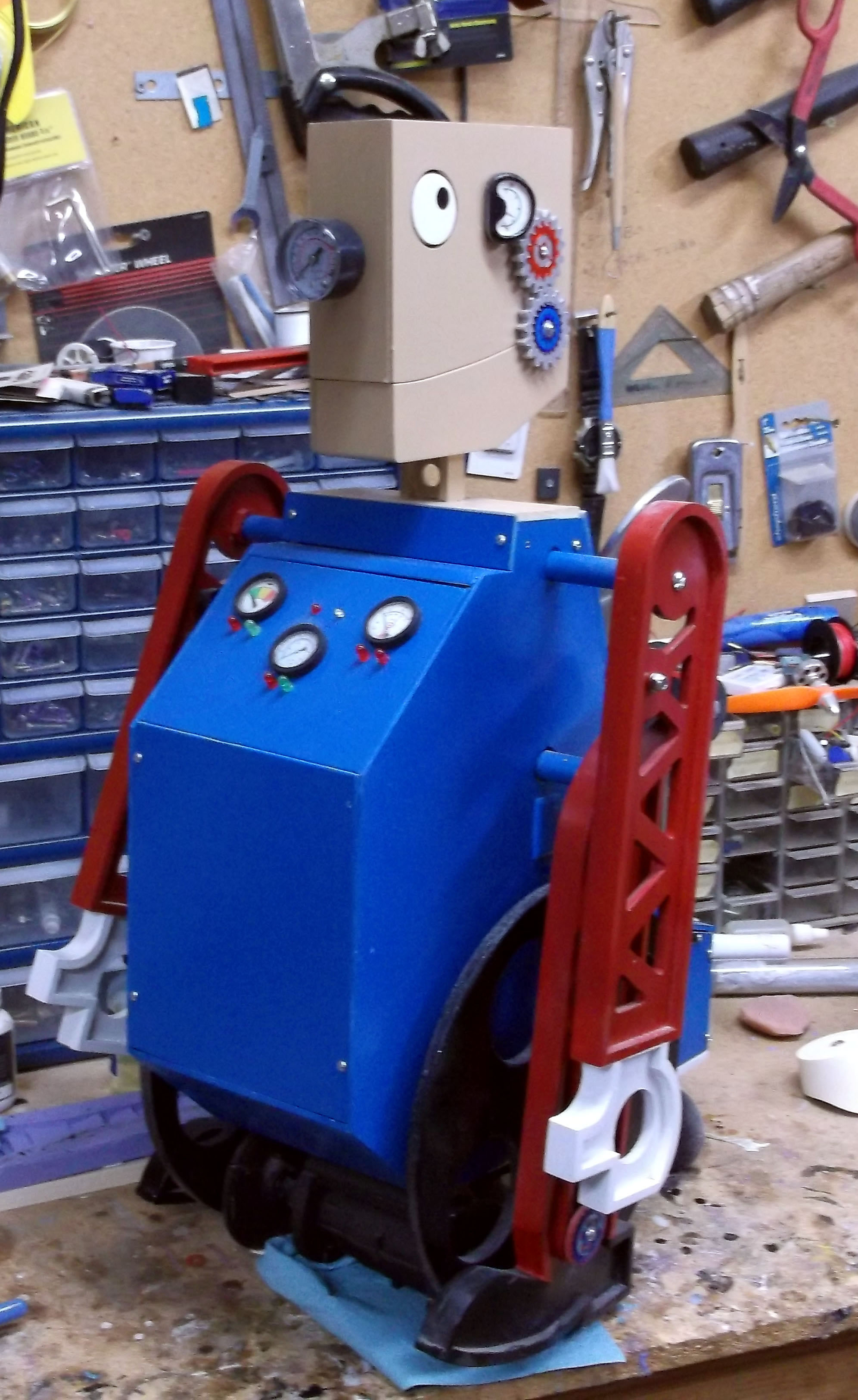

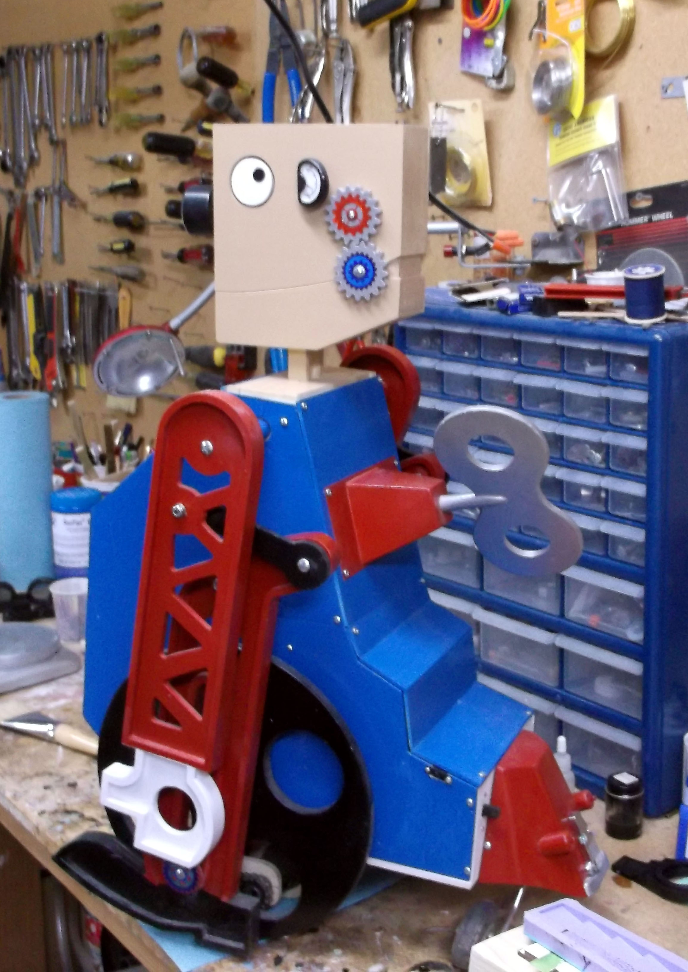

This is one of my older projects- a 2x of Mr. Machine that is radio controlled- his eyes roll, his mouth opens and closes, he has a speaker system with a sound card that tells fortunes, the lights on his chest flash randomly and his tail lights flash. He is not absolutely authentic to the original plastic toy. He is made of marine grade plywood. He has two indepenently controlled gear motors that turn his wheels. Mr. Machine 3_4 cropped.jpgr. Machine rear cropped.jpg

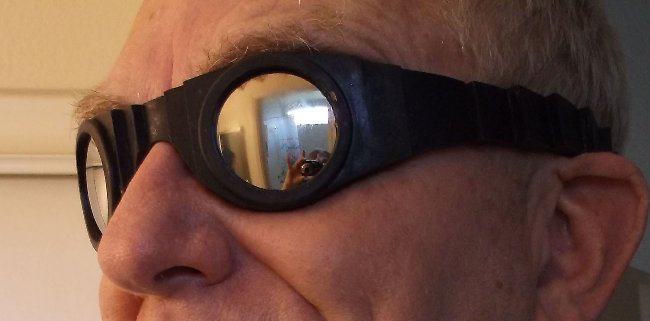

The goggles with the mirrored lenses are my version of Chronicles of Riddic Goggles. I made the pattern and the mold and cast them out of synthetic rubber and cut the lenses from sunglasses. The goggles I am wearing in my stylized Avitar are my version of the Pirch Black goggles.
Looks great there mate! Nice clean work . Love the riddick glasses.
