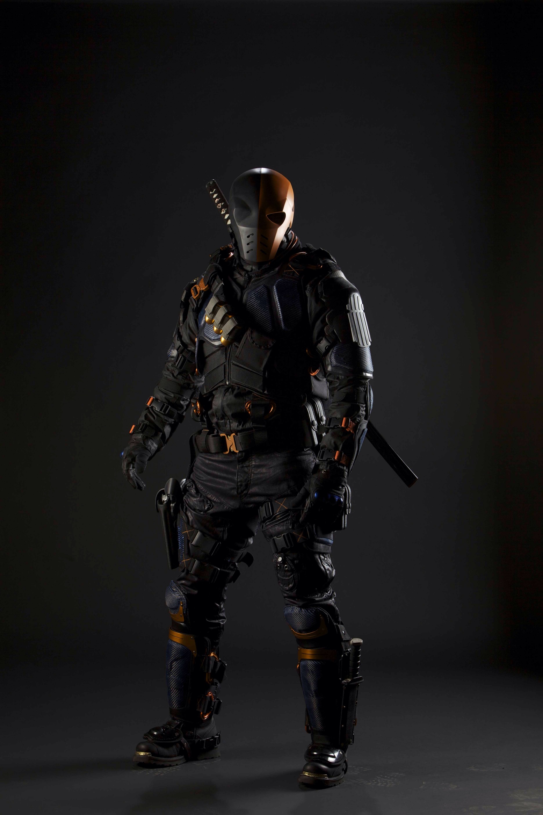

Rolling right along... started doing the detailing work that I wasn't able to get to last time.
This isn't perfect, but it's reasonably close. After this pic I did add the 4 rivets in the corners.
I went with a Husky knee pad as the donor part for the knees:
And I'm putting the finishing touches on the mask
I'll take some pics of the molds later tonight and try to step through it. The super short summary is:
Make shin forms out of 4" pvc pipe, glue, bondo
Vacuum form shins in black abs
Apply carbon fiber to center detail
Layer black vinyl over that with cut out for carbon fiber
Hand sew vinyl to plastic around the carbon fiber and outer perimeter
Rivet on straps
Harvest plates from Husky brand knee pads for the knees
Cover knee plate in blue carbon fiber
Cut out black vinyl for inside of knee
Hand sew around perimeter, through the carbon fiber, plastic and vinyl
Rivet on knee pad
Rivet on orange details to upper shin and knee
Repeat for other leg
Cry myself to sleep.
