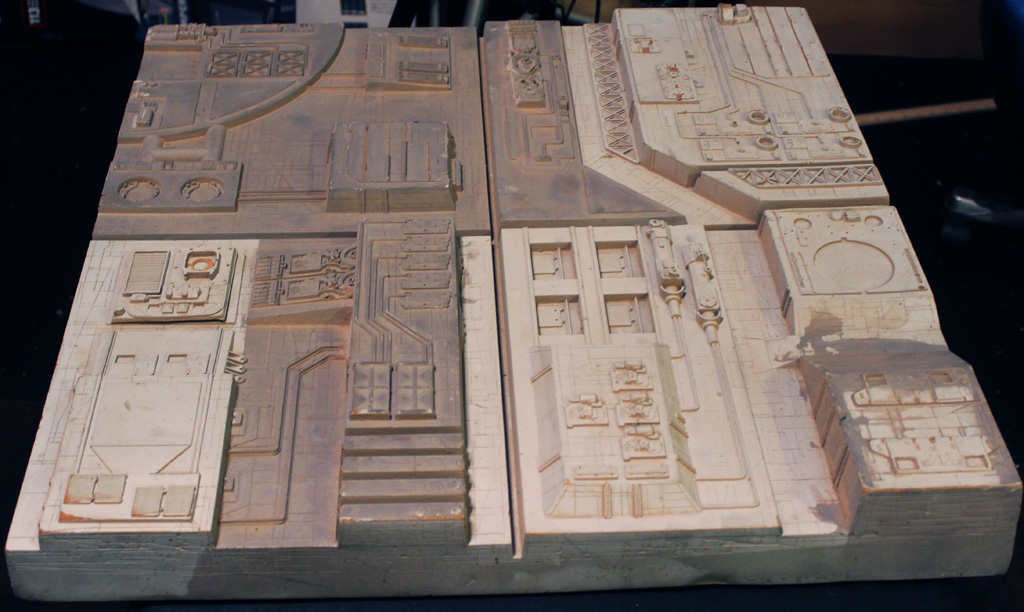

Hi, I've been asked by a friend of mine to find out some information about a piece of the Death Star Tile his has.
It belongs to the estate of a friend of his who passed away. It's authentic because it was given to his friend by the former head of the Lucas film fan club.
Seems sometimes in the 1990's the head of the fan club was told to "get rid" of some of the excess stuff they had around.
The piece is 24"x24" and I think was used in the filming of the close up for the attack runs.
What I'm trying to figure out is how the pieces were made.
This parts seems to be a foam cast with model bits glued to the surface.
Does anyone here know how they made the original tiles??
I was wondering if the made smaller tile pieces and then put four together to make a bigger piece and cast that.
Rotated the parts, mixed and matched and then cast another large 4 panel tile.
If anyone has any information I would appreciate it.

My two cents: from what I saw at Rancho Obi-Wan, your piece does look original. Biscuit foam construction with greeblies added on top, and a flaking/peeling multi-gray paint job is pretty much what all his pieces looked like. I'm conscious that model builders can replicate this look pretty well and/or easily, but to my eye you've got the real deal. They did make different scales of Death Star tiles, I believe three of them, for distant, medium, and close-up shots, and yours looks like the close-up version. And they did make them as individual tiles, cast them up, and then arrange them in different layouts to produce the randomized non-repeatable pattern of the DS surface.

Basically ALL the tiles were cast in a quick/fast setting self skinning expanding 2 part foam. They had to make hundreds of them.
The back will look something like this:
The detailing is from kit parts, but these were in the mold too, not added after.
Here's an example of the same tile, from the same mold, just painted differently (and with an added turret)
They were also made in different scale, for different shots.
This is the largest and used for very close shots like this:
It's a very valuable piece today!

Hi, Thanks for the info. From what I understand the gentleman acquired it in the late 80's or early 90's. The head of the fan club then was a woman.
I don't know her name but they are in touch with her to get a letter of authenticity.
Lee Thanks for posting the images. I almost recognize the two parts that are the back of a tank engine in the lower right hand corner.
The back of it is flat but looks like it was cast on plywood. There is a slight plywoody pattern to it.
Yeah that sounds weird to me also but that's the only way I can describe it.
I'm curious now as to what type of two part foam it was. The hard ware store stuff I know expands too much.
if I stand on my head and squint really hard I can almost figure out which piece it was.

That's a beautiful piece! and yes the texture on the underside comes from the flat wood surface that was clamped down onto the mould to contain the expanding foam.
