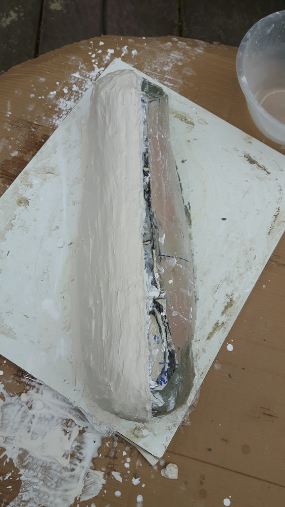

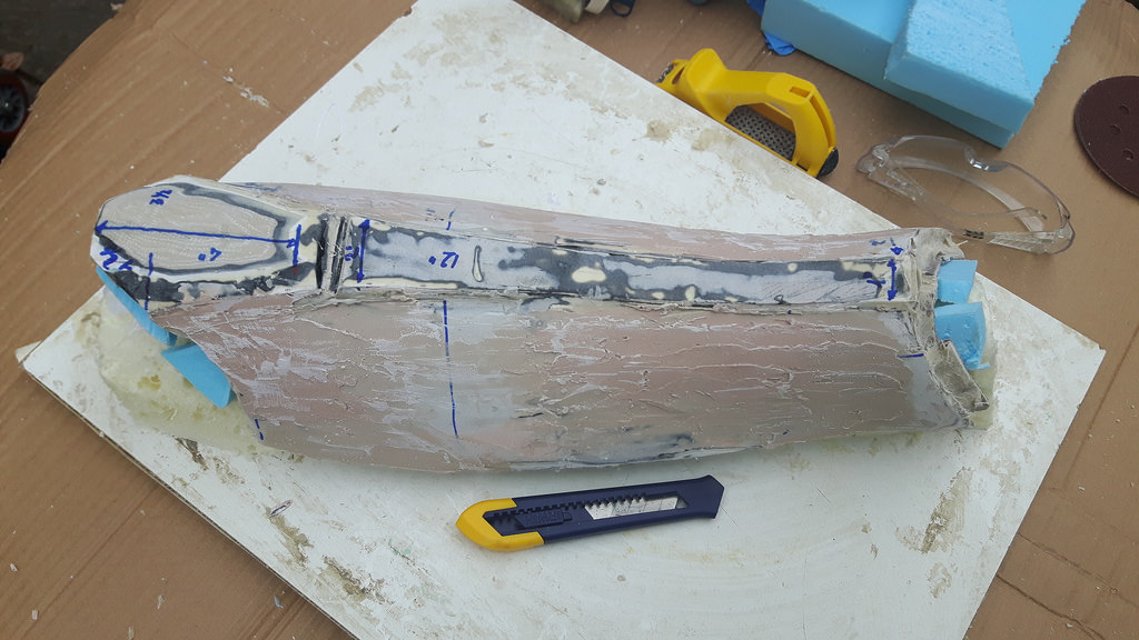

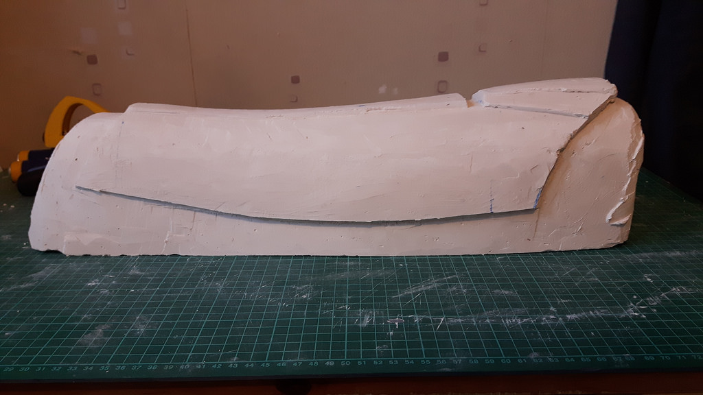

By the way I moved some steps forward on my project, I made a quick mold with plaster bandages and once well waxed I poured Plaster in the mold to have a positive copy of my initial efforts.
The resins and all that car filler was just too messy and too stinky to allow me to work at closed doors.
Here some pics of the latest progresses:
Here I filled the shin with some foam
filled the gaps with clay
half mold
the overlapping side
and ready for the plaster
quite thick as I needed to carve a bit in my original shape
there you go a good start for a proper sculpting

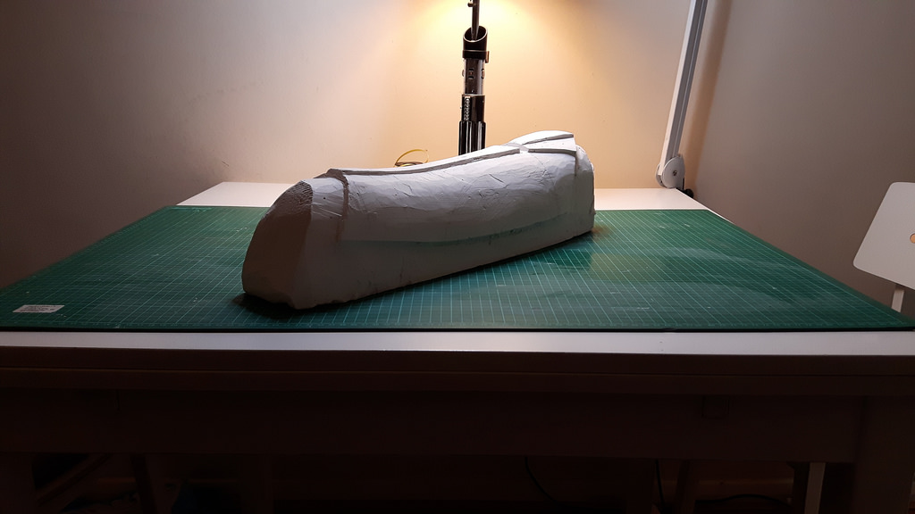

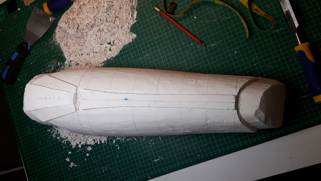

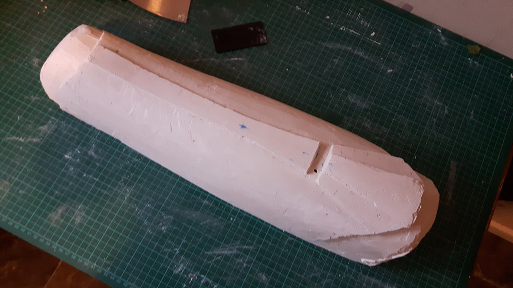

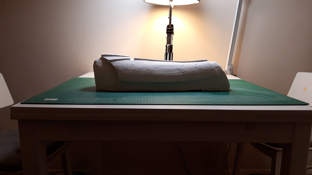

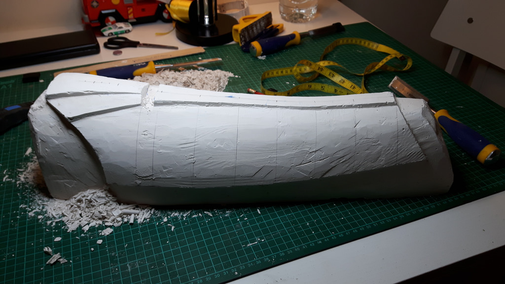

Here after a couple of days sanding and filling and adding volume and reshaping.
As I said the initial plan was to sculpt only one symmetrical shin and then cast it.
Then I moved on a more accurate version based on the original seen on the prop store a while ago.
I like the asymmetrical shape on each of them but since my shins are pretty much the same lenght I won't sculpt the right one 1inch longer otherwise they won't look right once on me.
Here after Friday night effort
Sent from my SM-G903F using Tapatalk
Sunday again... :)
Still lot to come but I am feeling very confident now that I am on the right path.
Thanks to the couple of guys that sent me very good reference pictures of the originals and some tips about sculpting the master
