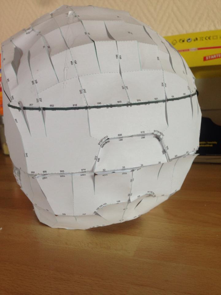

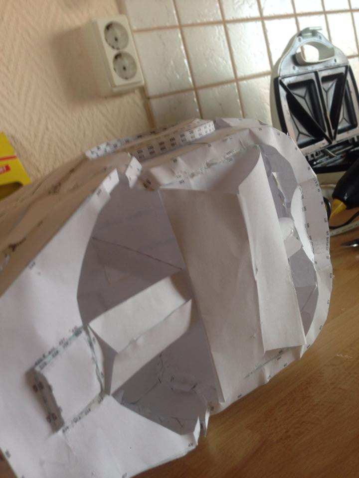

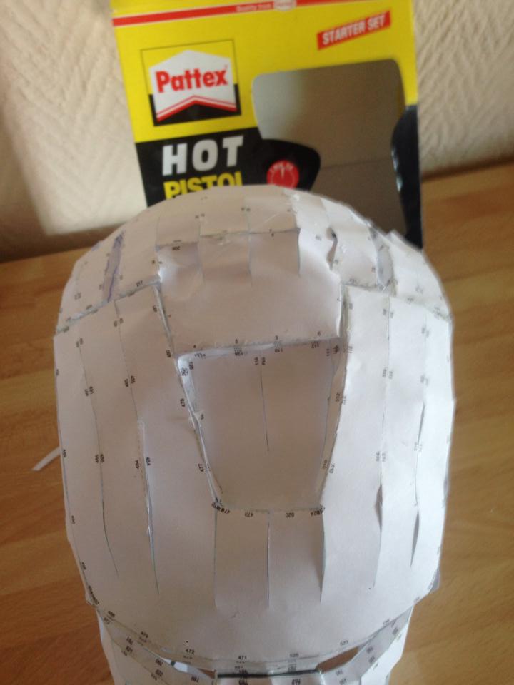

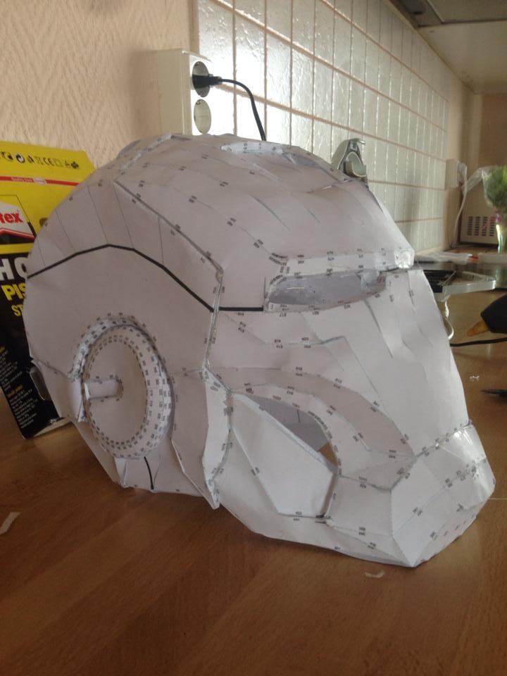

Glued it all up ready for fiber glass here are a few pictures before fiber glassing. I think with alot of sanding this helmet might not be for trash! :D
View attachment 343195View attachment 343196View attachment 343198View attachment 343199View attachment 343200View attachment 343201

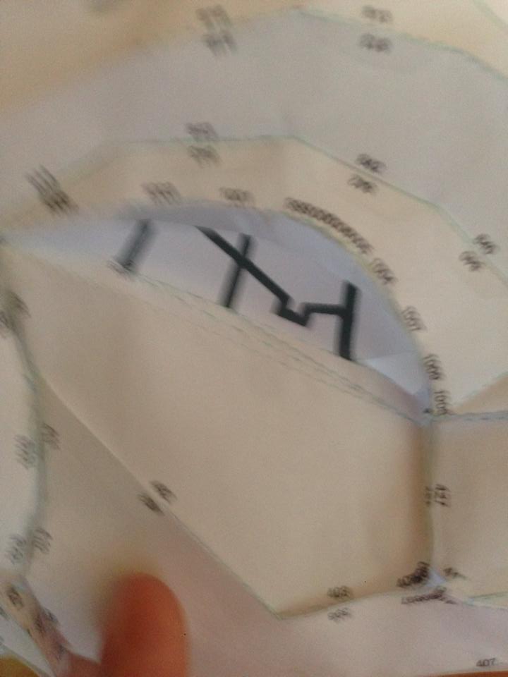

I'd love to hear your comments! Also can someone tell me what I need to do with the black lines? The ones near the cheeks,the ones that people call teeth. (2nd pic.)
Hey bud!
Great attempt! Based on what I'm seeing here, I'm going to suggest that you either tighten up what you've got here or maybe consider a re-pep. You have a lot of cracks, and dents that are going to really translate into a lot of work on the back end when you start 'glassing and sanding. Again, just my two cents, but I'd at least try to close up those cracks and pop out the dents from the inside.
That's the bad news. The good news as I always say is that the second time around goes much quicker and that applies to the pepping discipline as well.
Also, don't worry about the "black lines". Those will go away once you start applying bondo over them and eventually primer and paint.
Wow thank you darkside501st!!! :) I feel dumb lol
It is not your fault. That is just one part of the program that does not function intuitively like every other program that is out there. It is something I brought to their attention and they have yet to fix it.

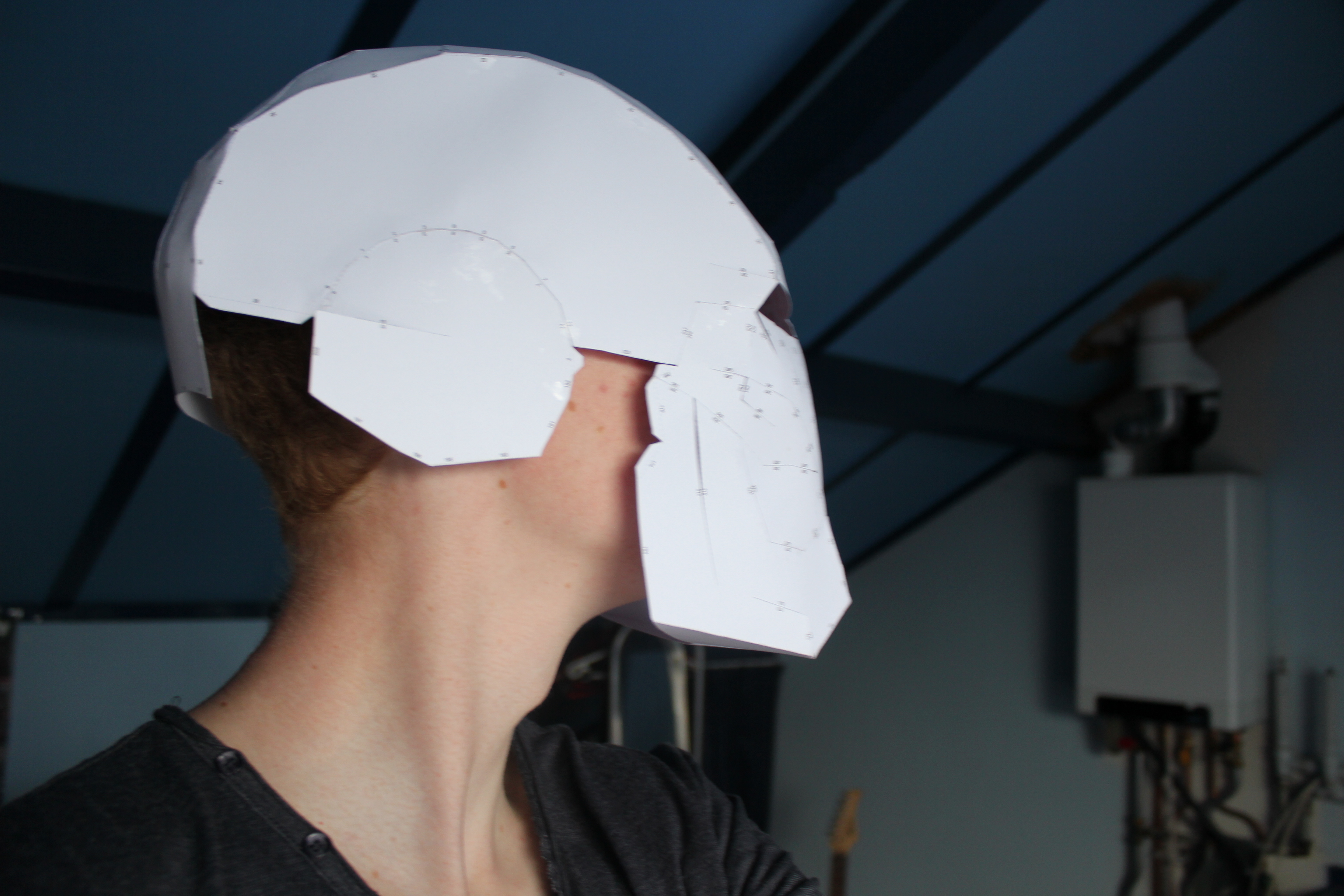

I'm building the tester mk 7 helmet now, I believe that the fit is supposed to be so tight you can't put it on in one piece, is that right. I've cut and glued everything except the pieces below the ears and the back bottom part. If I glue those on, will I still be able to put it on? Or should I try the fit another way with this tester? I hope you understand my problem.

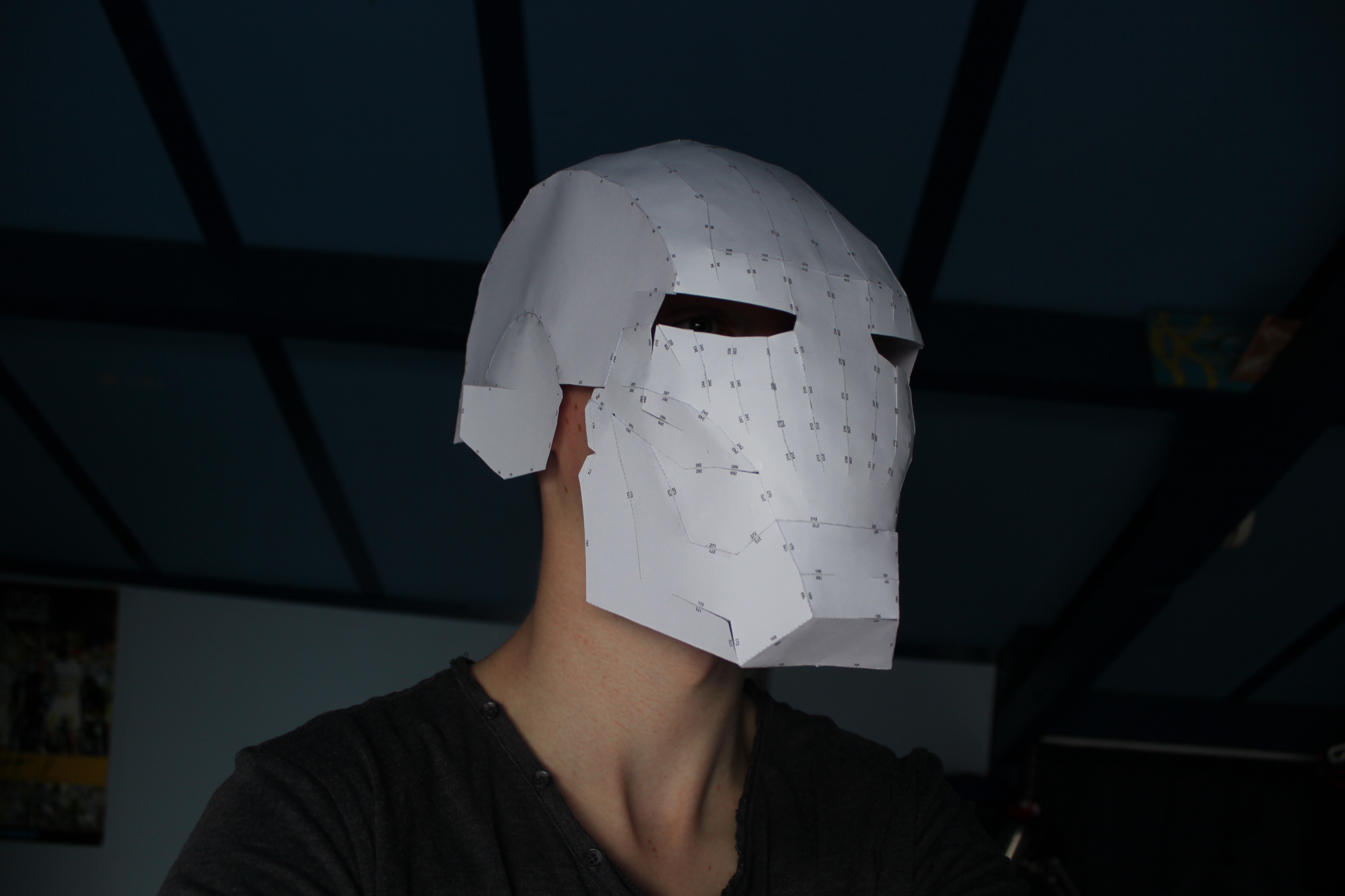

-Edit: IMG_6314.JPGIMG_6317.JPGIMG_6313.JPGHere is what I have right now. The sides are gently touching my ears. Looking at the pictures I'd say the fit is about good, I'm only wondering if the helmet will hug my cheeks with the faceplate open like in the movies. The distance from the bridge of my nose to the helmet between the eyes is about 4 cm. Is that about what it is supposed to be, and will there be enough room for electronics for the faceplate? It probably needs some padding at the top to create some space for that.
