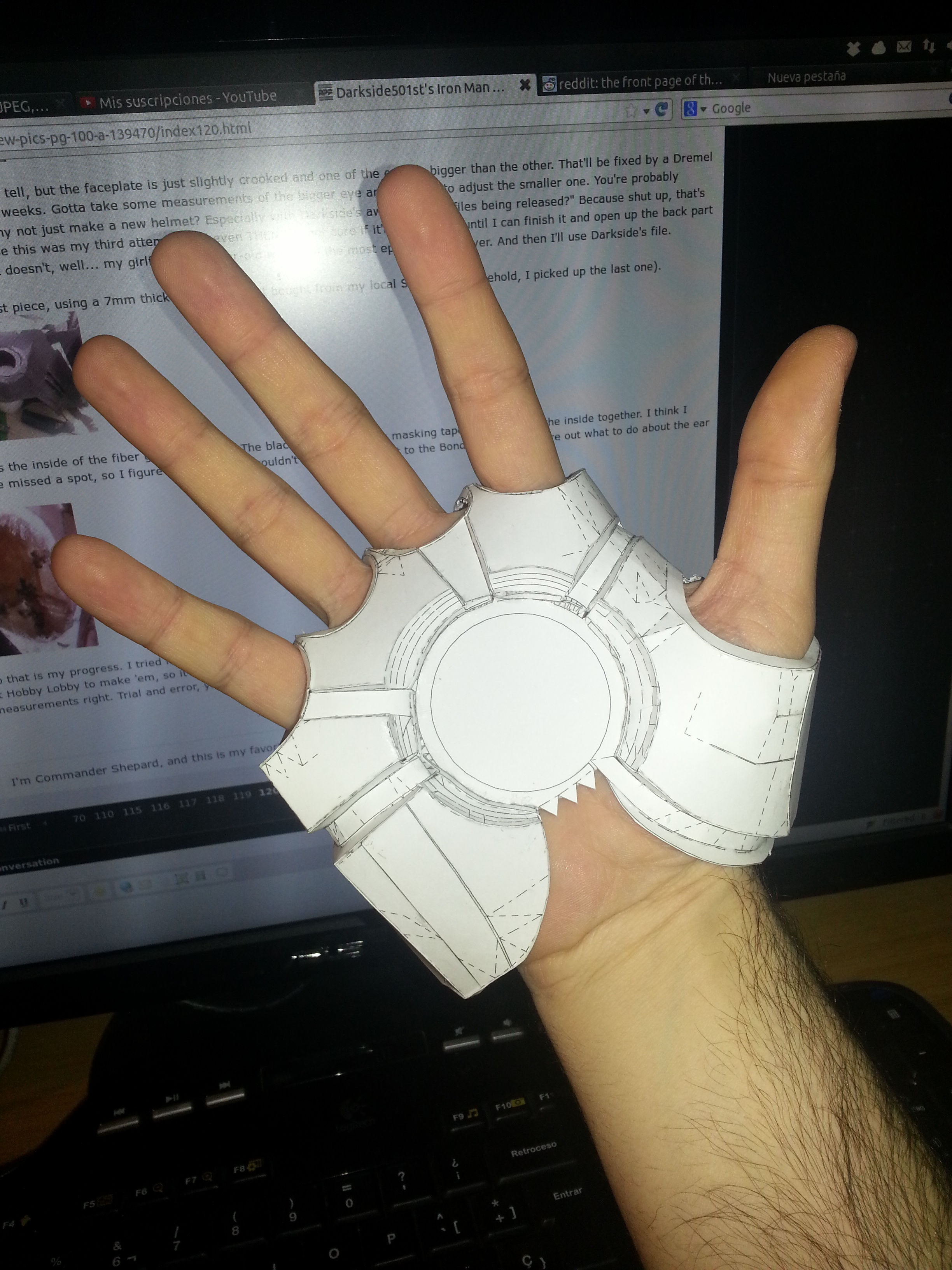

So that is my progress. I tried my hand at one of the gauntlets, but I kept making them too small. I just used little 3mm foamies for $1 at Hobby Lobby to make 'em, so it's not like they were costing loads of money to make. Just frustrating is all. Trying to get the measurements right. Trial and error, yay.
I think I have the opposite problem, I still have to finish the gauntlet but I think it's too big... but still not sure... :confused:confused
What scale are you using? (width, depth, height) Maybe we can average them out and meet somewhere in the middle?
On the other hand (ha), apply a quick coat of resin or epoxy (whichever method you prefer) and then see how well you can close your hand. If your fingers can't grip a cup, then it's too big. Think about Robert Downey, Jr. for instance. The costume designers in Iron Man 2 had to make the Mark VI so he could hold the microphone with a gloved hand.

I measured my hand at the knuckles as it seemed to me the most easy point to measure in both my hand and the 3d model. That dimension is pretty right at the glove.
It seemed to me like I had too much room at the wrist. But once complete, the onening of the wrist gets a bit smallet, so I guess it's ok.

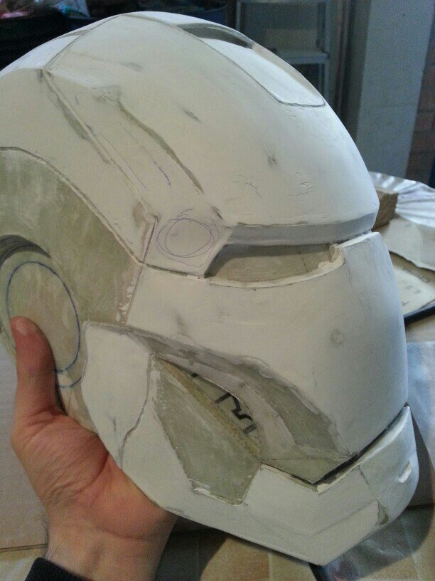

Little progress update on that helmet with Darkside's file. getting happier with it now I managed to pretty much make the line running along the side and back of the helmet look even, smooth and clean enough.and getting to work on the rings around the ears, made the skull and faceplate a little smoother still. Far from finished. IMAG0323.jpg IMAG0324.jpg
I know it's not much progress for an update pic, but I'm really trying to get this as right as I can. It's a beautiful file and I wanna do it justice, and my thread's getting no love as far as any help for things i'm coming to really need advice on.
I'd like to know what'd be the best suggestions for sculpting out those earpod rings so that they form a proper smooth circle, and I'd like to have any ideas on forming screwhead indents into faceplate sides.
Last thing I 'd like to get advice on is particular methods and measurements to place cutting lines for when I cut the faceplate off, as the lines I was using are lost under the bondo, even though i've done a few approximate traces with pen. thanks for any help :) and thanks infinitely to darkside501st.

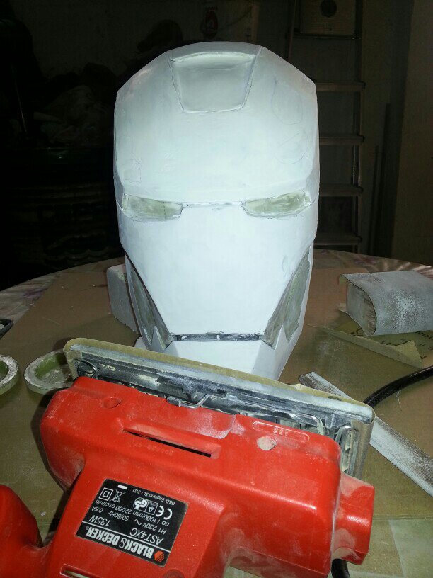

Sanding weekend! :D

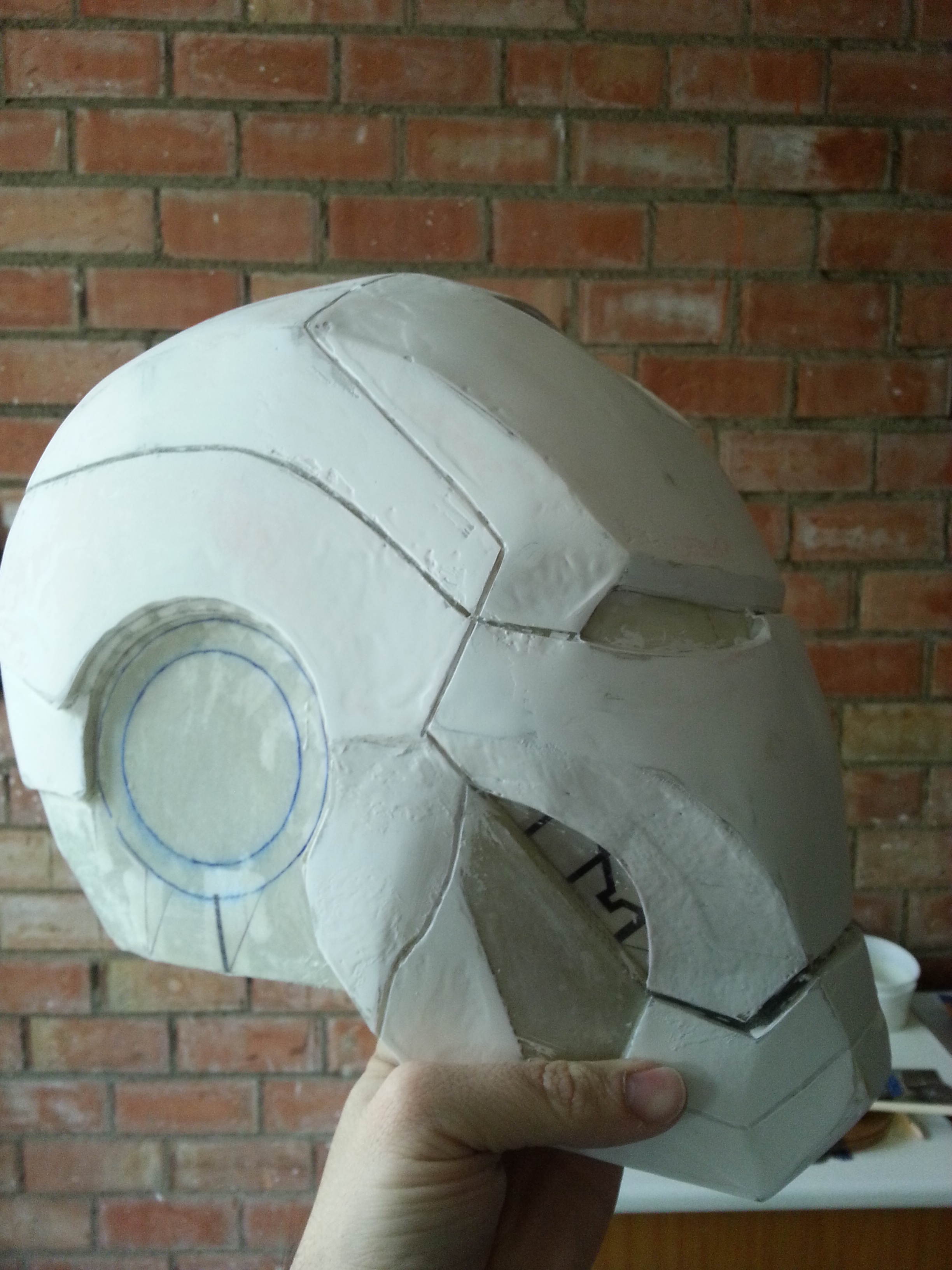

BTW, what I'm applying to the helmet isn't "bondo" filler. In the store i bought the fiberglass the only thing they had was "gel coat" which I thought was the same as "bondo", it turns out that although I think is similar, it's much more fluid than a filler... I had to apply it with a brush and the thickness of each coat is about 1 mm at most. So this requires a lot of work to fill a big gap.
I have found now a couple of stores that sell real filler, not that I'm unhappy with this "gel coat" but it requires too much work, maybe for the next pieces I will use filler :unsure
Also, I'm not sure if I'm going to cast my helmet or not... it may depend on how well it turns out, but I would like to have 3 or 4 helmets to try different things and not to worry if I break one :)
Does it require much work to do a cast? I mean, compared to building another helmet does it require 50% of the time? 25%? :D
Is it better to cast the helmet before or after cutting the faceplate/back??
I have located a shop that sells any requested automotive paint in spray can, I think I'm going to do the popular choice of colors "Toreador Red Effect Clearcoat FL" and "Sunburst Gold Metallic Clearcoat BP/M6924" do you guys have any other color suggestion?
Lots of questions today!!! :D :D

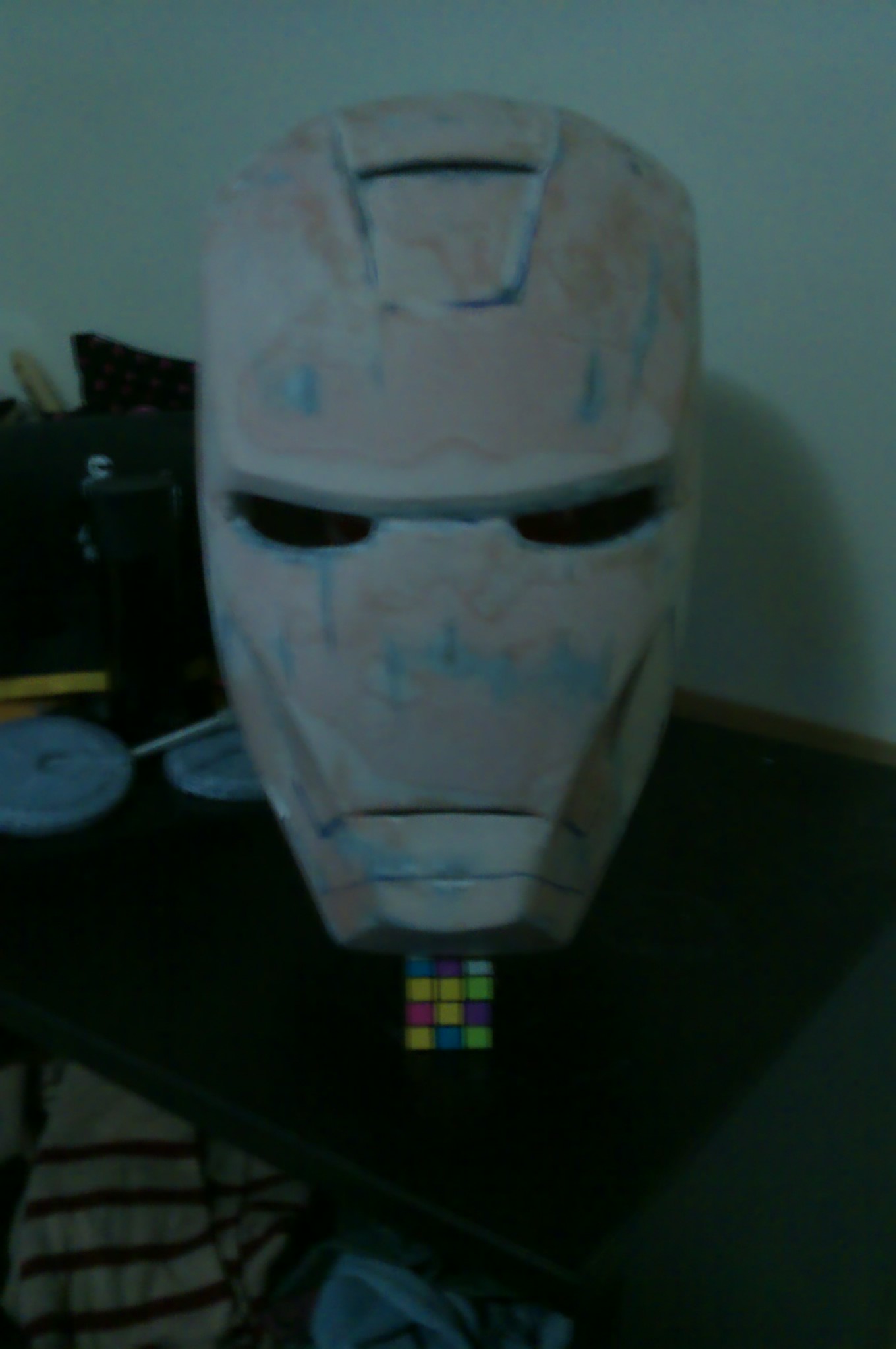

PD: not so much progress since las photo, but this is the state of the helmet right now :D
its normal you are unhappy with the gelcoat !
the gelcoat is used to repair boats ... its like polyester resin but with a different consistancy!
alot of members use it to make fiberglass cast because its consistancy allow it to cover all the details !
So, apart from all the extra work I have to do now, what do you think of the durability of the gelcoat? will be the same? if it's used for boats I hope it will be! :D

Well i am quite impressed that you used it as a filler !
It shod have reinforced your helmet alot!
Beside of that gelcoat itself is a little weak if not back with fiberglass !
As for your previous question it is alot faster to make mold and copies
Making the silicone mold can take you 2 days if you take your time
And making copy using gelcoat..1h or 2h.
I would suggest to mold the helmet parts separate
So it will require less clean up
