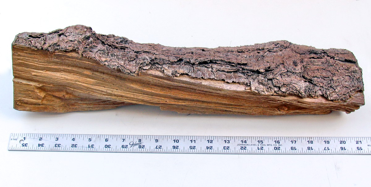

This is a rubber log from one of the Zorro films, base was black rubber, generic tone for the color as it would get dirt and moss and other such and what nots applied to it with some hair spray to come off when being swung and hitting someone. This rubber log is about 15 years old and has been used a dozen times since for an idea of how durable the above application and material methods are.
